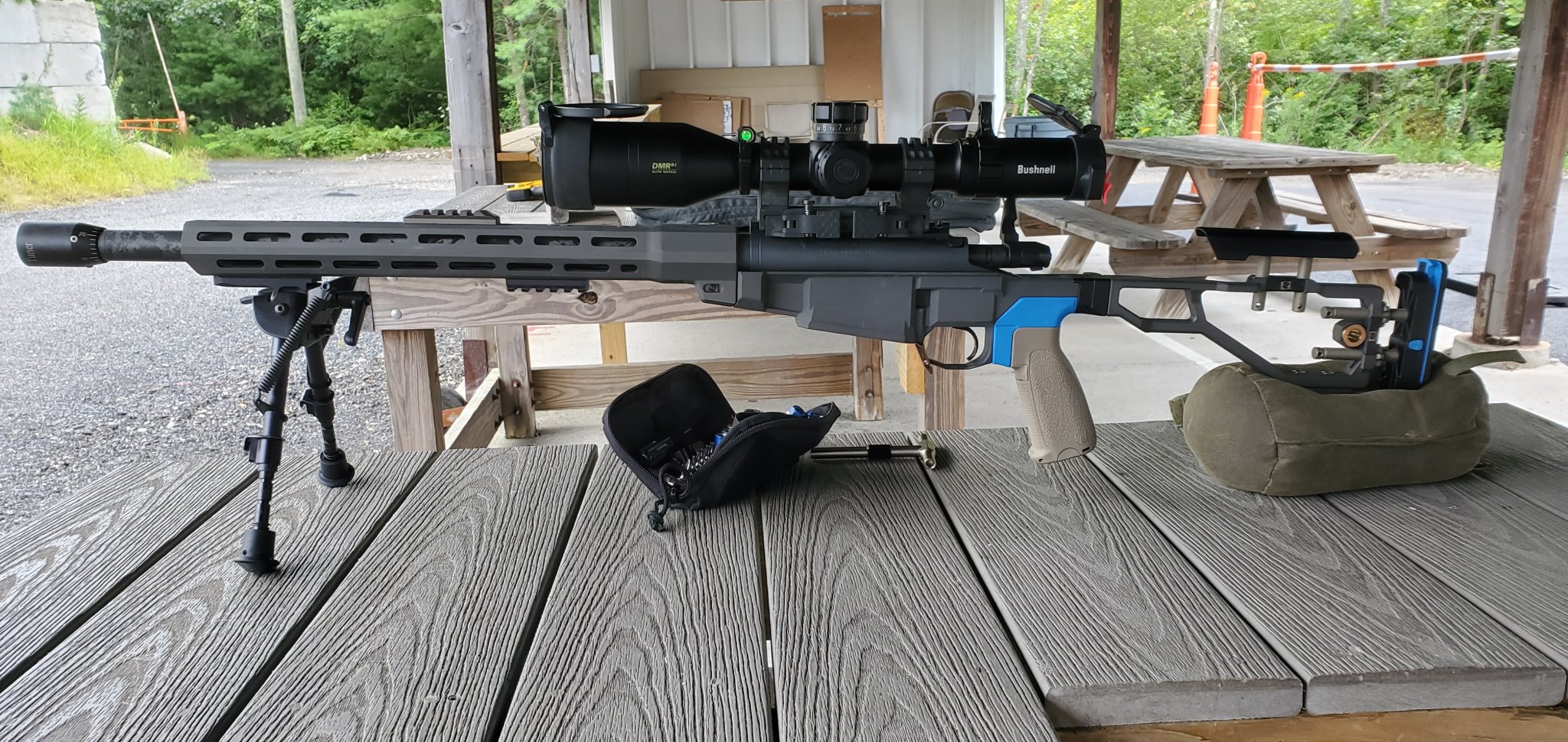

Is anyone out there running an EC tuner brake on their .22lr? I know there are other options but due to my setup the other options are more difficult. I am currently running my gen 2 Vudoo in a JP APAC chassis ( which I love) but the barrel length is right at the end of the hand guard. Just want to see what results people might be getting. Thinking of running some f class along with prs/nrl matches. TIA

Really like the chassis. What's the length of the barrel your running in it?

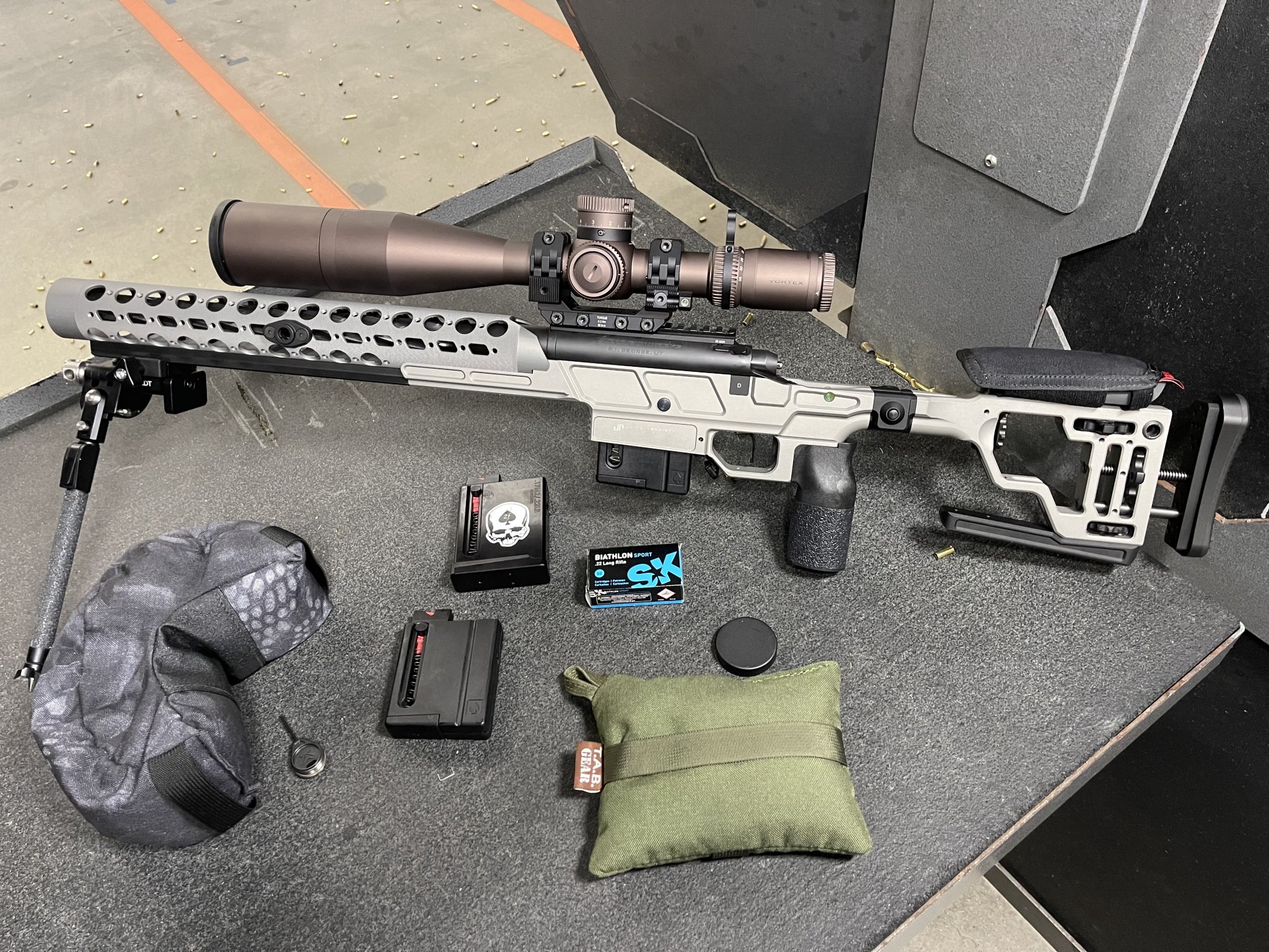

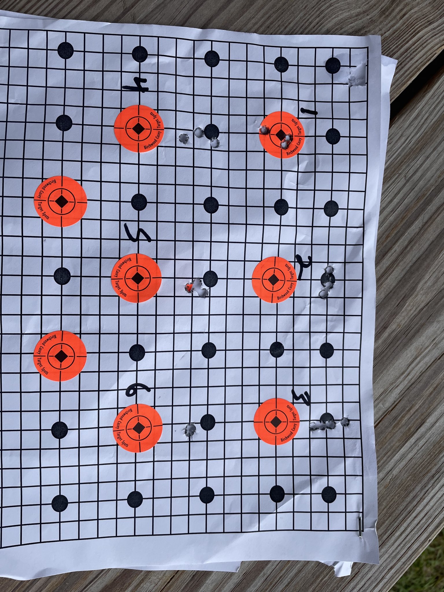

I just stuck one on my voodoo yesterday, here are the pics:
3 shot groups using norma tac-22. Im a believer

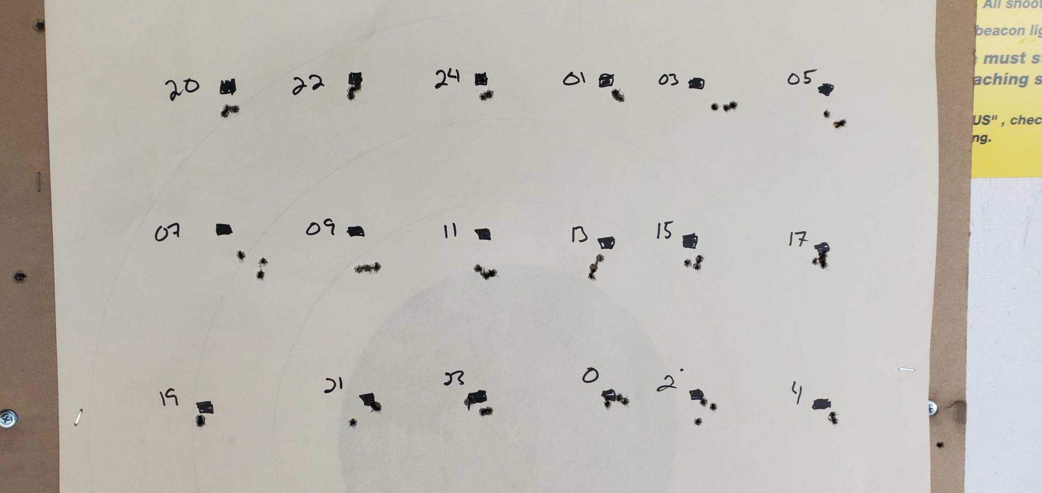

I'm running the EC Tuner on my V22 Gen 2. It is awesome. No experience with the brake but it's the same concept. #19 is the winner
#19 is the winner
I reached that same point with a Vudoo and a RimX. But when I took it out to 100 and 200 yds if was no better than without it. Shooting good lots of Rifle match and Center X. Put it on my .223 and after tuning at 100 it shrunk the groups at 300. My conclusion is it may or may not help you.

The groups are improved at 100 for me and 200 had improved vertical spread but I can't call wind well enough with a 22 at 200 yards. I've shot 22 PRS out to 350 and had consistent hits. Maybe it's the tuner, maybe it's just fun to play with. I'm going to test it on my 10/22 with a TacSol barrel. It shoots lights out at 50 and about 40 MOA at 100.
