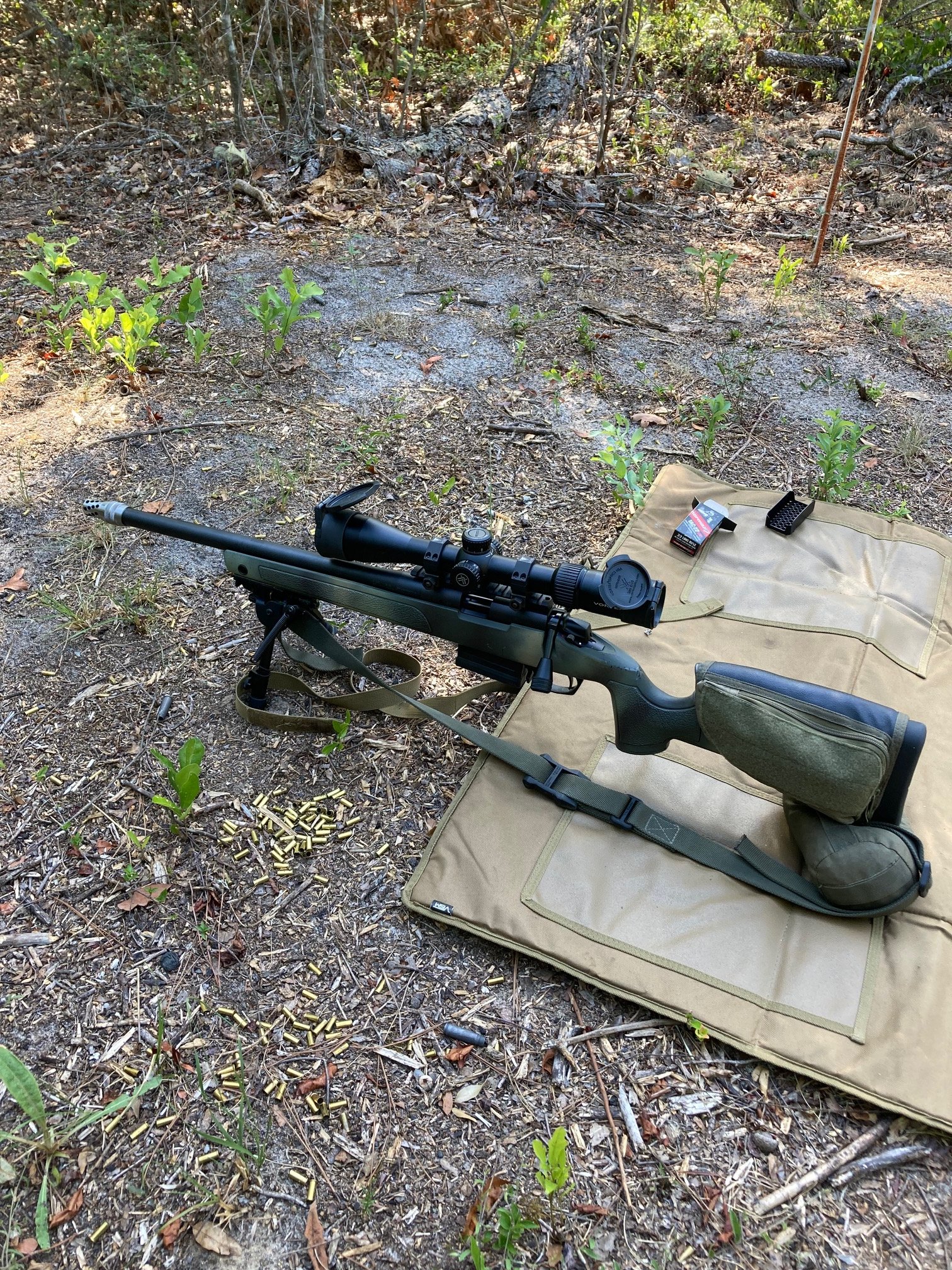

Cadex mx-1 mini brake
Ats tuner
@6.5SH
I'm running the same tuner and you ain't kidding! That thing gets loaded with carbon/lead pretty quick. It's a PITA to clean, but my results have been stellar
Reactions: 6.5SH
@6.5SH
Mine is the 2 port side exit model, but I can see where the spiral model would be even worse in that regard. I agree the tuner works.
