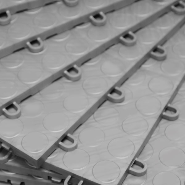

    Tech Floor or similar lay down garage floor squares. A couple different options with either open air or fully enclosed tiles (I would do fully enclosed so I can find all the small parts that get dropped).
    No big involved floor prep and easy enough to repair/replace if needed. Lots of different options for edges. You can take it with you if you move. Still big $ per square foot. Helped a couple car buddies lay out their garages with this back in the 2000’s , fairly easy install, just time consuming. The one guy I see occasionally still likes it.

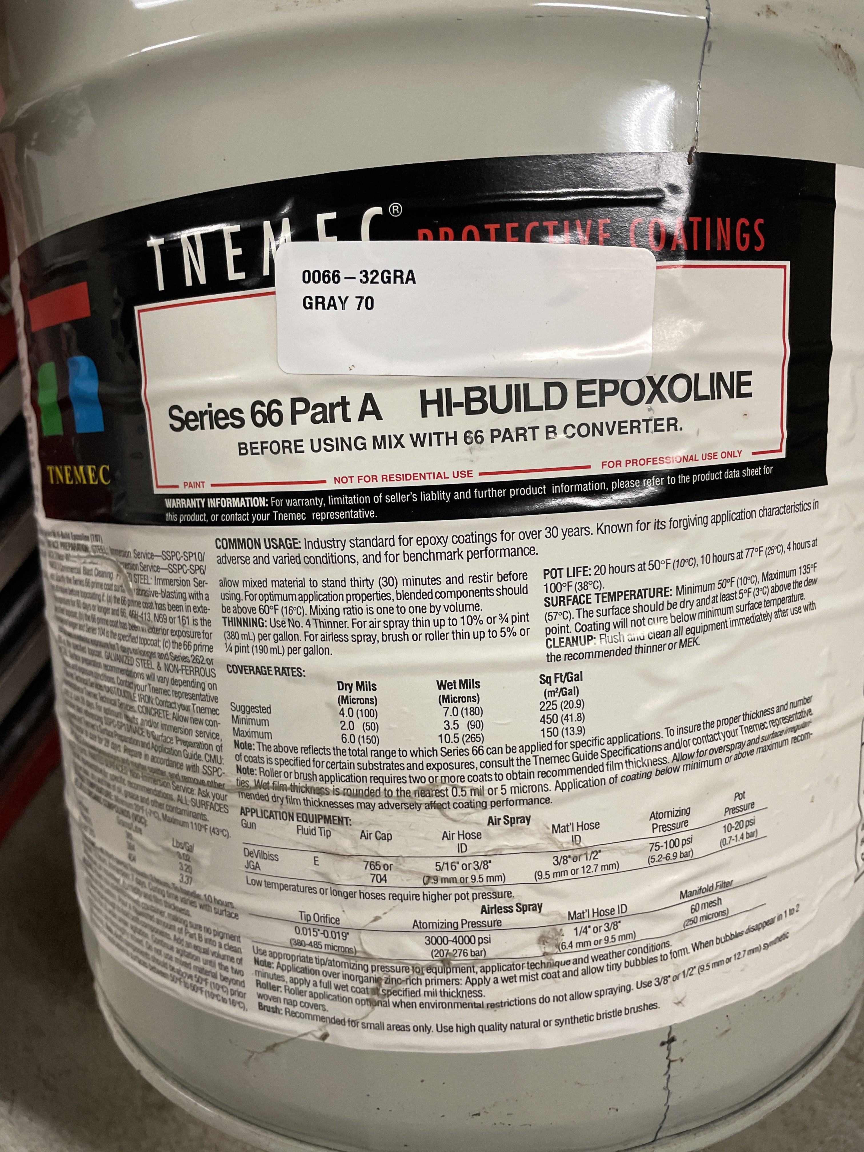

    I have had great results for 20+ years in my shop.
    The only product I use is TNEMEC
    Think cement spelled backwards.
    Their 2 part epoxy is Awesome!

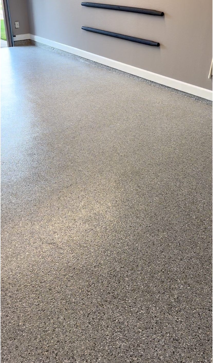

    I went with a professionally applied polyaspartic coating on my garage floor. For the reasons below (copied from a google query).
    Most epoxy coatings with yellow with age when exposed to UV. Polyaspartic won't yellow. Some companies will use an epoxy for the base coats and then a polyaspartic for the top coat to prevent the yellowing.
    You can also have grit added to coatings to provide additional grip to help prevent slipping when the floor is wet.

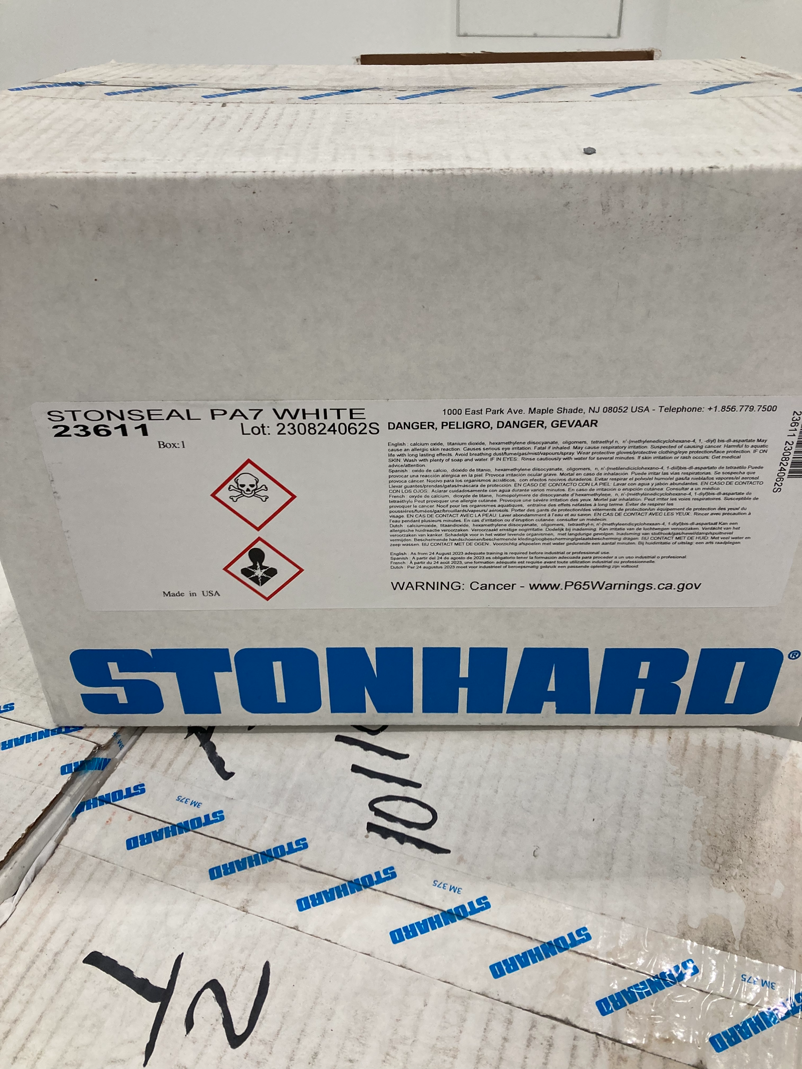

    as stated above, the poly is better coating imo. prep sucks
    these guys use it and it has held up well for my peeps

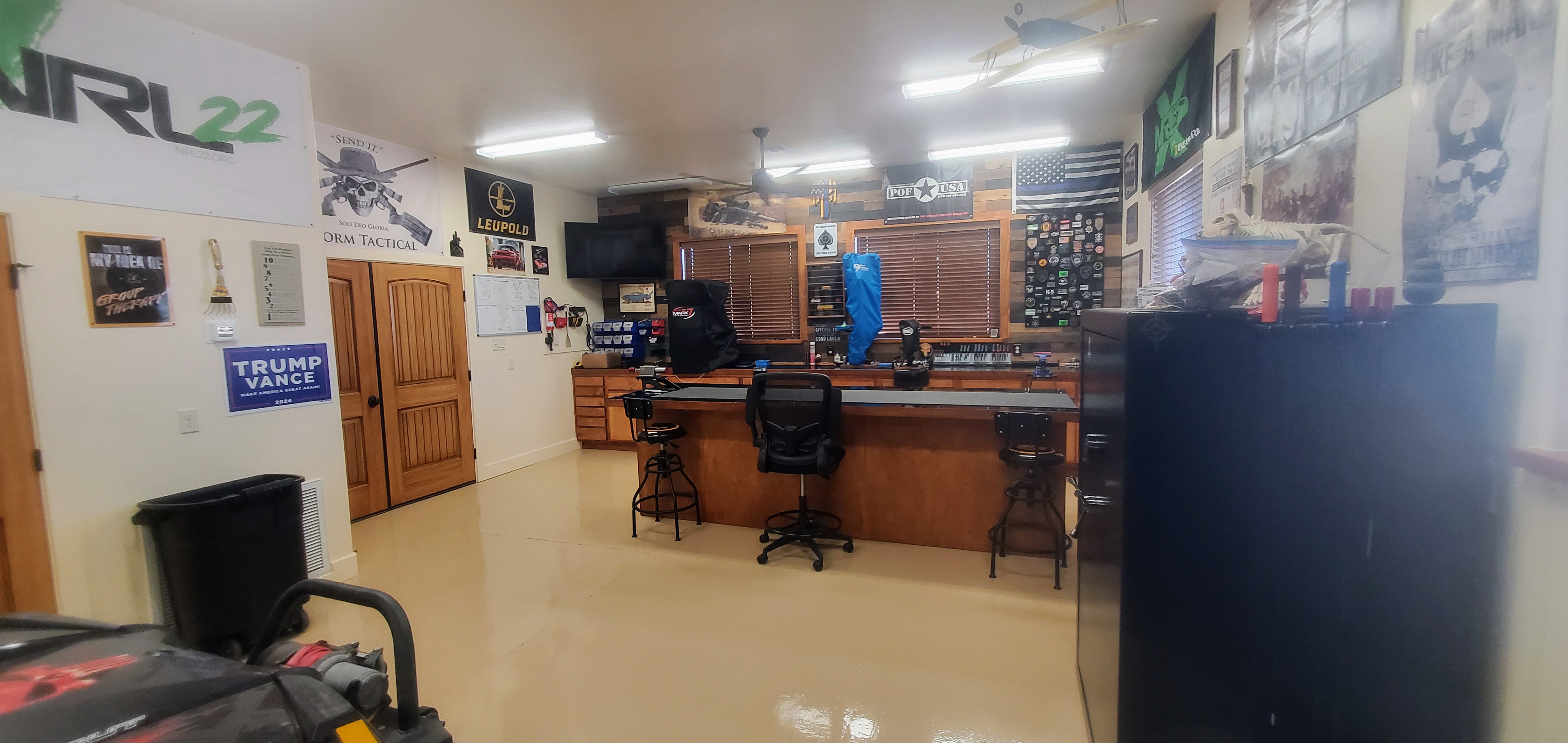

    I have this exact poly in one of my rentals

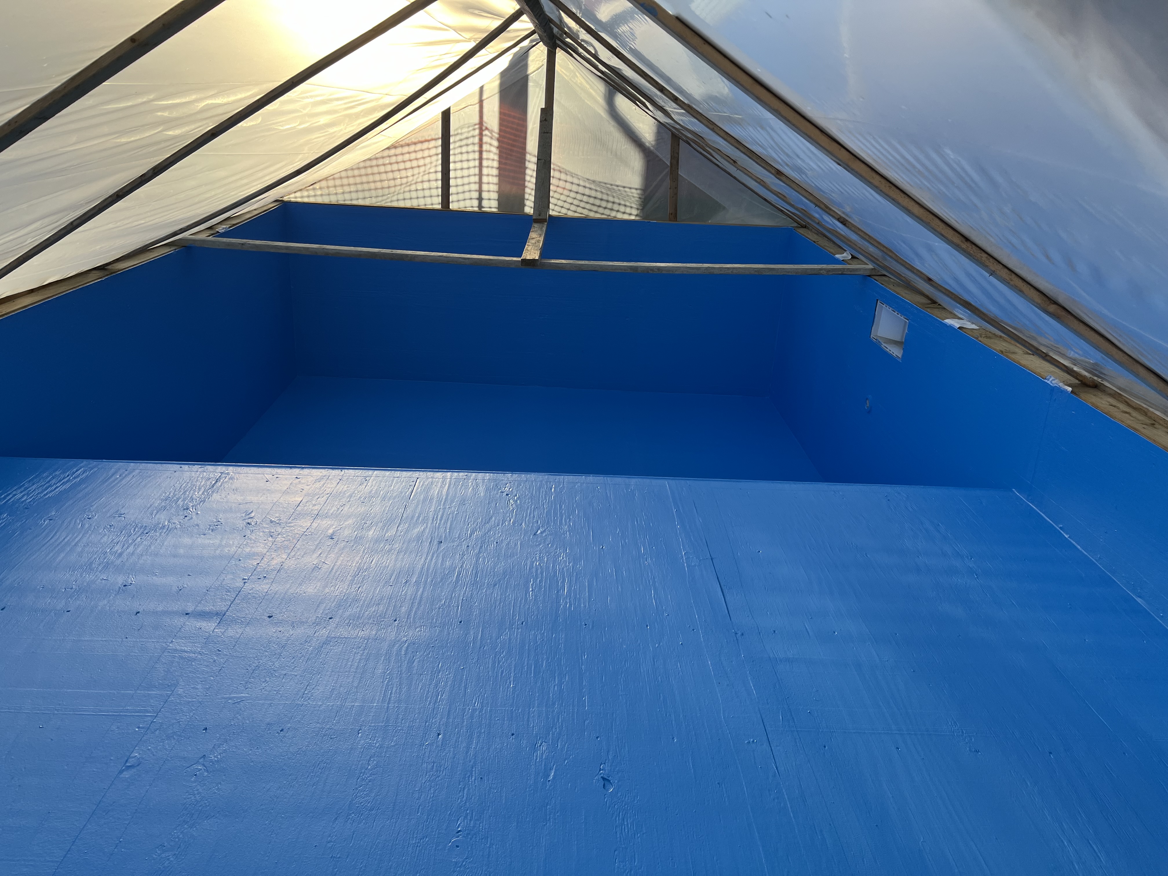

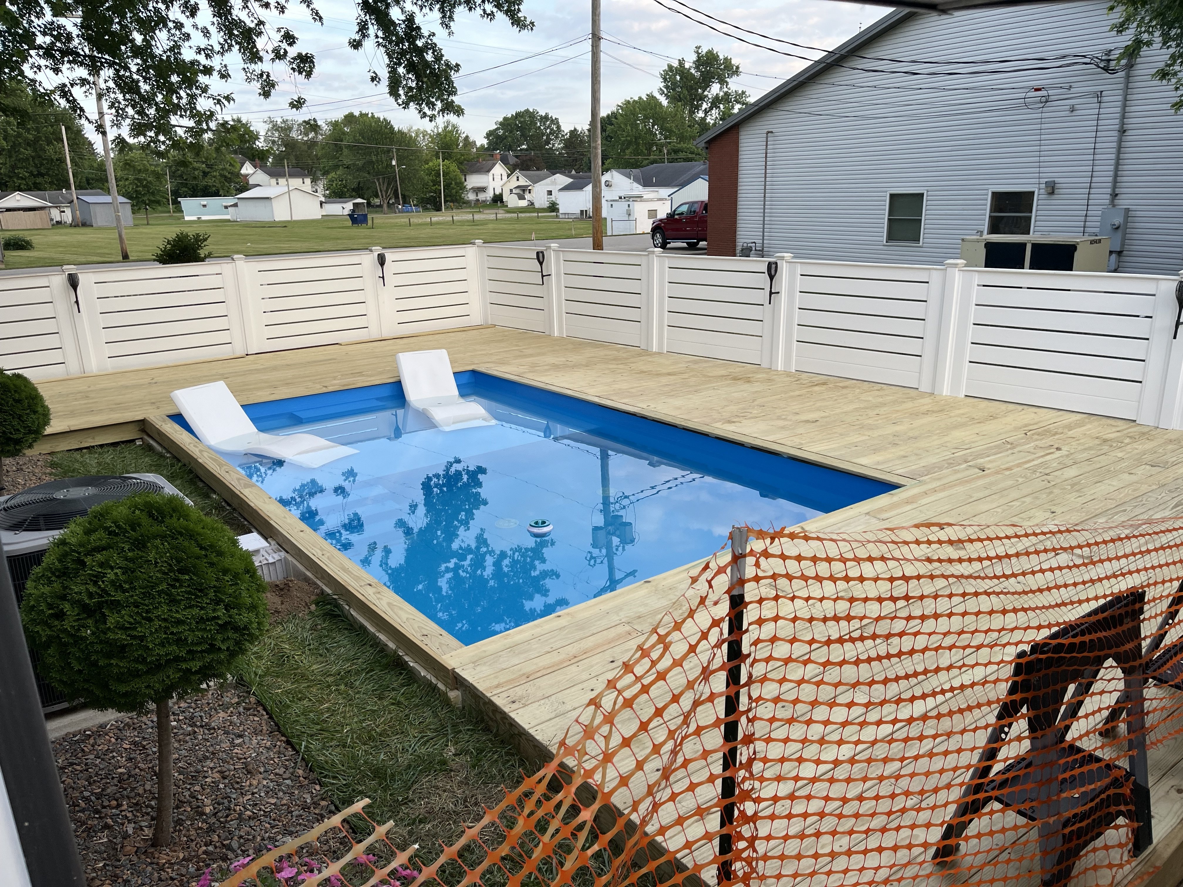

    there are some really good rubberized products out there depending on what you are doing. This is a pool I built a few years back.
    Dura Rubber
    That's a cool setup.
