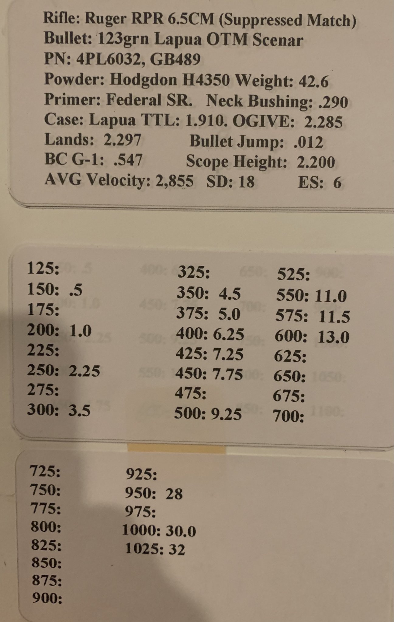

So I have a new Ruger RPR in 6.5CM. I'm shooting a Vortex Optics Strike Eagle 4-25x50 in MOA, with Warne MED Rings, with the factory RPR 20MOA Rail. From a 100yard zero I can adjust down 41 MOA still. I went to the range today and got to hit out to 1030 without any issues, however my max up number is 60.25MOA form zero. attached is my load and dope for that load for the ranges I have so far.
You could run a 40moa rail safely, and still zero. It would "buy back" 20moa elevation. You can dial 1k, what does it matter ?
