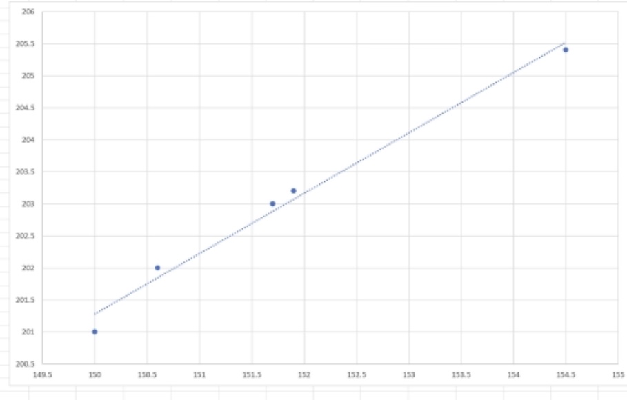

Below is the graph of case volume (y-axis) vs. case weight (in gn) after decapping, case trimming and neck turning. All 5 are Hornady cases. Case volume is in units of “grains of alcohol”. Partial data set.
Surprisingly good (linear) relationship. [Have tried this before with plain tap water and it did not look this good. Guessing it has something to do with water not always getting into the space inside of the flash hole and primer. Some issues with minuscus errors too.]

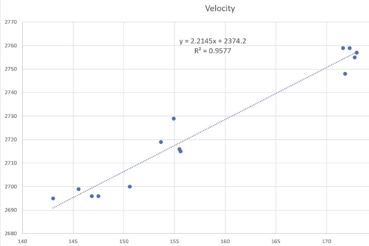

Muzzle velocity (y-axis) from a 30” barrel (in fps) vs case weight (x-axis) in grain, for FL sized brass, 140 gn ELD-M Hornady bullet, 40.00 grains of H4350. Labradar velocity measurement. Multiple different brands of brass.
This experiment gave the best fit (96%). Slope of the best fit straight line is 2.2 indicating that each additional grain of case weight adds 2.2 fps in muzzle velocity. So if you want your SD below 10, assume case weight contributes 50% to the total, and keep case weight variation below 5/2.2 = 2.3 gn.
At lower speed range, the case weight variations have a bigger impact (3.1 fps/gn), and the result is then 5/3.1=1.6 gn (max allowed variation in case weight).
It might sound like a higher speed range is a better idea, and that is true but only up to a point. Some amount above 2800 fps, the relationship collapsed completely, and very large speed variations (20-50 fps) were observed for cases of very similar weight. The equivalent SD increased from 5.5 fps to >18 fps. Pressure signs started to appear. Advice: Stick to the second highest node if you can, it is often wider, cases and barrels last longer, and the benefit in terms of hit percentage is only 1-2%. [If you compete, and you are in the top 5, you probably do want that last 2%!]
Read something recently where an improved way was proposed for measuring case volume: Decap the case, then turn around the empty fired primer cup and reinsert the wrong way. That ensures that any volume differences inside the fired primer cup will not play a role.
Should improve accuracy a little bit. [The result obtained above was pretty good already. Numbers will just be a little different.]

Just an update: Got hold of the Sinclair primer plugs and measured case volume for 20 fire formed Lapua SRP cases (trimmed to spec), and the linear / straight line relationship between case weight and case volume was clearly visible. No outliers were found.
Just an aside: It is challenging to accurately measure water weight as the meniscus (the surface shape of the liquid) is hard to get the exact same every time, but it is very easy to measure case weight accurately on an FX120. There might also be trapped air in the flash hole. I used a mixture of water and alchohol.
Of course, checking 20 cases and not finding an outlier does not prove that there are none in a batch of 1000. Poorly made brass can have a thicker web, but experience shows that premium brass rarely has this problem. Would still recommend that you mark cases that produce large ES twice in a row and simply cull them. Whether that was due to bad neck tension (different metallurgy perhaps) or case volume differences does not matter, just chuck it out.

Fair point: If you found your node / speed flat spot 50-100 fps lower than max (my situation), then Alpha brass works fine, you just load less powder and adjust the load to get the same speed as you had before with your prior brand of brass. Of course, if you use thin skinned brass like Hornady and load close to max, then yes you are going to lose speed.
