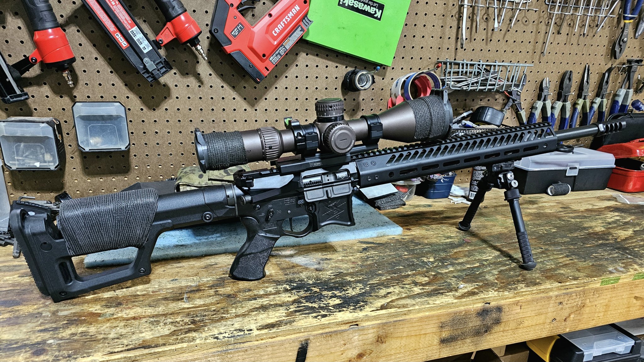

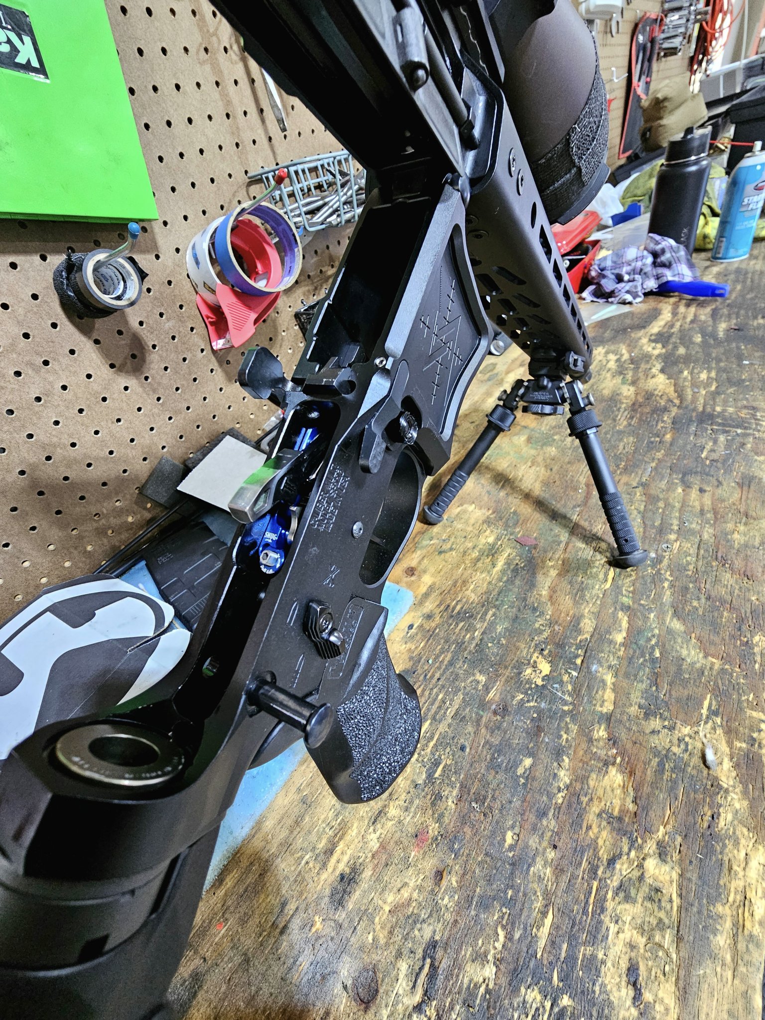

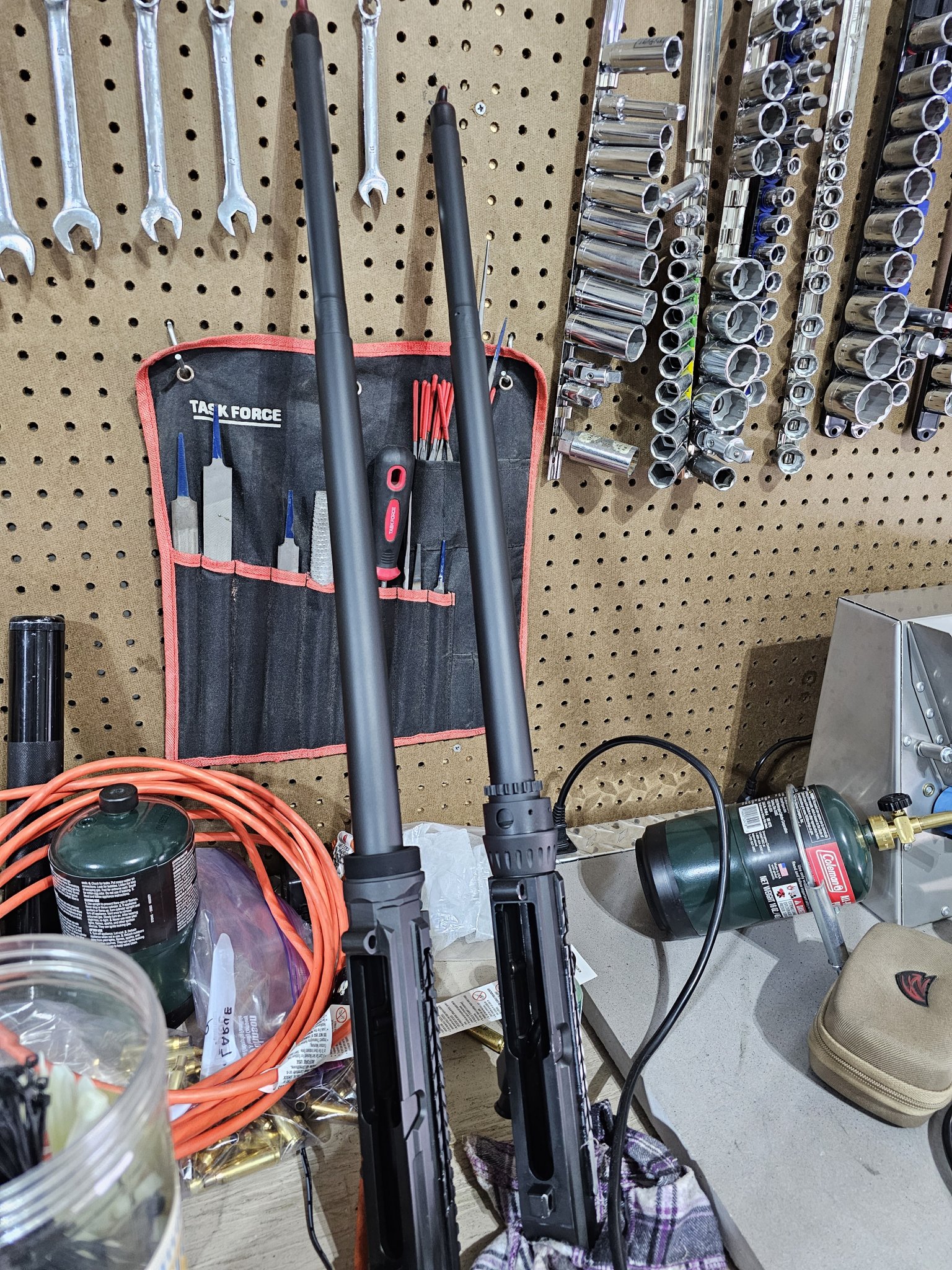

We had a great weekend working these platforms and trying to see how to increase speed vs accuracy at distance.
Exploring the speed drop vs other methods as well as getting back to 308.
This 556 we took to 1k, so it’s been fun working the systems again as they are so different compared to the wind cheaters

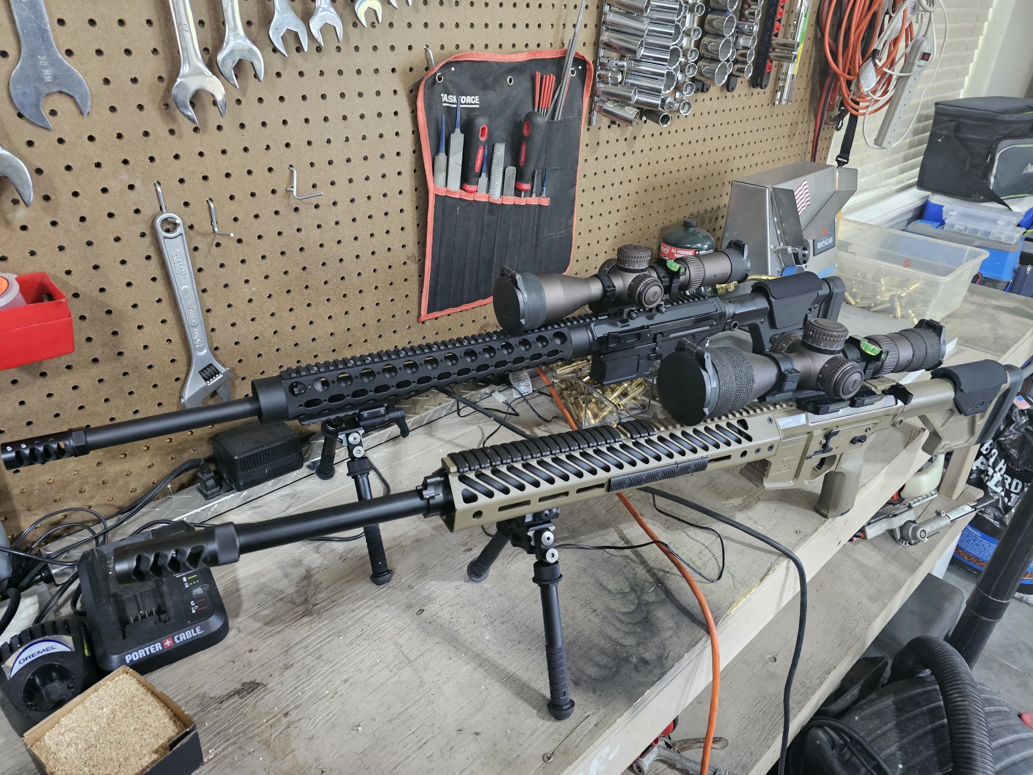

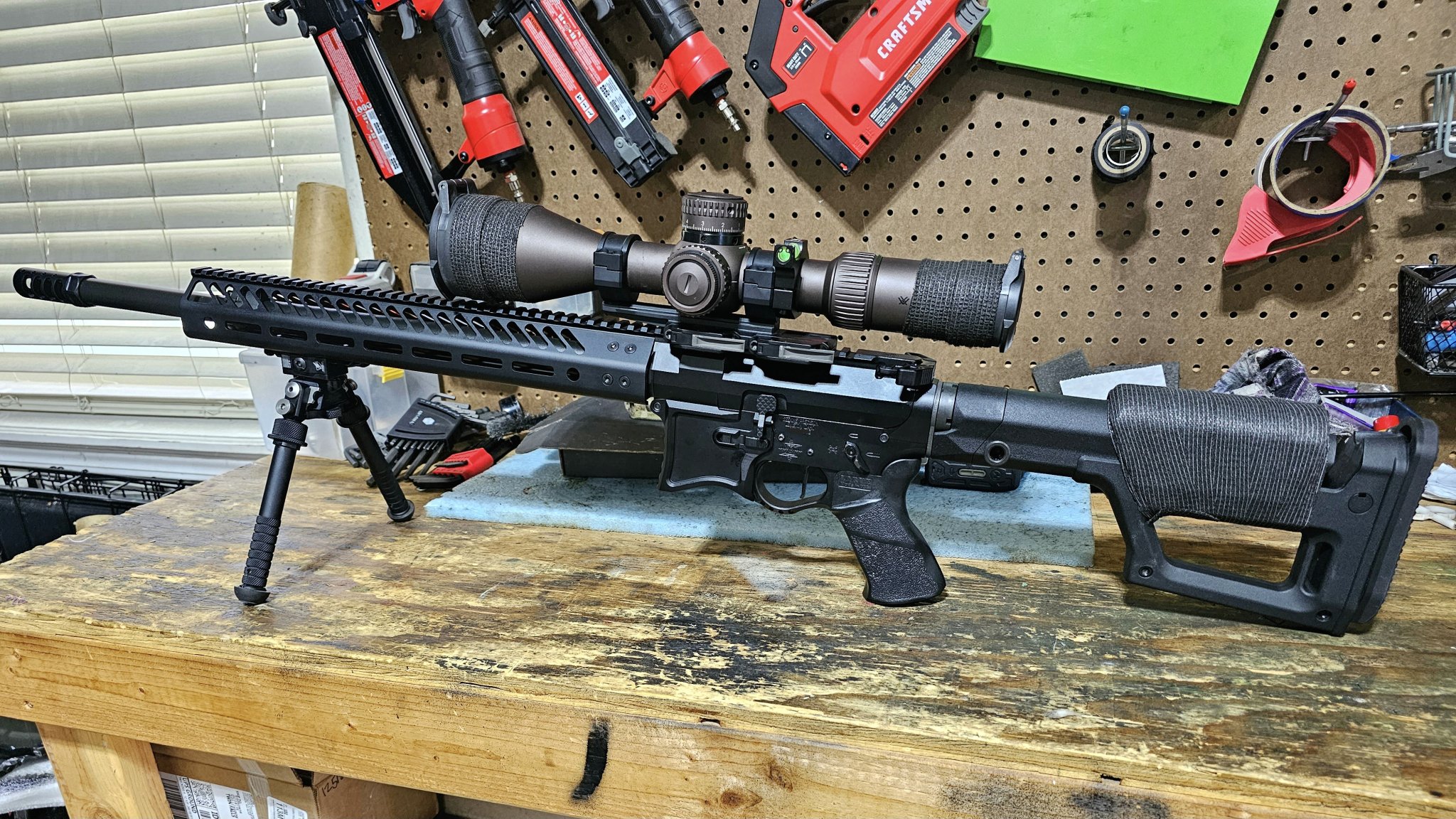

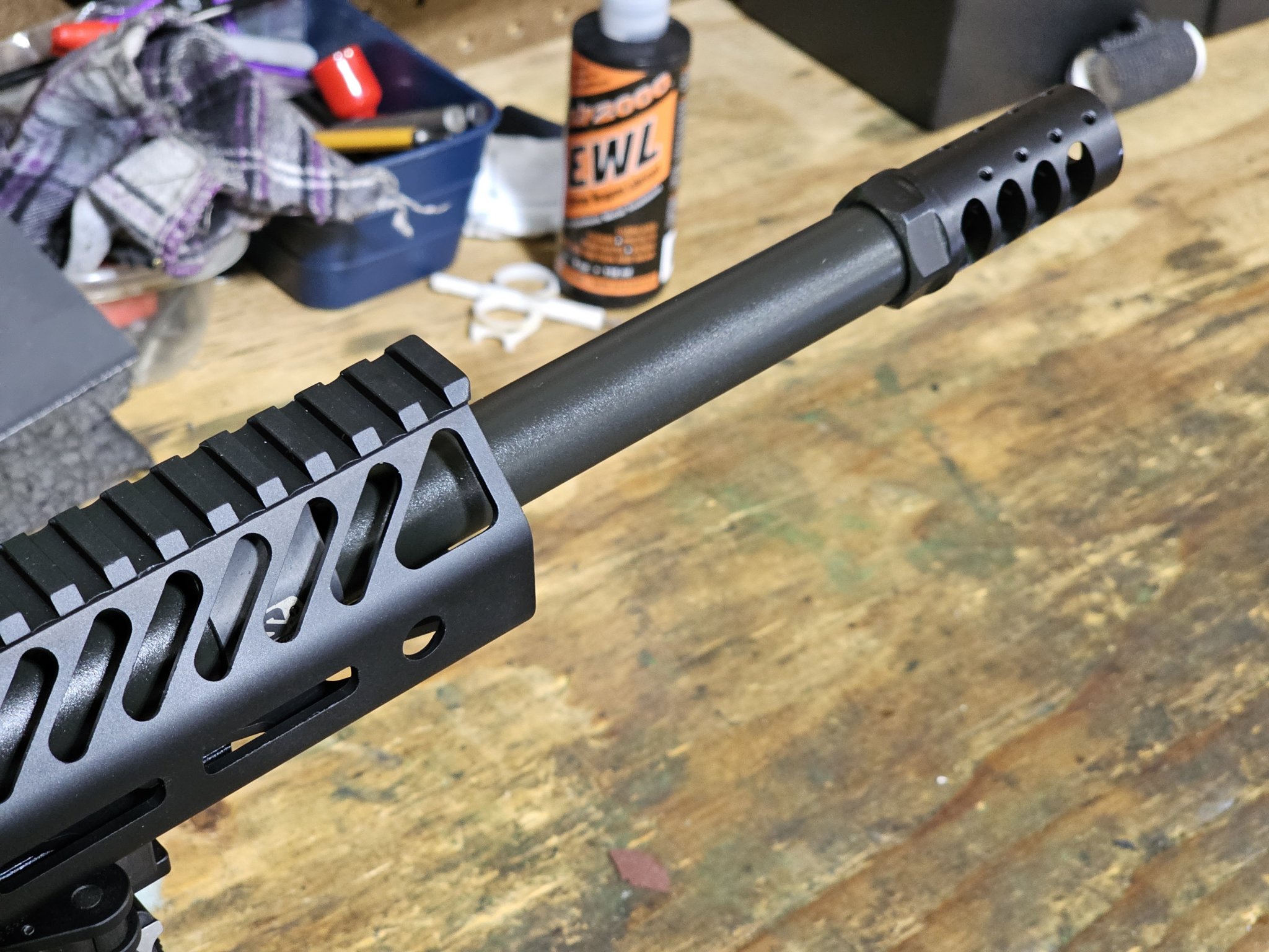

Here she is all finished...
CLE 20" Bartlein / 4 Groove / 1-7.7 Twist / CLE Match Chamber / Rifle Length Gas / M110 Contour / .875 Gas Block journal / 5/8x24 Treads / 11° Target Crown / WOA Competition Barrel exstenion polished to a mirror finish.
SA Adjustable. 875 Gas Block.
APA Gen3 Little Bastard Adjustable Muzzle Brake.
Seekins Precision IRMT-3 V3 Billet AR-15 Upper Receiver and 15" Handguard.
Raptor Ambi Charging Handle.
Seekins Precision SP223 Gen2 Billet Ambi Lower.
Oversized JP Micro Take Down Pins hand fitted front and rear for rock solid lock-up.
Triggertech Single stage AR15 Diamond with flat Trigger Shoe and TT Ambi Safety.
JP Standard SCS.
JP Enhanced Buffer Tube.
Rubber City Armory Titanium BCG, 7.8 oz
MagPul PRS Light Adjustable Stock.

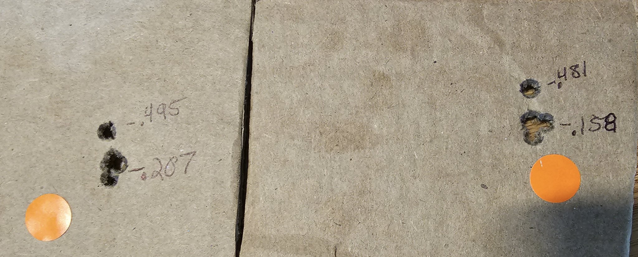

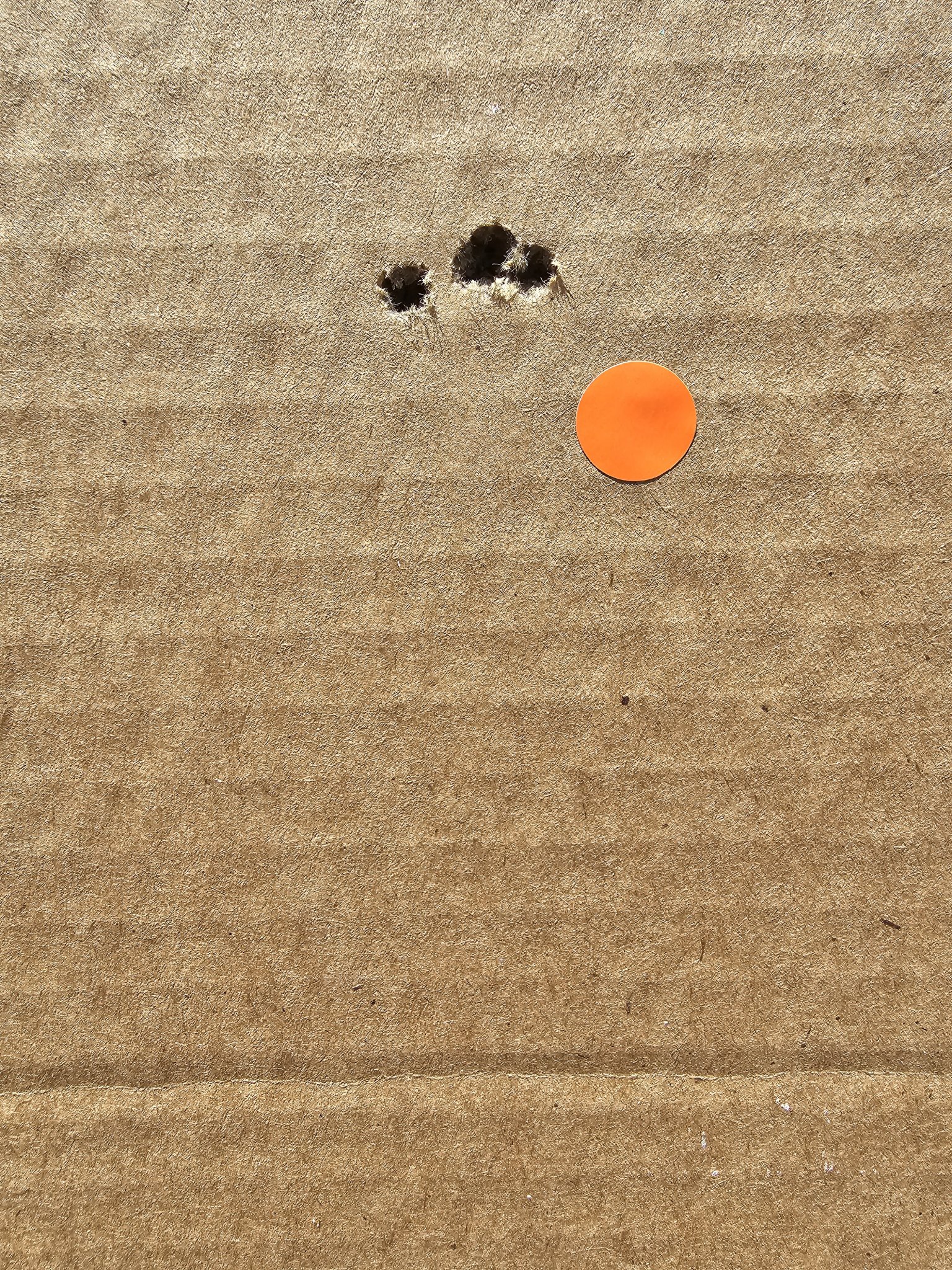

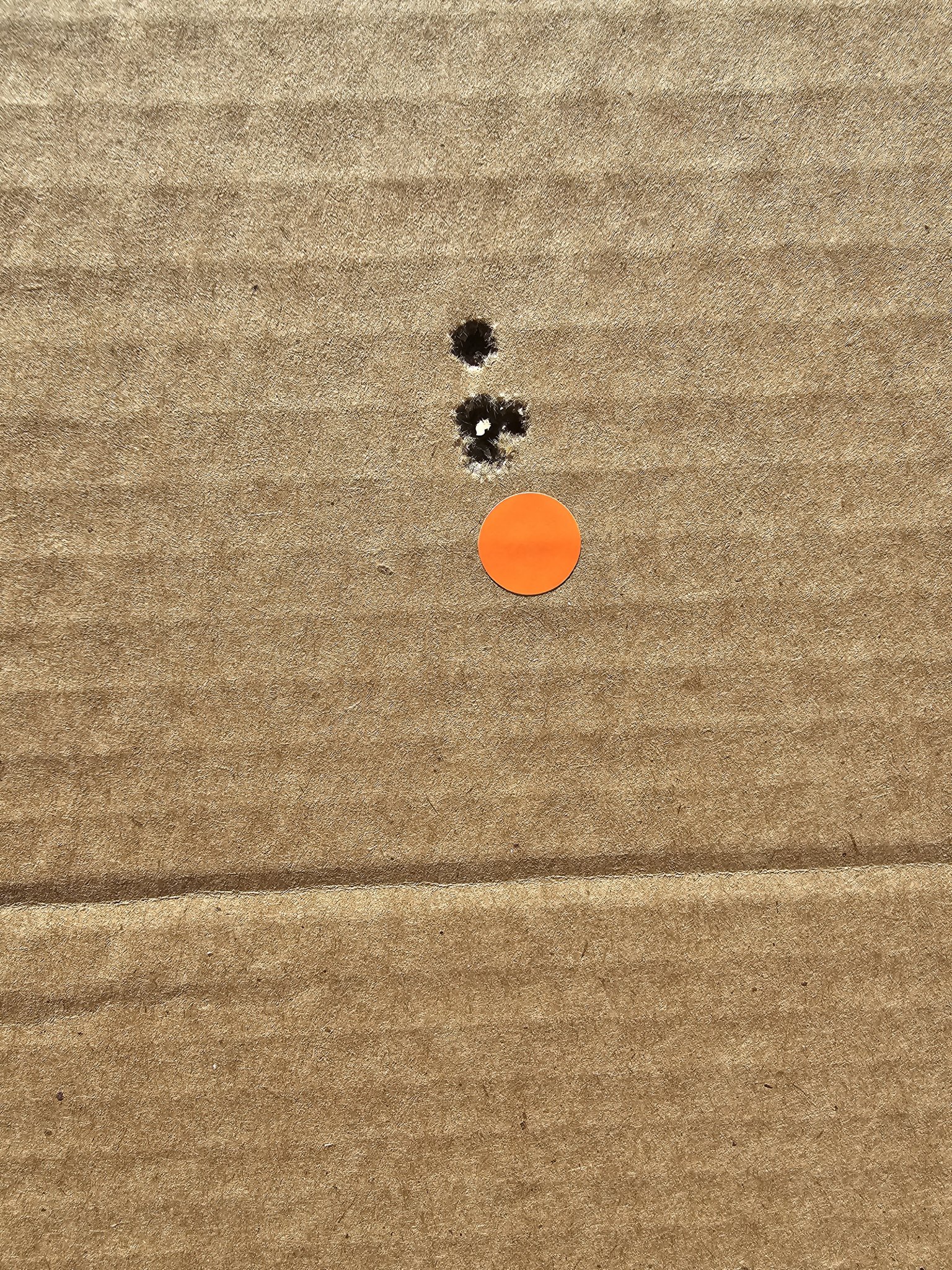

As Pictured above the two 5rd groups were shot by loading and firing 1rd at a time during Gas Block Adjustment waiting for Lock Back and a 3 o'clock ejector pattern with Black Hills 77gr, the orange targets are 1/2". I'm confident with handloads it will be a consistent Sub Half MOA shooter.
There is almost zero recoil with this set-up making it a absolute pleasure to shoot.

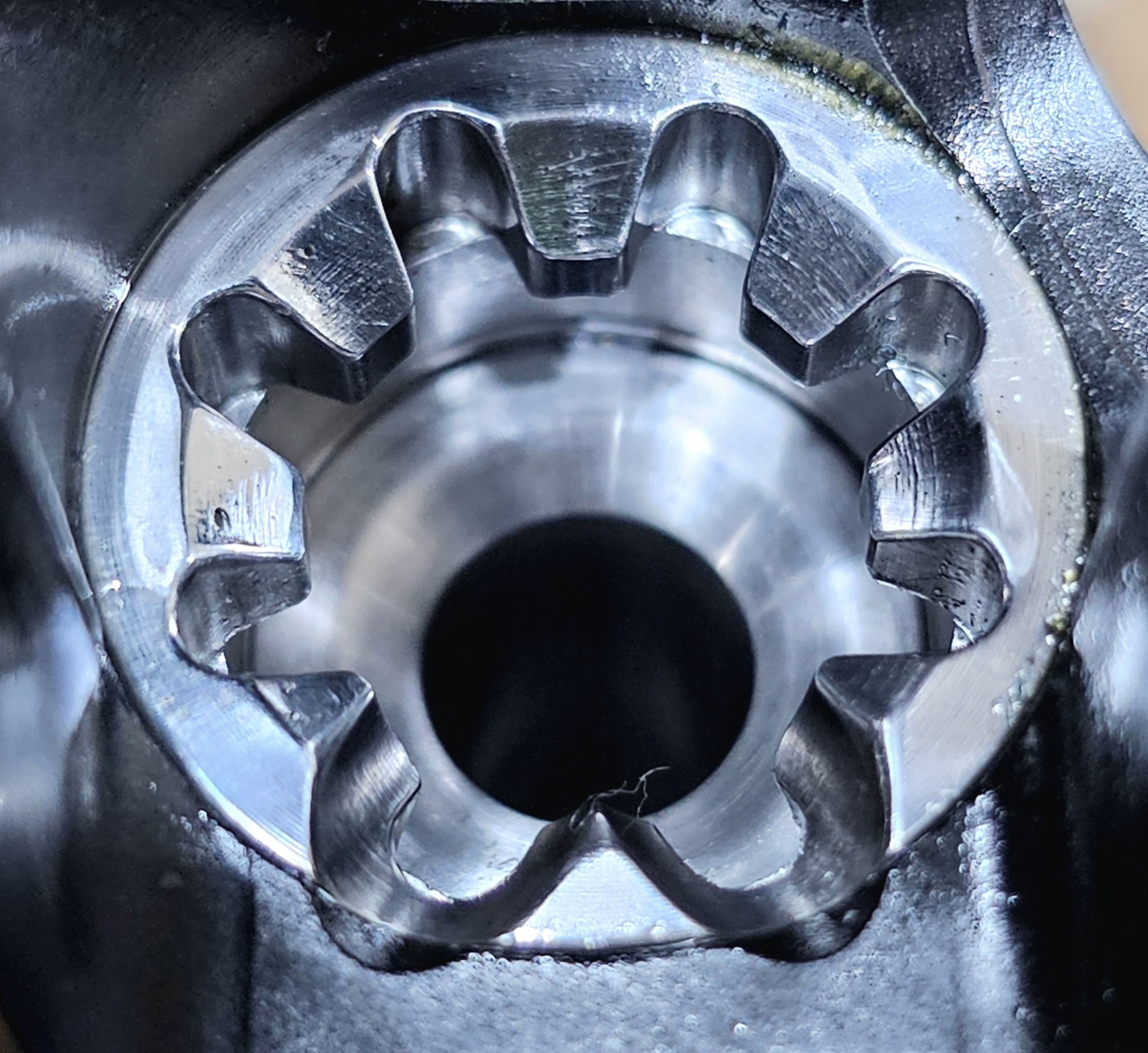

How much material did you have to remove and how did you do it?
Probably around .001-.002 with a Pin Guage and 600 grit lapping compound. Start with the lower, lapping until the take down pins and are able to tap in with a AR-15 armorer's hammer then move on to the upper. Usually the front take down lug on the upper is the only one that needs any lapping.

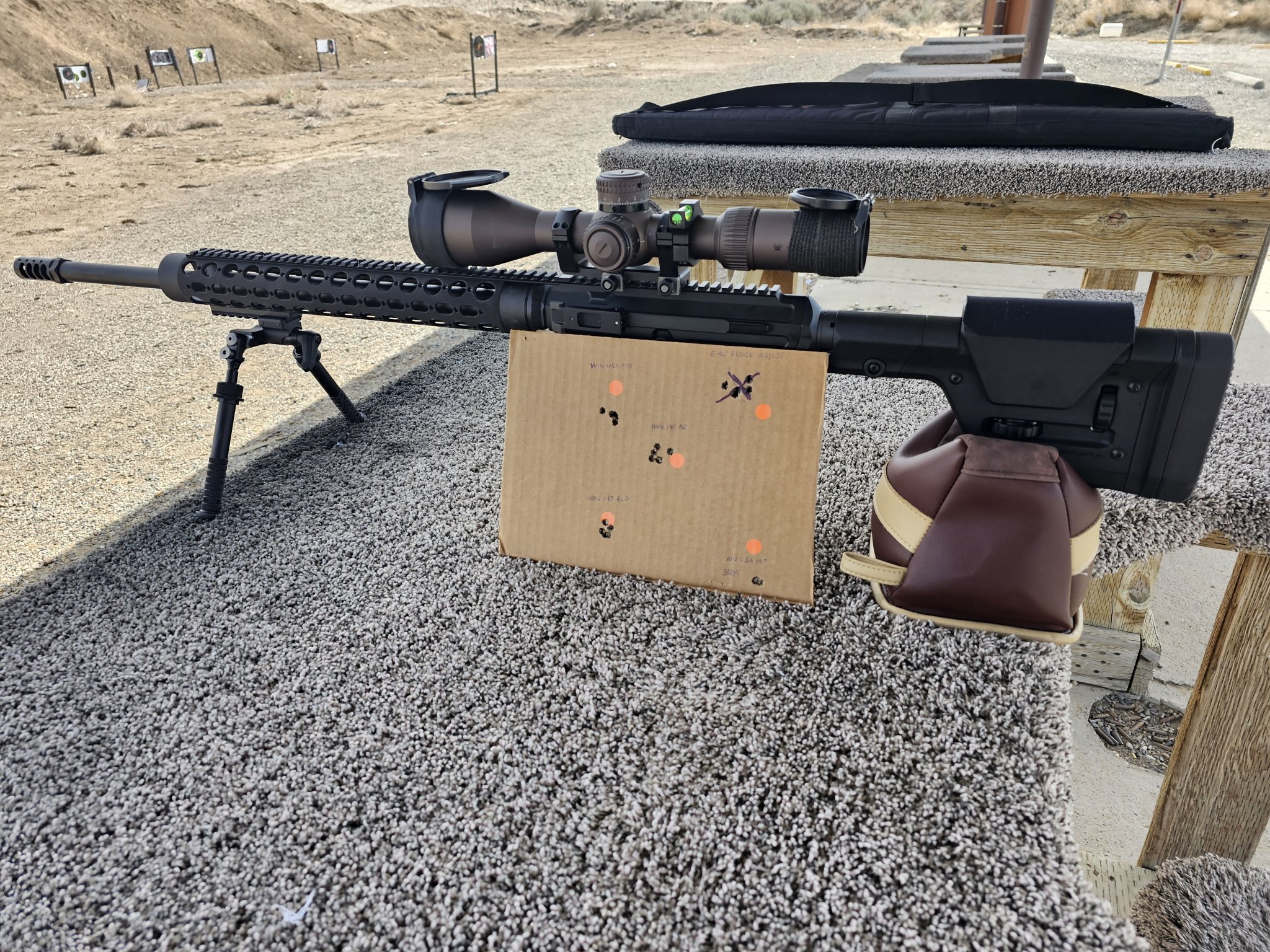

I actually just put together a JP LRI-20 with a 24" CLE 6.5CM Bartlein Barrel and it's a laser..
JP and Seekins are definitely my two favorite Chassis systems to work with.
I haven't started Load development on the JP yet but it sure loves that cheap Winchester USA 140gr Ammo, I've had quite a few groups in the .2-.3 MOA Range.

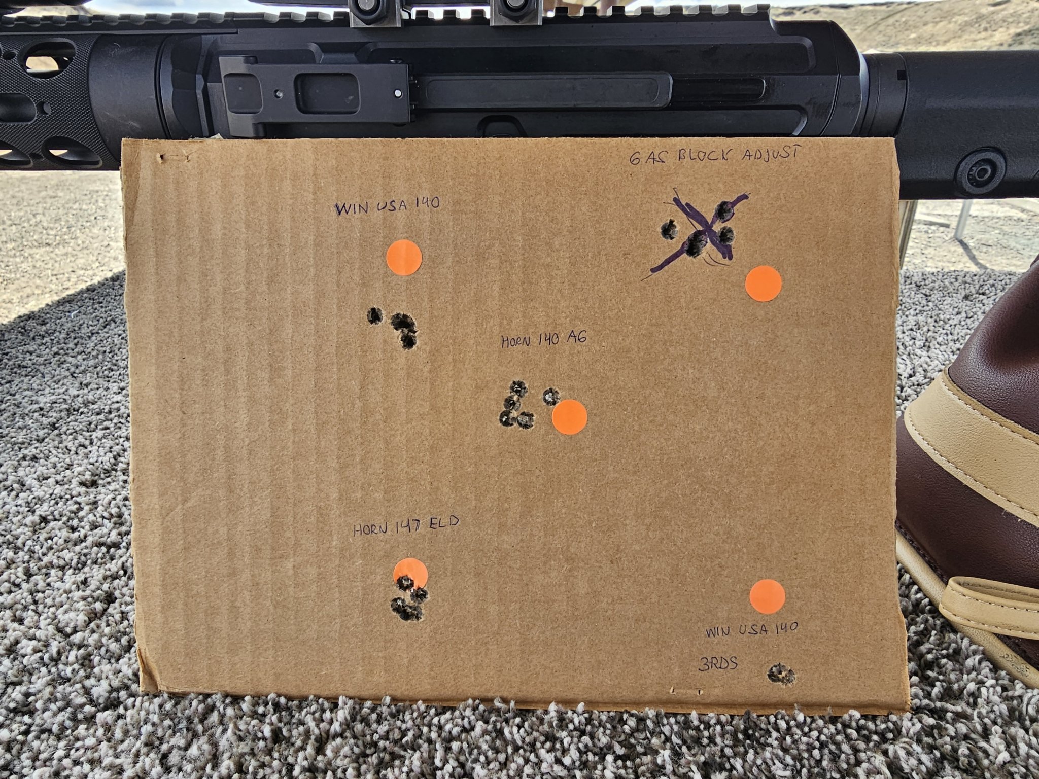

I'll be at the range again today, I want to see how it shoots some of the Burger Pills. I'll post the groups and the specs of JP 6.5CM
View attachment 8174134View attachment 8174132

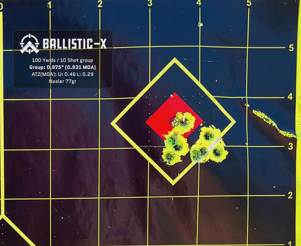

After reading Jp’s reloading for semiautomatic rifles, I tried a 123 grain bullet in my JP 6.5 cm. It shoots a lot flatter than the 140 gr at 2900 fps. And it groups well out to a 1000.

Damn dude. How the hell do you get groups that tight? lol. My best has been .931 MOA at 100 yards w/ Nosler Match Grade 77gr out of my 16" Noveske stainless barrel.
If you handload make up one with a flat base varmint bullet and a moderate powder charge. They are good for plinking, coyotes, banging steel too. I shoot lots of 69-77 handloads because I bought a ton of blemished bullets for 12cents a pop several years ago but for most people a 55gr varmint bullet will do everything you need an AR to do.
Hammer swing is the main difference between an AR and a bolt gun when looking at precision. Bolt guns only have to worry about pre-vibration travel of the firing pin.
ARs have to worry about the mass of the hammer swinging and that transferring energy through the hammer spring into the lower, then impact on the firing pin, and pre-vibration travel of the firing pin inside the bolt.
One set of approaches to this is the low mass hammer (with hammer integrity/durability a consideration), and a firing pin design that doesn’t contact the inside of the bolt as much.
This is why fundamentals must be really dialed-in on gas guns, especially ones that fire larger cartridges than .223 Rem/5.56 NATO.
Tom Beckstand did a great article on all of this that went into the weeds, with a lot of testing and things you can duplicate, rather than lore and mystique. He tested several AR triggers and used the Bull Bags method for frontal support, just in front of the Magwell under the handguard vs far out in front.
