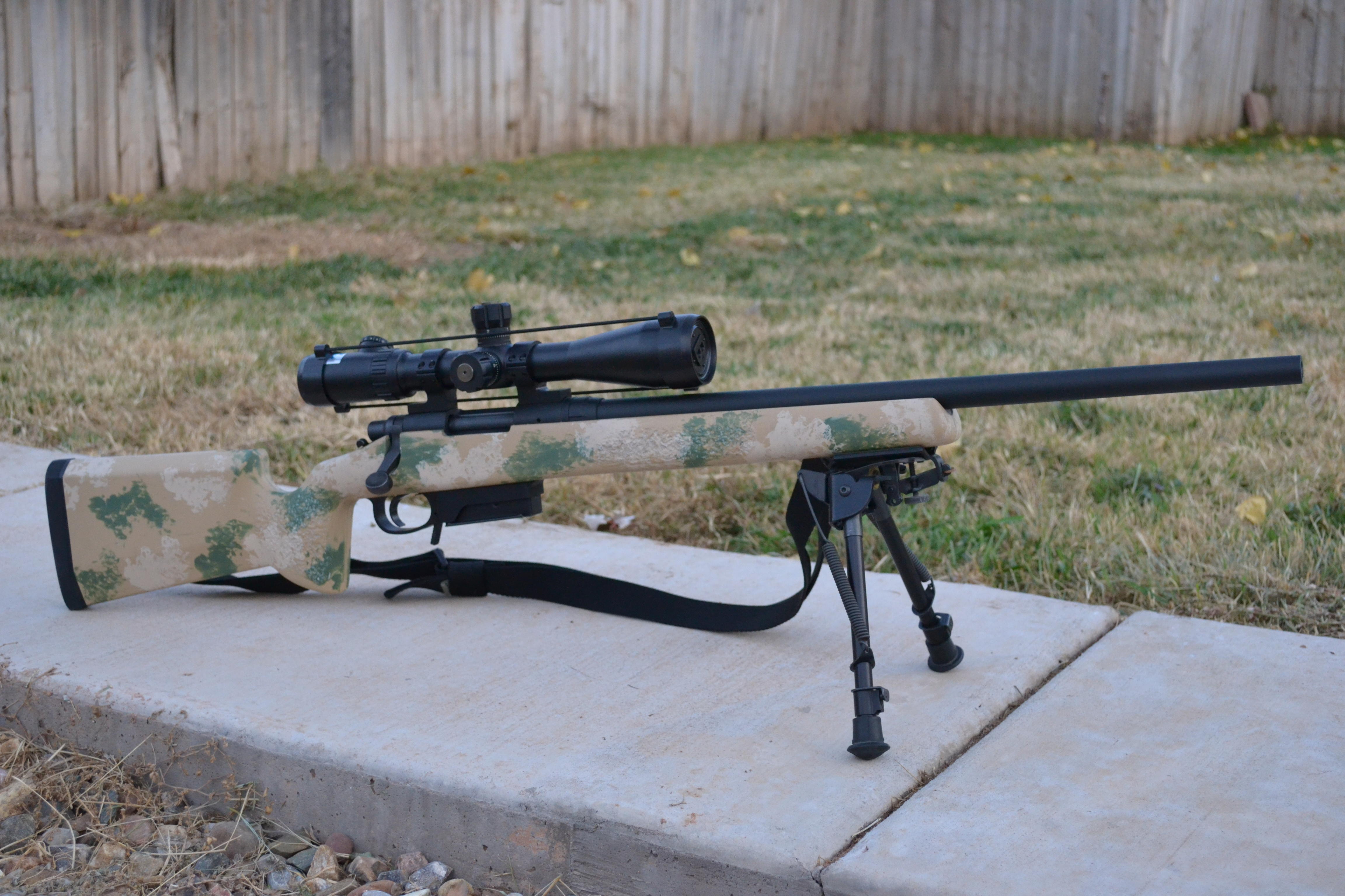

I have a Remington 7mm-08 with EH1 and M5 DBM. I started building it last spring with the goal of creating a short, lightish, medium range rifle that could double as target/steel ringer. I was able to keep the whole package at just over 10lbs with a loaded 5 rd mag. I really love this stock and will probably stick with it for all future builds.
