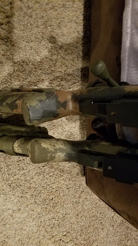

    Maybe it's just big hands or something, but I own both and really prefer the t6a and would rather have 2. The eh1 isn't bad, it's just slimmer everywhere and I don't like the fit as much. If it's more match and a little hunting, I'd do elite fill t6a. I ran a dual build for a while in the elite t6a and it was no problem for hunting. Now with a dedicated hunting rig with the eh1, it's not bad for that, but I'd regret it for a match.
    bkw1911, that's exactly what it comes down to is grip size. Here are 2 pics of a MCST next to T6A, and T next to A3-5. Big hands likely prefer the T6, smaller likely prefer the EH1.
