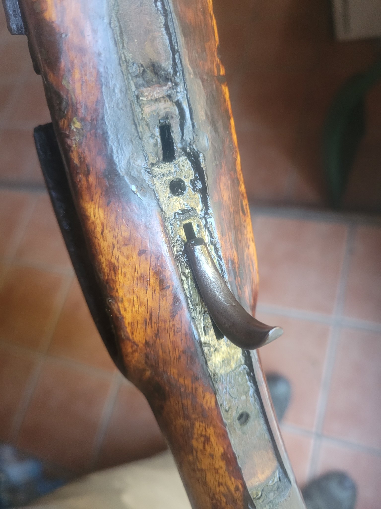

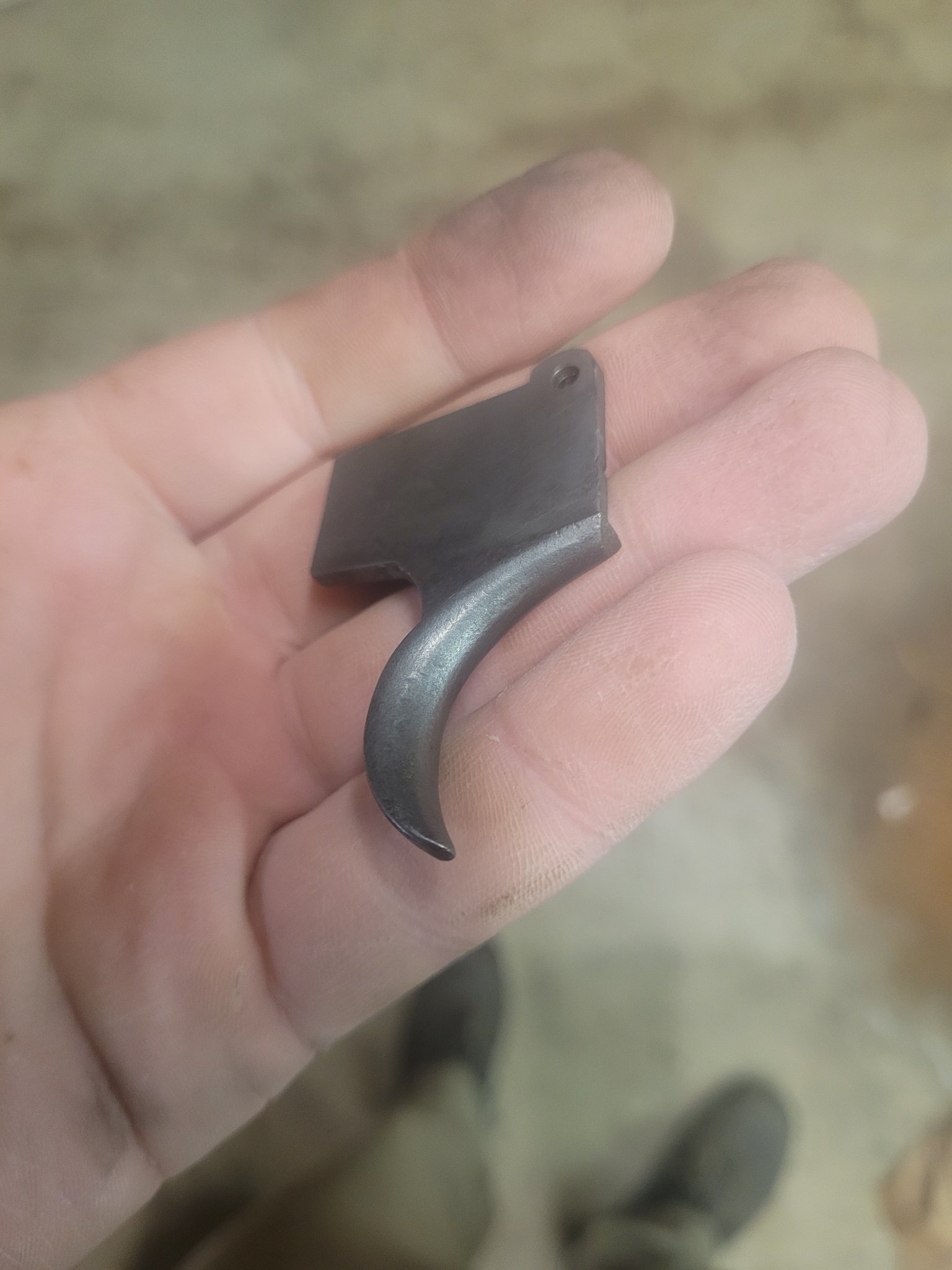

    I am working on an East India Musket I brought back from Afghanistan. It is basically a Brown Bess that was made in percussion vs flintlock.

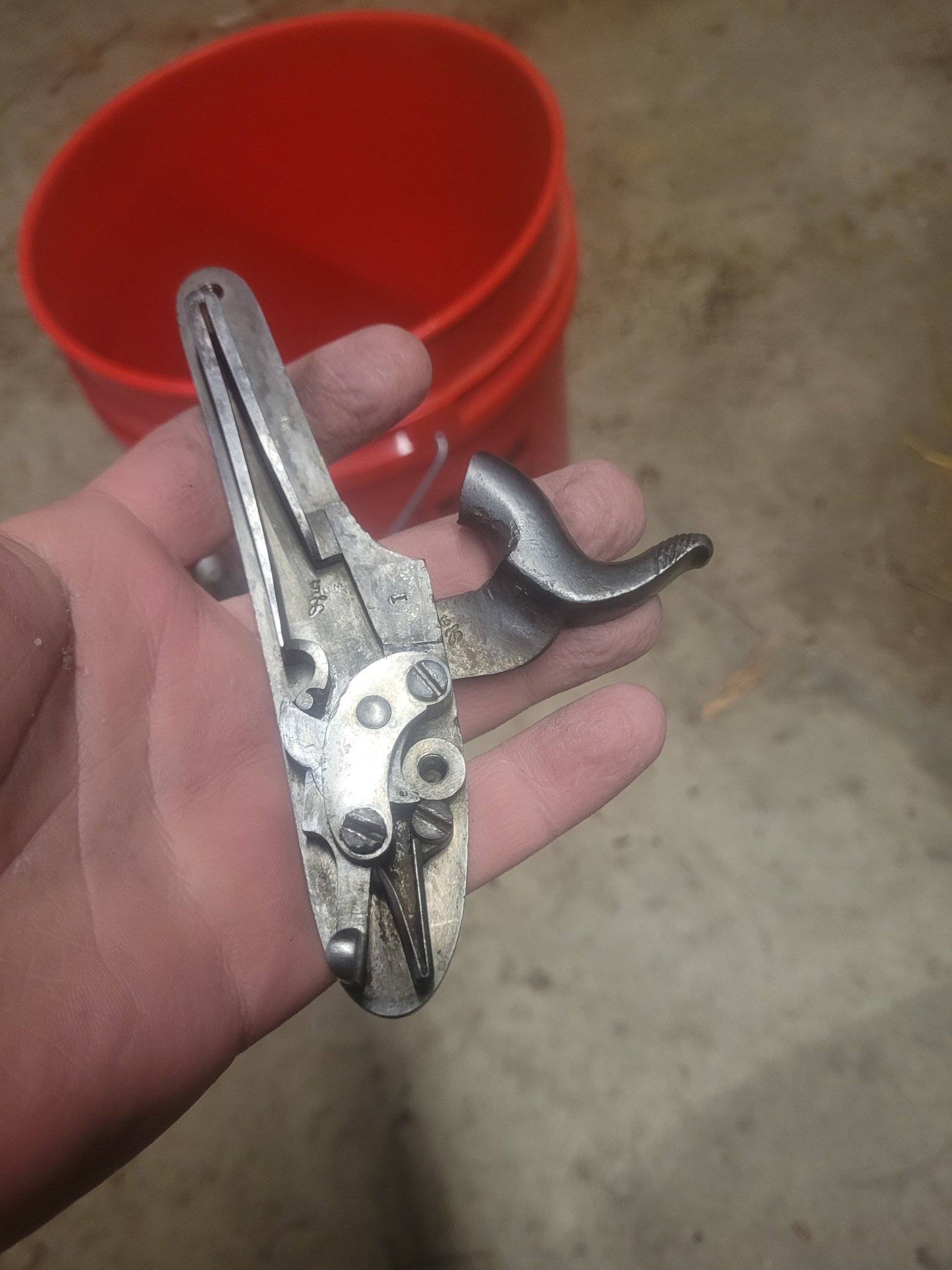

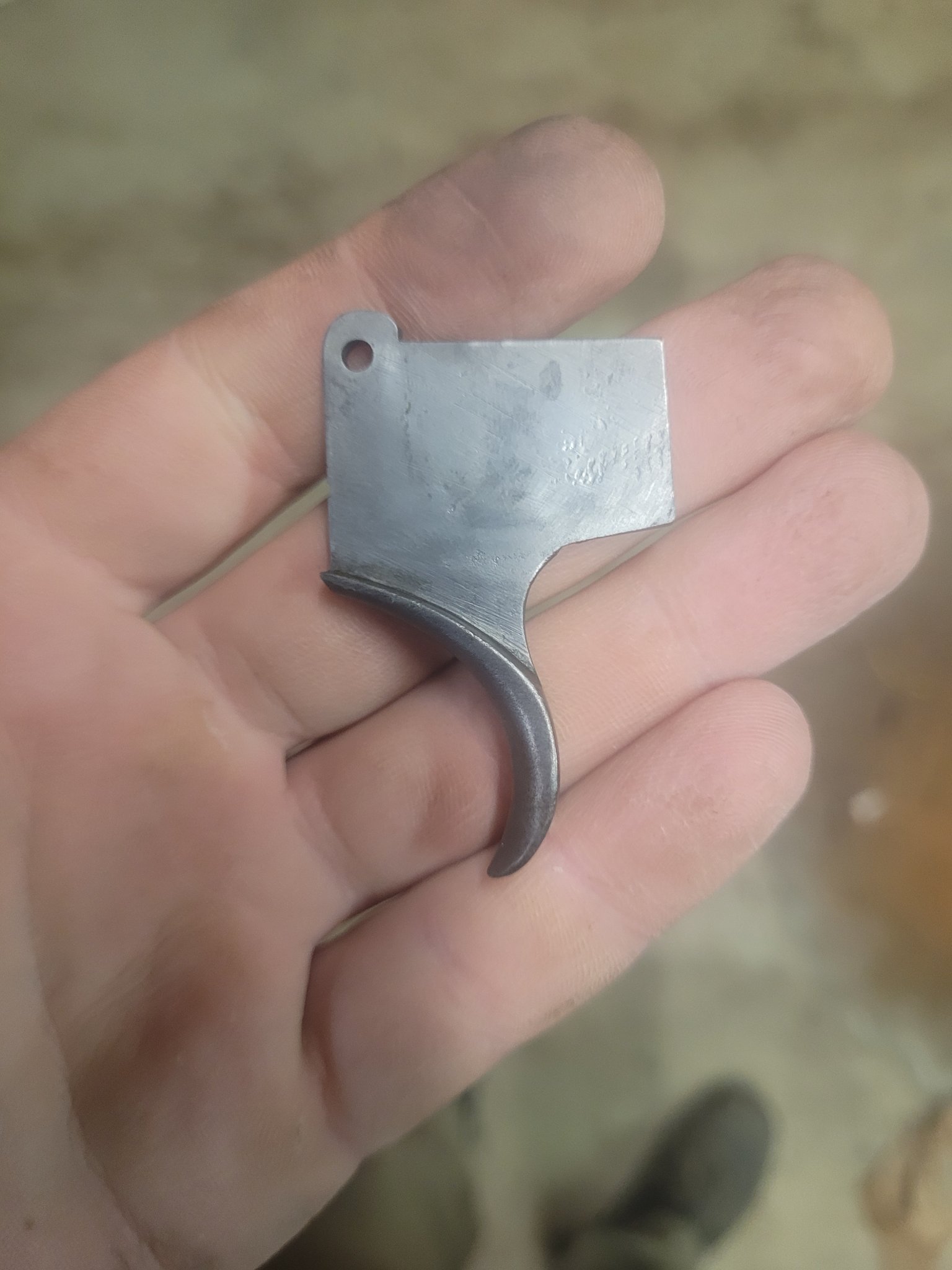

    I am trying to get the last piece out which is the trigger pack that sits under the trigger guard assembly. I can get it to wiggle but it refuses to come out. A pic is attached below. Am I missing another of those stupid little pins somewhere that they used to hold things in the stock?

    More likely the piece is just stuck in there with old oil and swelled wood. Very carefully clean the wood and metal. Sharp chisel or even a sharpened wood dowel (like a chisel).
    And clean the edges. Then worry it out.
    I don't think it has any horizontal pins onit. Just... crud! And more crud! Fine Indian Crud!
    Cool piece. Keep going!
    Sirhr
    Thanks sirhr.
    I just got it. Screwed the top tang screw back in and used that to push it out.

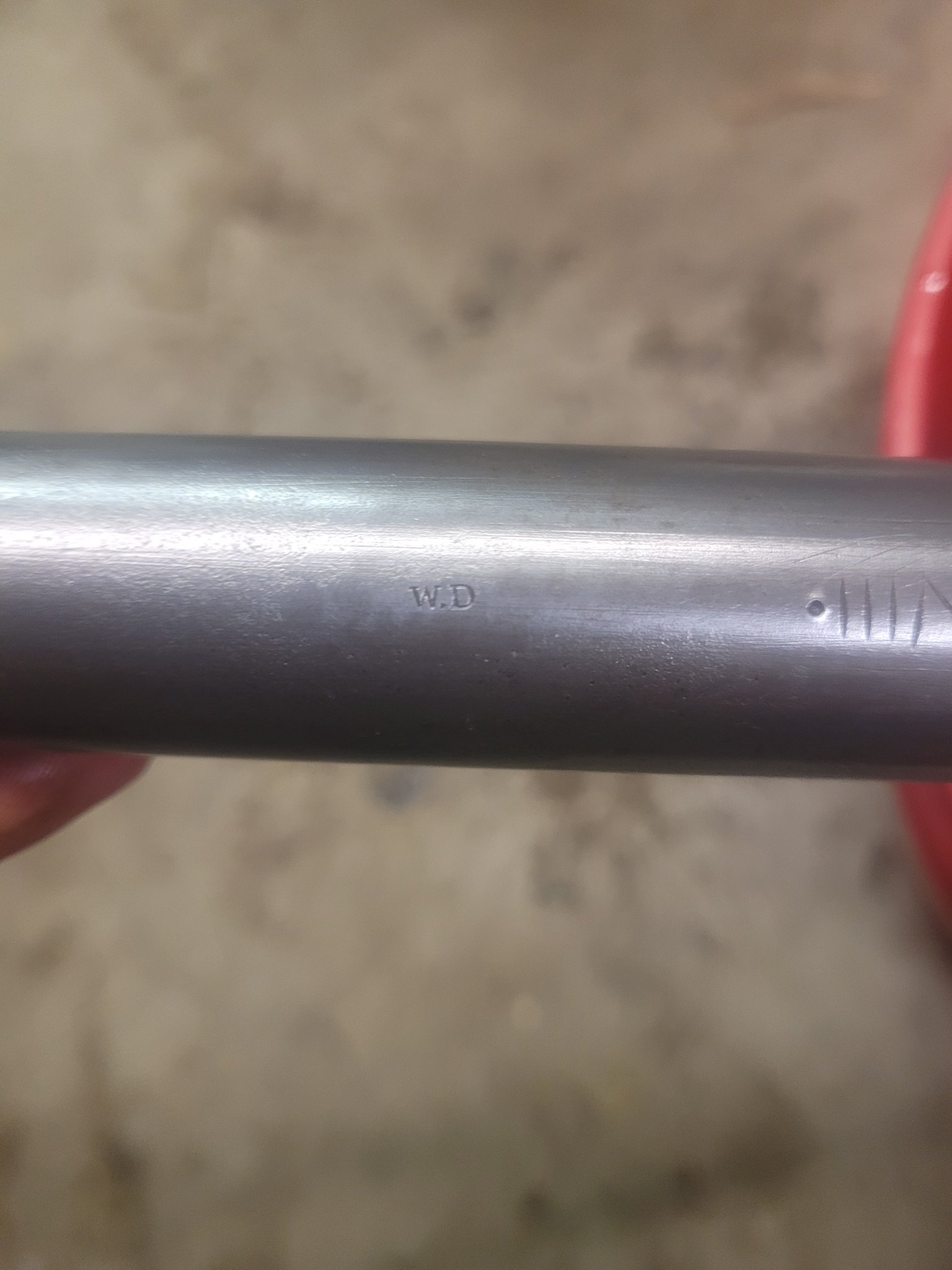

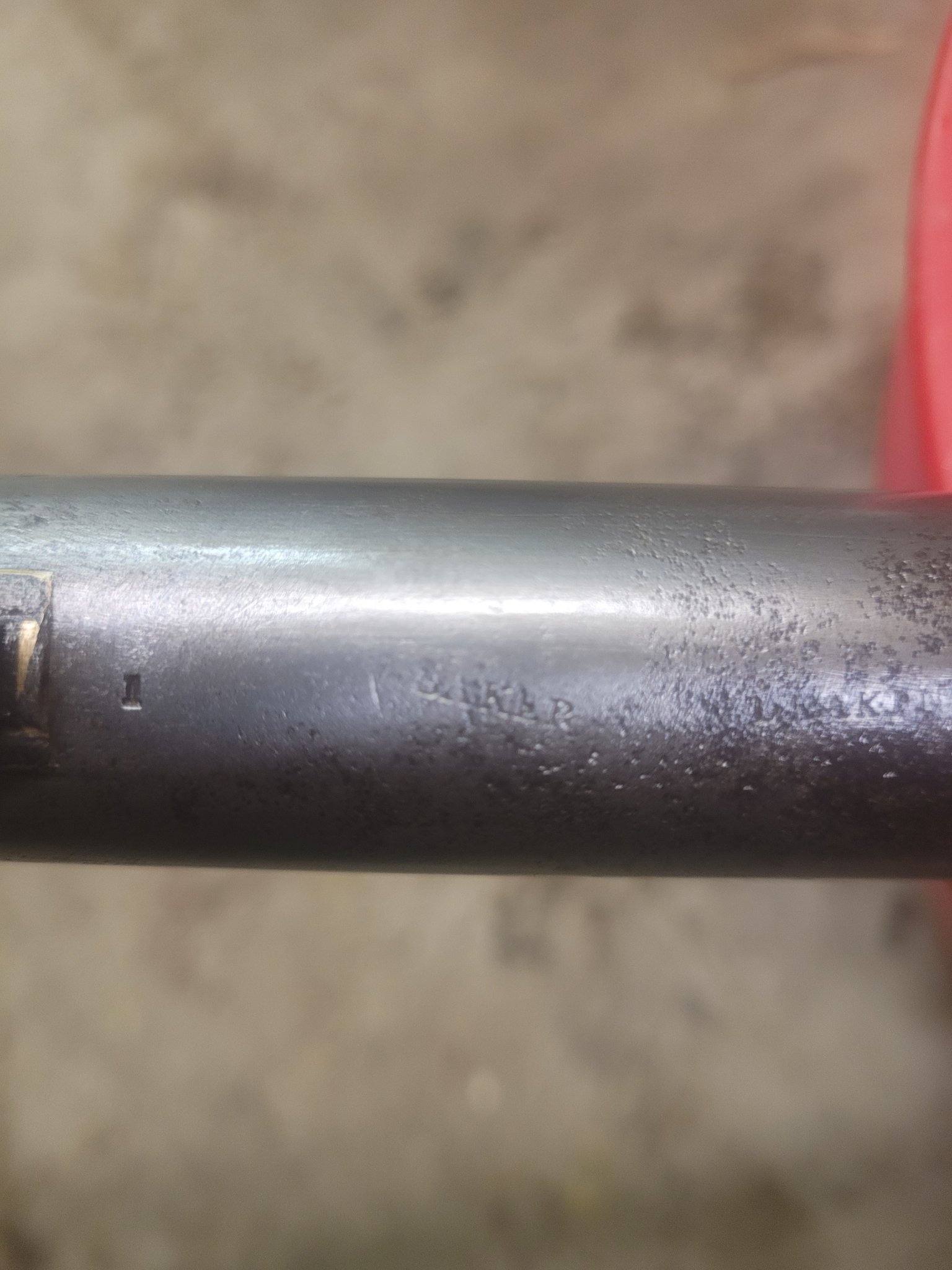

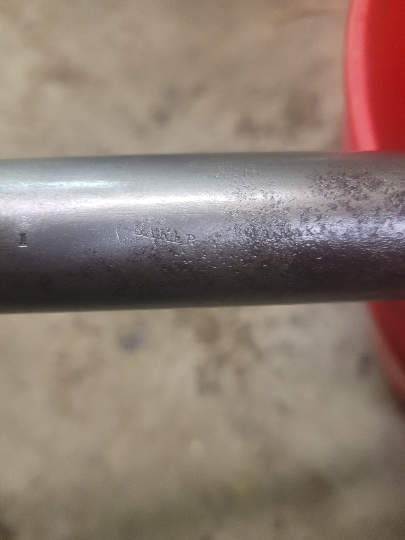

    The stock does have an "E.BAKER" stamp still visible at the toe of the stock.
    Some research indicates that this is an East India Company model F musket.

    There should be a pin which was sometimes under the lock plate if not just a hair below it. No reason to remove the trigger really unless it's broken. Is just leave it on and do what you have to do around it. Steel wool and brasso for the mountings.

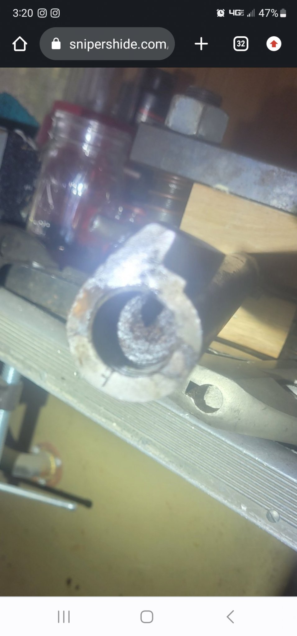

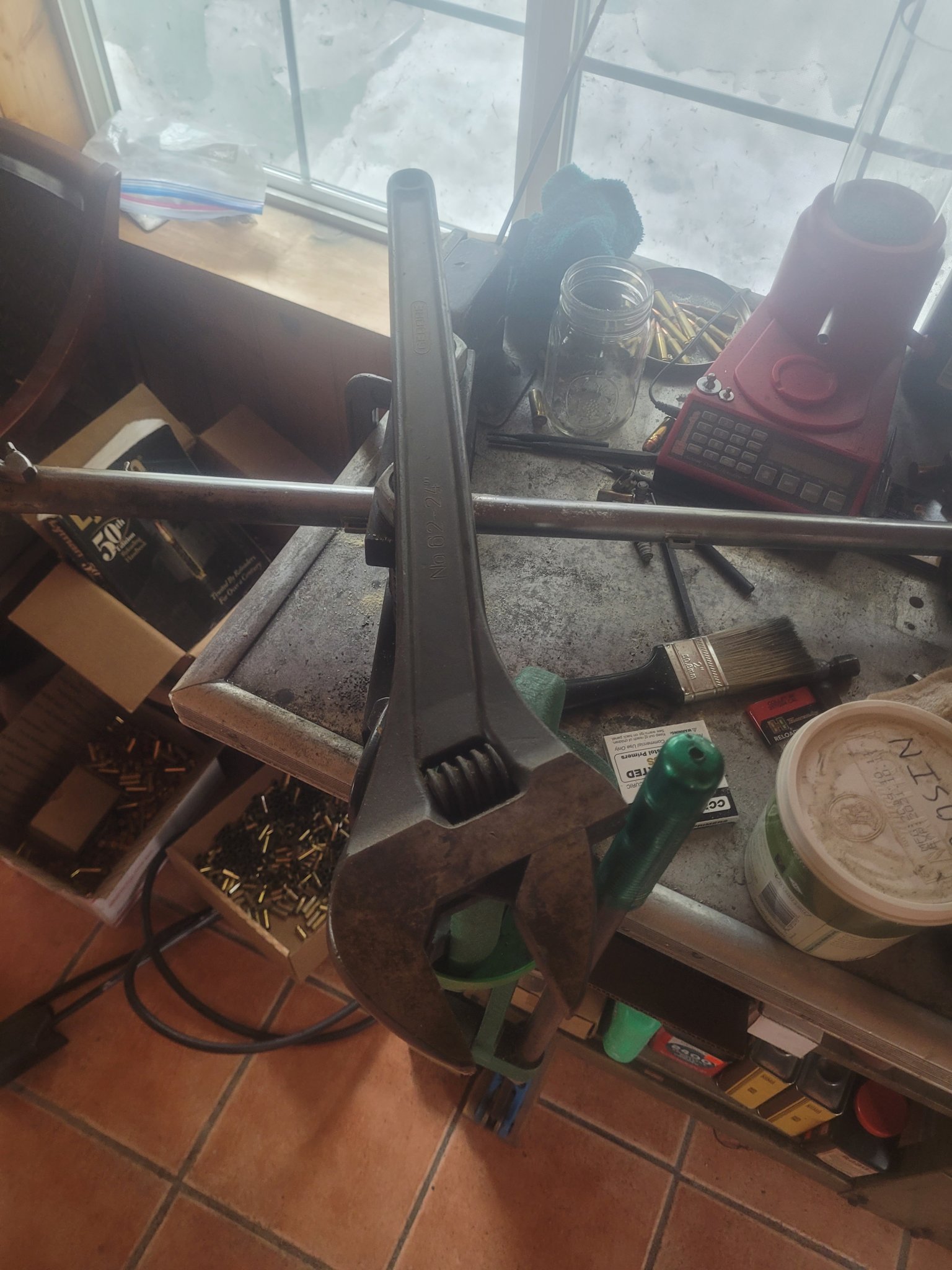

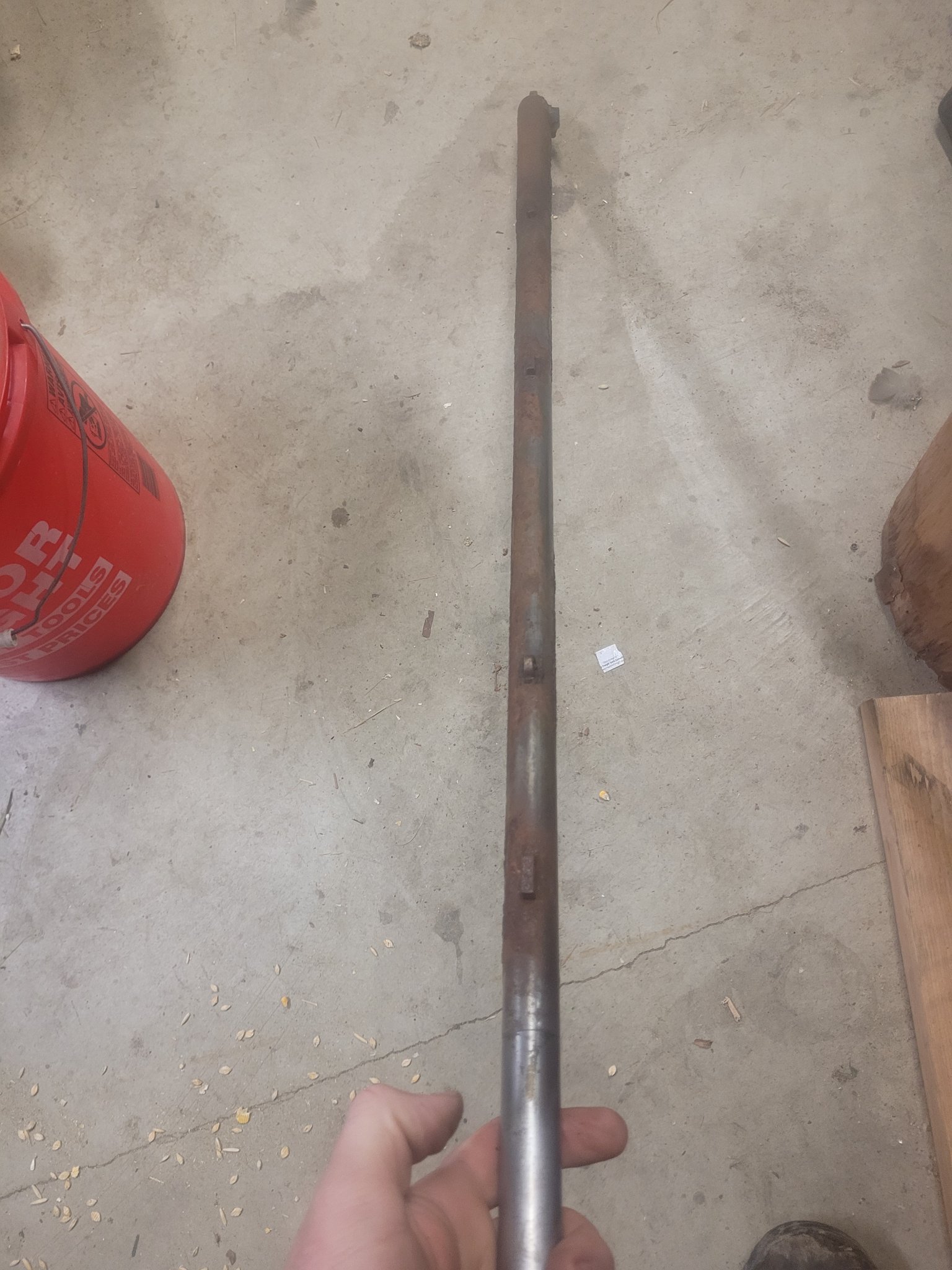

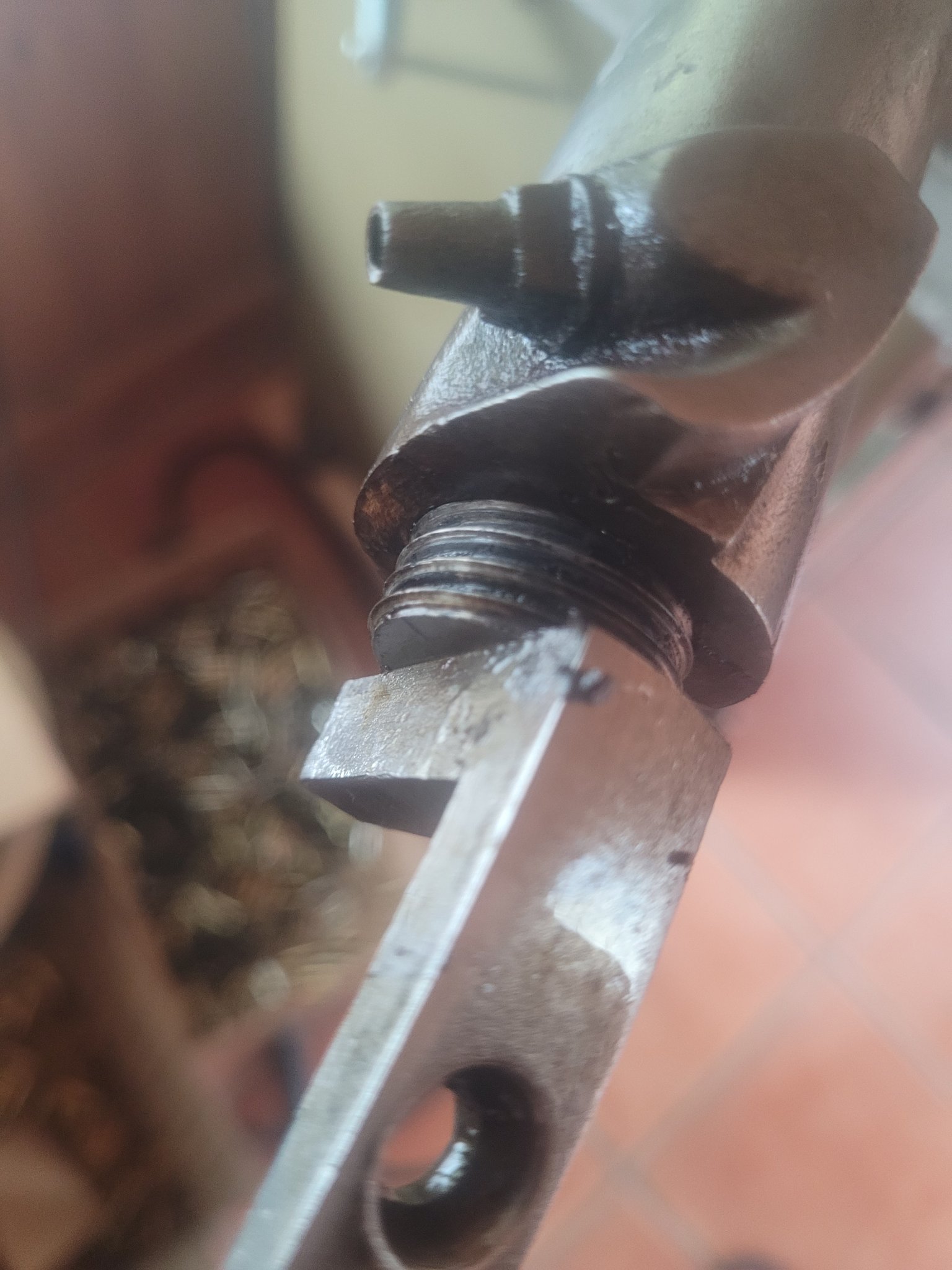

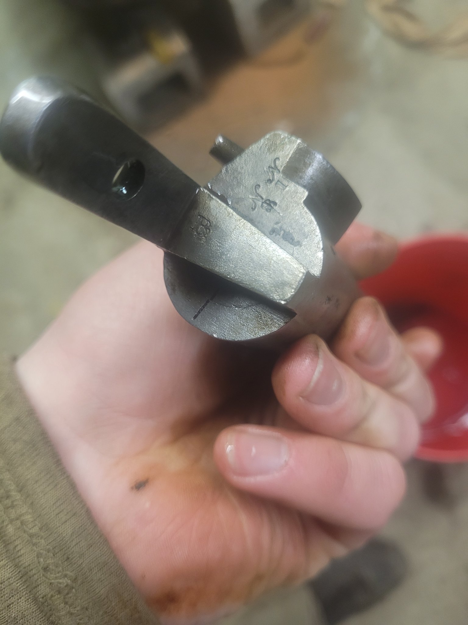

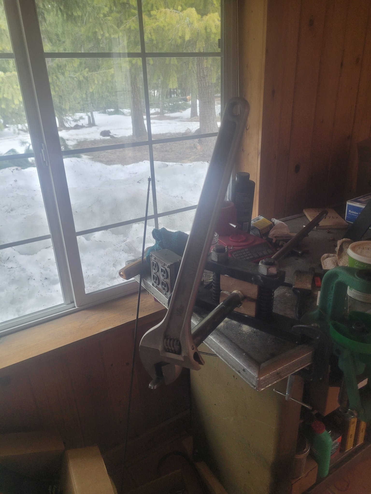

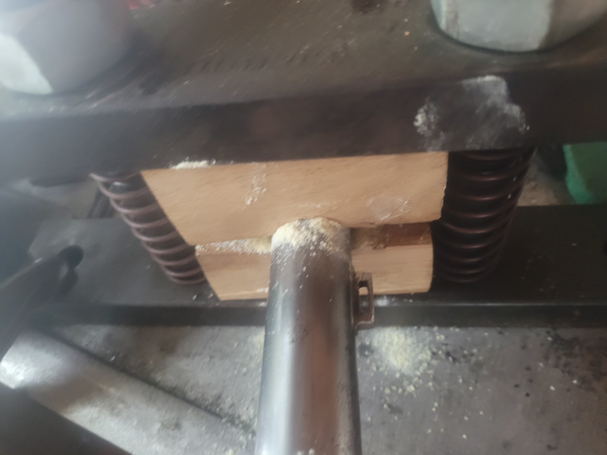

    I would very much like to pull the breechplug as it would make inspecting and cleaning the barrel much easier.
    @buffalowinter
    @sirhrmechanic
    For ideas of how to go about this.

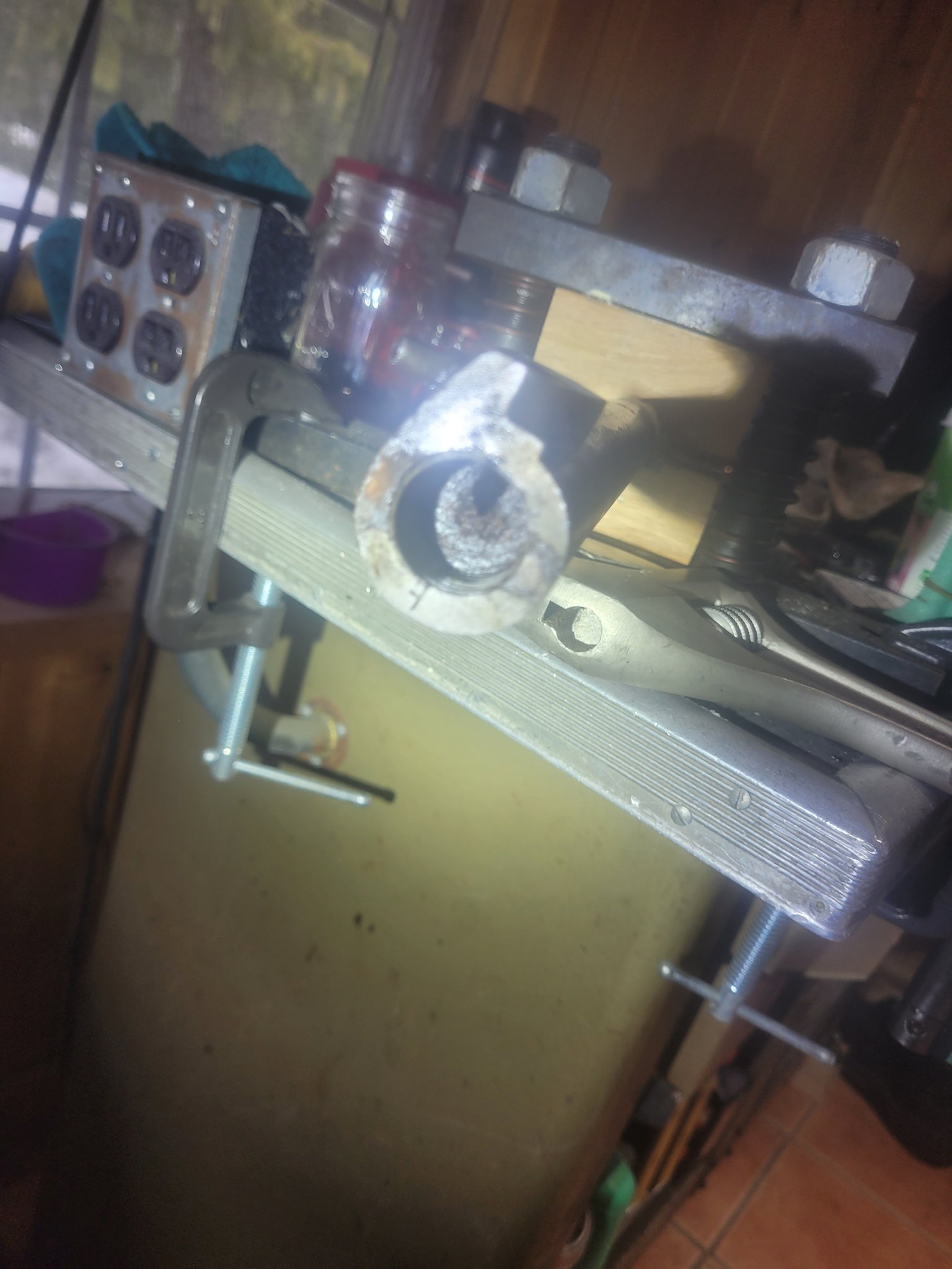

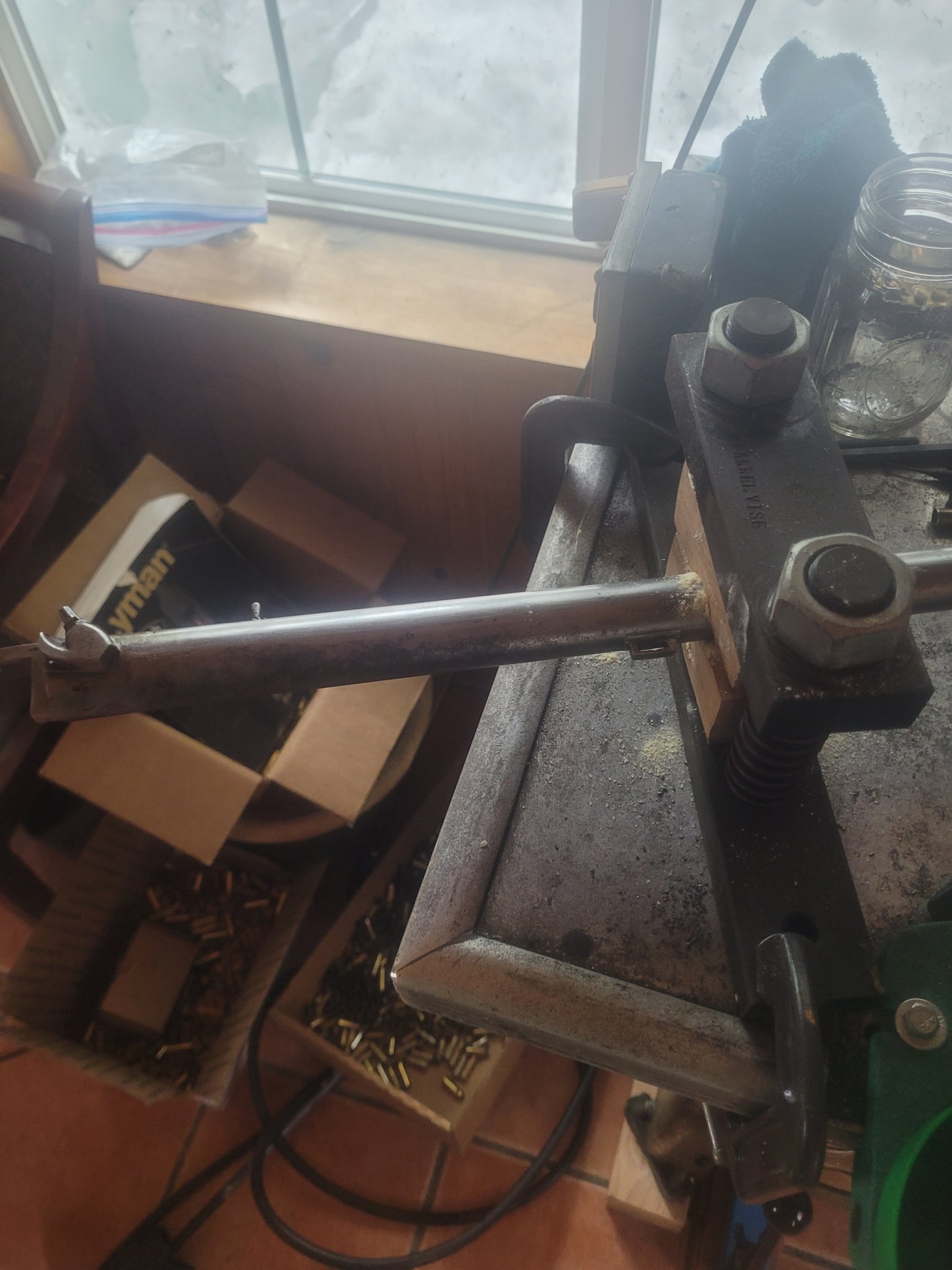

    Heat and penetrating oil then barrel vise and wrench or something different?

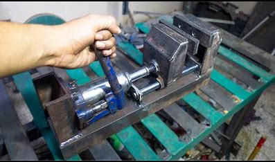

    First just give it a shot with a vise and wrench, you might get lucky. Then soak in kroil or penetrating oil for a day and try again. Use a sturdy vise and wrench with an extended breaker bar. I use a piece of water pipe slipped over the wrench...like two feet long. Then try heat. If all else fails, throw it in a freezer overnight and try again....I actually had this work last week after all other attempts failed. I guess if its a brown bess it has a round barrel. You will need a barrel vise to grip that round barrel. You will need to coat the barrel with rosin or use lead sheets between the barrel and barrel clamps. You can make the clamps out of two pieces of wood. You can use a bottle jack to make a vise. There are two methods for applying pressure...just steady constant pressure is best when using a long breaker bar. Filing that, take a short bar, about 8", and try sharp impact with a hammer. The bad news is, with an older piece like this, the parts may have succumbed to chemical welding and will never come apart.

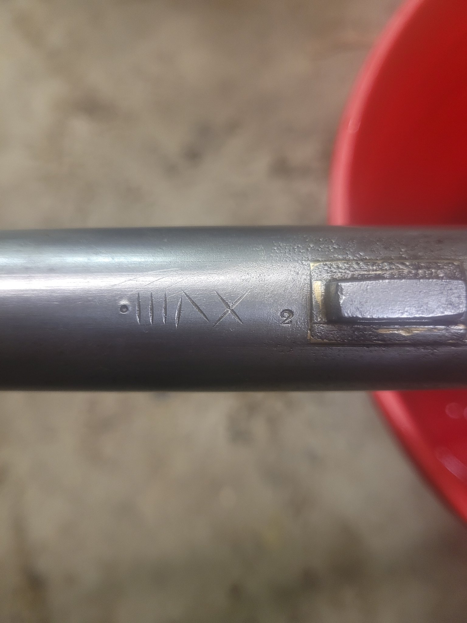

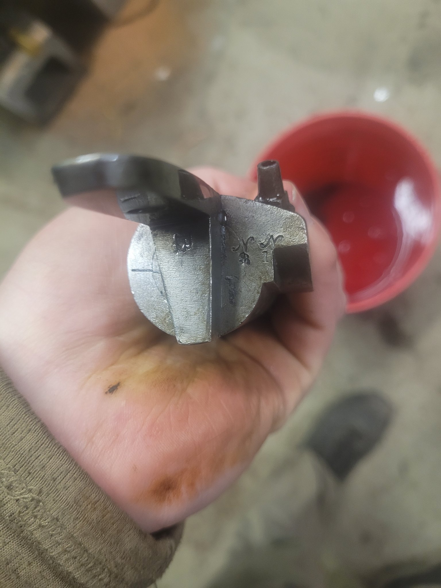

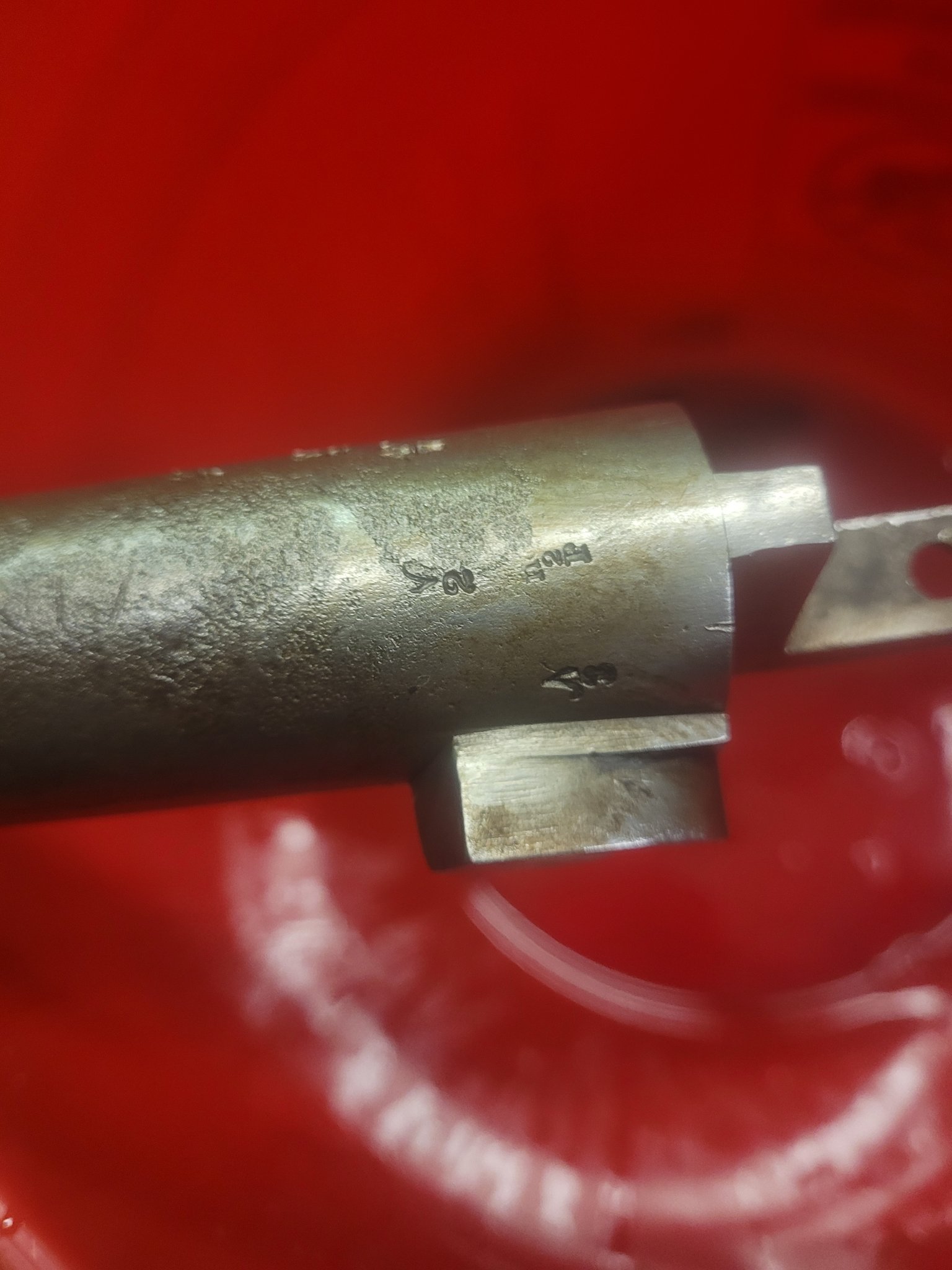

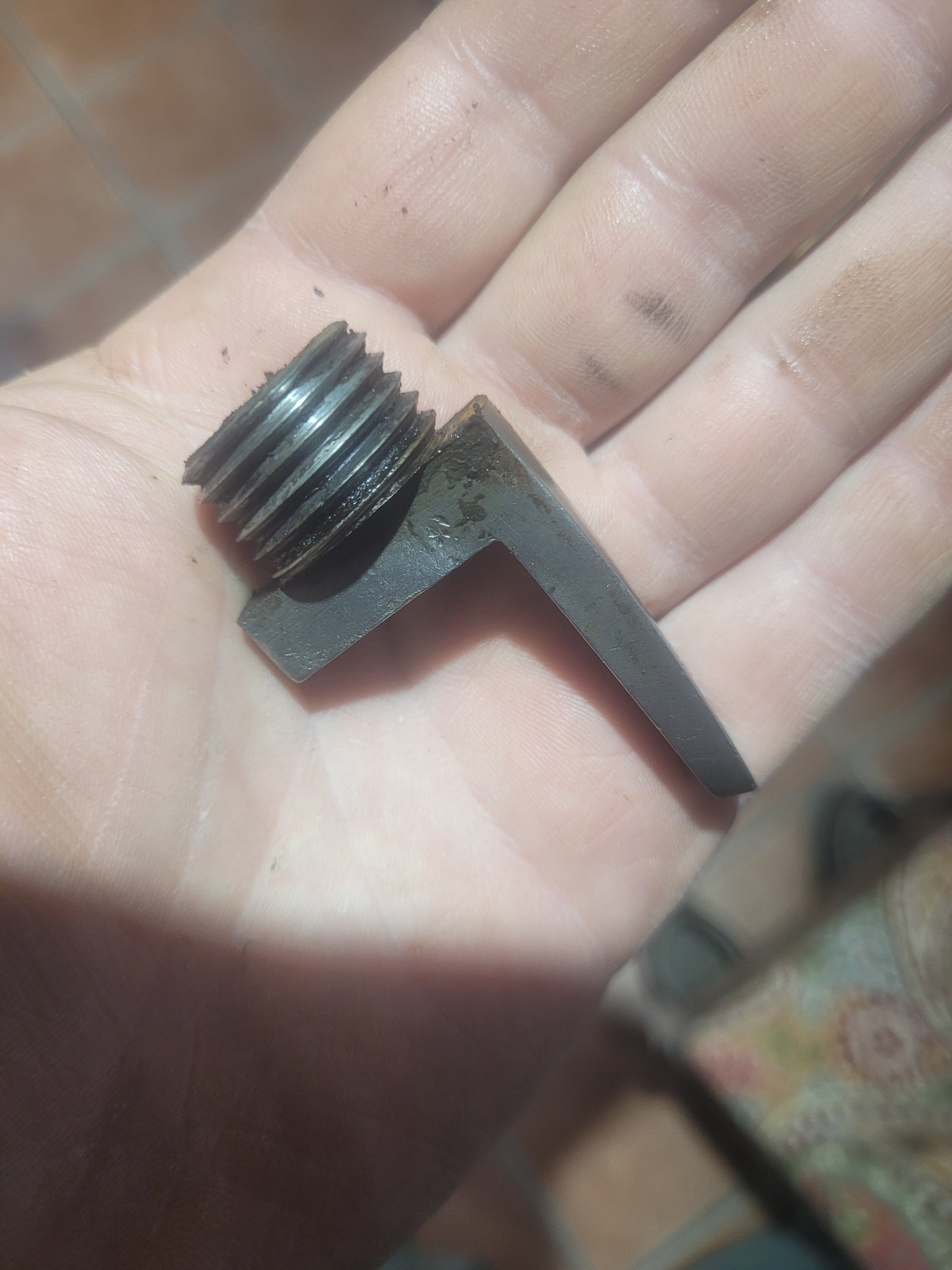

    Thanks. I thought those would be the steps but have never pulled an old plug like this before. This one looks to have been coated in tallow for 2 centuries though and is in remarkably good shape.
    Applied a bit of heat to get it warm.
    And then.....

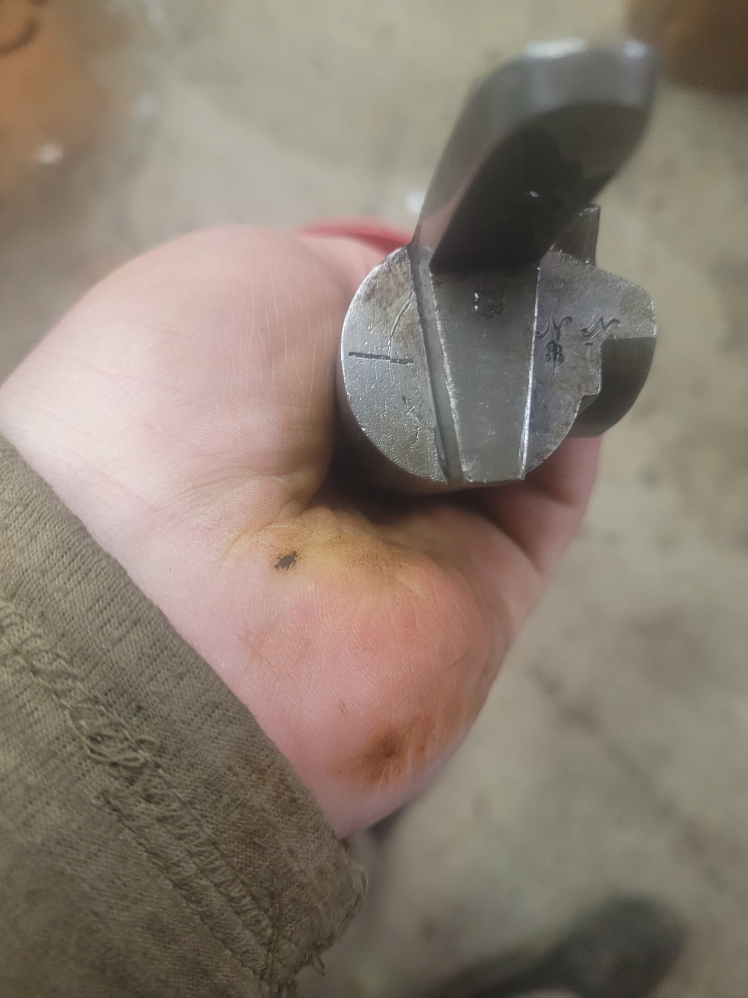

    Presto, plug popped right out. Still had grease on the threads from almost 200 years ago.

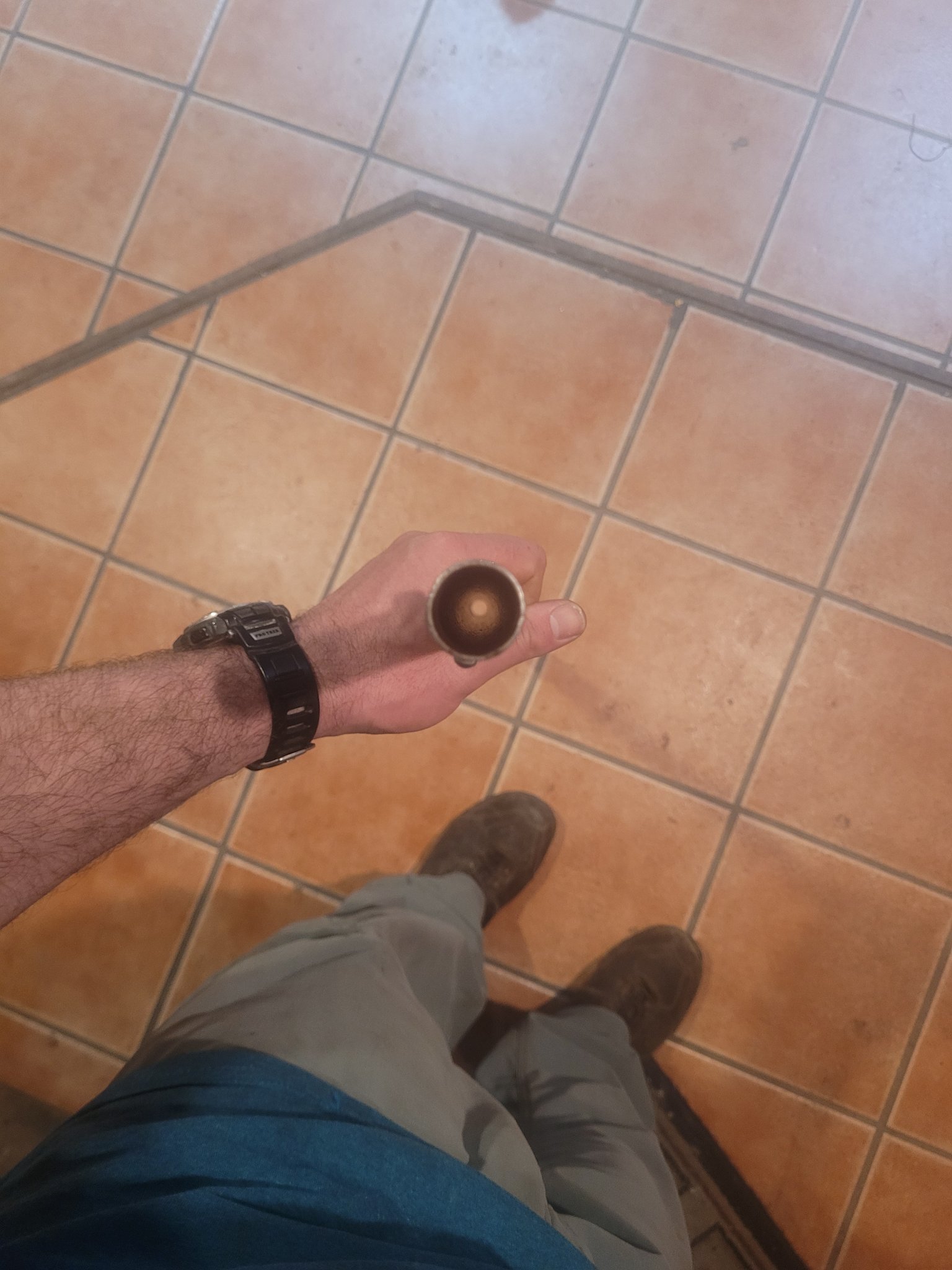

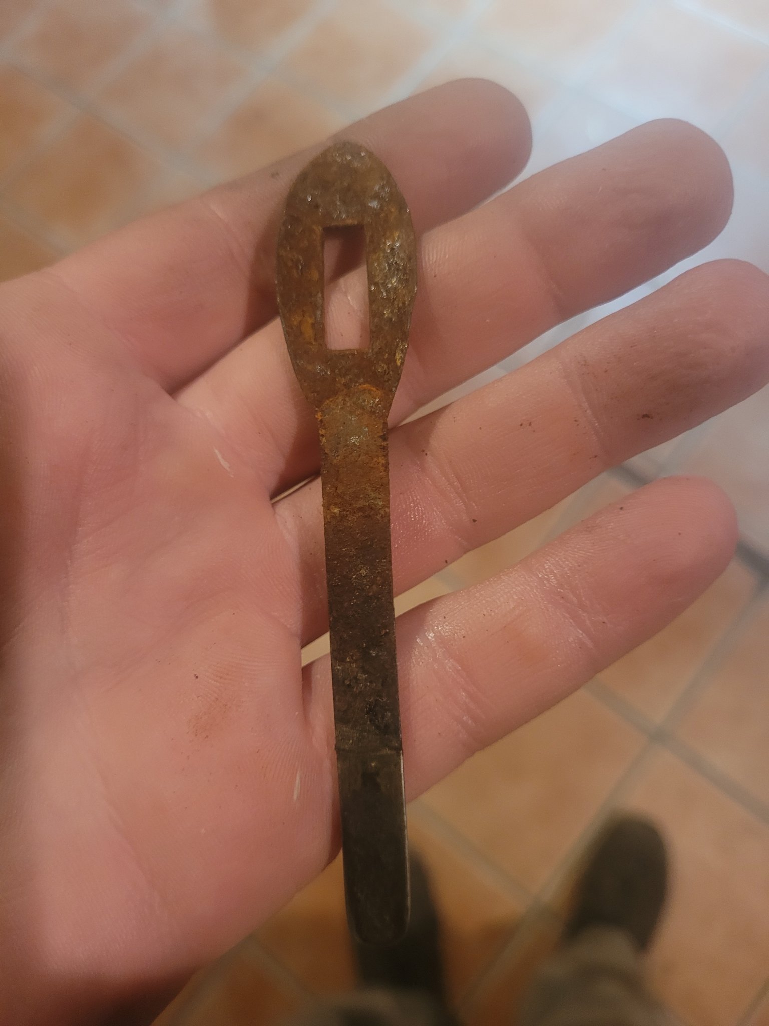

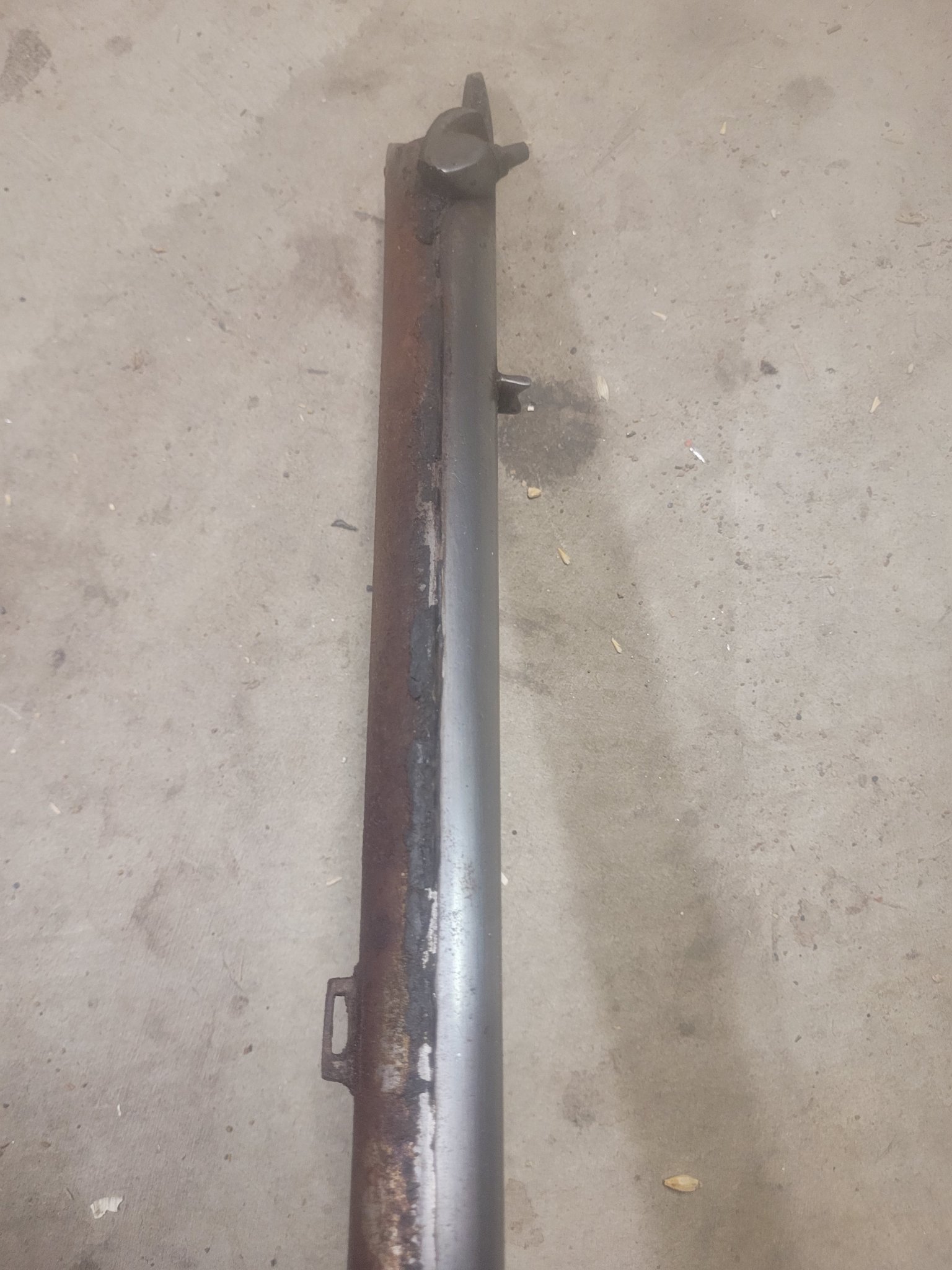

    Glad I popped the plug out. There is a rust/fouling plug in the bottom of the barrel.

    It was a calculated risk. The amount of tallow type goo I was scraping off the breech and the condition of the underlying metal led me to believe that the goo in the threads would still be soft.

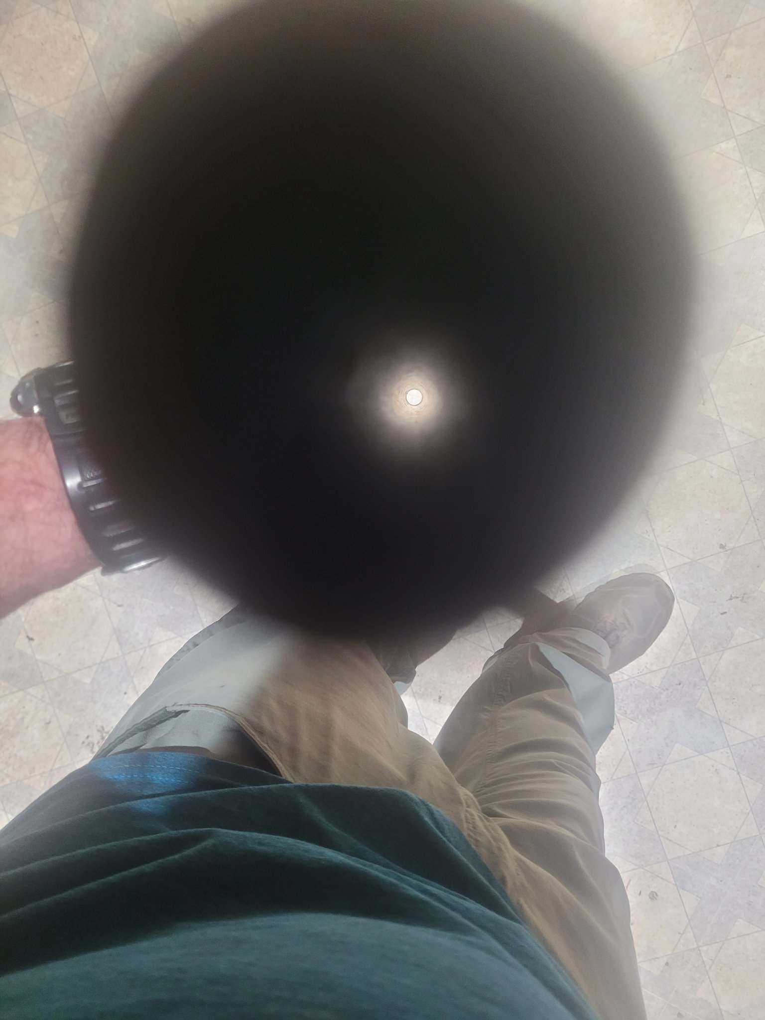

    The bore has rust in it but it appears to be in remarkably good shape for it's age and spending 200 years in India/Pakistan/Afghanistan.
    I plan to plug the bore and soak in CLR for several hours. Then brush and I'll get a truly good look.
    But it is shootable. I can tell that right now.
