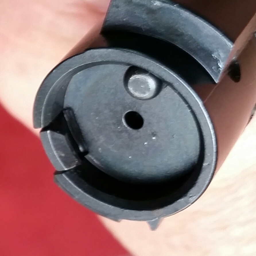

I found a picture of the extractor modification which changes the ejection angle
