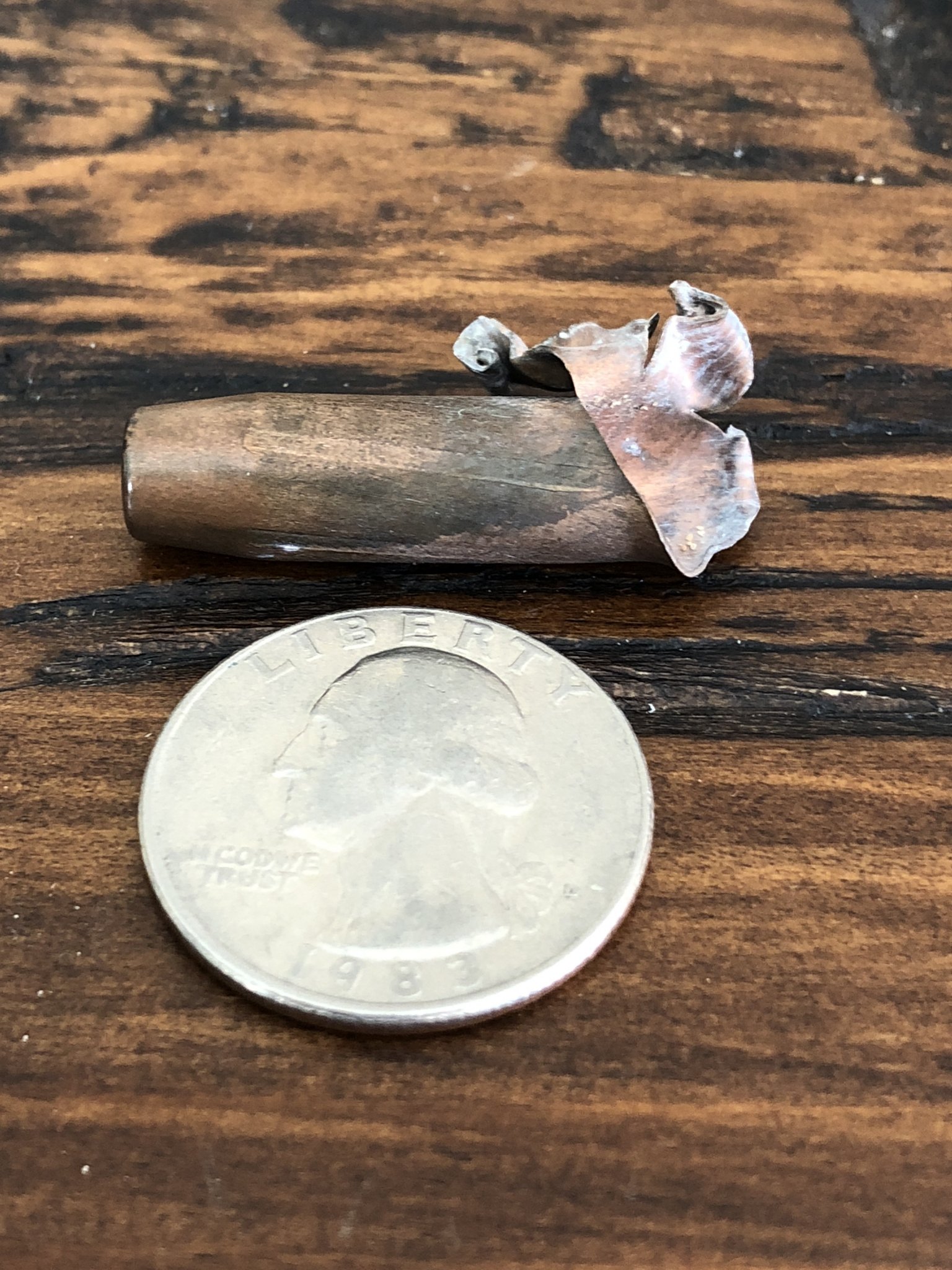

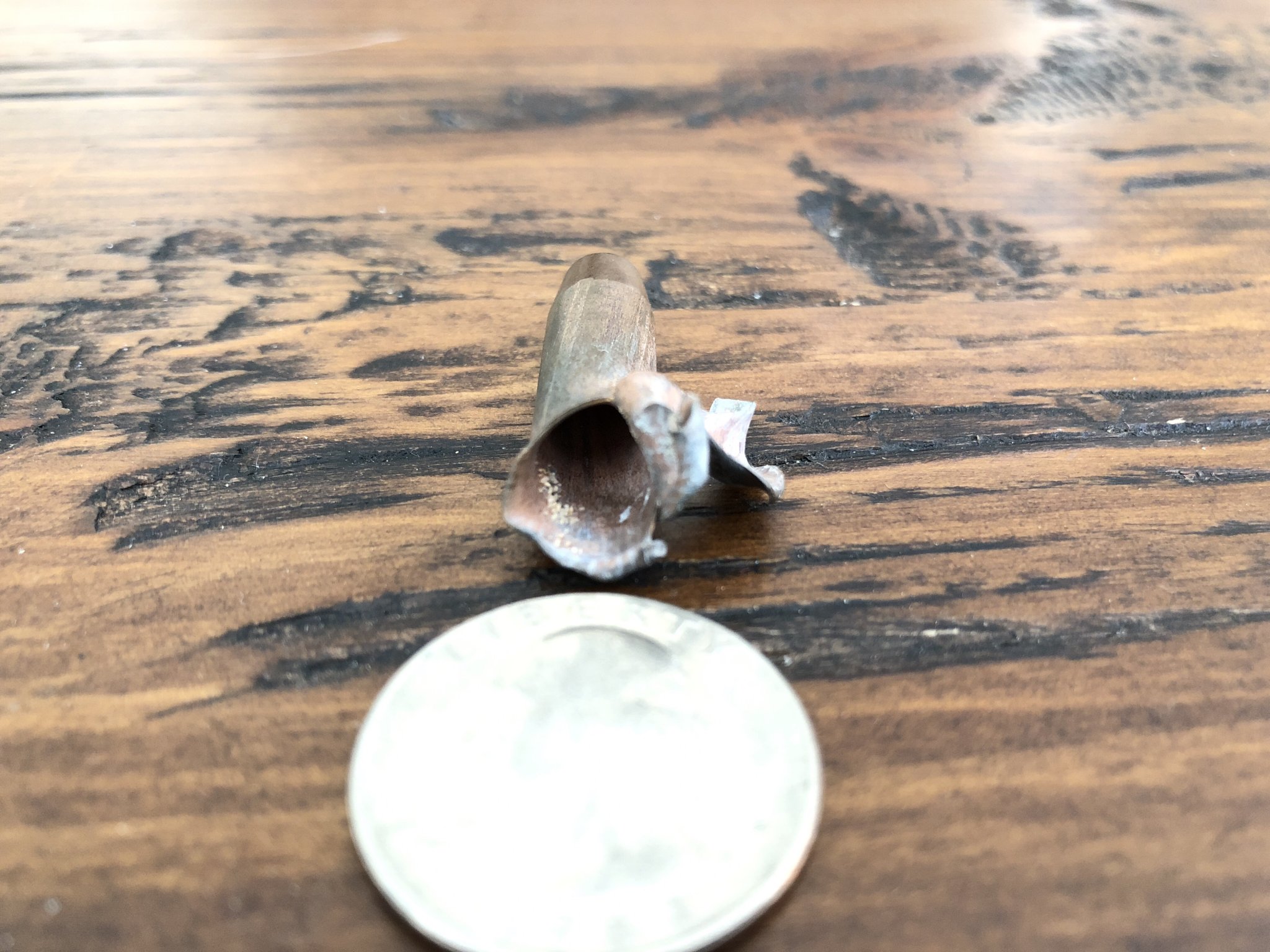

Below is a 338/285 ELD M. Very little damage to the bullet, but the entire core slipped out. This is a near transonic hit into damp sand. A Sierra smk does the opposite at this distance, and you could practically load them again. Not saying the Sierra is a good hunting bullet, because it isn’t. The 140/147 eld’s act exactly the same as the 285.

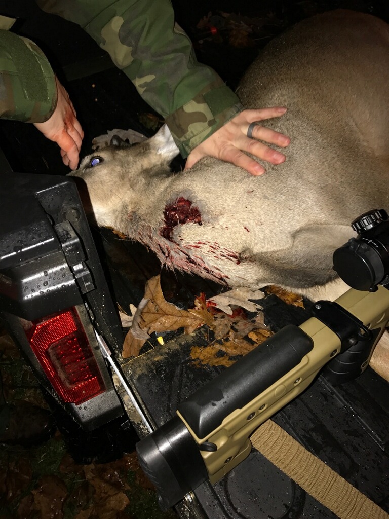

I am shooting a 147 ELD-M handload at 2858fps.
This past fall I shot a doe at 632 yards cold bore from a tree stand. The deer literally dropped dead where it was standing. The deer was broadside to me with right shoulder facing me. The bullet entered right shoulder and blew completely threw deer and exited. Since I am shooting suppressed I was able to hear the impact and it is a VERY unique sound. If you hunt suppressed you know what I mean .
The bullet at 632 yards is moving at 2038 fps and is delivering 1355 ft lbs of energy.
Attached is the exit wound, please let me know if picture is showing.
Nice! LoL, I love that youre deer hunting with an AI. that's awesome.
