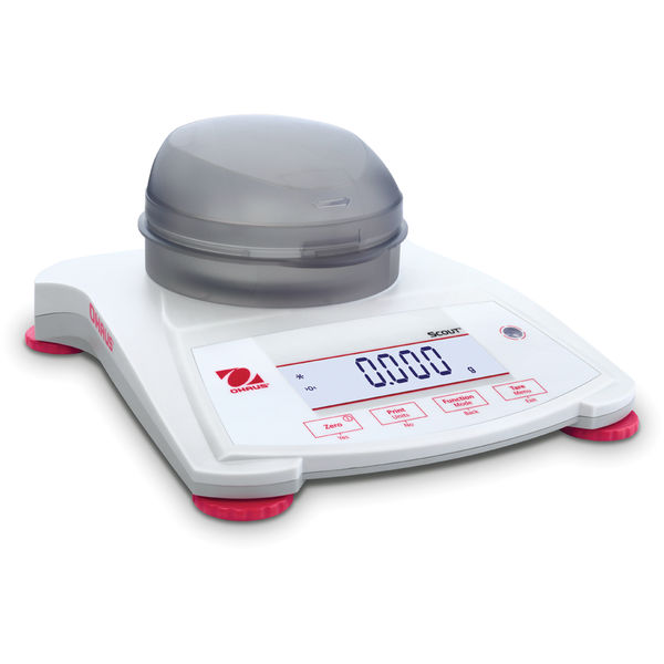

    For just checking the RCBS Lite I can recommend the Ohaus SPX123. It's the same resolution, and more importantly, just as fast to weigh and stabalize as an A&D120fx, but it's smaller and simpler, almost like someone planned its footprint for use on a reloading bench.
    Think they're aimed at use in the jewlery and/or pharmacutical industry. Not exactly cheap, but not too bad.
    This scale is not the same accuracy as the AnD. It has an overall 95% accuracy of 0.08 to 0.09 grains. The Fx-120 is ~.06 to .07 gr.
    Having used both, pragmatically, they seem the same to me, both are fast and will weigh to a single kernel. Obviously if one is planning on getting an Autotrickler down the road, the FX120 is a no brainer.
    But, if one is just looking for a good general purpose scale for their bench, I stand by my opinion that the little Ohaus is better for that (though I found mine for significantly less than they typically go for, costs being nearly the same I'd go FX120).

    I see its battery powered. How long do the batteries last? When the batteries get low does the device let you know or does it start weighing erratically?
    I have know idea, it has a power cord too and I've only run it on 120V (I'm not really sure why it even has the option to run it off the batteries?).
    I didn’t see the 120v power cord in the description or photos that I was looking at. Good to know. I picked up the A&D fx120I that was in the exchange a couple days ago that should be here tomorrow or I would have tried the Ohaus you recommended.
