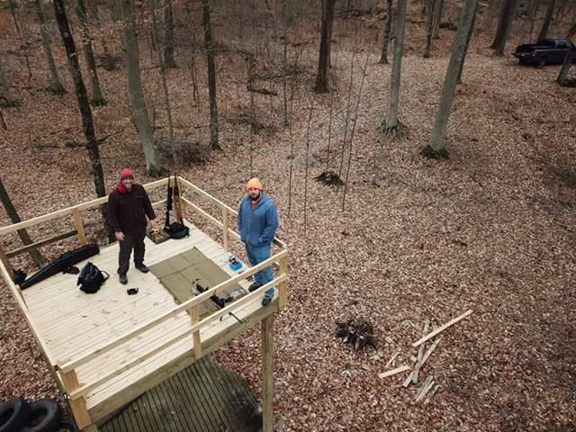

I have a 10' x 10' platform 11' high. Used 16' 6x6 posts, one in each corner. Can easily accomidate 3 shooters. It was very wobbly until i added 2x6 cross members from ground level to platform, one on each side. Very happy with it.
Best pic i have on my tablet
Looks good. We were thinking 8x12. Any reason that wouldn't work? We would be laying pointing in the 8 foot direction. 12 wide would be good for 3 maybe 4 shooters.

I think 8ft would be a little tight. Figure most people are 6ftish and when prone the gun sticks out a good 2ft.
Eight feet might be long enough. The best way to tell would be to lay down behind your rifle. Have someone mark where your Bipod feet are and where your feet are and see what kind of length that is. You probably don’t want to be shooting with your feet hanging off the edge.
As said before, diagonal braces will add strength and rigidity. Remember, triangles are strong. Also, add a small lip all around it. It doesn’t have to be huge. 2”x3” or even 2”x2” will work to load the Bipod against as well as keeping Your brass or other stuff from rolling off the edge.

We did some measurements and found that 8ft was just barely enough. 3ft wide per-person is ok as long as you're always shooting the same direction. However, we will likely have targets from 10 o'clock to 3 o'clock. In the end we decided to 'go big or go home' and it will be 10x12, 11-12 ft off the ground, and 6x6 posts running up to a roof. Hope to get the posts set and maybe some framing done this weekend.

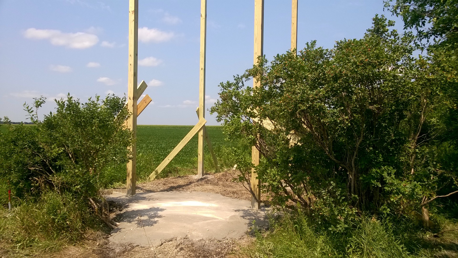

We got the poles up last weekend.
As soon as the concrete truck showed up, it started to rain. Poured a half inch while we did it. I was soaked and covered in mud and concrete. Complete shit-show, but we got it done. Had extra concrete, so we scraped it into a impromptu pad of sorts. Should have had a form set up for that, but we didn't expect to have that much extra.

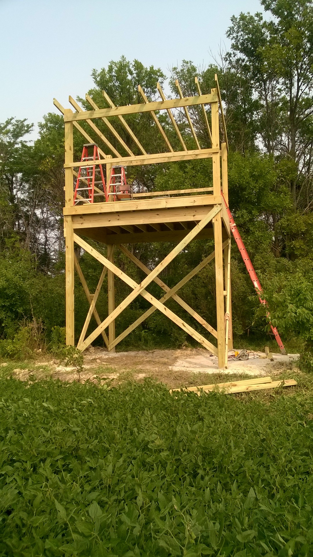

I can post a list for reference, but I suspect you could do it a lot cheaper than we are. We got 24' 6x6 poles to go all the way to the roof. Ours is also a bit over-engineered, but we tend to not mess around. It's going to be all of $1500, maybe more.

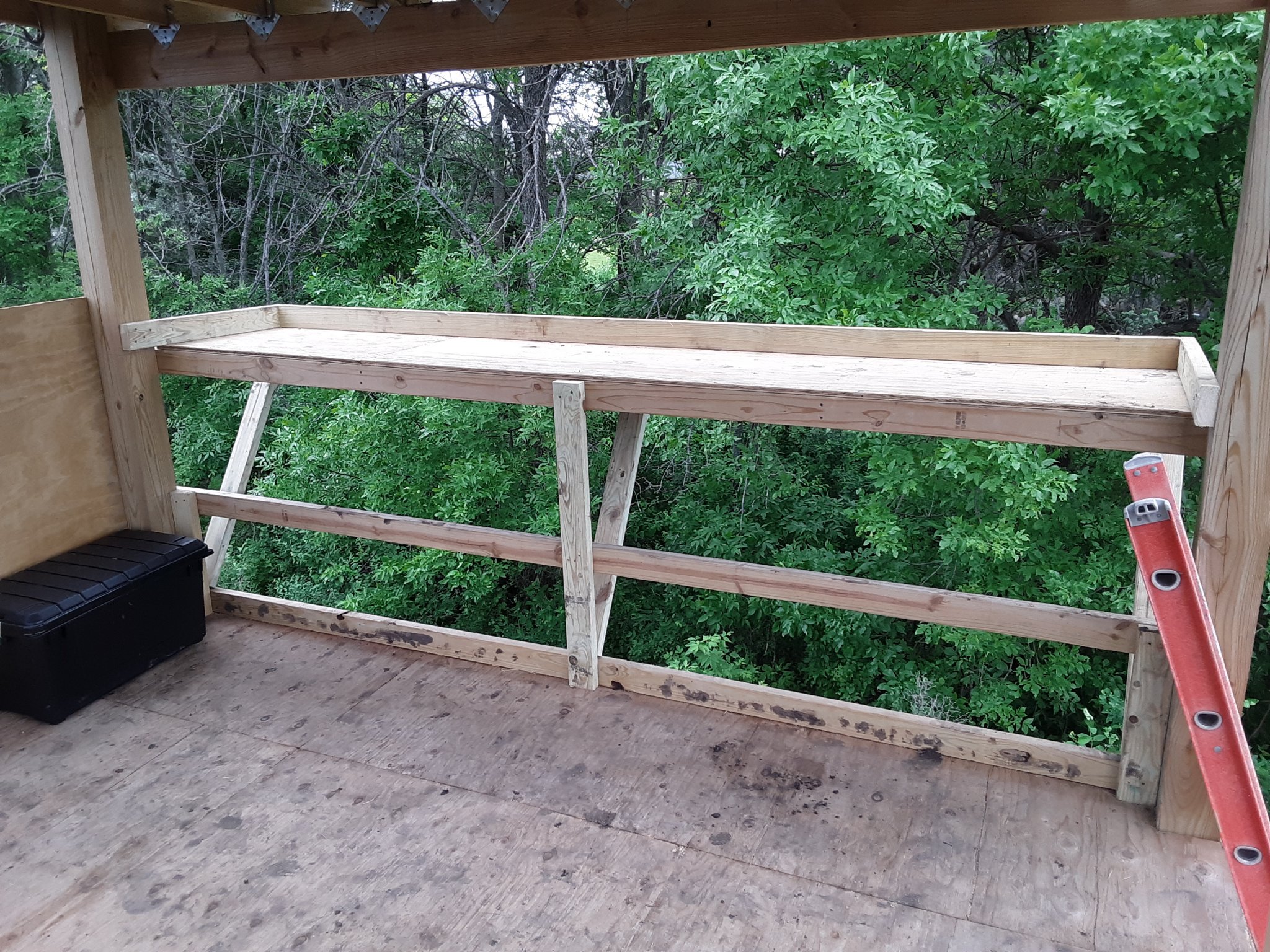

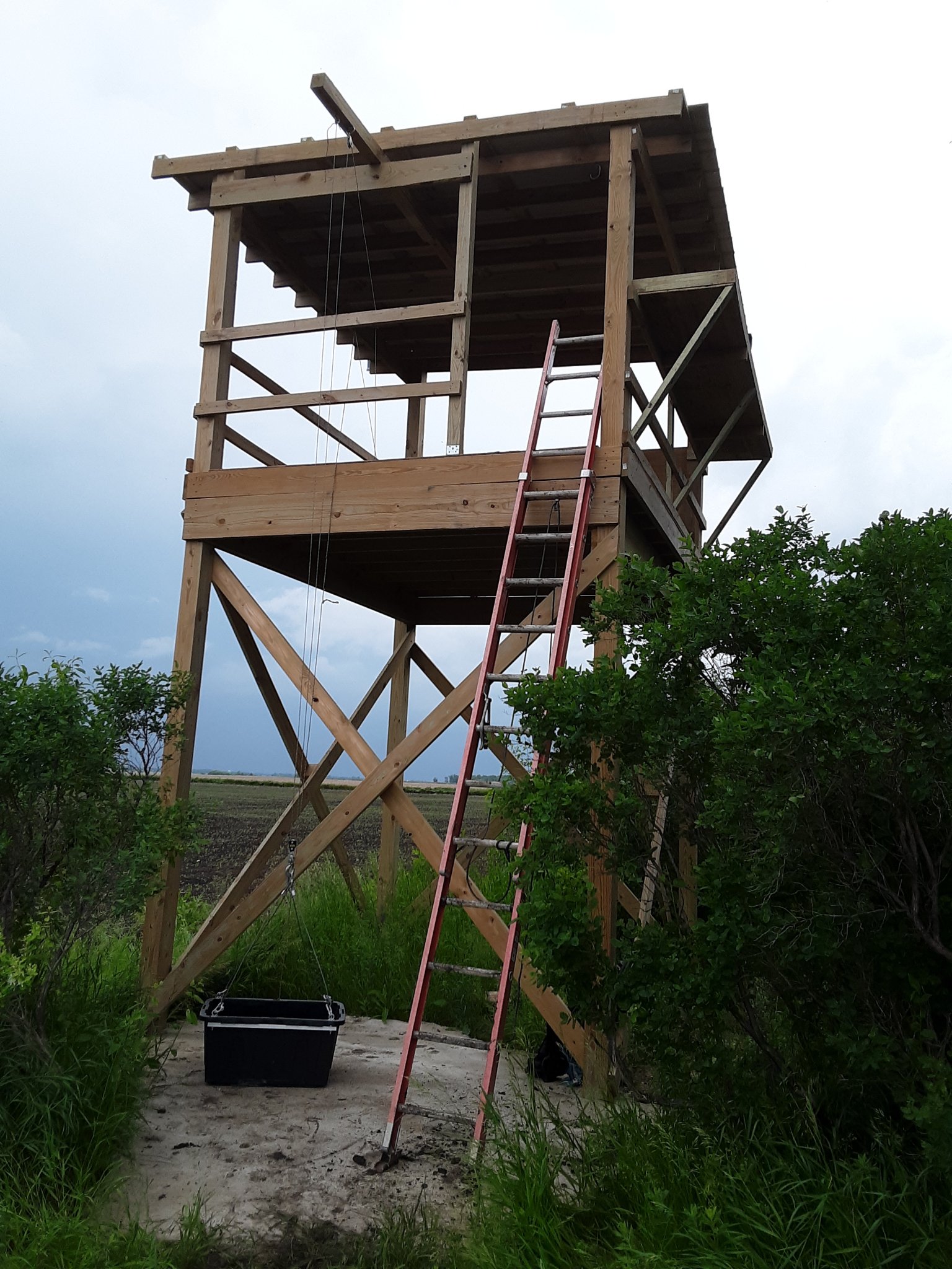

We got it pretty much done this weekend.
Just need to get the steel for the roof and a few other odds and ends.
I'll say that the 2x6 cross-members (the X's) make a huge difference. Without those, it was pretty wobbly when moving around on the platform.

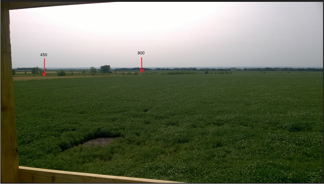

So far we have targets as 200, 325, 450, 500 and 800 yards. We plan on adding a few more, including one at nearly 1200.

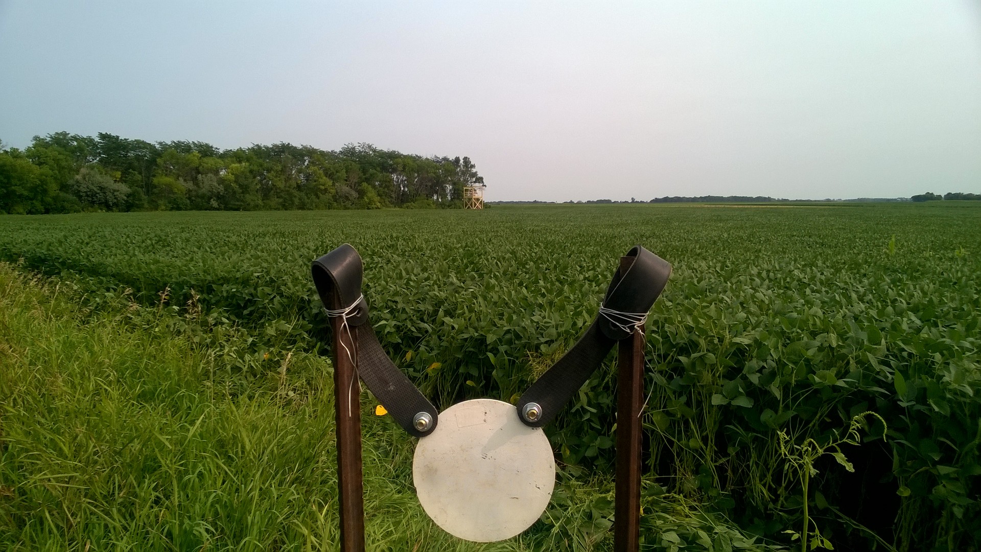

Here's our 8 inch at 200 yards for checking zero:
And here's a view from the top with a couple of targets pointed out:

Stairs have been discussed, and would be very handy. That gear elevator I rigged up is just ok. You can't really haul a rifle up with it.
