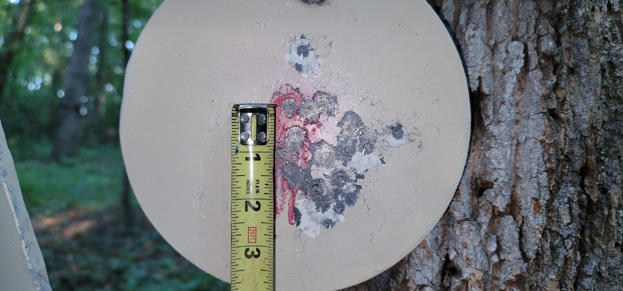

I have had good results with Tenex and Match 252 yard 20 shot group.
