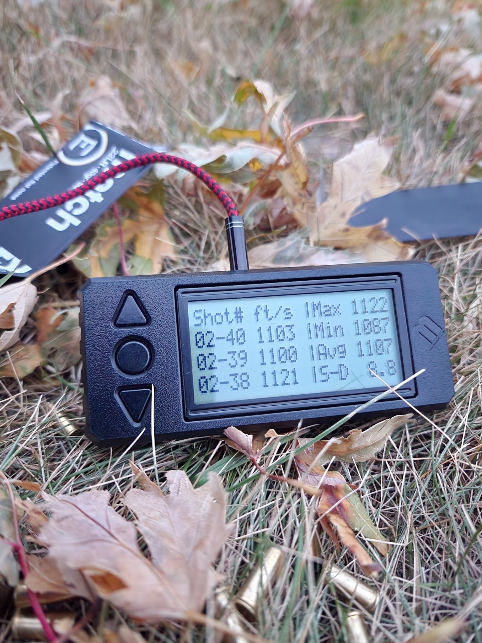

    I've had Eley Match with an ES of 26 fps for 50 shots that produced extremely good results at 200 yards
    and the next brick delivered chronied an ES of 60 fps and spit vertical strays.

    I had so much variation in lot quality between consecutive orders, I contacted Eley.
    Asked about their method of lot grading. The explanation is statistical sampling.
    A small portion of each batch is tested from fixtured barrels in a tunnel.
    The results from the small sample determines how the run is labeled.
    I asked about the sample sizes and confidence levels used in the determination,
    and was informed that it was proprietary information not to be disclosed.
    Considering I had Eley Match and Eley Team that produced better results/chrony numbers than Tenex,
    it tells me that the method of statistical sampling being used, may not be as effective as advertised.
    Or....ammo degradation occurs during shipping from England to the US.
    Those cargo containers aren't insulated and it's a long trip by freighter across the Atlantic.
    And the drivers/handlers at FedEx and UPS aren't the most careful folks with packages.

    This. I tested SK Biathlon the other day. 10 shots = SD 7. Next 10 shots from same box, same rifle, same conditions = SD 17.
