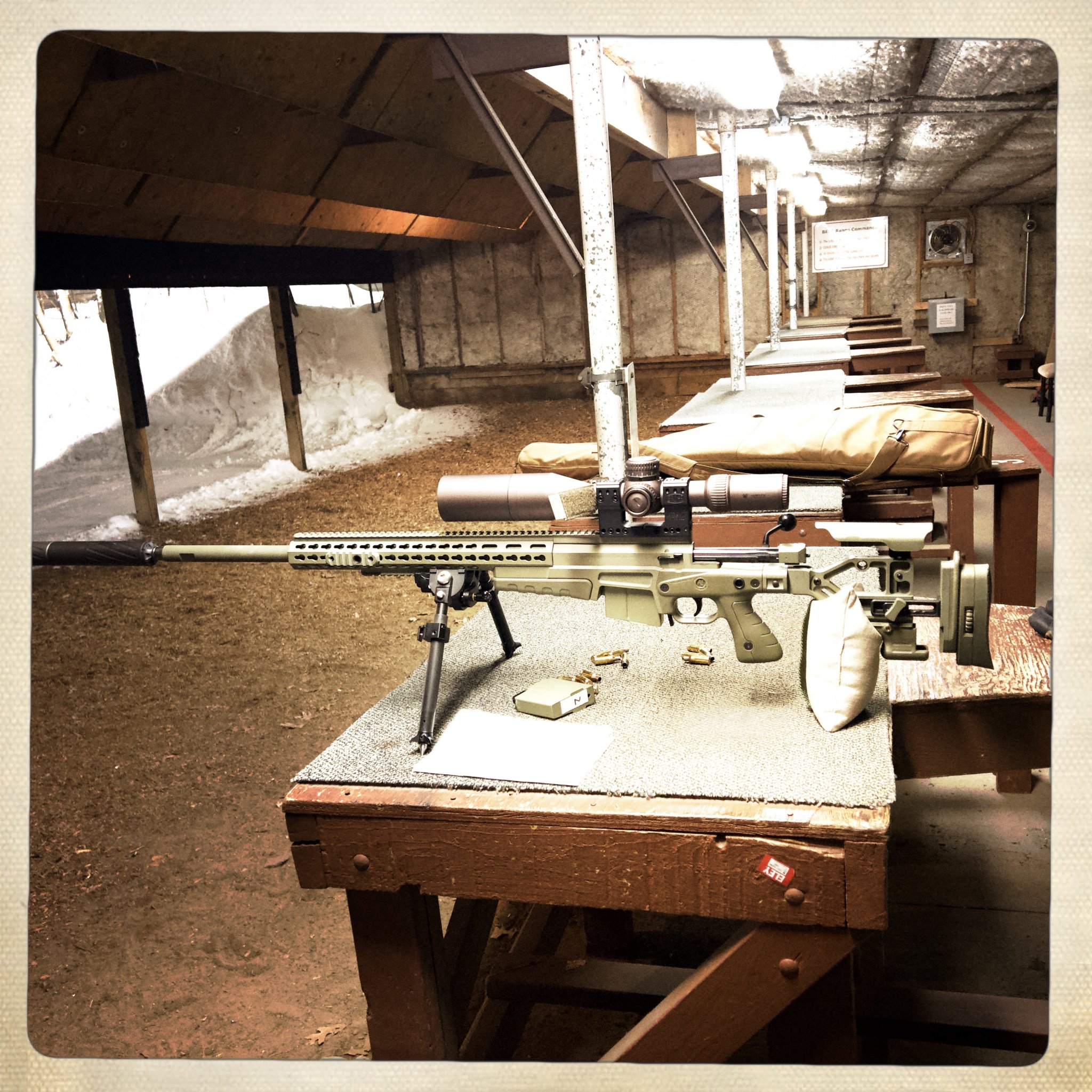

Also, one other thing to be aware of is because the EI mounts to the front of your stock/chassis, if you do shoot off benches, said benches need to be long.
Here is my range. You can see why I’m using the LRA here. My EI would be hanging off the front into space.
I’ve got my suppressor cover off for cooldown.

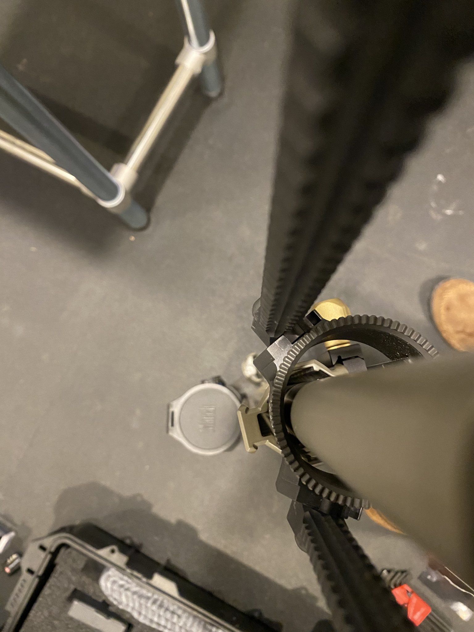

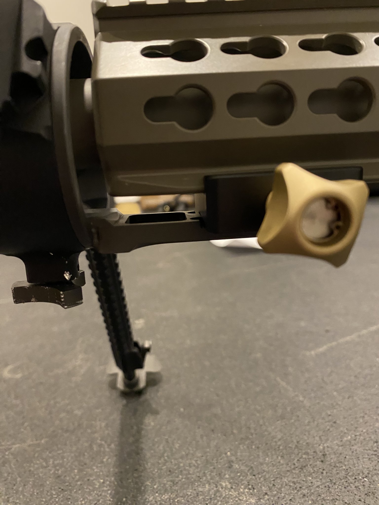

I fixated on this QD anspect and connected the area 419 arca clamp and pic rail attachment to the rail on my axsr (having removed the pic rail that was already there) to gain QD functionality. I think this “works” but obviously it may have been even better if I had a bigger EI ring as the clearance is a tad tight. (apologies for posting this same content twice I couldn’t figure out how to link to that other thread….)

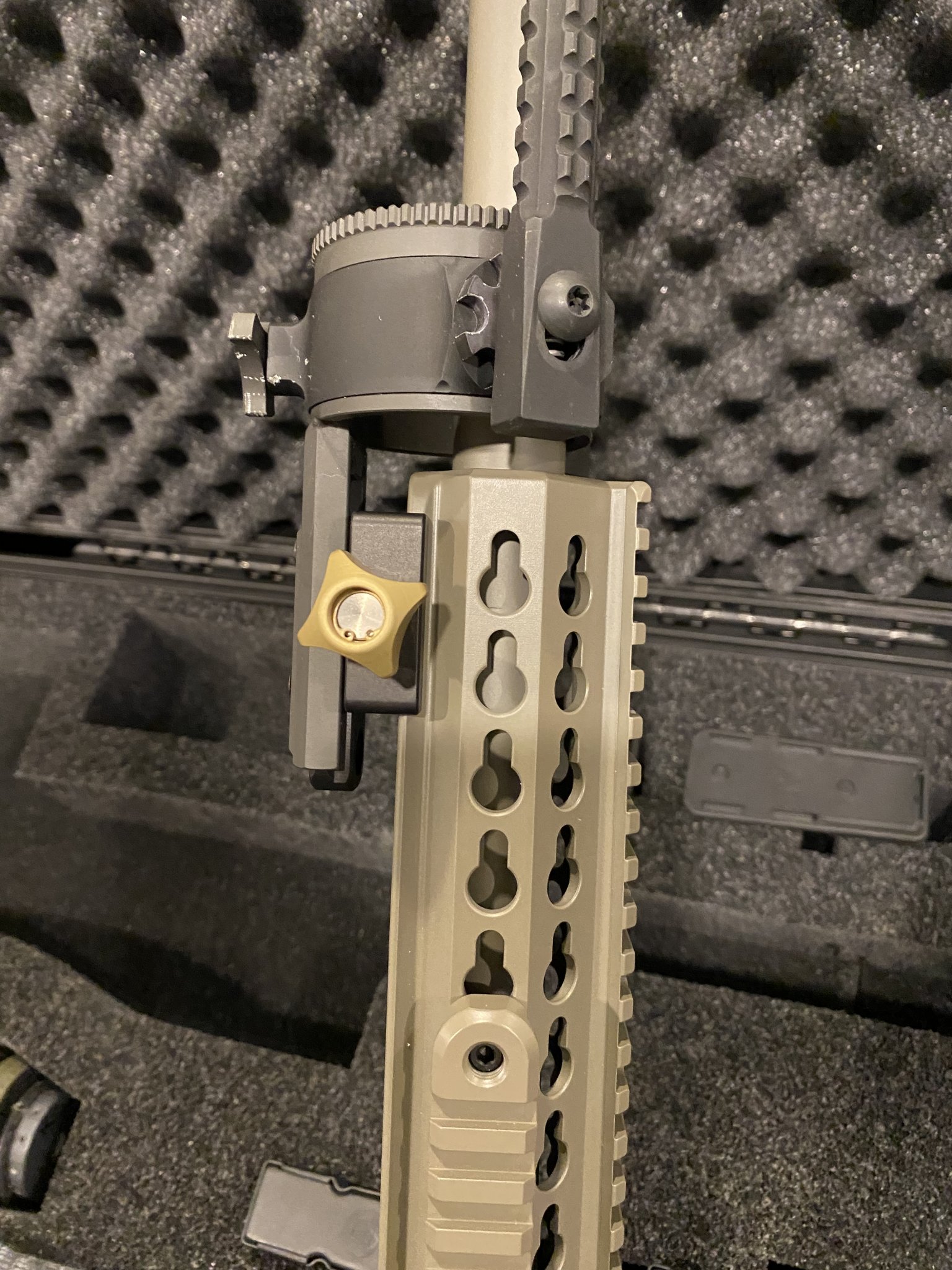

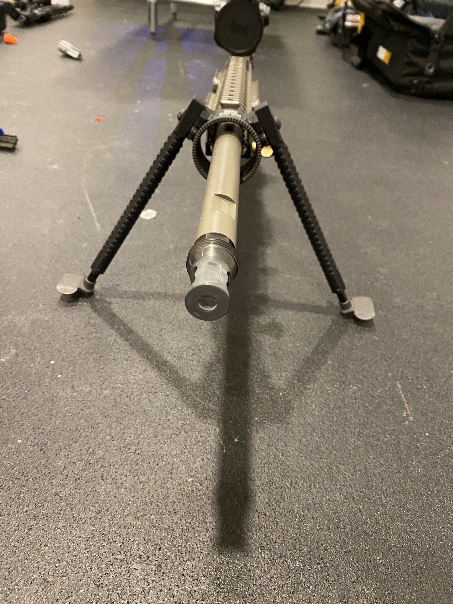

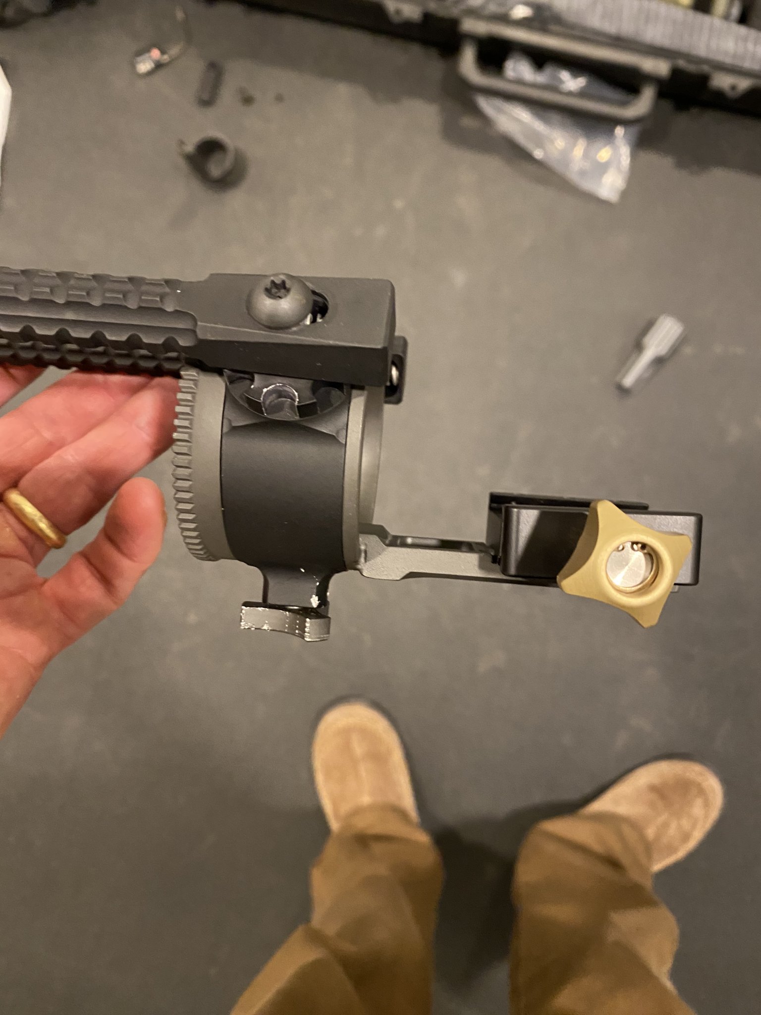

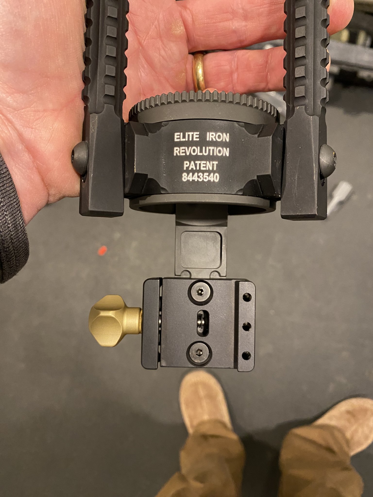

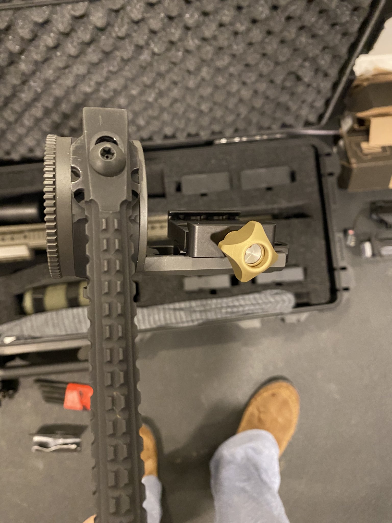

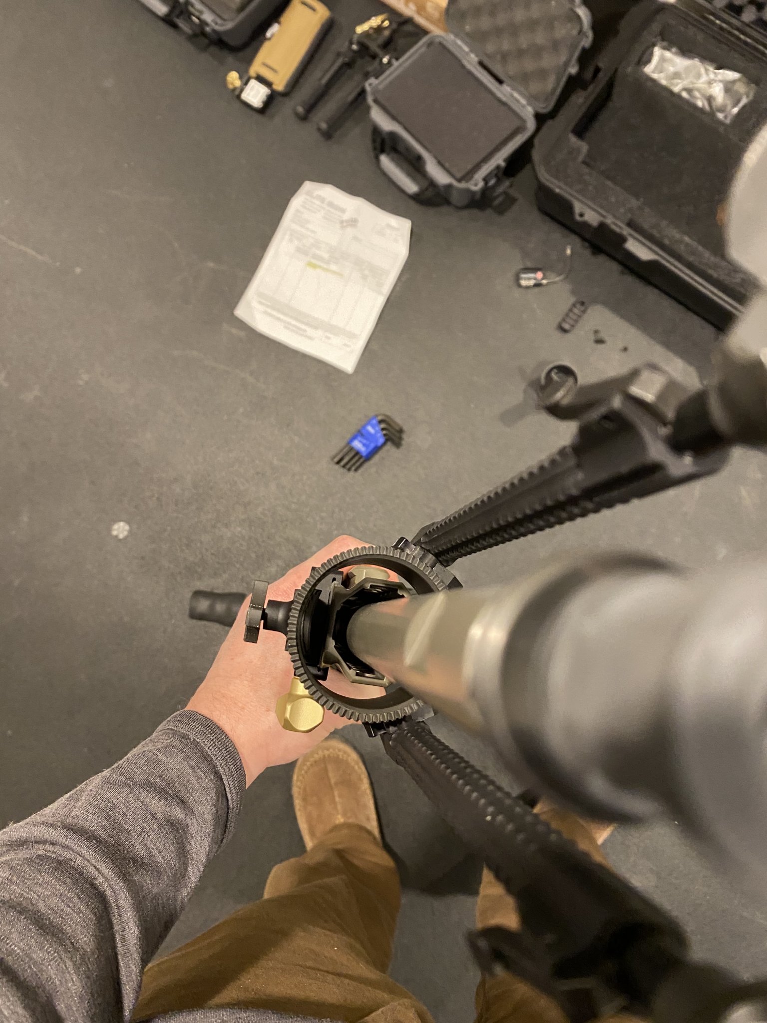

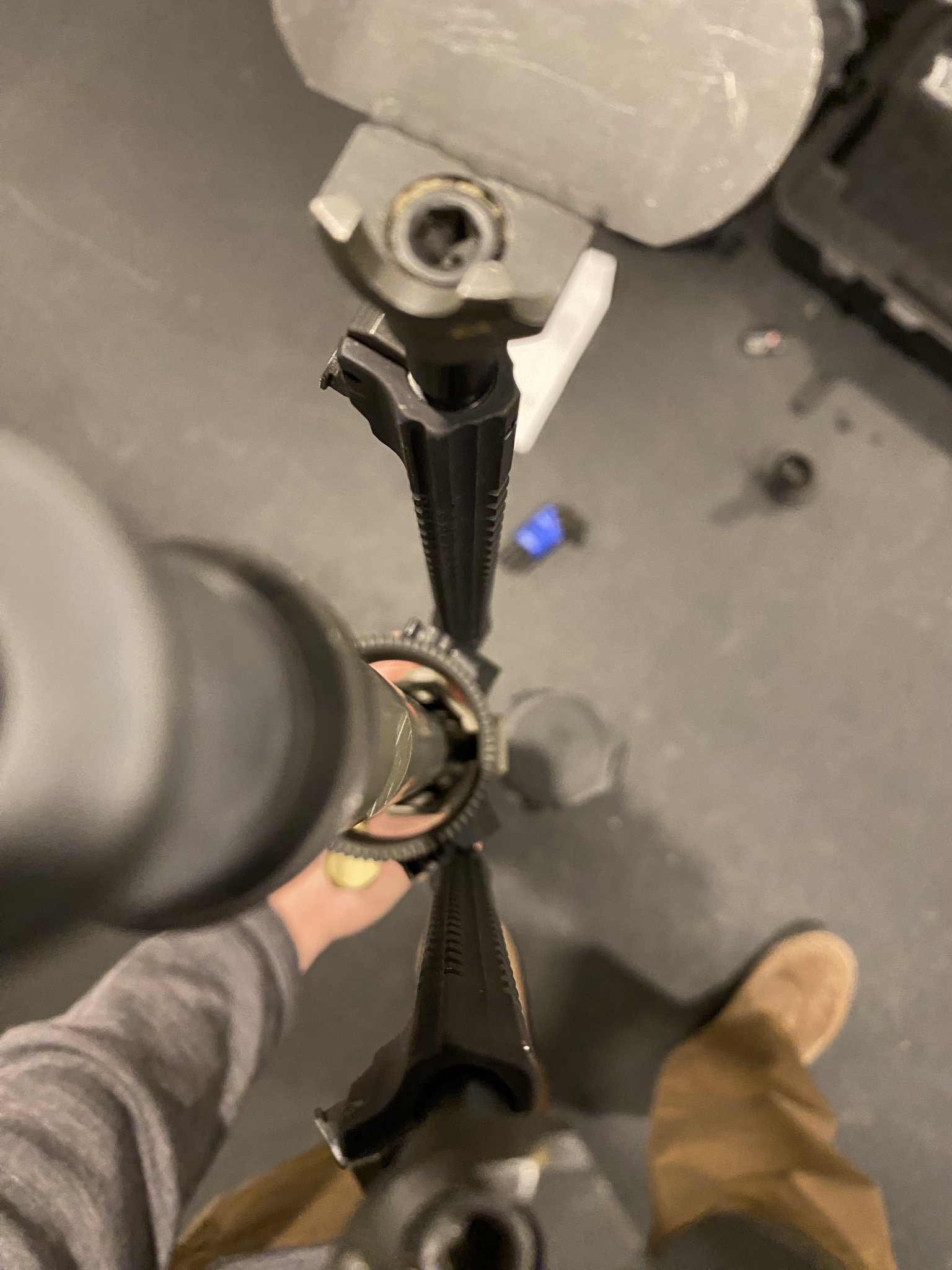

OK I spoke with Dale at Elite Iron and instead of rigging things with a pic rail attachment I now have the “flat Arca mount” and it has better all around clearance and less points of failure. Mission accomplished!
I'm thinking of running a similar set up on my elite irons. CUrrently on pic rail set up. Do you think and offset would put the barrel more central to the bipods? if so in hind sight what offset would you choose?
I think the offset can be varied to center the barrel within the ring. But if you were like me and have a pic rail attached to an arca rail if it were me I am happy having gone directly with the arca rail mount. In addition to fewer points of failure it is now sort of QD. Measure the distance from the bottom of your arca rail to the top of the barrel and ask Kathy at [email protected] to ask Dale what is the right offset.
I hope I addressed your actual question and not one I made up!
