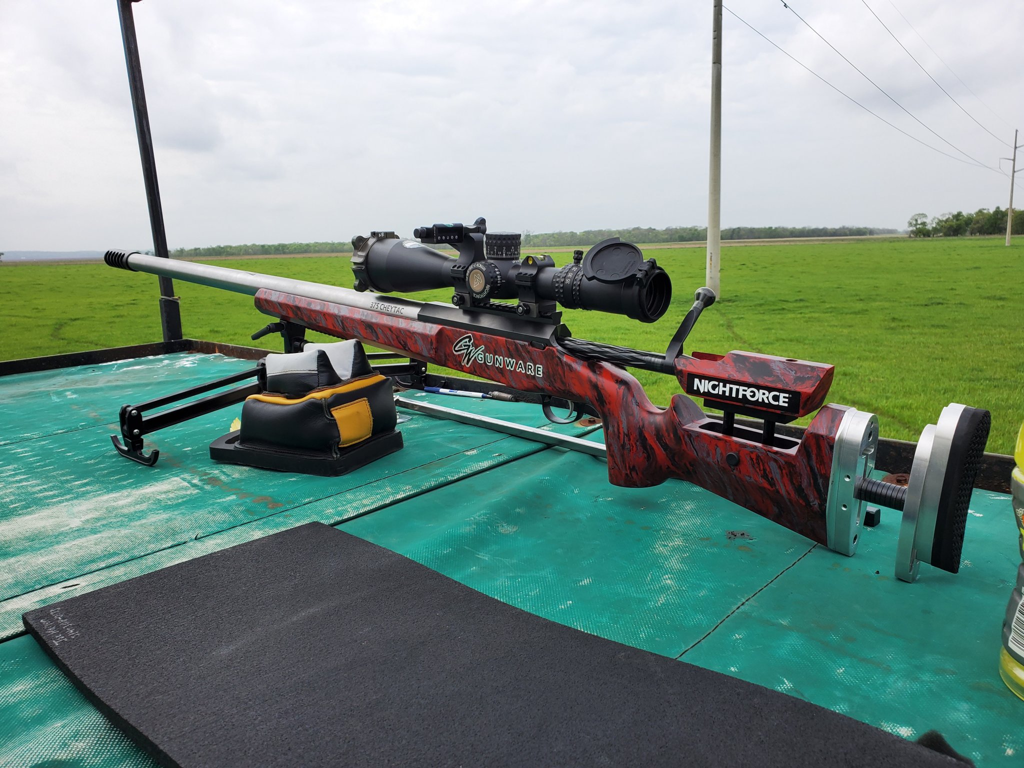

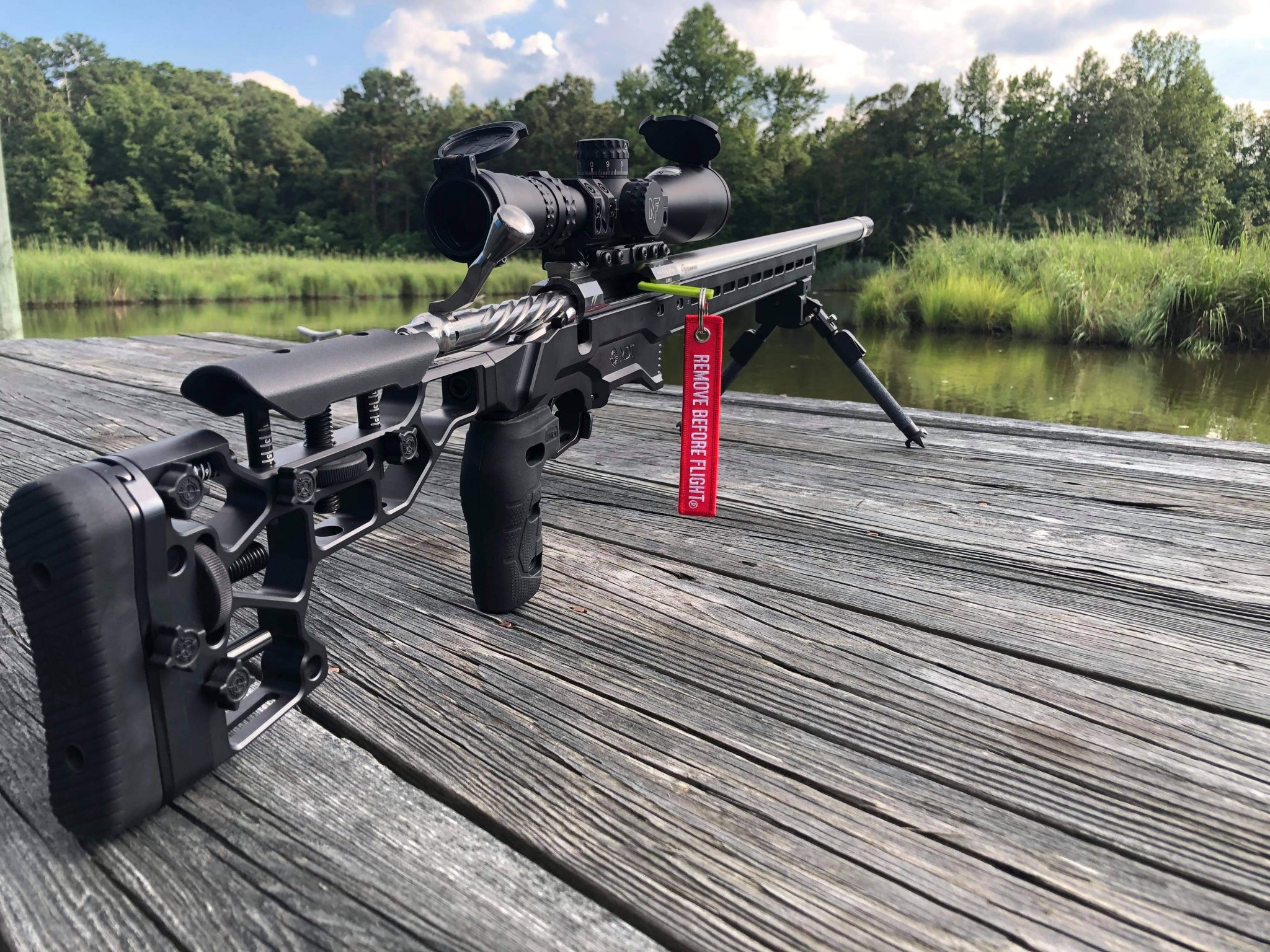

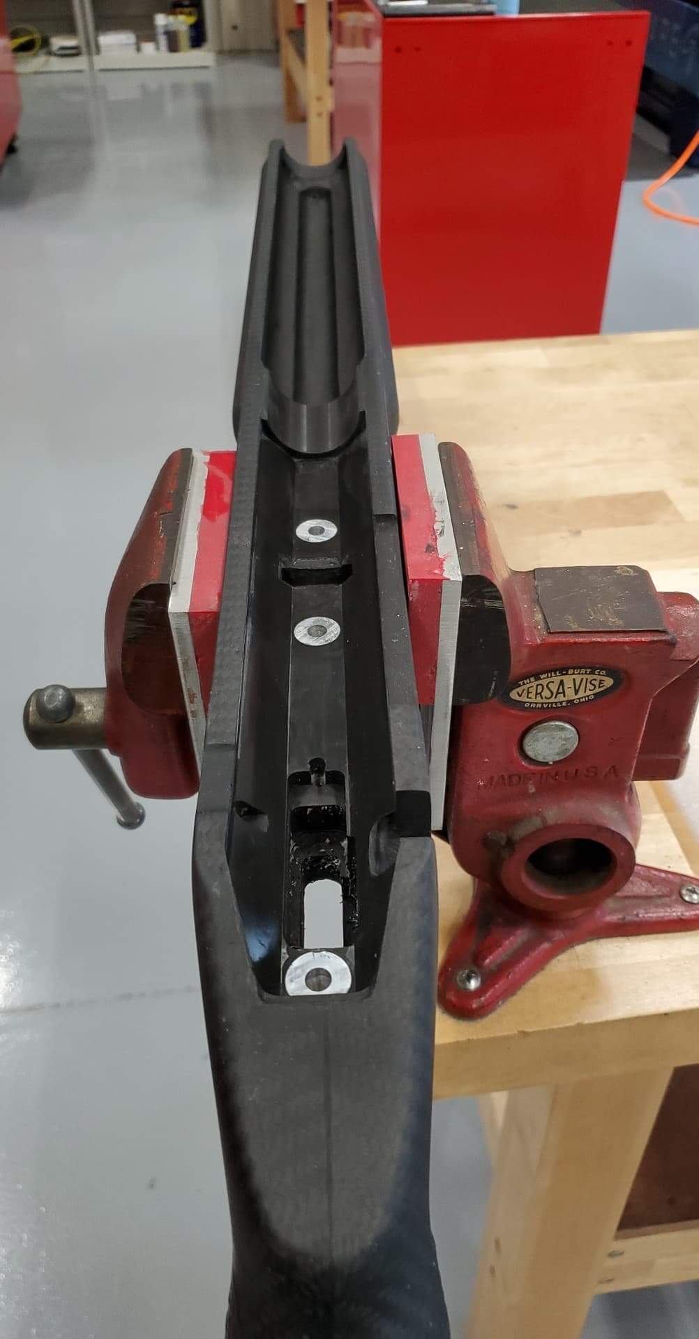

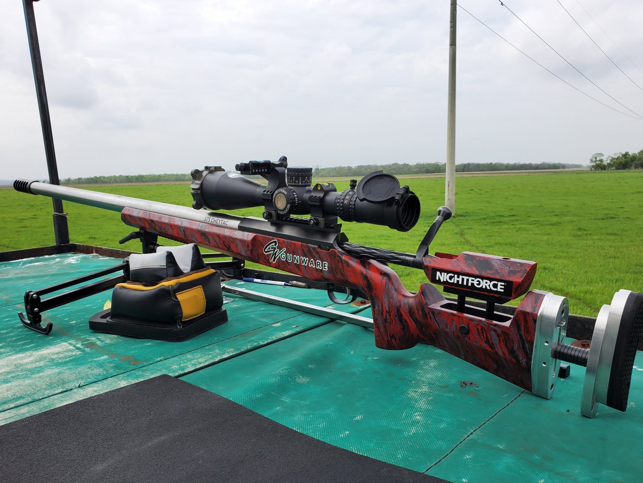

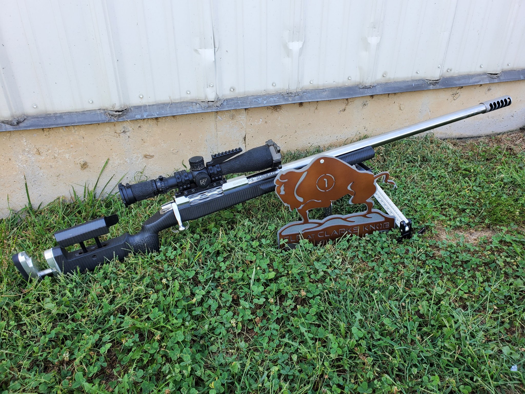

At Sterling Precision we build ELR Rifles that set records. If you are looking to get into the sport for the 2021 season let me know. We carry Parts in stock to build the ELR Rifle you need to win. Soon we will be testing our own caliber the 416 Stroker that I believe is going to be a top contender without all the inherent issues that come with shooting a 50 BMG parent case cartridge !
