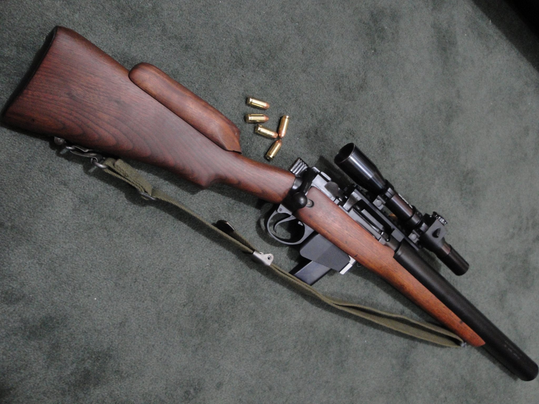

Seriously considering an L42A1 for nostalgia and military rifle club shoots.
I love 303 and 308 😍😍😍

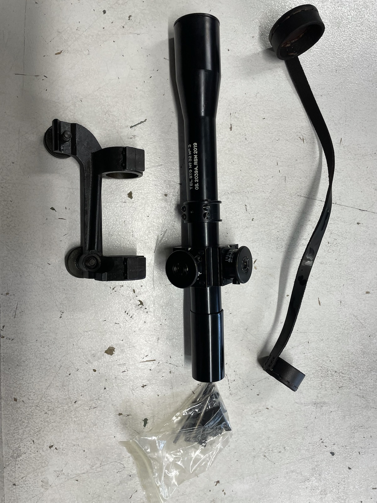

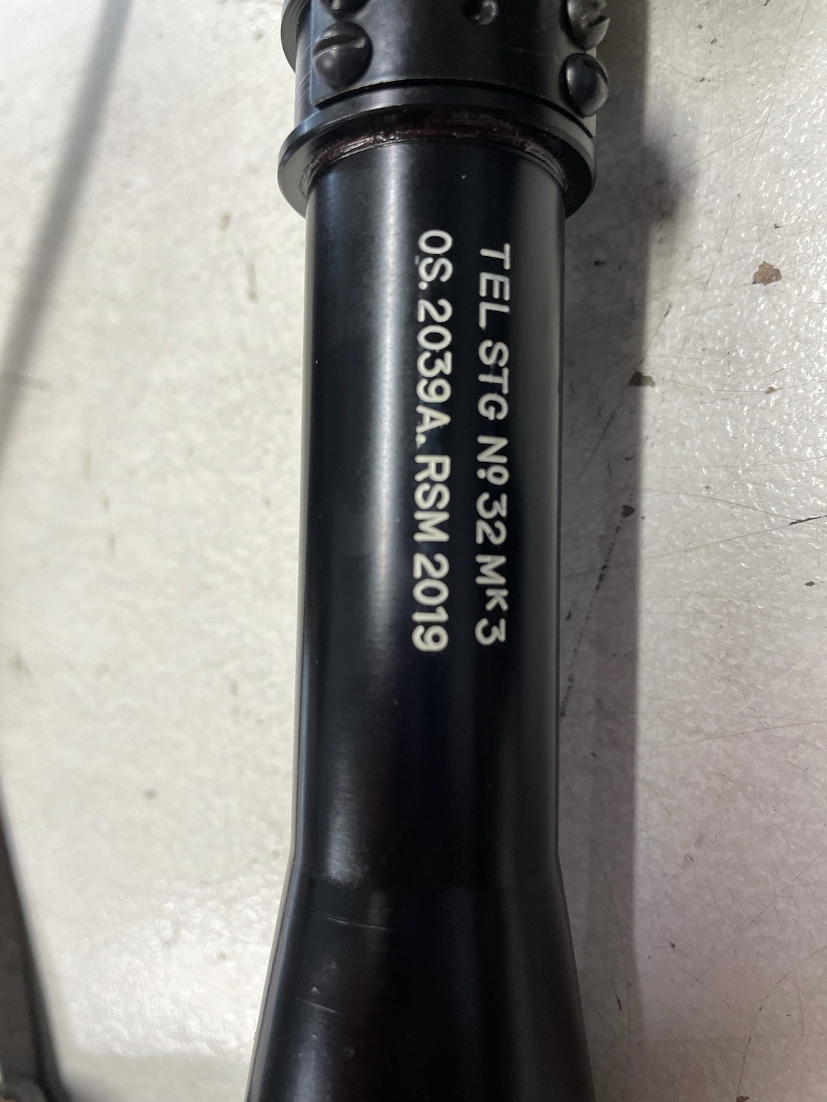

I've managed to snaffle a RSM scope.
Seems to be okay.
Put it next to an original, evidently it's been blue printed from a real one, and the glass is good.
The mount is identical, and seems robust. Looking forward to it being on my L42A1 clone.
As much as I was tempted to obtain a real one, this will do.
It will be used and abused at military shoots.
