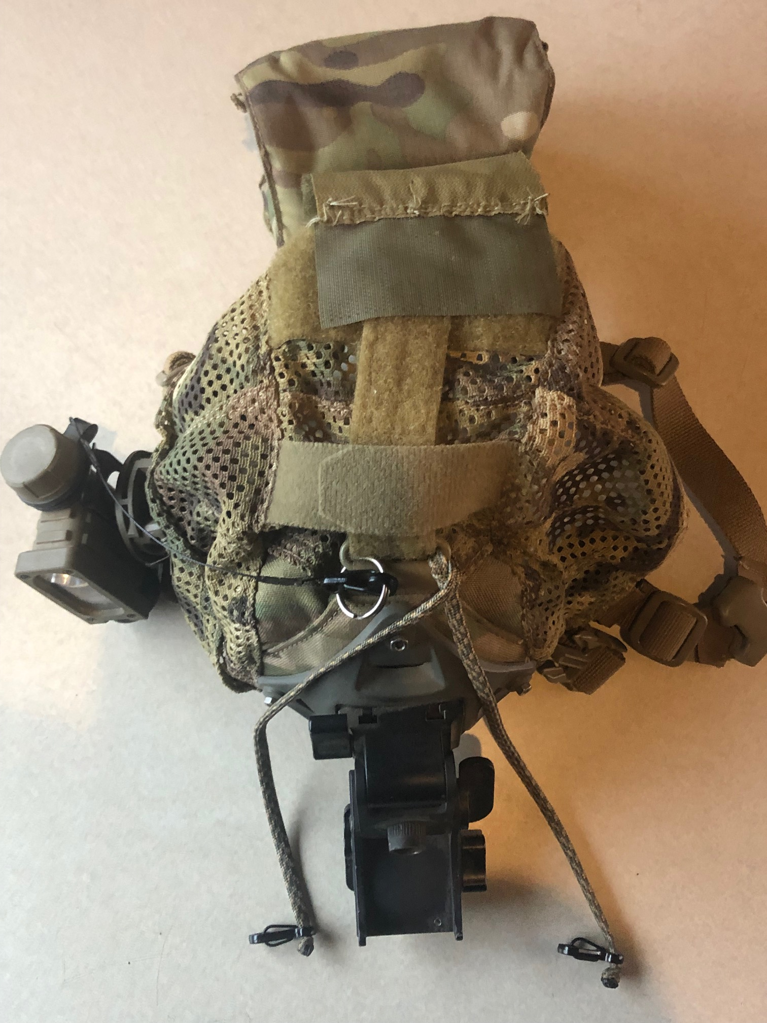

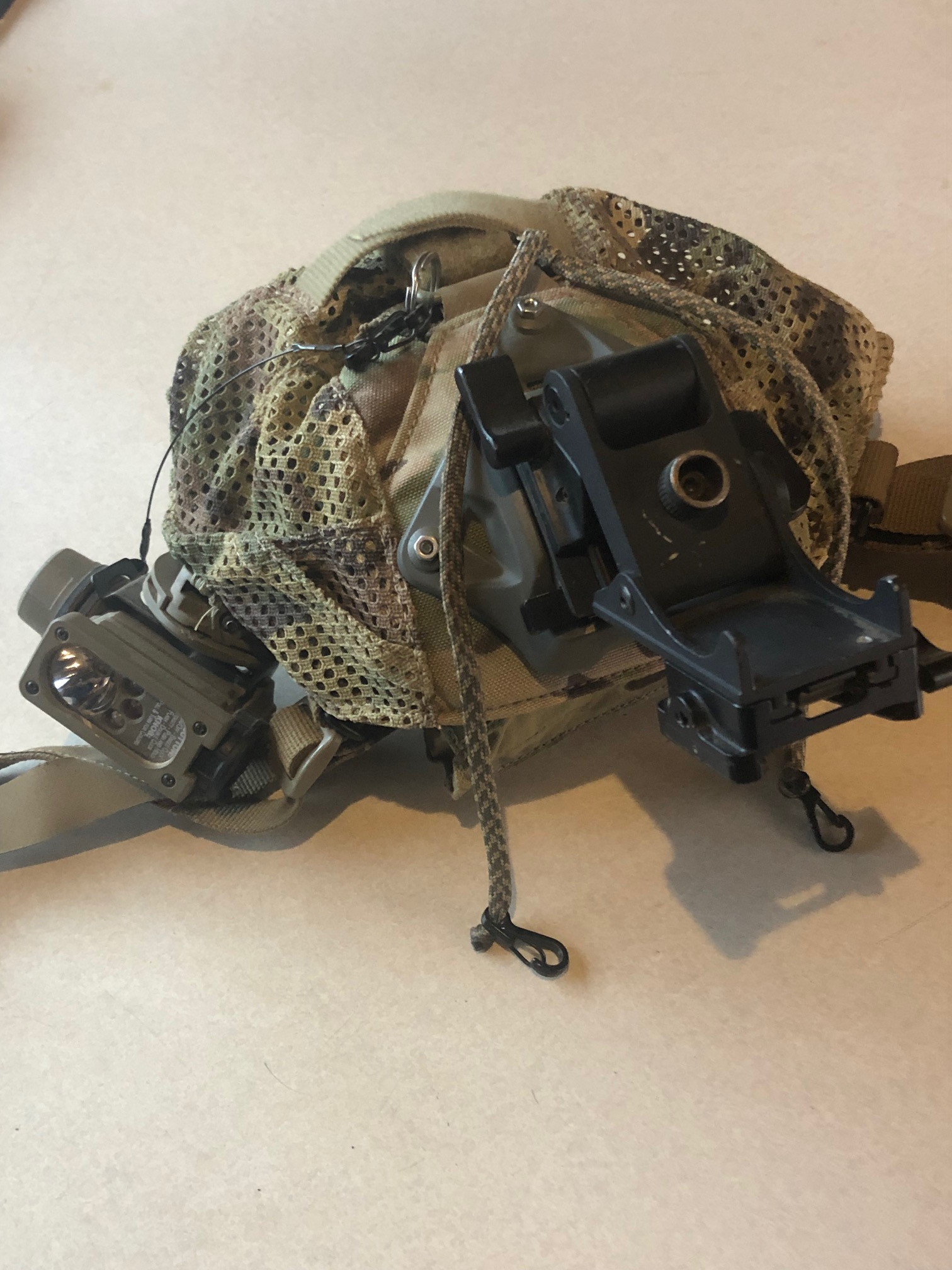

    I also have a Crye Nightcap. I have a large size head, so its not ideal for me but it does still work and the PVS-14 is stable enough to move and shoot. I also have a bump helmet, which is a better solution, but I still carry the nightcap in a small bag with the PVS-14 to throw in the car for night time hiking or star gazing.
    For the Nightcap, you really just need a Wilcox Shroud (its pre-drilled to fit it) and some kind of mount along with the J-arm that probably came with your tube. The Rhino II mount from ebay (or others) is the cheapest practical mount (< $50 used), and it does work. Next up from that would be something like a Wilcox G11 which is a bit lighter and more adjustable - you can sometimes find these used for a bit over $200. Honestly you don't need anything more expensive than that with the nightcap.
    I would also recommend you fashion some kind of lanyard - even if its just thin paracord - to connect your tube directly to the nightcap. You don't want to drop your expensive tube just because your J-arm or mount was not fully engaged.
