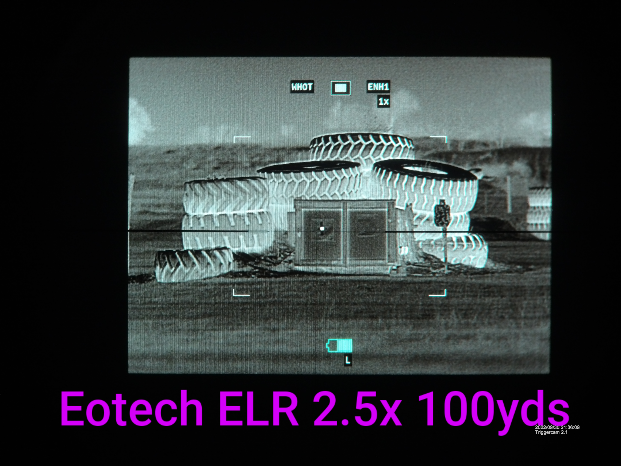

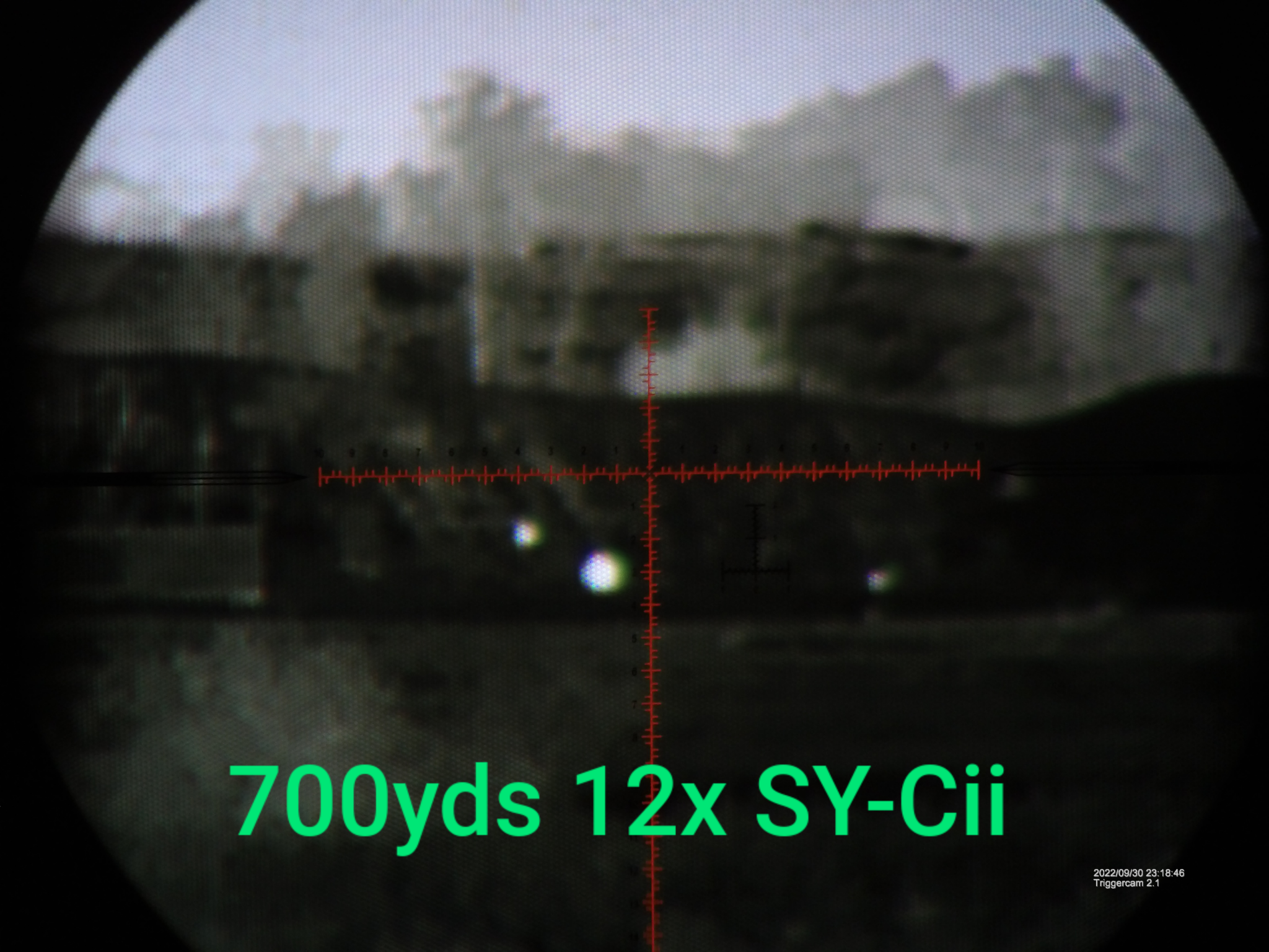

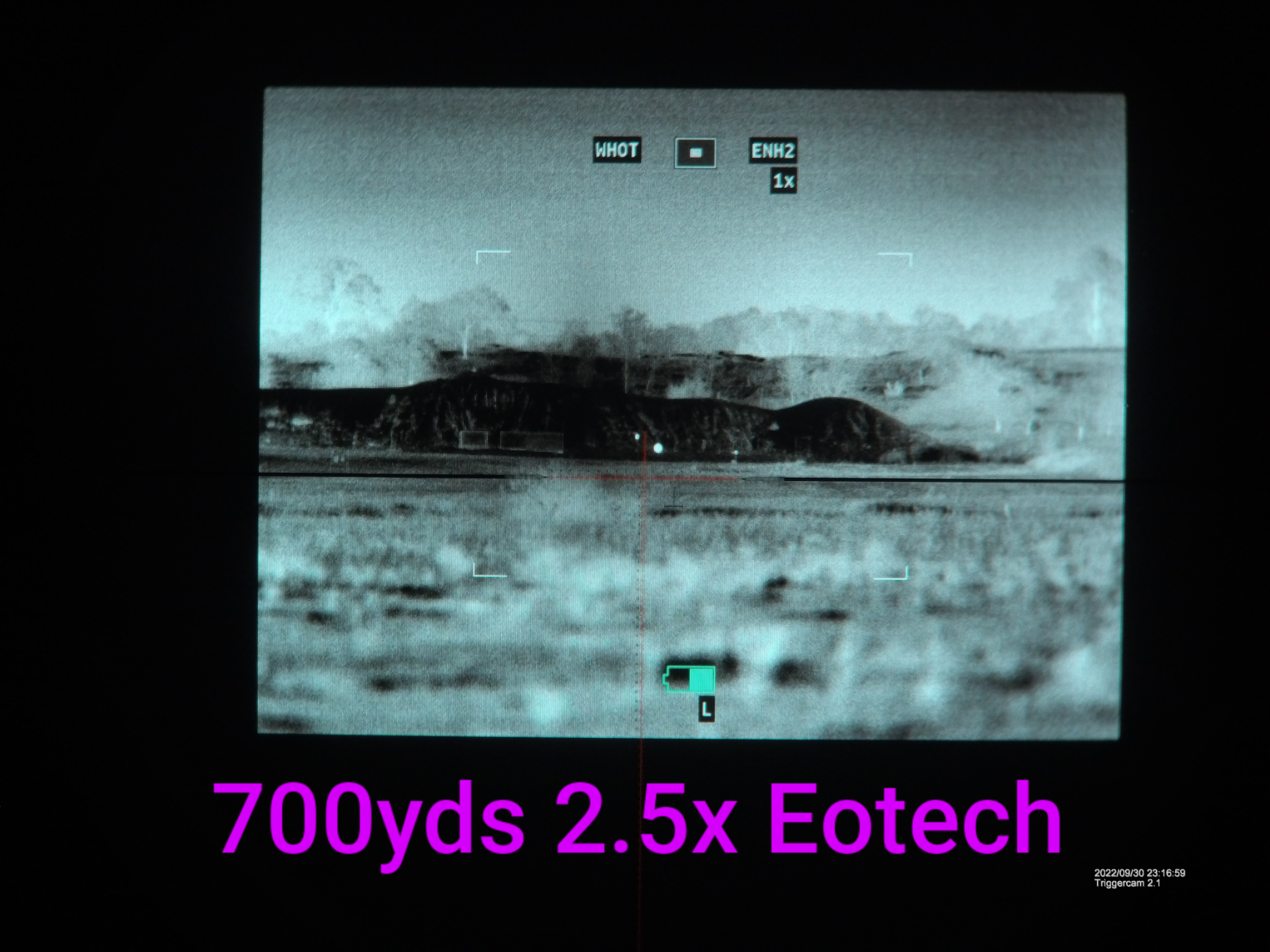

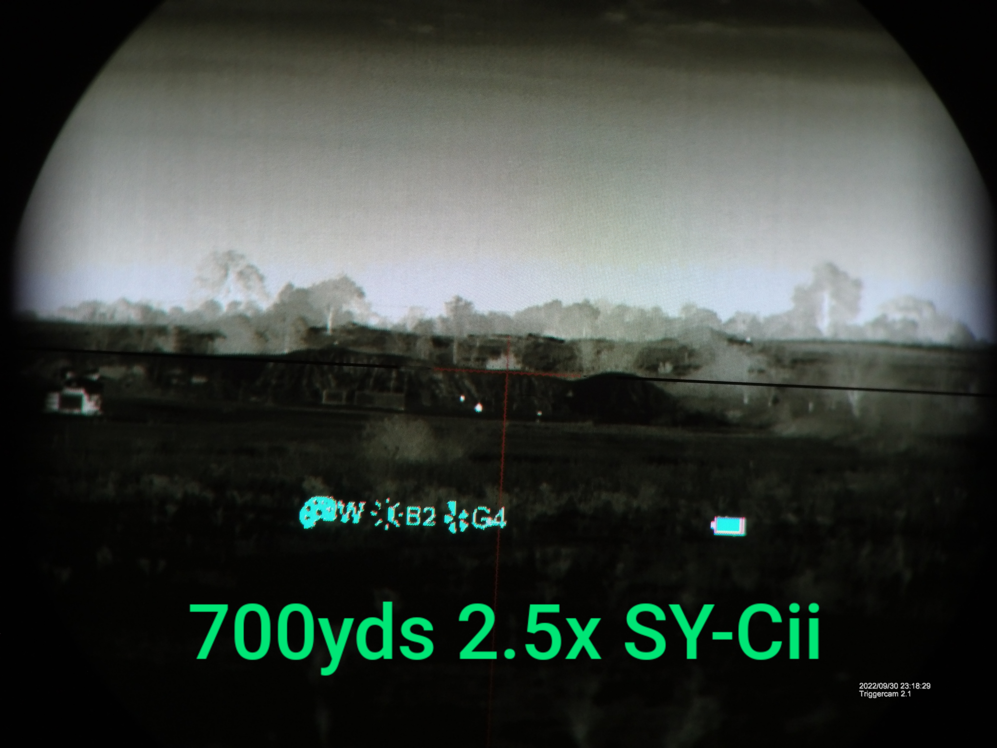

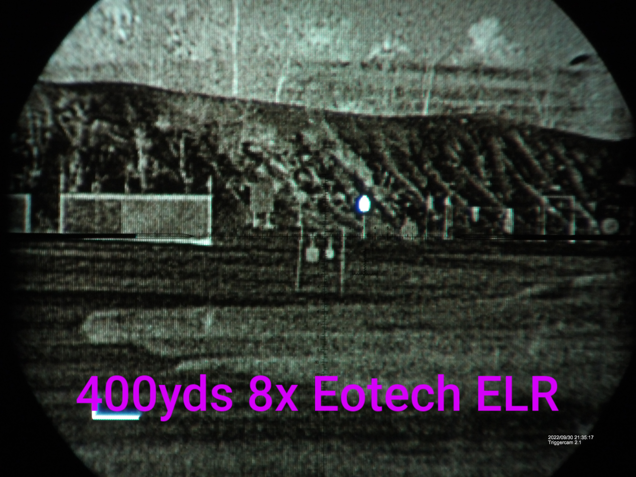

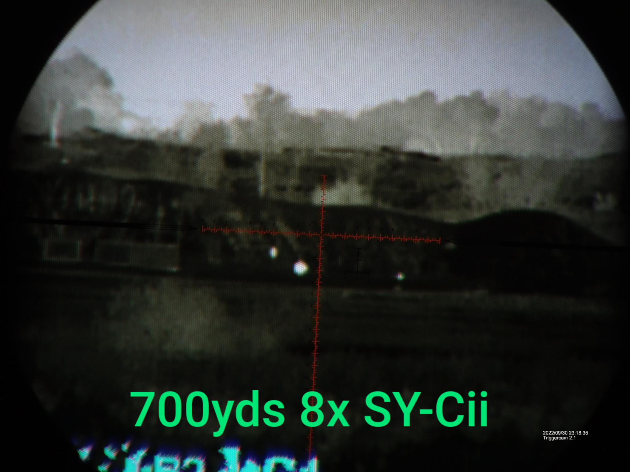

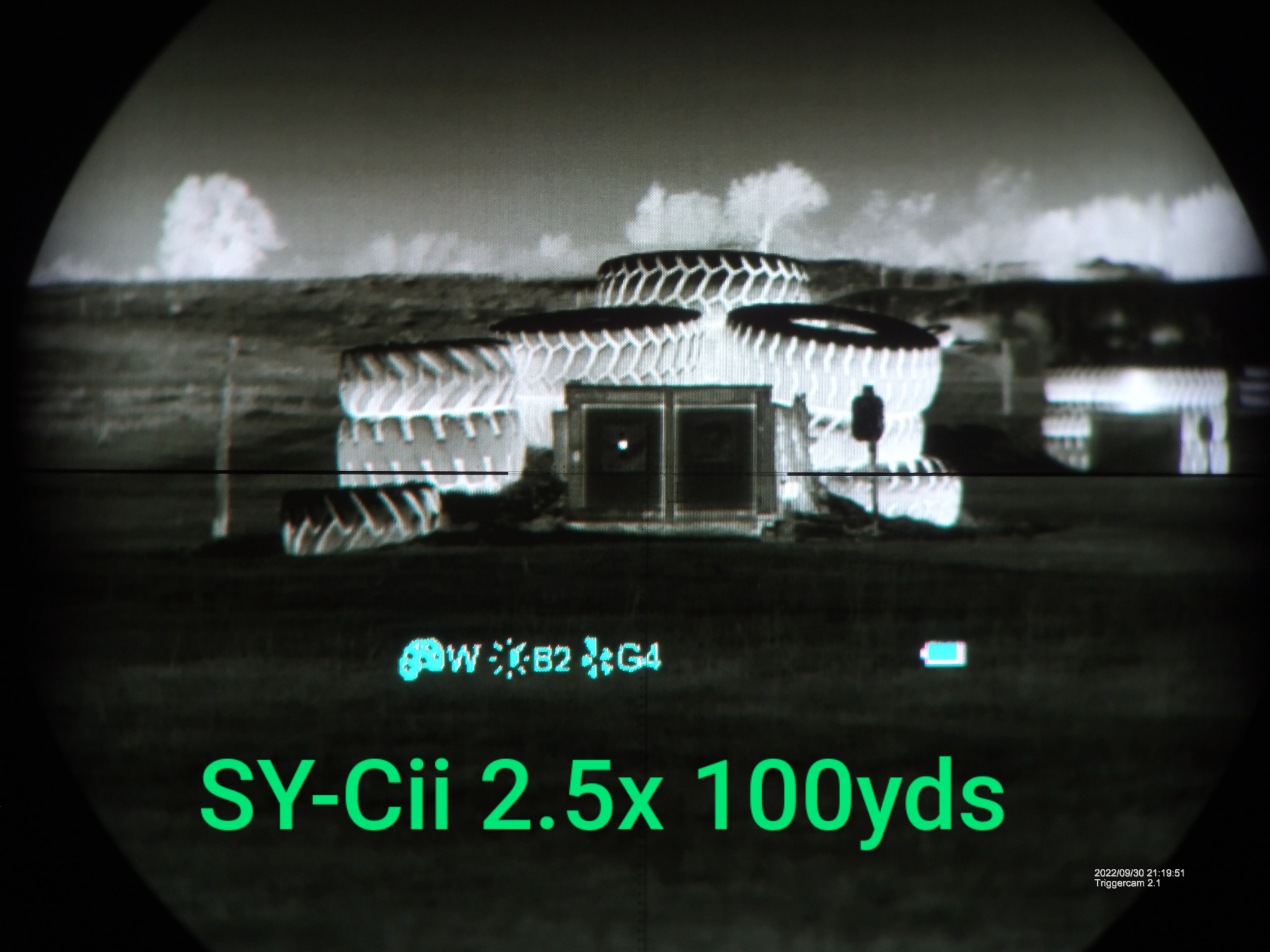

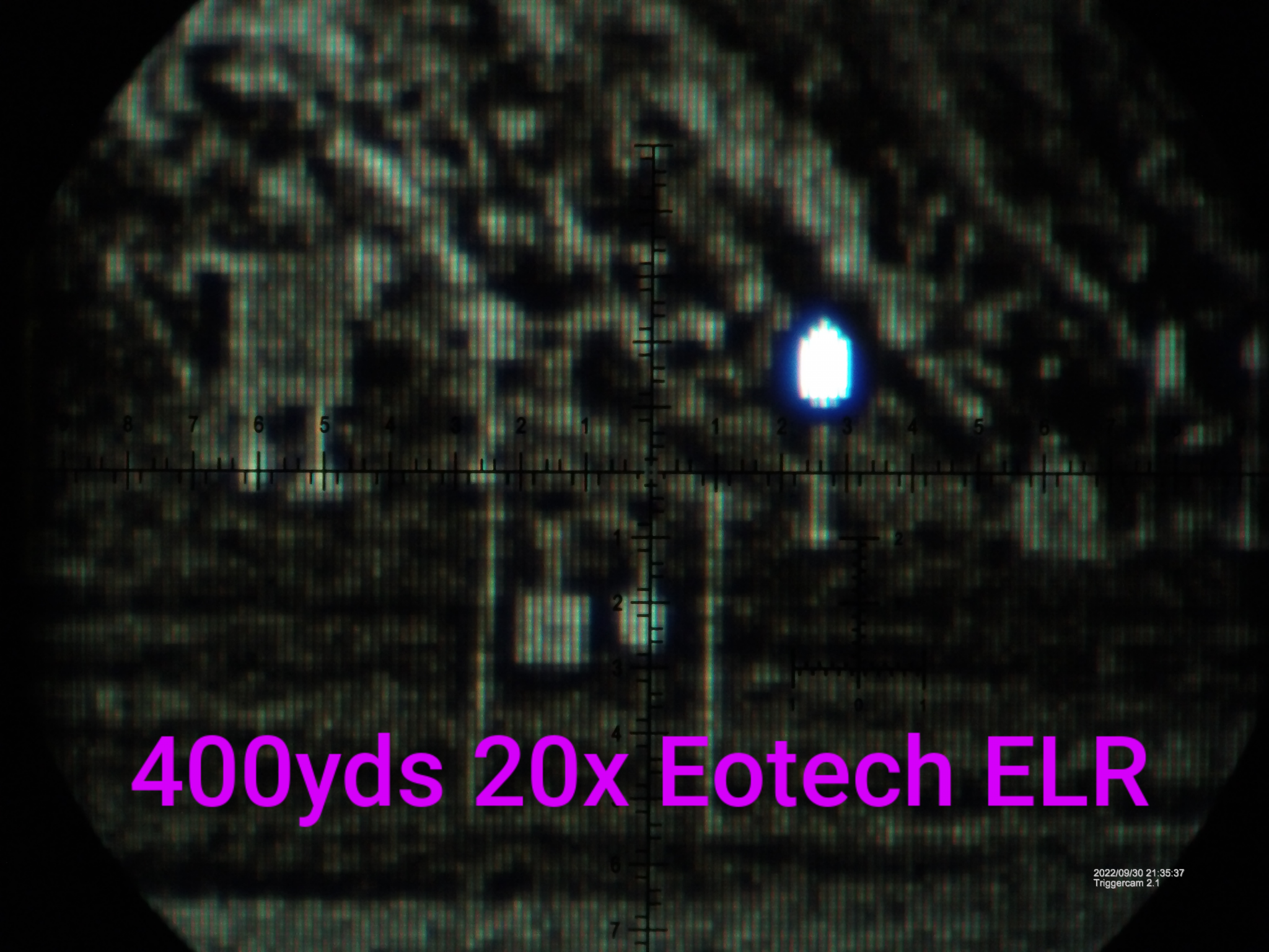

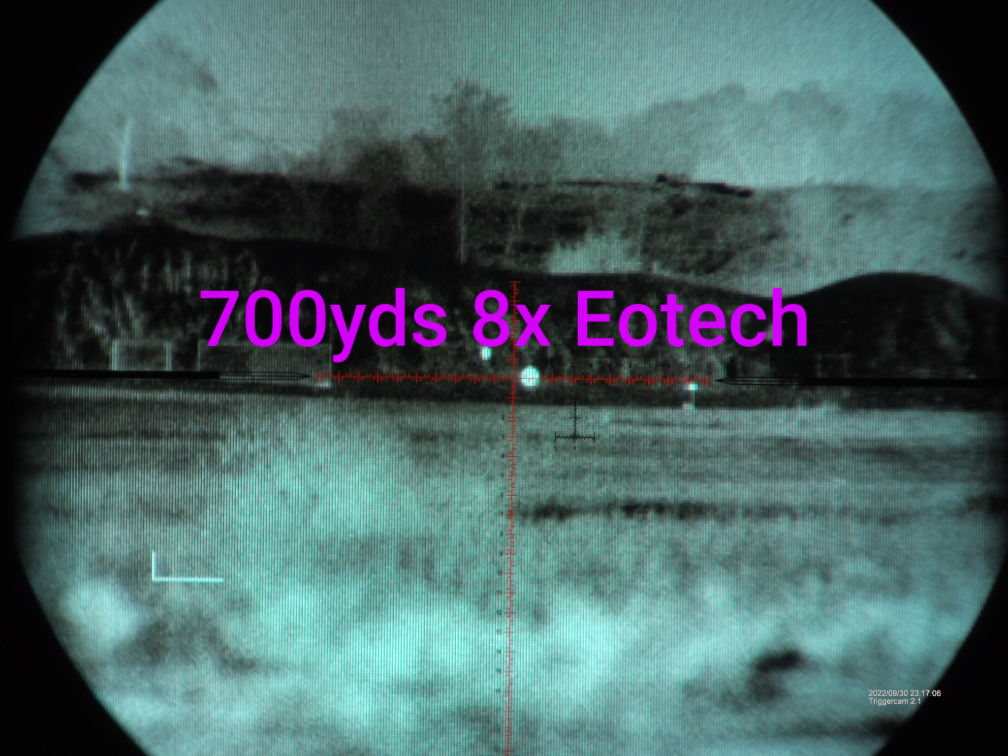

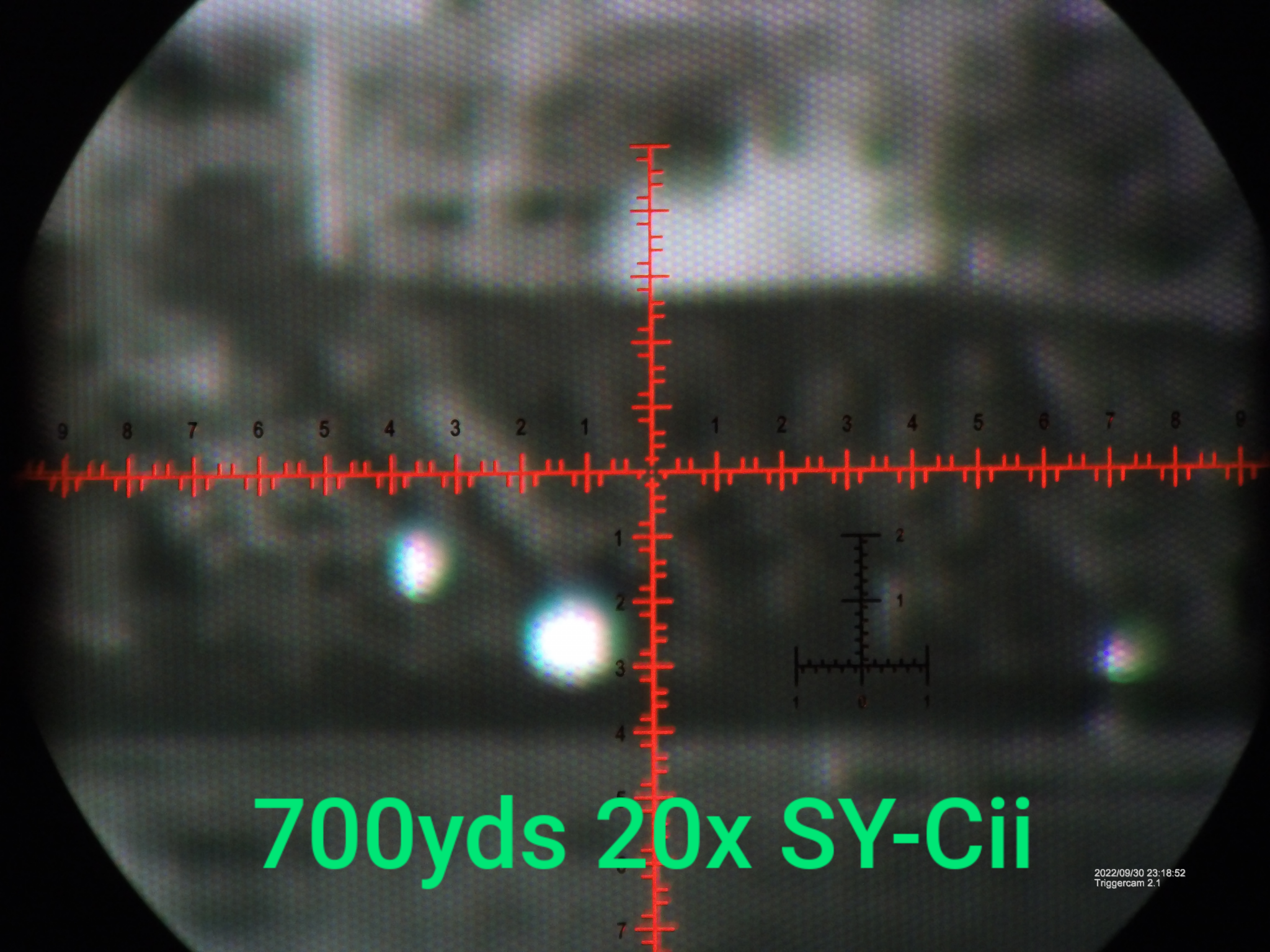

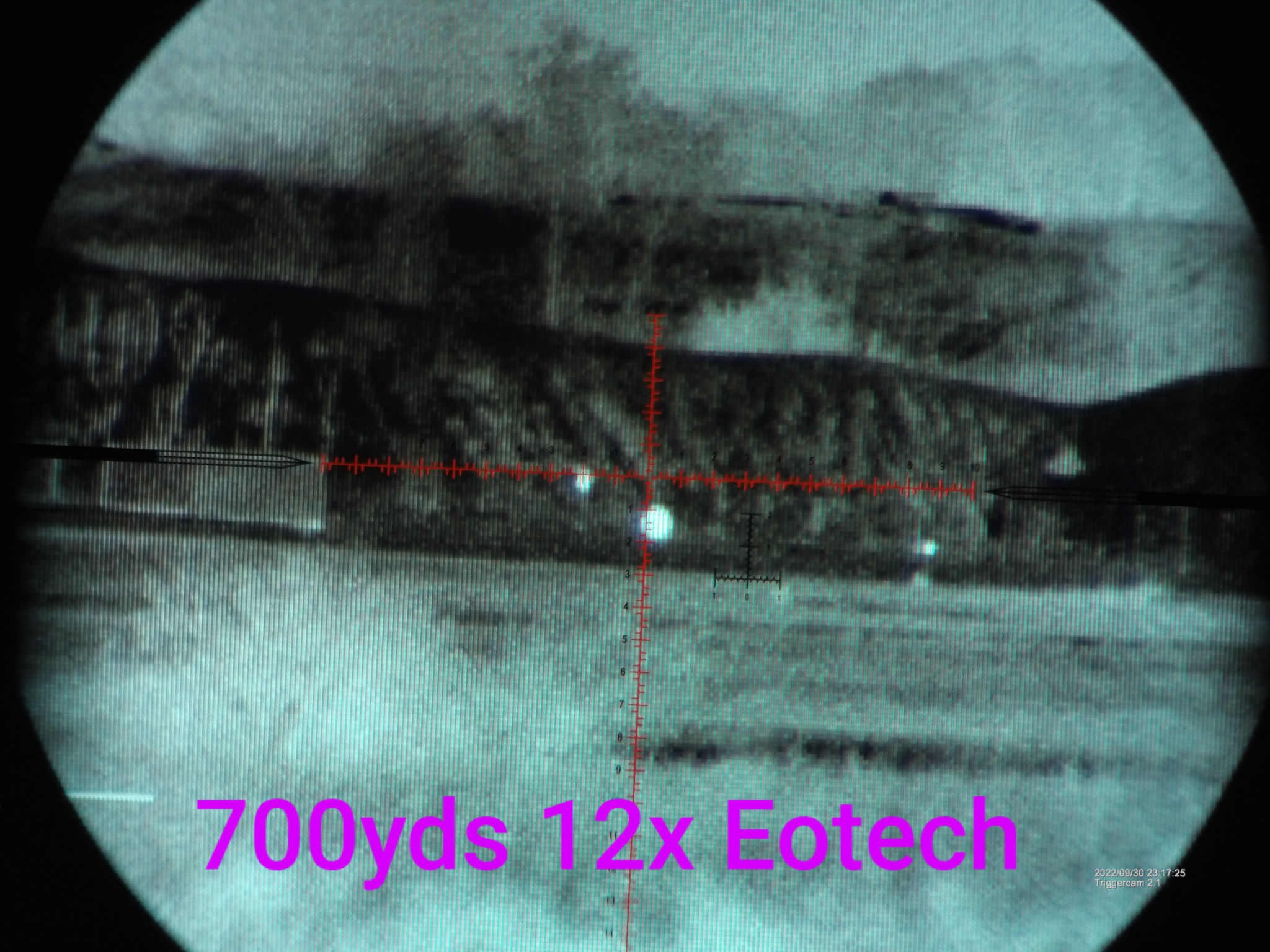

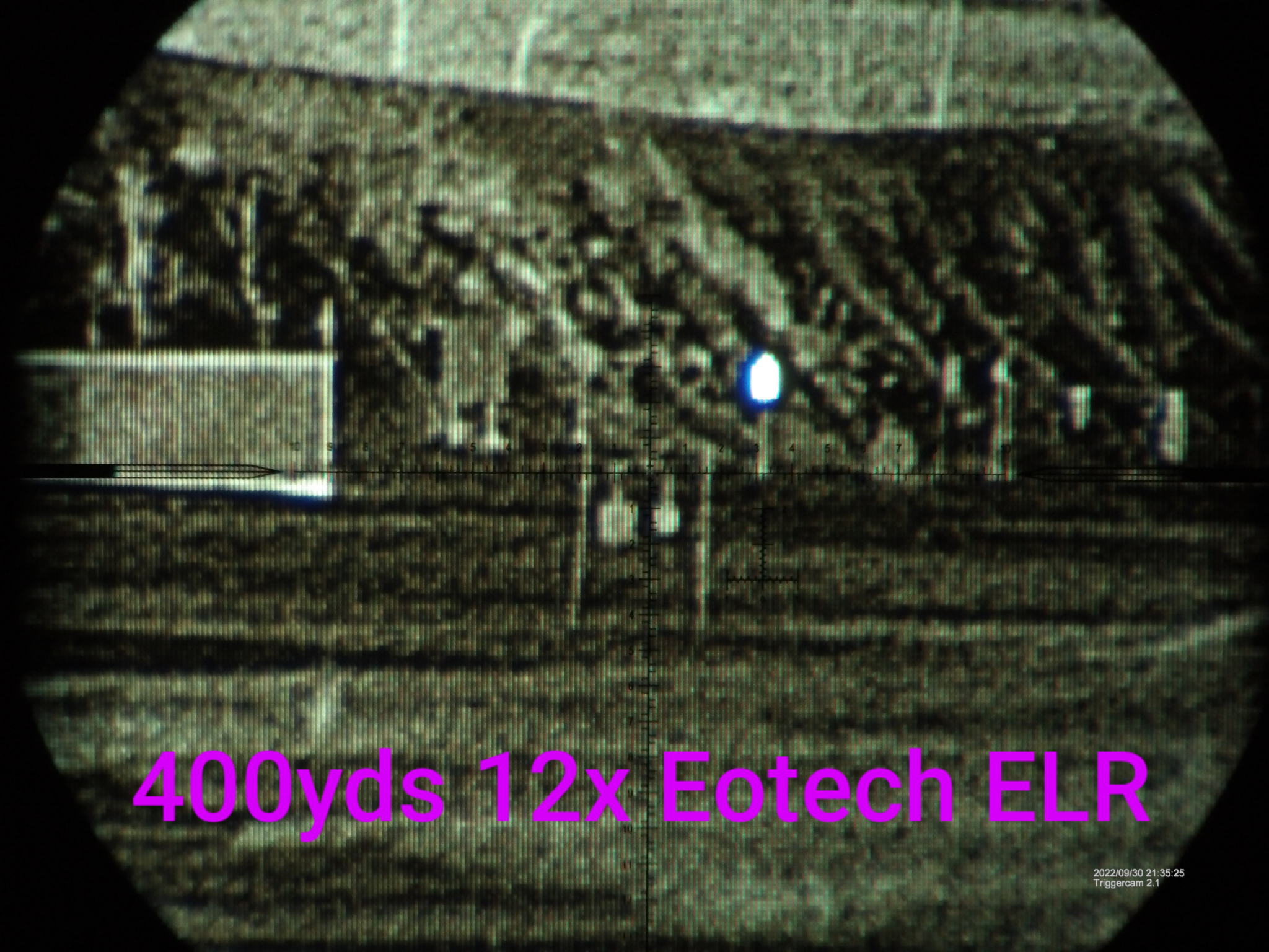

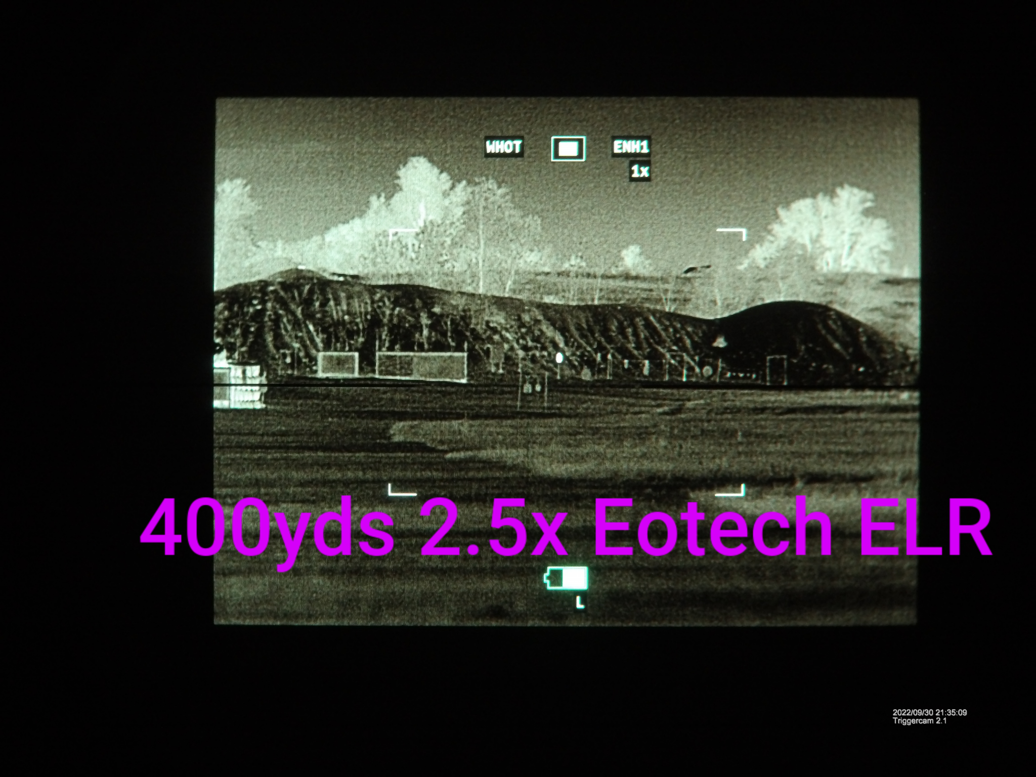

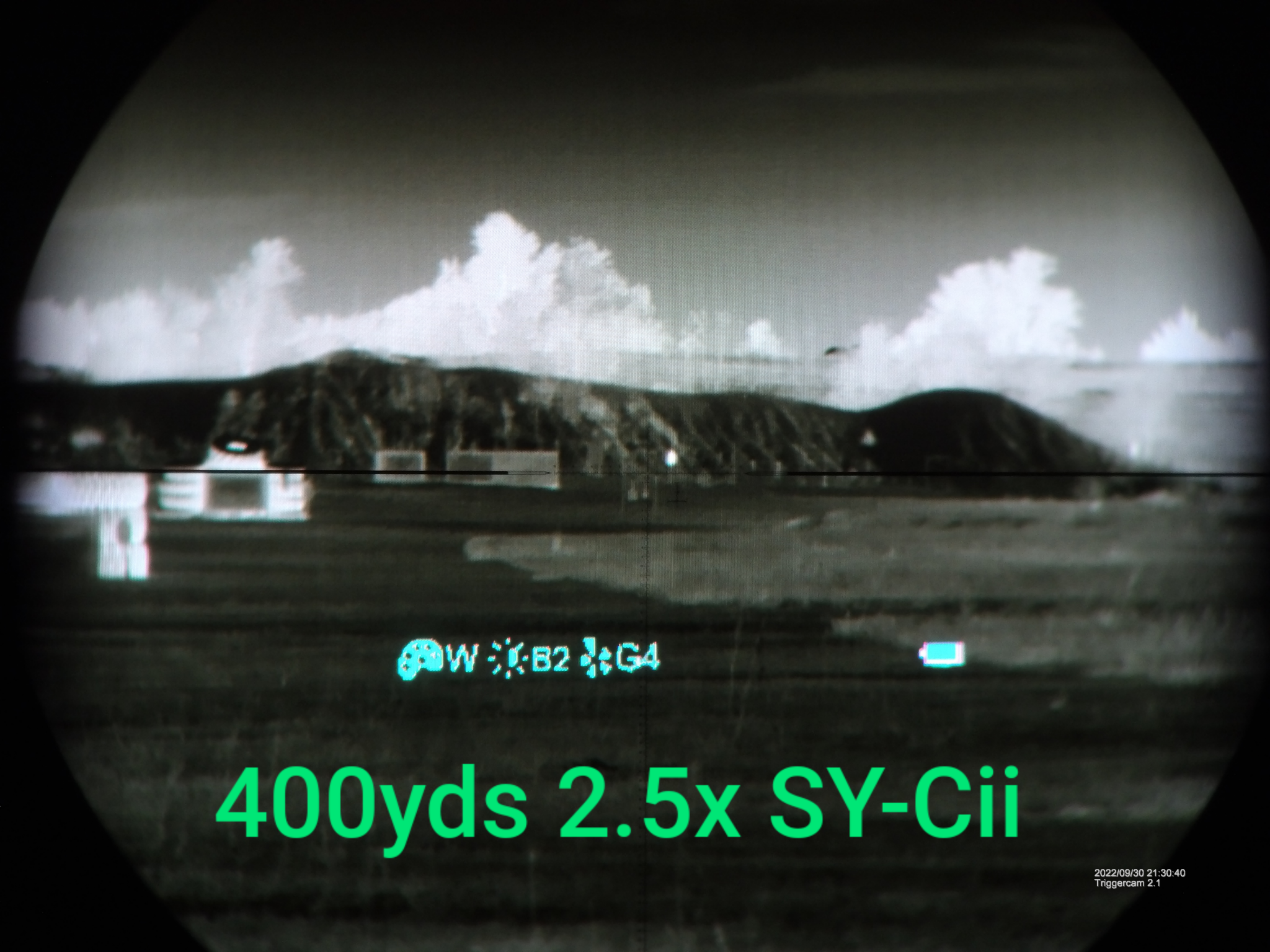

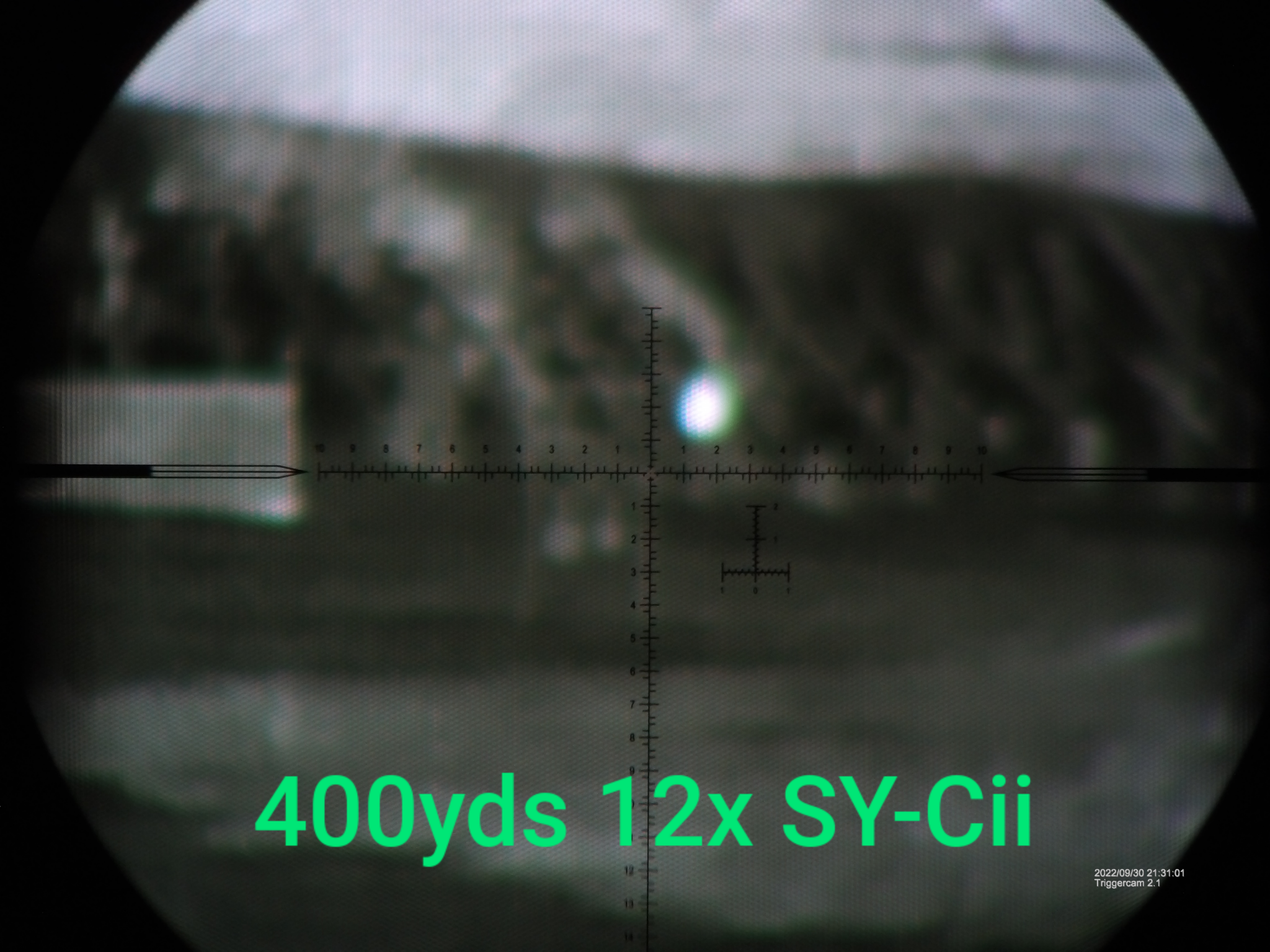

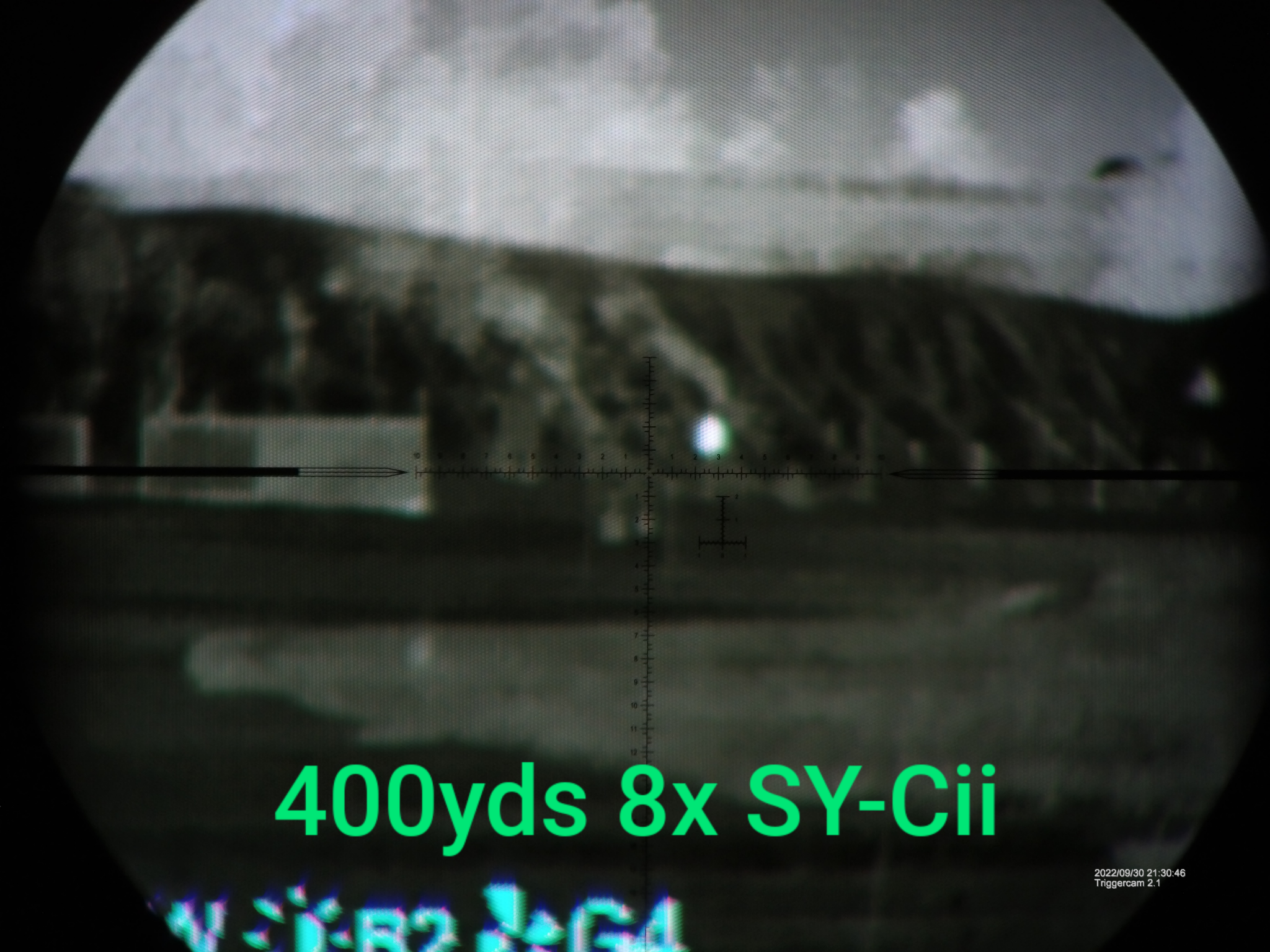

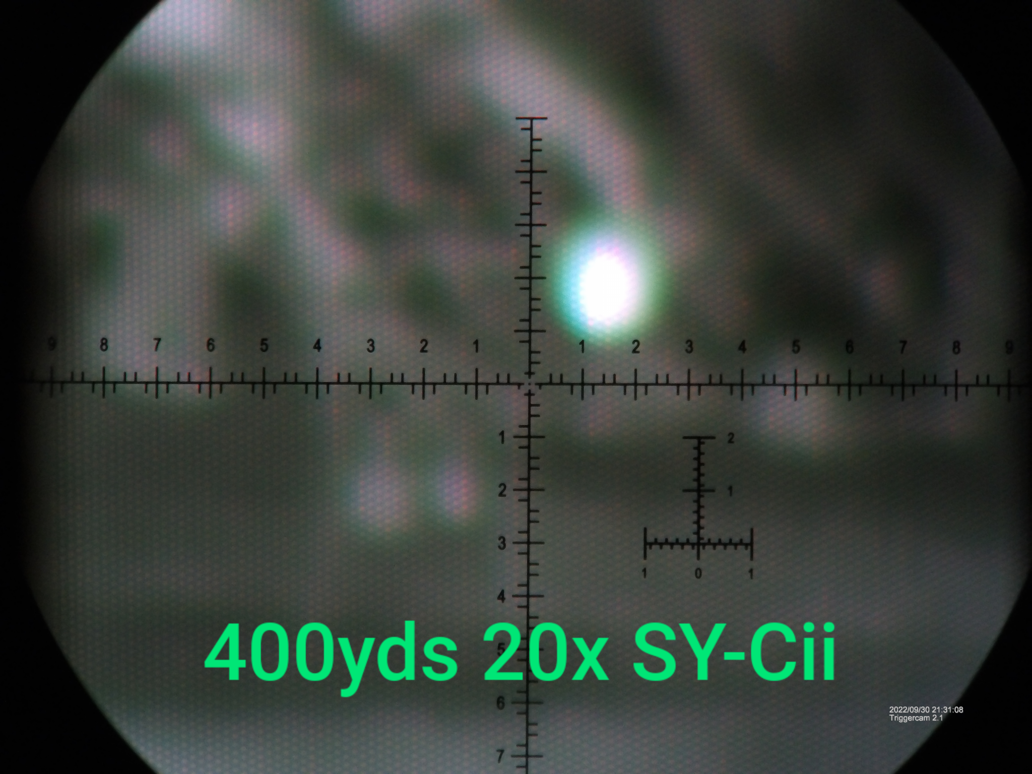

I've had a couple PM's asking about the second generation Bering Optics Super Yoter clip on. The main question seems to be "how good is the image at range". I thought I would post these here for others who might be interested also.
I'm not going to call this a comparison, because we all know it's not an apples to apples test because the Yoter is in a wider FOV class and it's a third of the price. But I will say that within a couple hundred yards and under 10x the SY-Cii holds its own very well image wise. Plus it has onboard recording, is smaller, and has the larger FOV. I wouldn't have hesitated to spend this winter hunting with it if the Eotechs hadn't come along.

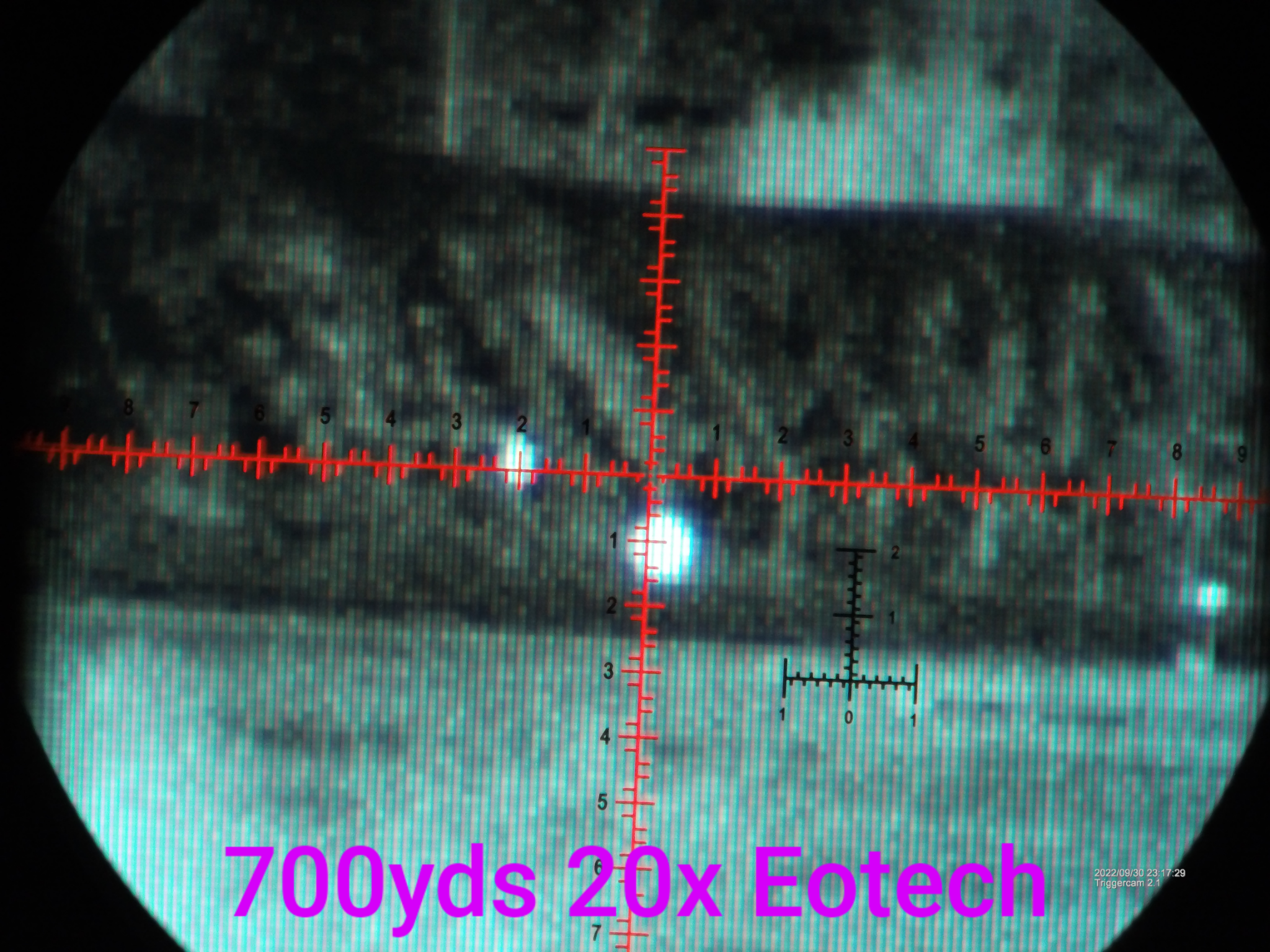

These pics were taken back to back. I've got more at 700yds I can post later if anybody is interested.
Also note, at 2.5x I'm loosing FOV with the Yoter. There is more past the edges.
Edit. I'm looking back at these wondering if I forgot to adjust the parallax on the NX8. Check out the 700yd pics for a more accurate comparison. That's a heated 50%IPSC at 400yds.

The difference beyond 2.5x is staggering. Alexander the Great must be running Theon, because them Greeks be kickin’ ass!
Reactions: cantankerous
700y looks like a lot better on yoter vs 400y. The ELR is a very impressive unit. I wish I'd waited for one vs the mid line LR.

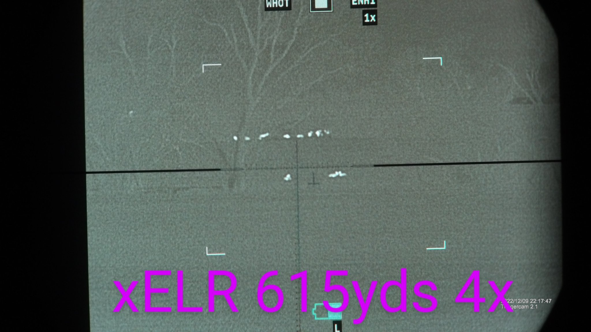

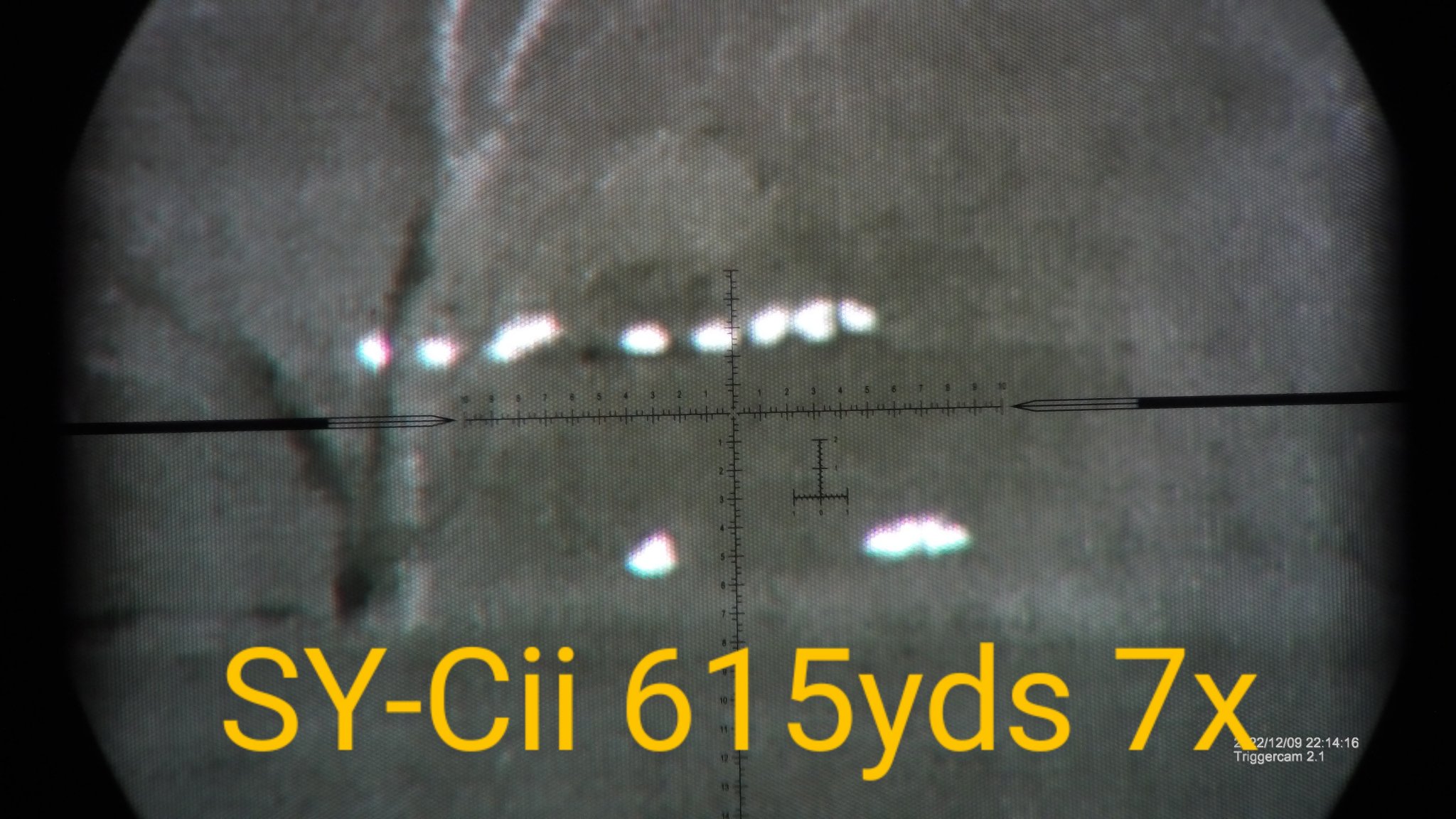

It seems to do pretty well. These pics were taken tonight. It was around 40*F with 90% humidity and a cold drizzle had just started to fall. My GF had her XQ38 Helion with and commented several times that the conditions were really bad, but it didn't affect either clip on much.
The Eotech does better on the animals but the background is sharper with the Bering.
The close deer are 600+ yds and the tree is about 450.
Reactions: 260284
