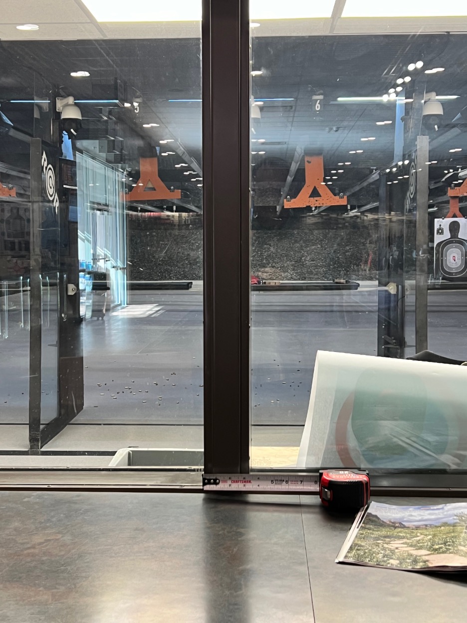

The video I've uploaded doesn't have any connection to an Eotech, but the video is an "eye opener" on how mistaken/wrong folks were about their tests which declared a gun to be "drop safe" that wasn't until it had some modifications that helped w/the problem of "inertia discharge".
Testing out a theory, in a way which seems reasonable for me, is "Hey, I did A-B-C-D, this is how I did it", then let anybody who cares to put it under scrutiny/pick it apart, and see if your idea/theory "holds up" because even professionals at testing things forget things or leave something out, just ask the folks who put Hubble in orbit before they checked their math.

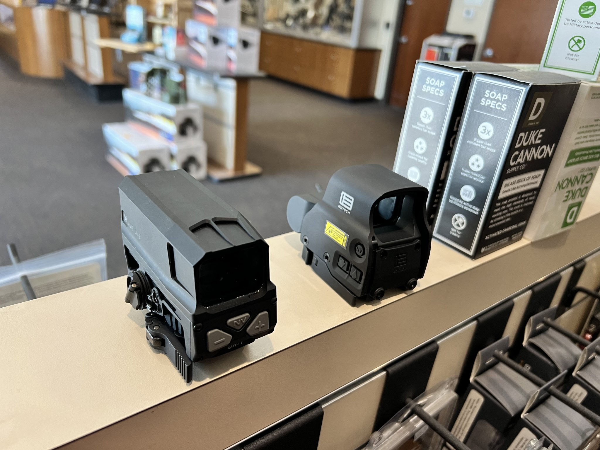

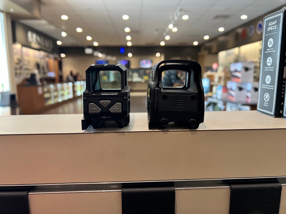

One sight, shown on the right in the picture below, is a second EOTech EXPS3. The other sight, shown on the left below, is a Vortex AMG UH-1 Gen II.
A group of black objects on a shelfDescription automatically generated
We placed the two sights side by side on a sturdy, stable half-wall. There is an indoor range that is 60 ft / 20 yards distance from the half wall. There are windows looking onto the range from the gun store. The windows are separated by 3.25 inch wide vertical window frames/dividers. We aimed both sights at the same window divider. We then moved our eye approximately +/- 0.5” across each of the sight windows while observing how far the aiming dot for each sight moved horizontally across the window divider. This was not a highly precise test, but it was sufficiently accurate to meet the goal of determining whether the EOTech parallax error measurements taken yesterday were “in the ballpark” as compared to a different EOTech EXPS3, or if the second unit we tested today would much better in parallax error. This test also allowed for a direct comparison of the Vortex sight parallax error to the EOTech sight error.

We both saw very close to the exact same amount of aiming dot movement in each of the sights. Here are the results:
When we moved our eye left and right about +/- 0.5”, the EOTech EXPS3 aiming dot moved about 3/4 of the width of the window divider, or about +/- 1.2”. Multiplying 3/4 x 3.25" / 2 = 1.2” by 100 yards divided by 20 yards = 1.2 x 5 = about 6 MOA.
When we moved our eye left and right about +/- 0.5”, the Vortex AMG UH-1 Gen II aiming dot moved about 1/3 of the width of the window divider. Multiplying 1/3 x 3.25 / 2 = 0.55” by 100 yards divided by 20 yards = 0.55 x 5 = 2.75 or about 3 MOA.
The results from today are consistent with the results from yesterday. The difference between today’s measured EOTech EXPS3 horizontal parallax induced error of 6 MOA and yesterday’s measured EOTech EXPS3 horizontal parallax induced error of 5 MOA is within measurement procedure tolerances for this kind of simple test. Yesterday’s testing was likely more accurate since it employed a grid target with closely spaced grid lines allowing for a more accurate observer estimate of the aiming dot movement. The unit I purchased and used in yesterday’s testing was from an online source. The unit we tested today was from a local store. It is possible that they both came from the same batch that had much larger parallax induced error than most EXPS3 sights.
My conclusion is that there are at least two EOTech EXPS3 units out there that have about the same parallax induced aiming error as a good red dot. The testing yesterday was definitely not a “one-off” result, and the cumulative test results are now at least a “two-off” result. This suggests it may be a “many-off” result.
A second conclusion is that there is at least one Vortex AMG UH-1 Gen II that has about half the parallax induced aiming error as compared to at least two EOTech EXPS3 units.

I haven't done a lot of research on this, so I haven't found an official number (I am admittedly not an expert on red dots or HWS sights). What I have found is a lot of statements on forums to the effect of "most red dots are ~25 feet to minimum parallax and 50 feet to being practically parallax free." So I am not sure about the actual physics of it, but it does appear that parallax error at closer distances may not be proportional to parallax at further distances. I would love to hear someone weigh in on this that knows more than me on the matter (wouldn't take much).
OK - I will do some additional testing when I get a chance to see if there is variation in the MOA error as a function of distance. I have 6 different red dot models I can try at different distances and can go back to the gun shop to try the EOTech and Vortex models at different distances. I won't measure the exact parallax error because the question is whether or not there is a "parallax free distance" so the MOA error is either going to get small at some distance or not and that is easier to test than the exact MOA error numbers at lots of distances (which I expect not to change much if any).
For what it's worth, the second set of tests in the gun shop were done at 60' so if the sights are supposed to be parallax tree at about 50 feet that was close to 50', and the EOTech results were not any better than the first tests at 21'. I doubt there is a truly parallax free distance for any red dot like there is for lots and lots of scopes.
Reactions: Cutout

Sorry, I can't tell what you are getting at here. The test was to move the eye around like a shooter would and see how far the dot moved and convert that to MOA. It's simple, practical and real world.
w/these two red dots or any others.
really?
When you talked about moving your eyes, how did you measure that, you don't bother to tell us. Have you had your vision tested. You don't say. You don't clue us in on anything on something you've done once or twice, you don't repeat the test w/other participants but say all this is pretty conclusive.
Good question. In the first test, for the horizontal direction three lines were drawn directly below where the eye was positioned: one line on the centerline of the sight, and two lines at +/- 0.5" from the center line of the sight and the eye was moved back and forth until it was directly over the two outside lines, and the +/- dot travel on the grid target was recorded. For the vertical direction masking tape was used between two stacks of books just in front of the eye position so that the red dot sights were blocked from view at +/- 0.35" from the center of the sight. Of course there was not nearly as much time to set up a test in the gun shop, so we did our best to limit horizontal travel to about +/- 0.5" because the goal was to see if the previous, more accurate tests produced results that would not be repeated with a second EOTech unit, or were about right. It turned out the first days testing was about right. It also turned out that the Vortex unit had half the horizontal parallax error sensitivity as the EOTech sight. I would trust the first day test results more than the second because it was more carefully set up with hard limits on eye travel and a closely spaced grid target for measuring aiming dot travel.
