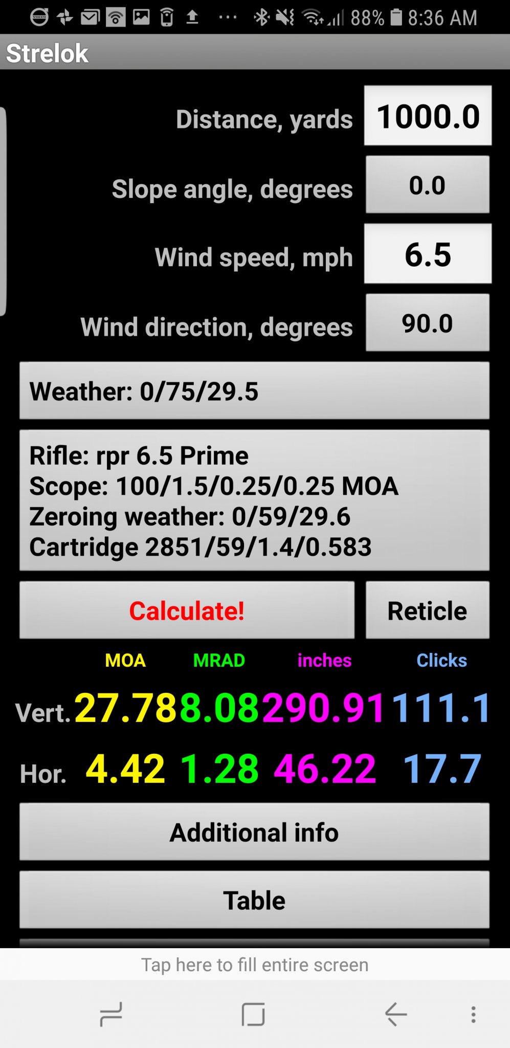

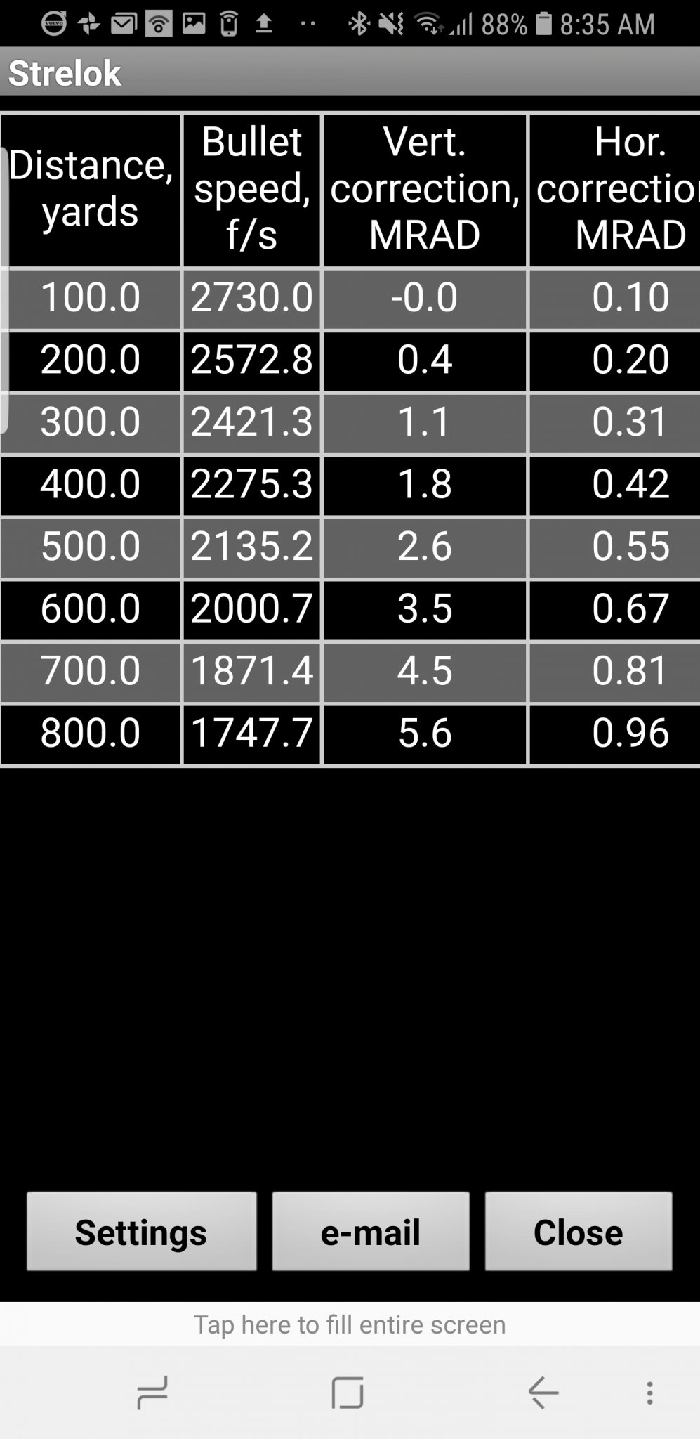

Ok, so I'm Strelok, this is what i have entered for my prime.
Which netted these results:
So for every 6.5mph increase I add 0.1 Mill up to 600 yards. Then do math on the reduction from full value if applicable?
So a 13mph 90 degree wind at 300 yards would be 0.62, tons to 0.6 wind correction.

No put in 6pmh what to you get -- completely forget about 1/2 mph stuff or this gets to0 complicated and can end up being slower than your solver
But ya-- in reality it is closer to a 5.75 gun but thats hard to half, quarter or use .75 value at least in my head - see above.

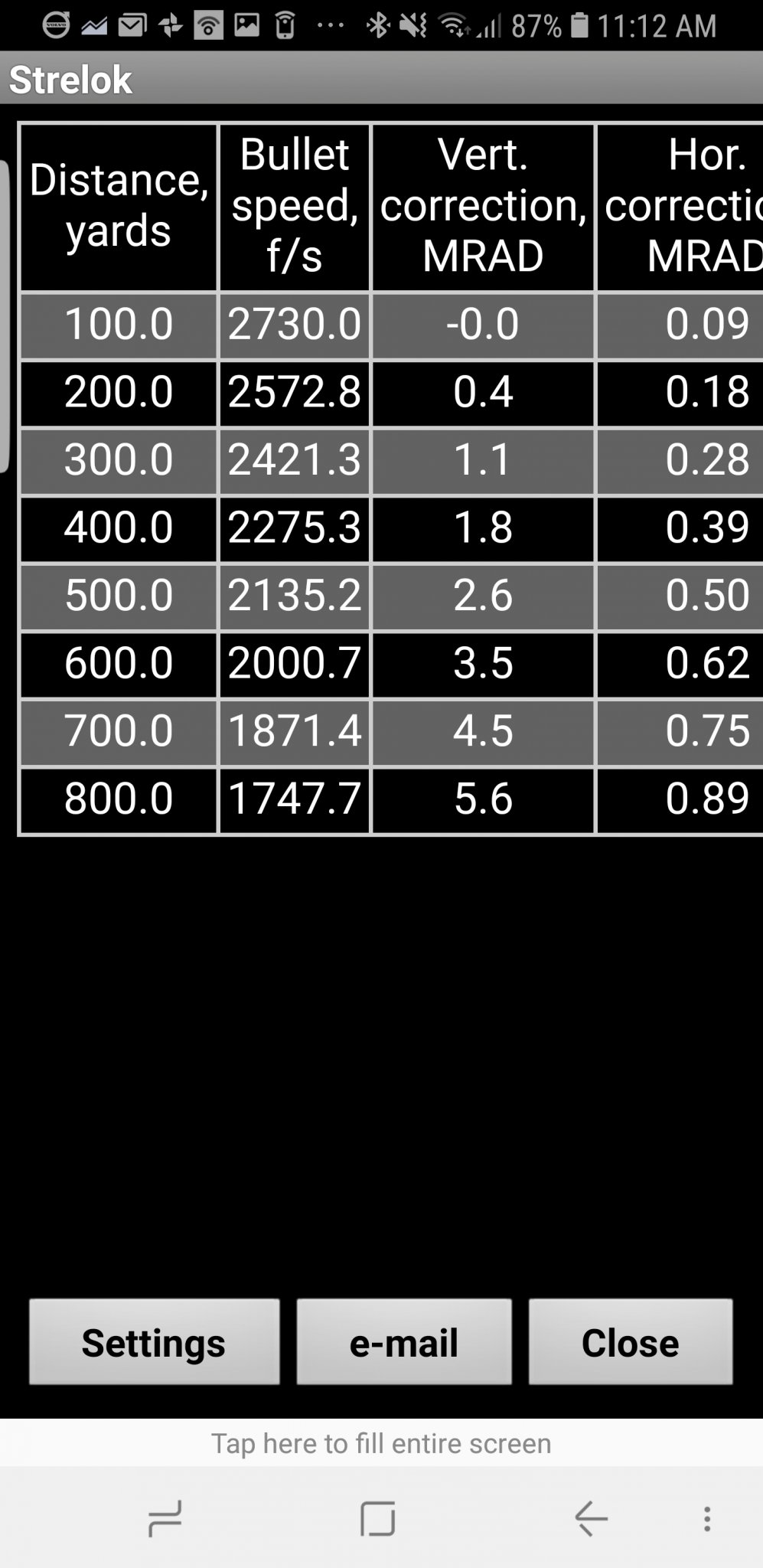

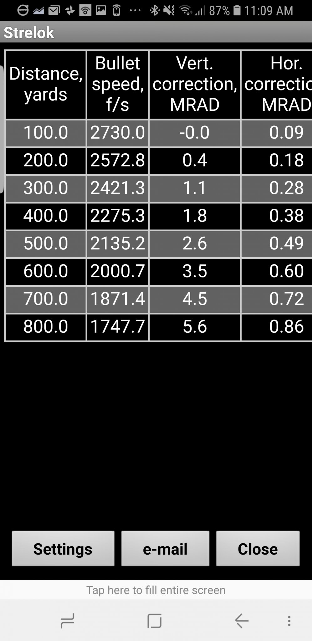

Ok, so I'm Strelok, this is what i have entered for my prime.View attachment 6970449
Why did you use 6.5mph? You have your altitude set at sea-level, so I ran your numbers in Strelok and 5mph gives you 0.99mils at 1000 yards.

Here's the 5.8, I used sea level because that is what the datasheet said the BC and Dara was derived.
Here is the 6.0.... this is all paper analysis, i would then need to true my MV for my gun at my alt and adjust, correct?
