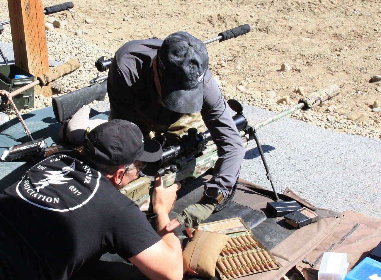

Body type determines the amount of height, but we still don't advocate laying on the rifle or melting into ground. Look at the images from class we posted its pretty clear, 99% of guys are too low.

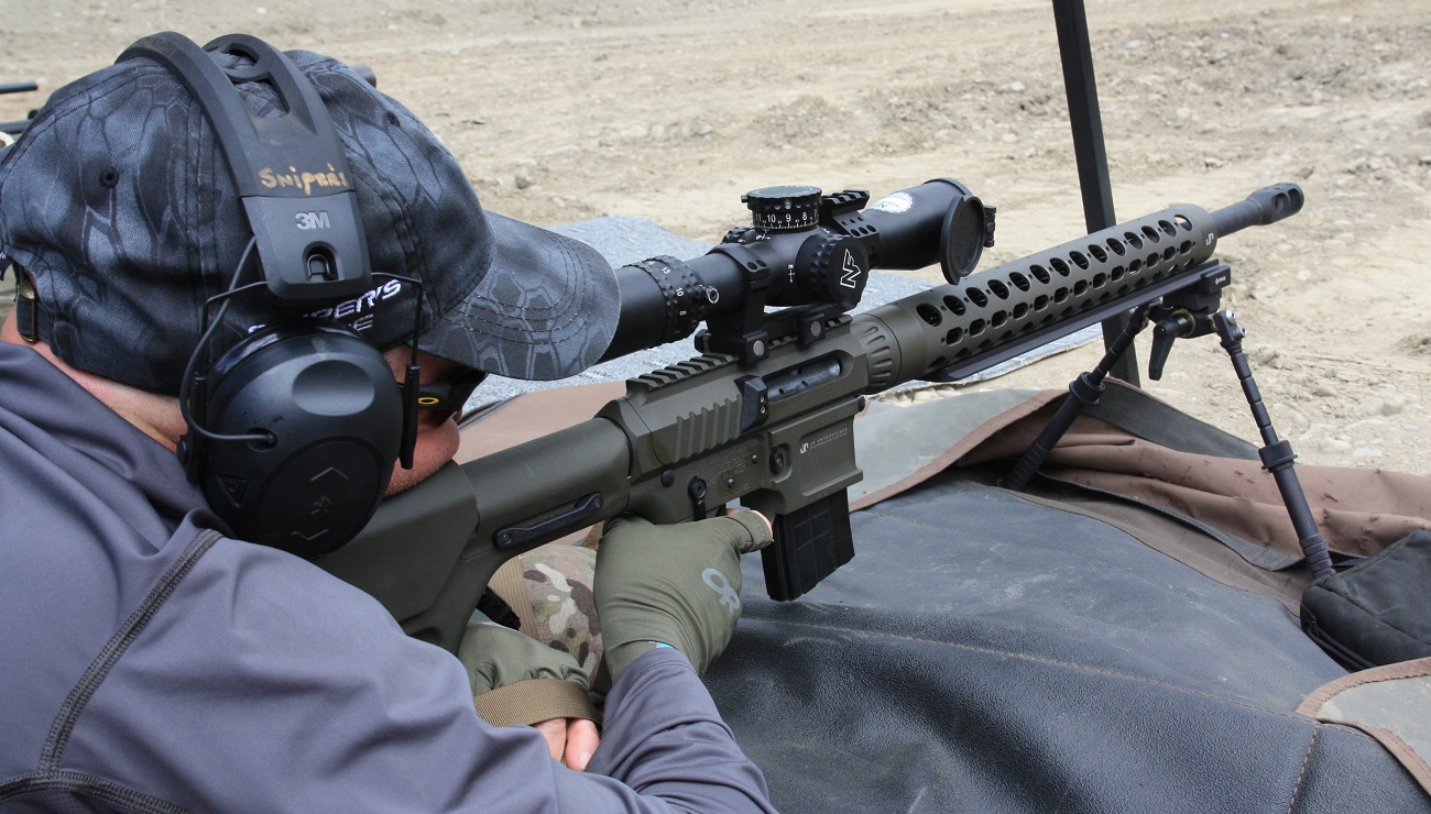

I'm the shooter in the top photo. What Frank and I do is start the shooters out higher than they are used to and work them down to where they are "comfortable" and in solid control of the rifle, directly behind the "line of departure". Shooters generally flop down and do not take the extra time to set up properly. In a learning environment, where they are behind the rifle for long periods of time, this is very important to consistency. As a comp shooter, all you have to do is approach the stage with your bipod already set at your comfort level instead of collapsed. As you can see, I have paint marks on my bipod legs for level shooting. I just extend until I can see the first paint mark and everything will be legit for me. Try this for yourself and you will see, in your living room, with an empty rifle, that you can be much more comfortable AND in total control of recoil.

Pictures really helped put the info I have heard you say over time into perspective. I'm jumping on the damn online lessons.
