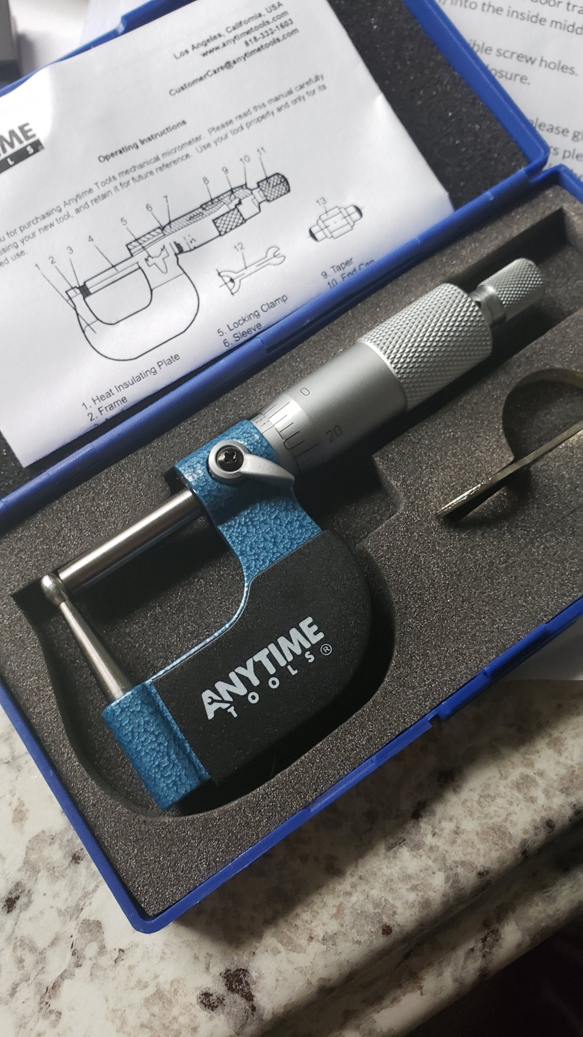

Should have clarified I have a magnetospeed v3 ( would love to trade for a labradar though) and a igauging digital caliper and an anytime tools micrometer. So far they have been accurate , but a mitu is in the "future purchase" bin.. after all your only as precise as you're able to measure.

Then you'd want to get a ball or tube micrometer to measure neck thickness. This one works very well for me: https://www.amazon.com/gp/product/B01524DDIO/ref=ppx_yo_dt_b_search_asin_title?ie=UTF8&psc=1
I would love to start turning necks .. I got that exact mic you posted to determine whY bushings to get and for future neck turning activities.
