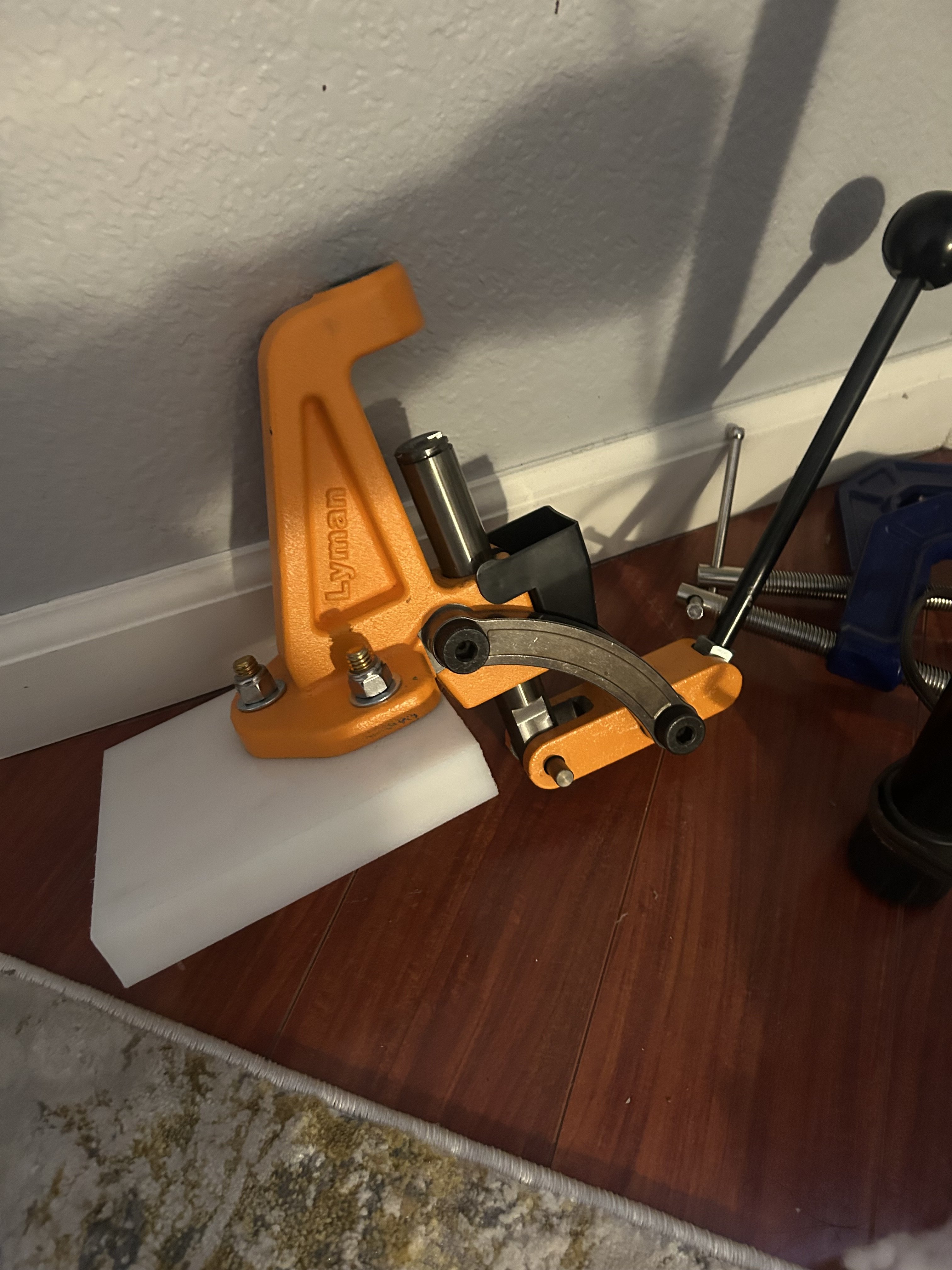

I’d recommend not spending too much money at first to see if you stick with it. Reloading ammo can be tedious detail oriented work so it’s not for everyone but at the same time it can save some money, be very rewarding, tune ammo to your rifle, and mainly enables you to shoot more. Start with a simple single stage press and if you stick with it you can start upgrading in certain areas
Below is an example of all the equipment you’d need to reload 223 Rem/5.56 NATO:
Total: $229

Yeah that’s a good point but most of the time those kits are well north of $300-400 and they usually come with a shitty scale, shitty universal reloading tray, shitty universal funnel, no calipers, no shoulder bump gauge, etc….but you can prob still find some on sale less than $300 and upgrade over time as you did. I guess my post is more of a custom kit that mainly needs an upgrade on the press and you’re almost set after that.

I loaded 223 with mine for a while but you def cant do large batches with it and your arms get tired as fuck especially during FL sizing but it’ll get the job done if on an ultra tight budget or very limited on space. That’s why I included the $100 Lyman ideal as an alternative if people want to avoid the hand press
