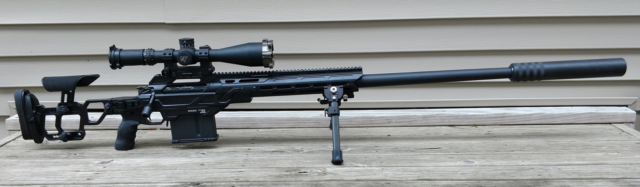

We are talking a Cadex shadow in 375 CT which has a 40moa rail. So here is what I am thinking, please sense-check and correct me if I go wrong anywhere... Plan is to shoot 1000yds plus in the beginning and then take it as far as I can once I figured out where.
Pictures of the Cadex happen to be 6 posts above so need for a new one.

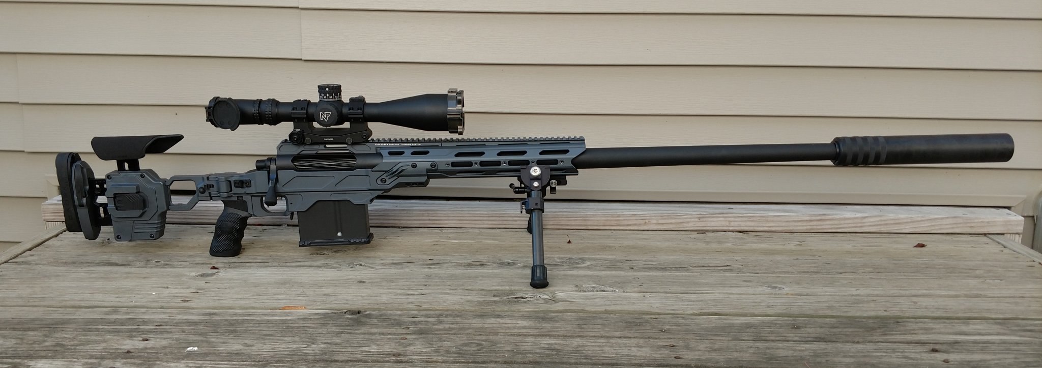

@MACHTECH nice looking rifles. Do you know your barrel diameter and lengths on both of those?
First off....Thank you. The barrels are both finished at 32" in length. They are 1.5" dia. at the breech and 1.2" dia. at the muzzle. Twist rate is 1:7.

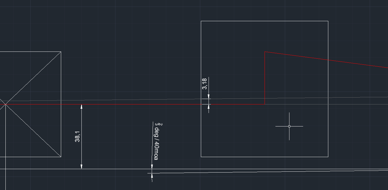

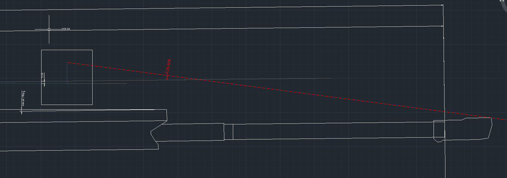

Ok so I have been doing some more thinking and OCDed it in AutoCAD :)
If the rail has already 40moa, I use a 27mil S&B scope, there is not much elevation I can get out of it with using a sloped mount (10 moa may already be too much) or the adjustable ERATAC. So my thought is, why not go with 0moa / 1.5in mount and should it become necessary use a rail mounted charlie. The Shadow's rail is long... and the Charlie shouldn't particularly care how far from the scope it is. So you can move it forward and not need a Delta... like ever. Like here:

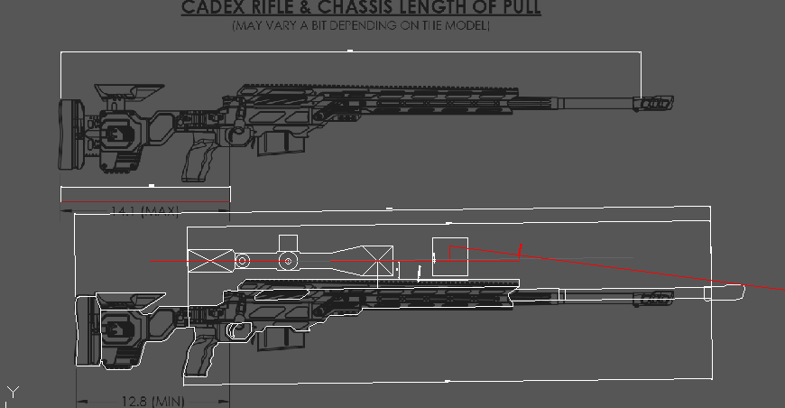

I only found a length of pull "drawing" from cadex, which shows another rifle (if anybody here has better blue prints - please send). So I traced that, adjusted the barrel length that the folded dimension matches... Scope is to scale, Charlie is a roughly estimated box :p This is not gonna be accurate to the 1/10th of a mil but the general idea should be clear. Red is line of sight with the charlie maxed to the edge of the muzzle brake.
That gives minimum 7 degree downwards angle which is 120+mil. As I said, I dont have any illusion that this is 100% accurate but honestly if it is 100mil or 150mil... Way more than enough. The distance the charlie is sitting now is also within the limits of +/-3mm up and down for the scope that Tacom says is the optimal range when you turn the turret. And that is also worst case assumption that the mil up and down have the elevation turret as a center...

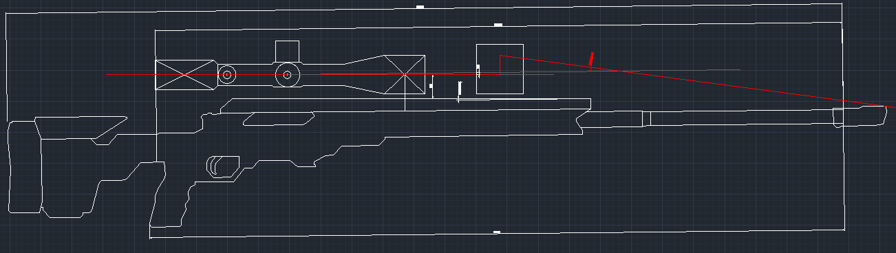

So I am thinking go with 0moa mount, 1.5in high - charlie on the rail later if needed...
Trace sketch:
Line of sight through Charlie (rough estimate)
That is around 8degree downward angle...

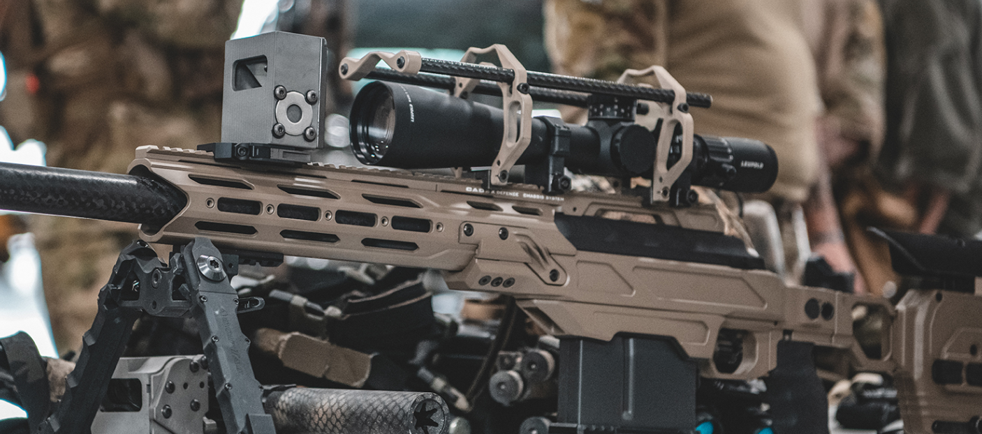

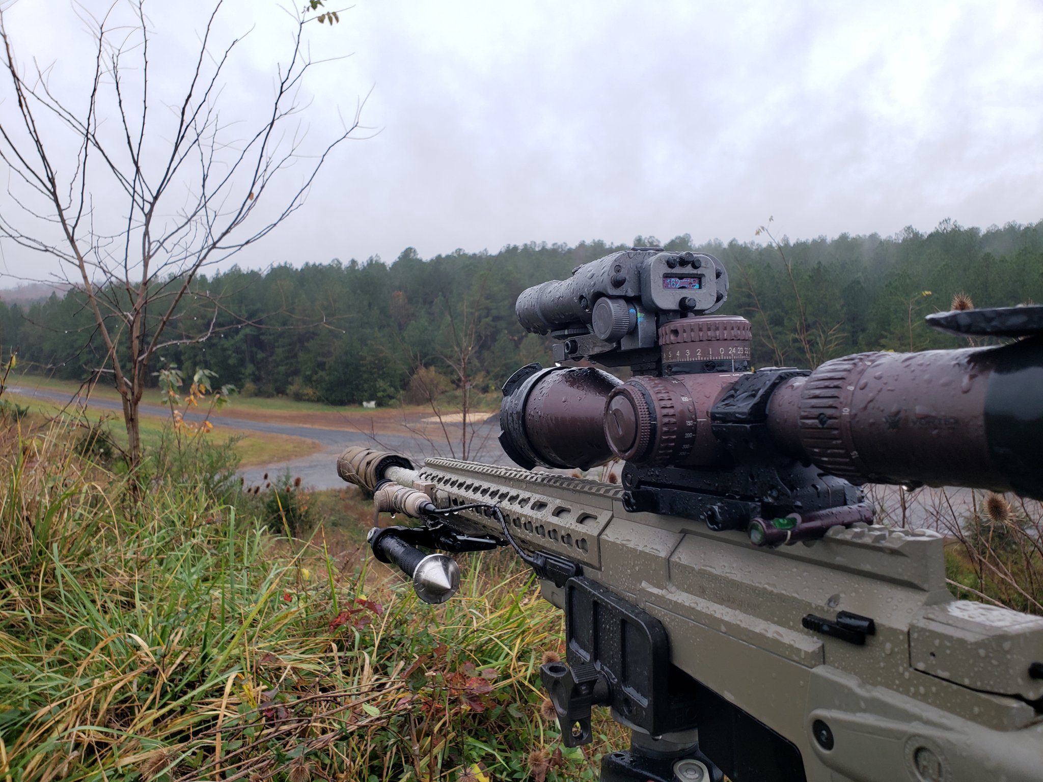

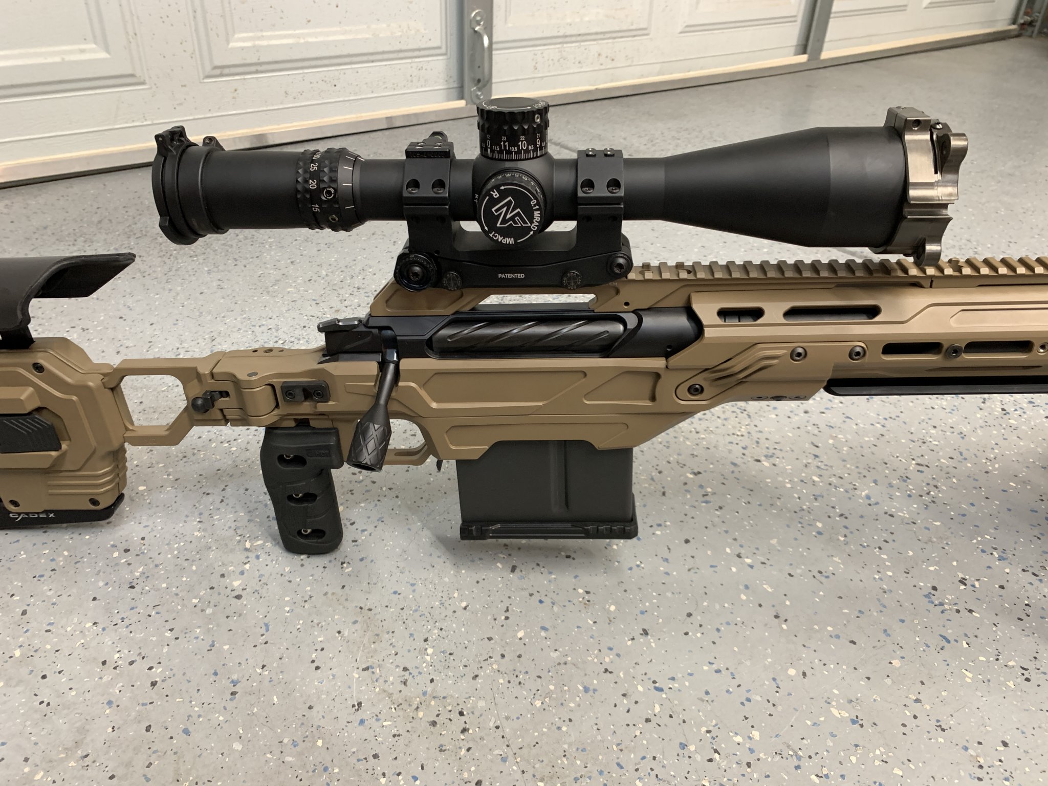

Full length pic rail with an objective mount Charlie, I’d get the 30mm height like mine pictured above. Just make sure your chassis cheek riser can go high enough.
If you go with a a rail mount Charlie, you can easily get away with the 25mm. Not sure if you’ll clear the 20mm.
Note: I gave you height in mm per Era-tac part numbers. If you buy from Eurooptic, they tried some weird conversion method to get the numbers in a more familiar format for us here in the US market but only made some of the conversions and made it confusing. Just focus on the part numbers ending in 20, 25, and 30.
One last thing, they make an MRAD version too so make sure you get either MOA or MRAD so that it matches your scope.

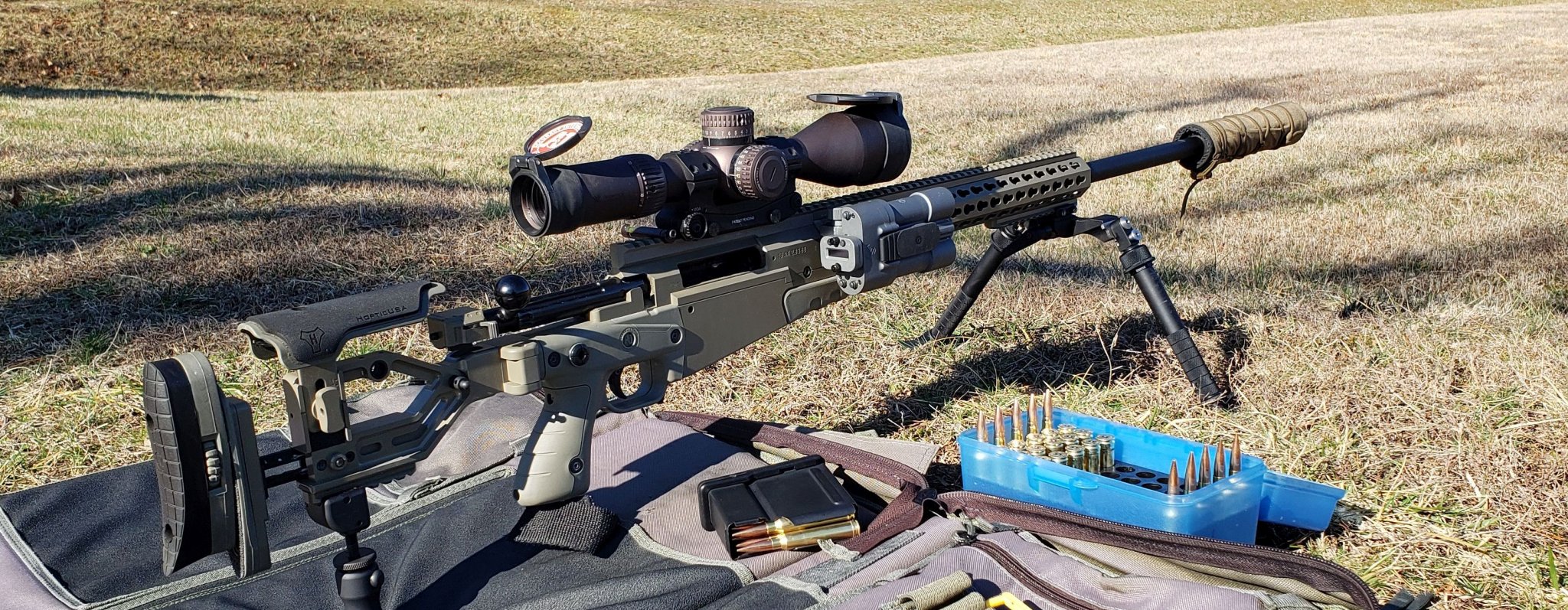

Thanks! The grey one is a cdx-50 that has been rebarreled to .416 barrett match.
