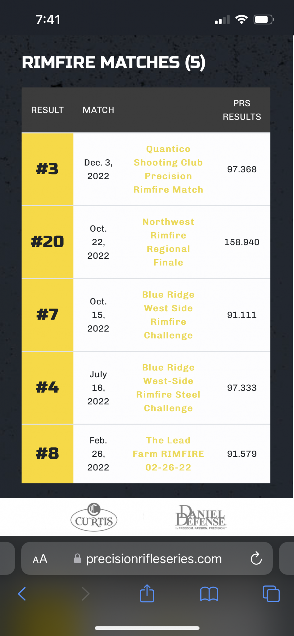

Winning matches??? 🫣

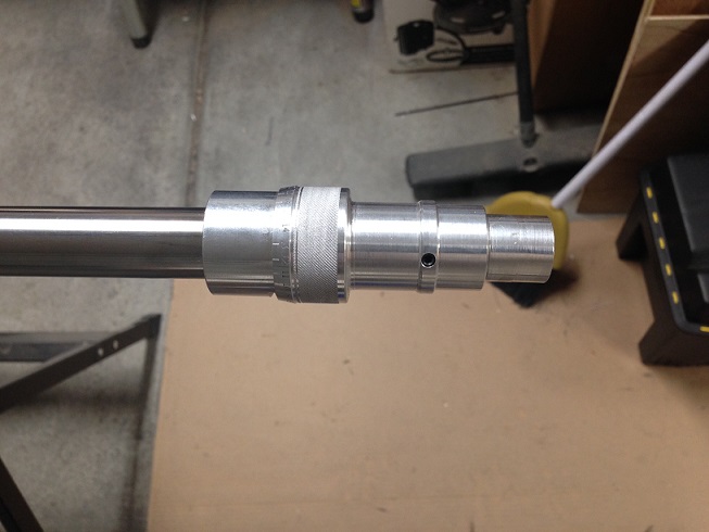

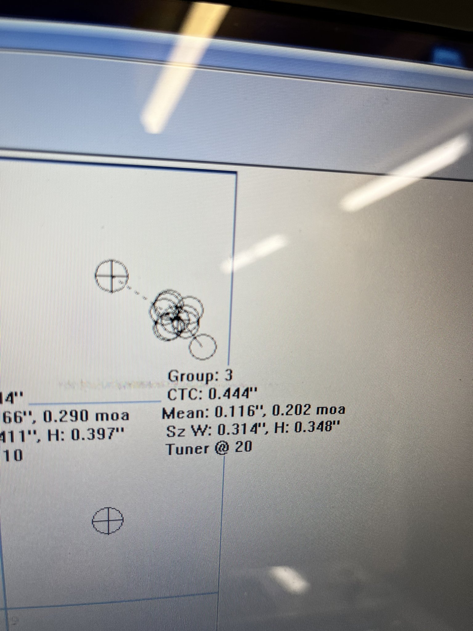

Picked 5 random lots and fired 2 shots from each lot for a 10 shot group at each revolution. Found the revolution that grouped the best and then tested all around that area until narrowing it down to the final setting. That’s the short and sweet version anyway…
Attached pic is 10 shots from 5 random lots. Lot speeds ranged from 1050-1085 but if you know Eley ammo that doesn’t mean anything. He isn’t the only person that tunes like this as I have read elsewhere of this method. I like having him do the tuning because it takes a lot of the variables out of the equation.
Without a doubt it works. I had a baseline on some Tenex that had before going there and was totally unimpressed with the lot in this rifle. What was a great lot in another rifle wasn’t even a player for practice ammo in this rifle imo. After him tuning the rifle the same lot is printing .75 average 5 shot groups at 100 yards.

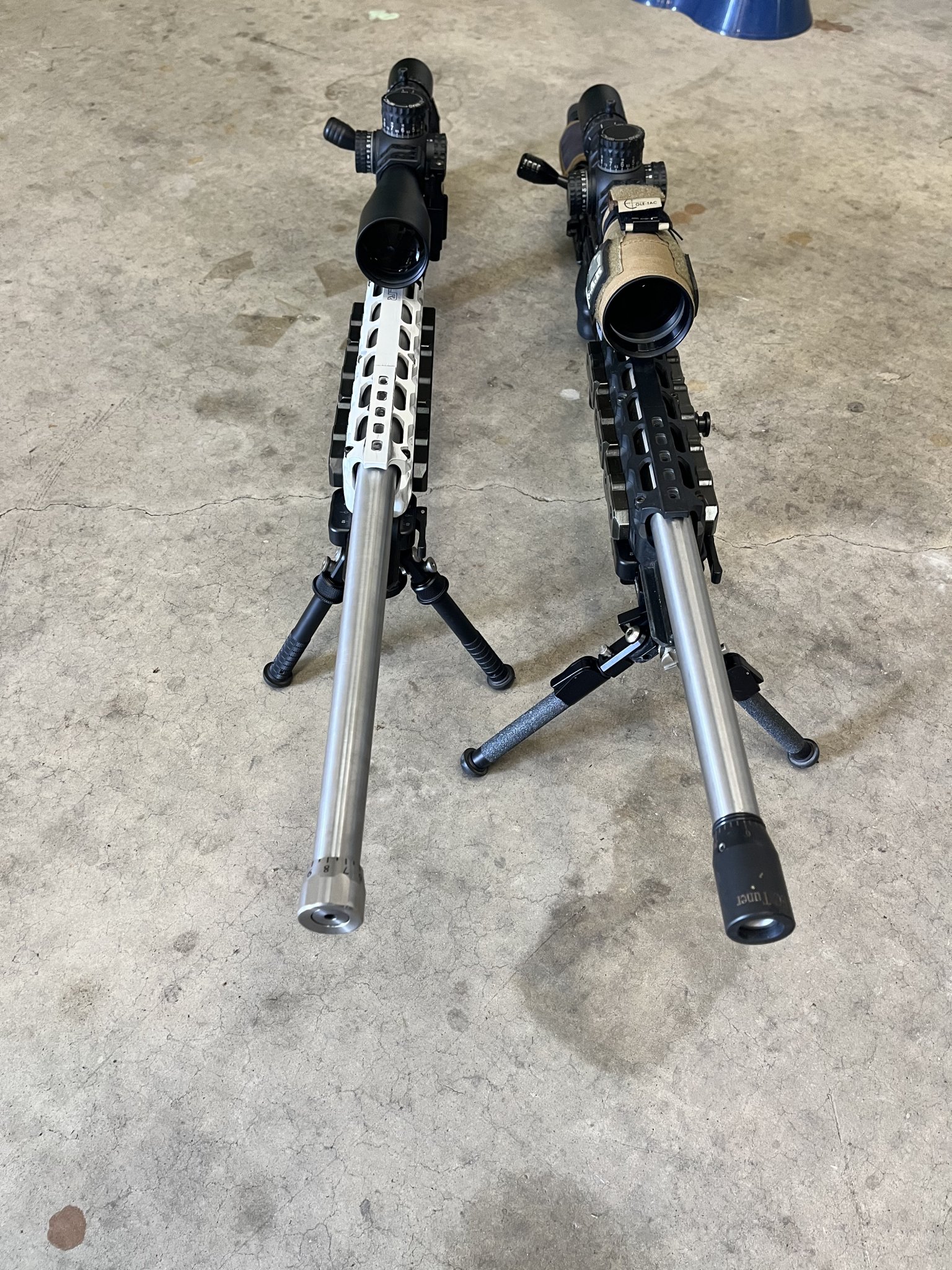

For what it’s worth I have 2 Vudoo rifles chambered by MCR with Krieger barrels. One at 25.5” long and one at 27” long. They both shoot the same lots of ammo equally well. Really tough to pick the best rifle. The 27” shoots some of the lots from the 25.5” better than it did. But…. The lot that was tested at Eley for the 27” the 25.5” shoots better. 🤣
Both rifles are exactly the same otherwise and both wear a 7x35 ATACR. The pic with the 4x20 was just when I slapped it together.
