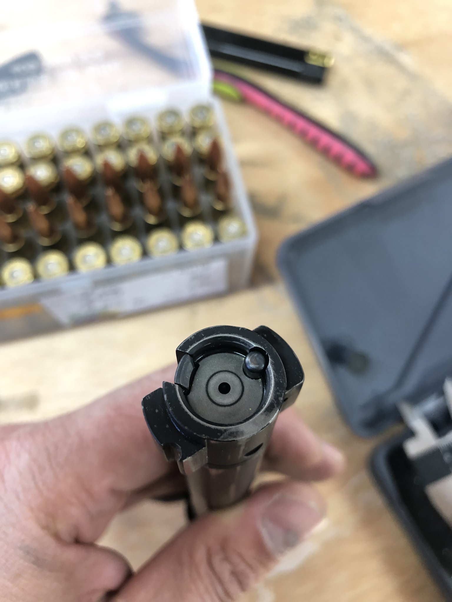

Gents,
After my last range trip I noticed what looks like an etched bolt face from leakage around my primers. Federal cases (308win) have only been loaded twice so I’m assuming this is because of pressure and not loose primer pockets. I’ve looked at case heads under a loop and seen no other signs of pressure.
I think this is happening due to too much jam into the lands. Chamber is cut using LRI’s “sniper reamer” for 165 smk. I measured a distance from bolt face to lands of 2.1770. My reloads using 175smk measure 2.230. means I was into the lands 0.05. I’ve backed off to a length of 2.220 which matches factory federal 175smk ammo but that is still a jam of 0.04 into the lands, which I’m concerned is still too much.
any advice?

.050" jam? I'm guessing the bolt is a little hard to close if you are running any kind of neck tension. I have to ask why you would want to run like that? If you chamber a round and need to extract a live round, I'm sure the bullet will stay in the barrel.

You would think so, but no. No issues closing the bolt or extracting a live round. Though when I do extract a live round I can see the marks from rifling on the bullet jacket, which is what clued me into this in the first place.
That’s etching? It looks perfectly formed. Can you feel it with a fingernail? Does it run away?
Put a new primer in the case, are they loose or can you still feel some resistance?
Yes. Can feel with fingernail. Looked at it under a hand lens too. Perfect groove.

@hotload you are getting some harsh treatment but it is for your own safety. What is your reloading background? Either you are fairly new or overconfident. EVERYTHING affects your load. Change the primer, start over. Change powders, start over. Change cases, start over. Change bullets, start over. The only thing you can change without backing off your powder charge is seating depth (excluding jamming into the lands). You should find a mentor or take a class, there is a lot of knowledge transfer that only happens in person. Every reloading manual will tell you the maximum loads are for the exact components listed and that you should back off 10% and work you load up by testing yourself.

Ok, if your bolt face was being etched as you say, the holes around your fired primers would be black from gas escaping. I take it is a Rem 700 bolt, have you owned it since new? How long has it looked like this? It would have started with pin holes in random locations, and steadily gotten worse.
Your primer looks good, no gas IMO, I say what you have is a shitty bushing job.

This is a 700 bolt (tac30 action). I am original owner. The ring in first pic is from 30 or less rounds after last range session. It wasn’t there, and now it is. No bushing job on this bolt. Factory format from Stiller.

I am no gunsmith, but I think I am smart enough to say that did not happen in 30rds of abuse, now I am not questioning you either. It is too perfect, and unless your fired brass shows signs of gas escaping, no way.
I think you have gotten some wayward advice in this post, have someone qualified inspect that bolt, because if it is by chance etched, it has been seriously compromised IMHO.

At 2.82 COAL, you are probably just barely touching with the 175SMK, if its the same reamer LRI used on my .308. I can't imagine you would be jammed .05 at that COAL.
That would explain why I can load/unload without trouble but have spiked pressure.
So the consensus here is start over in load, reduce coal, and have gunsmith inspect bolt?
That mark on the bolt face isn't going to hurt anything. Odds are you had one bad one that caused that. I ran into a bad lot of Winchester primers that made the bolt face look worse than that before I noticed it. I also have a bolt look like that from a combination of loose primer pockets and a build up of carbon in the throat. There are threads about it all over the internet and that look a lot worse that people are still running.

Any chance that your bolt has a coating on it? The ridge looks like the primer, case contact has polished the bolt face and left a ridge of coating.?? I am not there, 2D picture and all, Ceracoate and such being common...
Ok I would then look at a carbon ring starting to form in the throat, as mentioned above, I have a 338 that the throat is exactly the bullet dia for my SMK, It is very sensitive to carbon, Gives the appearance of jamming the lands, when it is not. It is jamming the throat and carbon id, then bad things began even at minimum loads. Scrub the crap, carbon, out of the throat, and or get borescope to check throat condition. This is after eliminating all the other variables mentioned above. You mentioned the really short coal measured with your Hornady tools. You may be really close to the answer. If it is carbon, it is a MF'erto get out, or I just am a lousy bore cleaner, Hahaha I hope it is something simple.
This is where my money is. If you look closely at the bolt face, you can see that the bolt has a coating on it, and that it has been worn off in places. Inside the recess, you can see that the coating has worn off exactly where the case head would be during firing.
I like the outside the box thinking, but no. No coating on the BF. If you look at it under a hand lens, it looks like a micro torch cut a perfect circle rather than a raised surface where coating would be after everything around it wore off.
Spoke with Greg Tannel, his opinion (from the backstory and photo) is that its cosmetic damage only. Lesson learned. At least I caught it early. Also, I found the Primal Rights article on pressure to be extremely useful. Although aware of the importance of pressure and obvious signs of pressure like sticky bolt lift, cratered primers, s[lit necks, etc, I was not fully learned on how subtle the signs could be. It took a magnifying glass to really see them.
