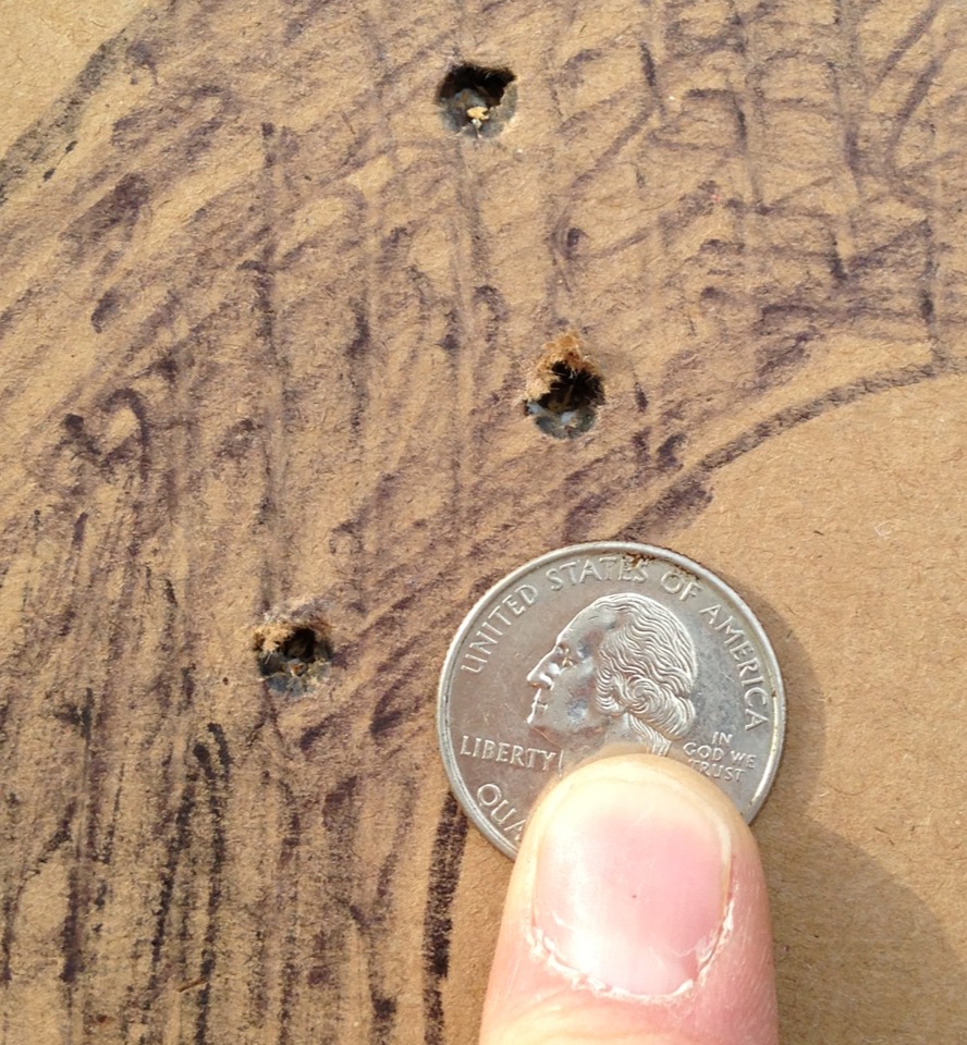

Well a little more testing and I'm thinking the 73's will work. This was at 350 with a left to right wind from 5-15.
