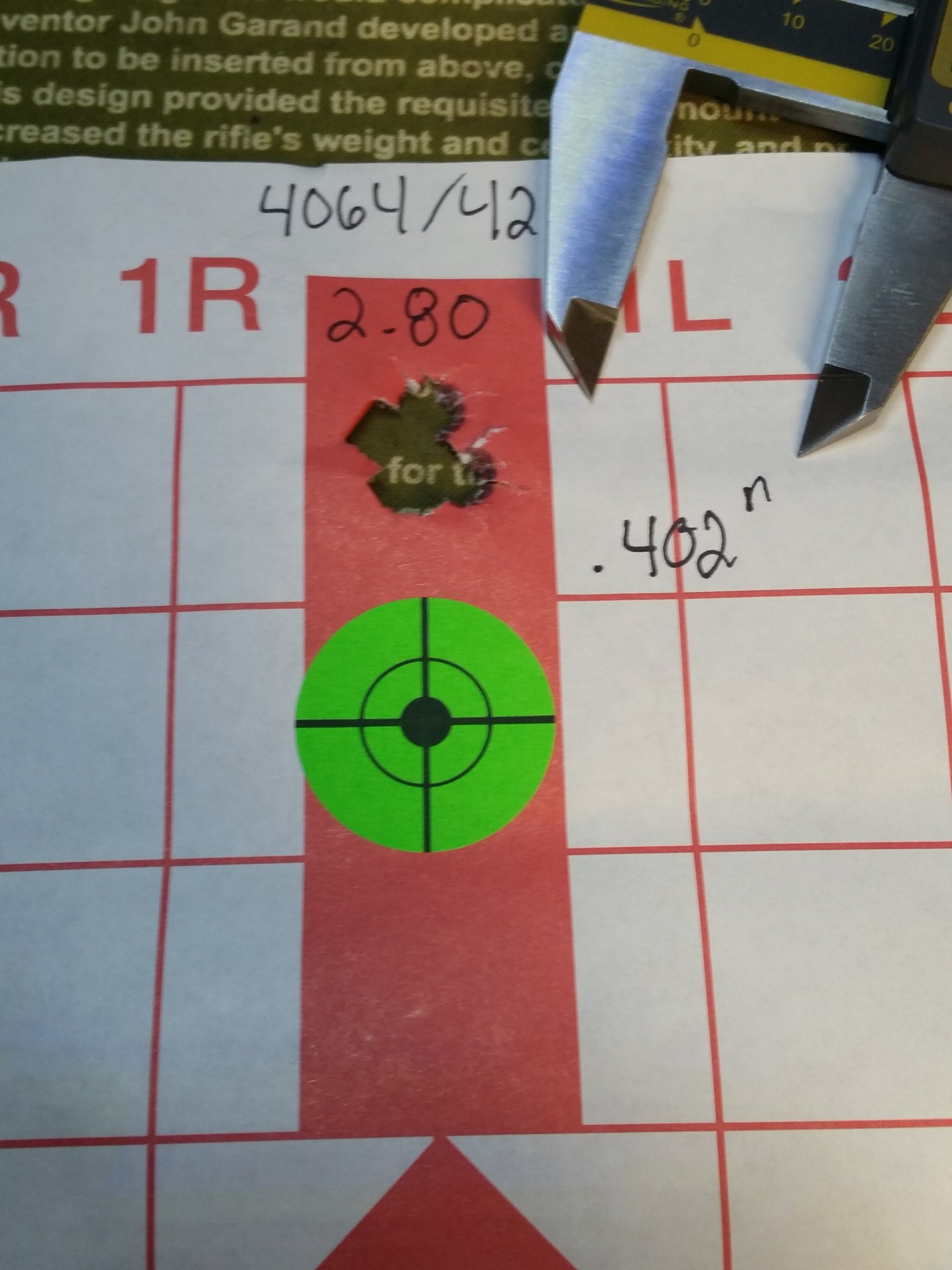

Just a brief post update. Had the rifle back out today. Had 9 loads to run through it hoping it would like one of them.
Have to mention all I did was reseat the action in the chassis. Oh, and retorque the optics, rail, rings etc.
First load right out of the Sierra manual. 2.80" / 42.2 grains of 4064.
She's back.
The other 8 loads were decent too. Shot an avg .77" group today. That's about what it shot on avg in the HS Precision stock.
What went wrong last time? Not a clue. Will I still skim coat the action.. maybe.
Have a great day guys.
