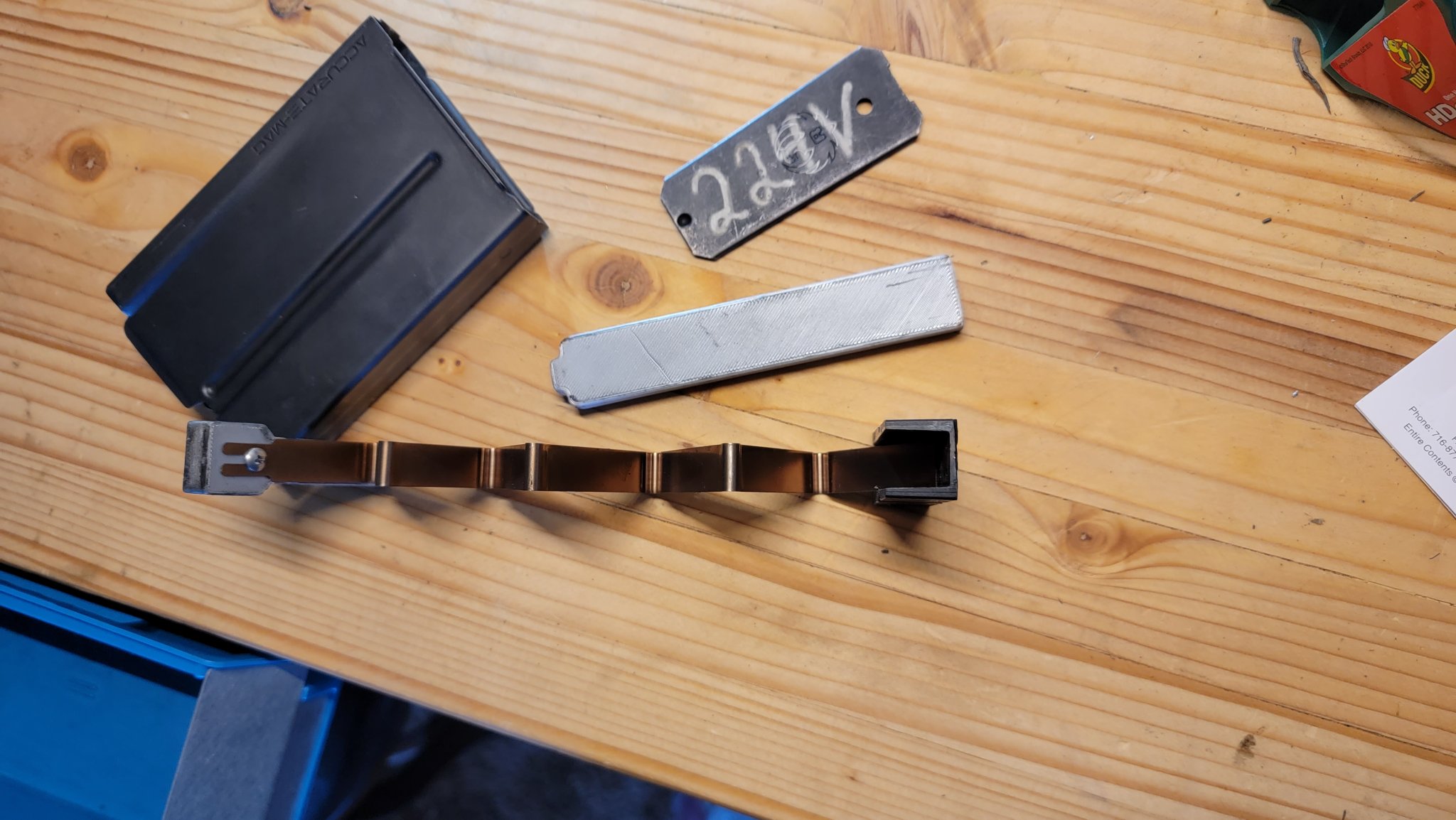

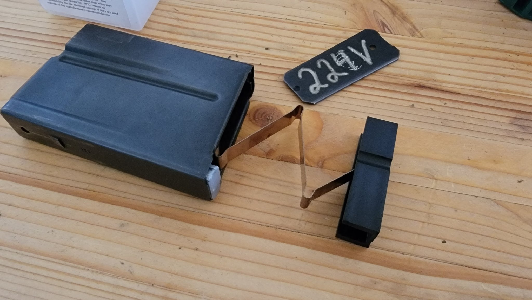

    So as far as mags go. I've got the primal rights 6br mag kit, adjust feed lips etc...
    But here's the real kicker...
    The little plastic block that comes in the bottom of the accurate mags is a life saver and keeps the spring centered. I had to hack it down but it's amazing what it'll do for those "double feeds". Any bit of cant on that follower really seems to screw you.

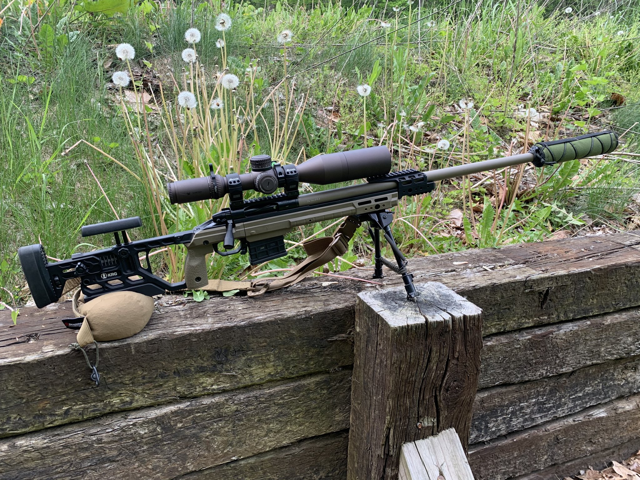

    Love the Valkyrie, been shooting it in a bolt gun since shortly after it’s release. For economic long range shooting and training it’s a phenomenal cartridge. I shoot the 88’s at about 2820, due to availability and cost of projectile. I haven’t seen any brass in a while and Starline quit taking backorders recently. I hope manufacturers haven’t totally given up on it.

    Ya there are viable magazine options for clones,
    it's the double-stack AI / AX MAGS that are the issue, getting them lock up
    My Bighorn Valkyrie in an AX Chassis runs flawlessly, it's my AX that needs a magazine

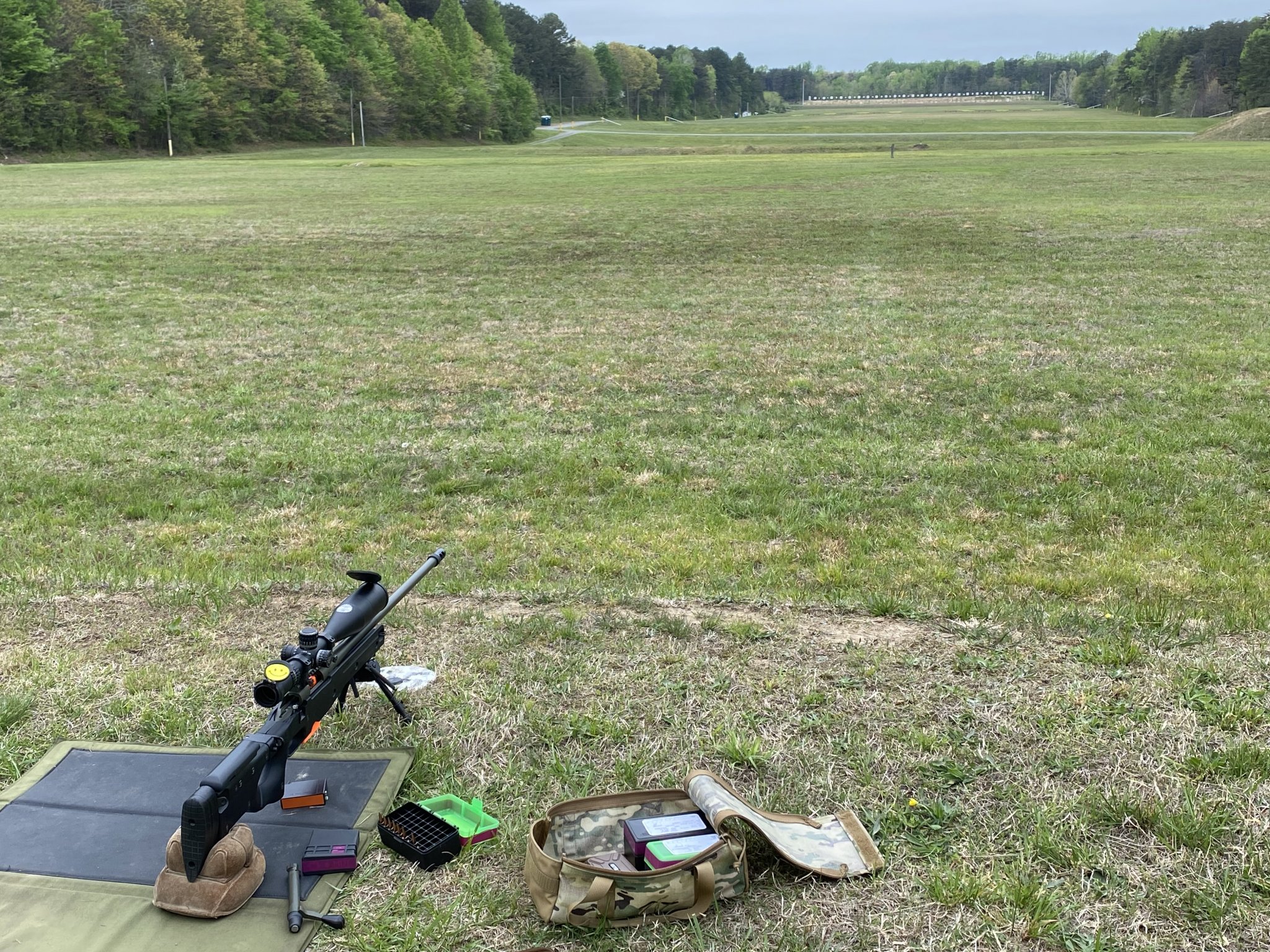

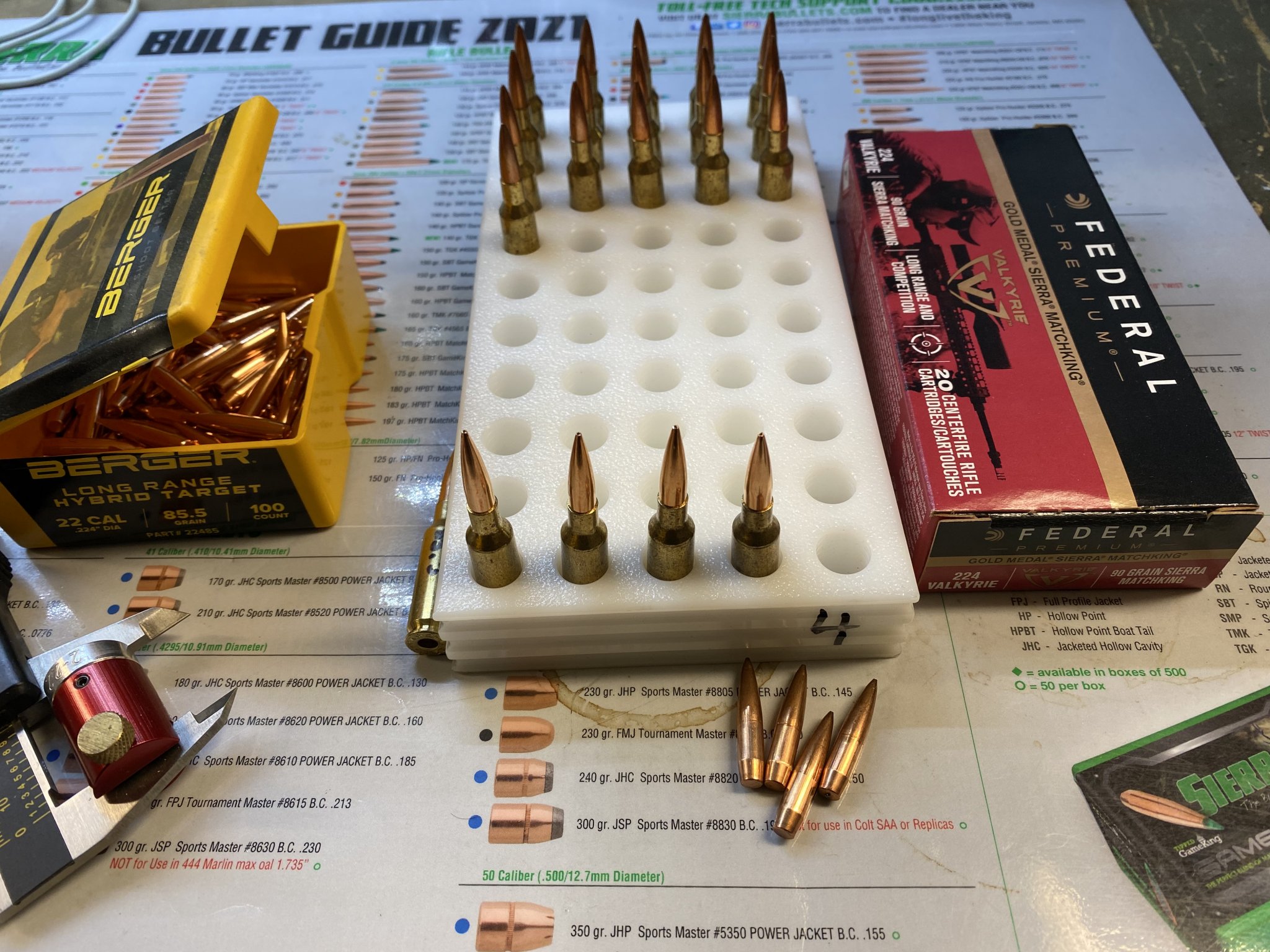

    I’ll be shooting on Quantico Range 4 this Sunday and I figured I’d chrono it and then give it a try at 1000 yards. It’ll either be awesome, or not, at 1K.
    Edited to add:
    85.5 Berger Hybrid Target
    COAL: 2.427
    CBTO: 1.877
    .015 off lands
    Left 85.5 Berger Right 90SMK
    I’ve been running 90VLDs over RL17 @ 2775 with my 224V bolt gun during load development but I haven’t taken it past 100….
    Reactions: MarshallDodge

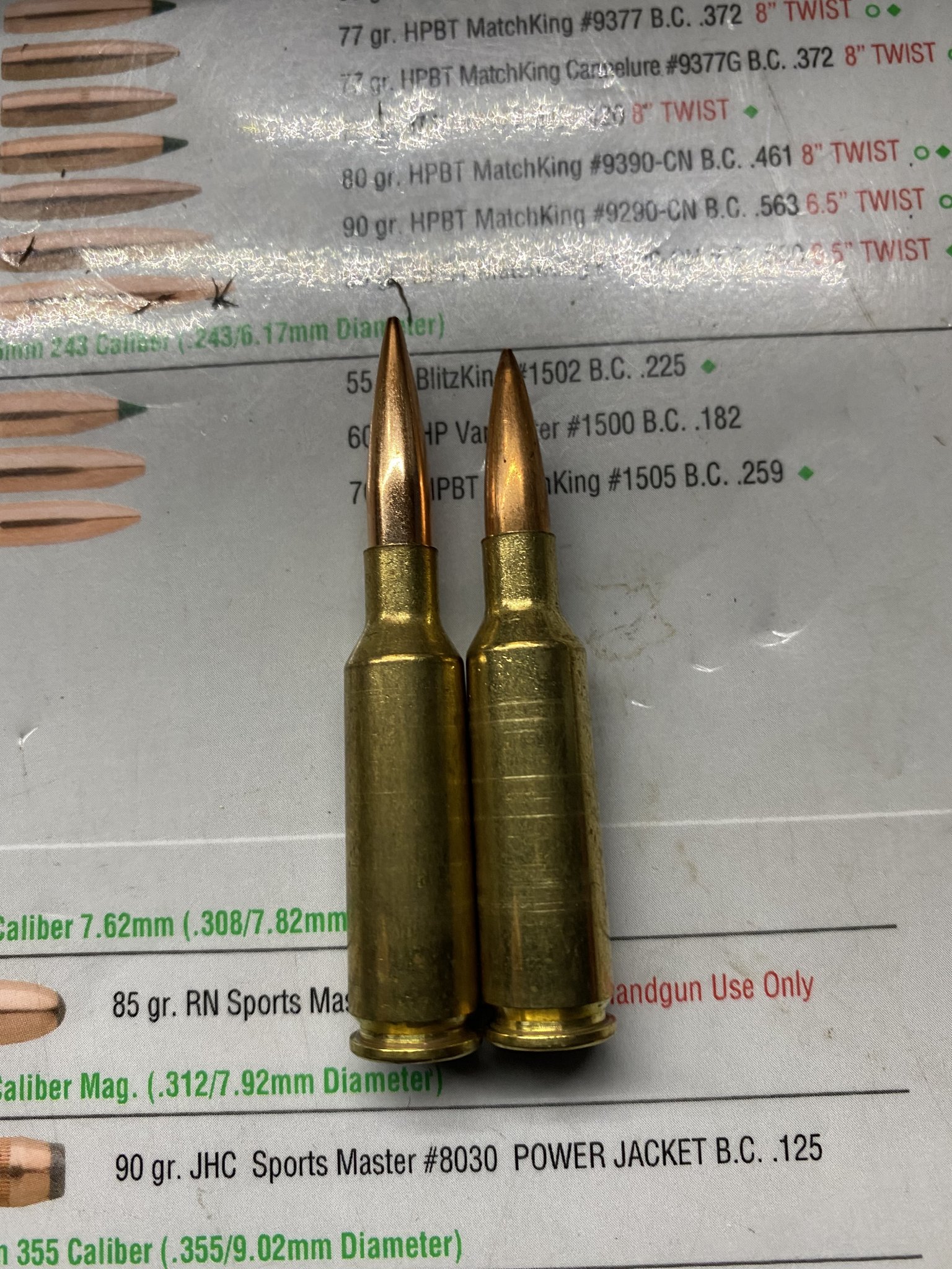

    Making Berger 85.5 Hybrid Target ammunition out of Federal 90SMK ammunition…..
    That's a pretty cool idea. Are you worried at all about neck tension after pulling the factory loaded pill out? I guess it would be easy enough to hit it w a neck bushing if a guy was really concerned about it
    Nice !!!
    Well definitely keep us informed I am excited to see your results and plan to do some of my own
    So I made it to Range 4 this morning and was pleasantly surprised the “Mexican Match” w/ 85.5 shot as well as it did at 1K…
    It was a perfectly overcast day (55F) with a DA of 340 and negligible wind from 11:00.
    Over a series of 18 shots (my LabRadar trigger shit the bed on shot 19) the 85.5 Bergers ran an average of 2757 FPS with an ES of 26 and an SD of 14.8: not bad for bullets reseated in factory loaded cases with no prep and inconsistent neck tension.
    I kinda’ thought they’d be faster..,
    I was shooting and 25x15 IPSIC: elevation was 9.5M (32.5 MOA) and I held left edge for windage.

    As far as the Mexican Match part of the experiment goes, I think the 85.5 Berger Hybrids reseated in the loaded Fed 90gr ammo is a success, despite the semi-anemic numbers.
    So which mag are you running with the Bighorn?
    Don’t want to answer for Frank, but I have no issue with accurate mags or mdt mags with the primal rights kits and modified feed lips in both a MPA and MDT chassis rifle with a bighorn TL3.
    Reactions: Diverhunter
    I use the MDT,
    I have the plastic 224V that I used in my Bighorn, the 223s work, the 6BR,
    In my AX I am using a modified MDT 6ARC Mag, I ever so lightly trimmed the feed lips and took a little off the plastic insert. It's not perfect and I need to trim a bit more as the bolt will drop the mag every so often
    The AX is accurate, works, but does not feed well, the Bighorn is flawless

    My first rifle in 224V was the Uintah Precision bolt action upper for the AR-15. For the price it wasn't bad but kept having problems with feeding from the magazine. The 88 ELDs were especially problematic.
    Regardless, I felt the 224V had a lot of potential. At the time, the cost was very attractive. I could purchase the factory Hornady 88 ELD ammo cheaper than Federal GMM 77 SMK. Within a few short months, I purchased over 7,000 rounds of that ammo and haven't regretted it.
    Like @lowlight, I had a bolt action built around the Origin action with Krieger barrel 1:6.5 twist with a TriggerTech trigger in a KRG chassis. The MDT magazines work flawlessly.
