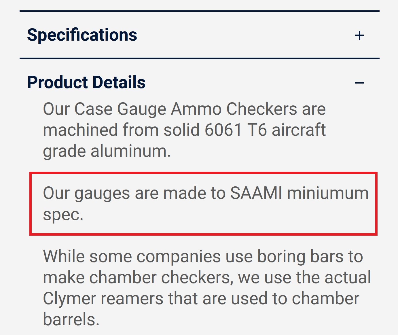

If that reamer is a zero freebore .223, then it should be good to go.
My point is that possibly the OP doesn't understand (or didn't take into consideration) what SAAMI specs actually are.
The TLDR version is they list the dimensions yes-- but its a RANGE of dimensions of acceptable tolerances. In other words if the wigit falls in between X and Y measurements then it is 'in spec'.
This gauge is supposedly cut to the very minimum of that range. Unless the OP has a chamber that is cut to min spec (on this rifle or any other) then the ammo is more than likely just fine and are not 'rejects' at all.
If I were manufacturing ammo on a commercial scale that will be sold to tens of thousands of people, then yes, it's worth the effort to make all the ammo to absolute min spec dimensions. For the average person that has anywhere from one rifle to 20 of them, it's not really worth the effort to chase down all the tooling needed to match a gauge.
Also, unless the brass is all from the exact same manufacturer and the exact same lot #, then chasing down every little nuance on 'mass production' is going to be difficult.
This is a situation where 'good enough' definitely applies.
I will go ahead and add the caveat that these types of gauges are NOT meant to be a 'good vs bad' ammo checker in an absolute sense of the word. Not at all.
They are more like 'guidelines' to see where you are at--and this is especially true in the context of being an at home reloader.
To go around loading ammo and every single case that doesn't fit exactly flush, to toss it out as a 'reject' isn't a good idea. This is especially true when using range brass or mixed brass or something like that.
This type of gauge allows the reloader to pick up on any major defects rather quickly. It should not be treated as the final arbiter of all things 'good'.

The gauge only confirms that the ammo fits in the gauge.
What is the relationship between the gauge and the chambers and the rifles it is meant to represent? If the only answer is “they all have the same cartridge markings” then we are back to my first statement.
If all of the rounds that failed the gauge fired fine in your rifle (15%), then your gauge has an observed false negative rate of 15%. Is that acceptable for the gauge meant to confirm ammunition functionality?
Case gauges are designed and intended to check and insure the case will fit in a SAAMI minimum chamber. Most commercial chambers exceed the SAAMI minimum chamber so just because a full length sized case doesn't fit the gauge doesn't mean it won't fit the rifle, especially in a rifle it was fired in. Neck sized cases almost never fit the gauge but can usually be fired in the rifle they were fired in.
With semi autos it not unusual for the case rim to receive some damage (often a burr) and often though fully sized will not fit into the gauge.
Take a look at the the cases that don't pass. If I run reloaded round throught my Dillon case gage, sometime there is just a little "tag" on the case rim where the rim is larger than standard in one small spot. But that case will actually fit fine into the rifle chamber, and feed/fire/extract, etc.

The problem, especially with semi auto rounds, is that the ejection begins with some pressure left in the barrel and the portion of the case just above the web becomes unsupported and the brass expands. Also semi auto chambers tend to be a little more generous in terms of dimensions (other than headspace). Some dies do not size this portion of the case enough. This is why small "base" dies exists. If most of the resized brass fits it's likely that this is the problem not an issue with the datum dimension.
This is easy to check with a caliper. Simply check the diameter at the base (not rim) above the extraction groove (0.376" dimension) and if any part of the body is larger than that dimension then the case is blown out and not resized.
