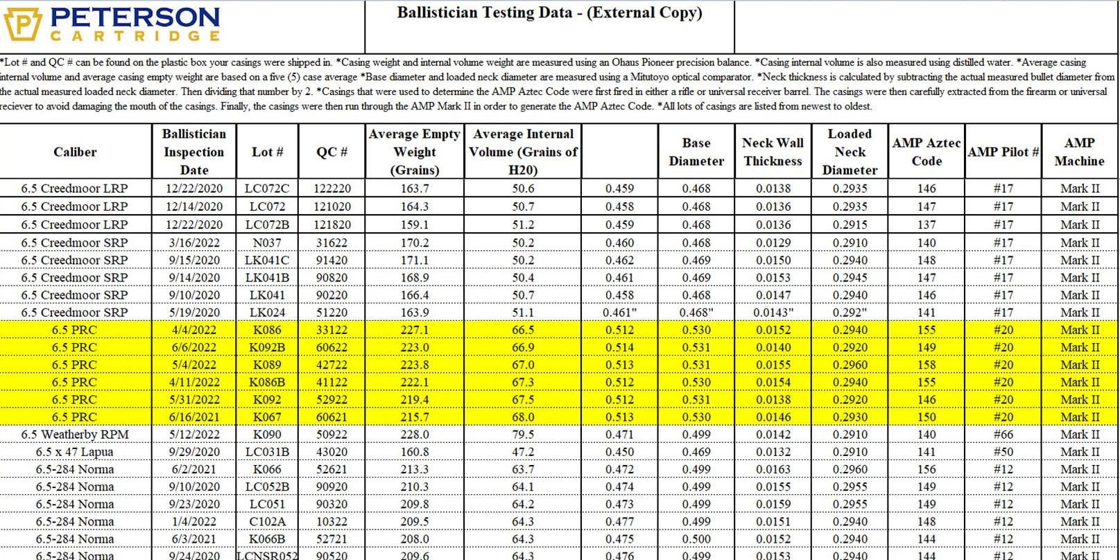

When you get new lot of brass, there can be significant differences. Like neck tension could be much more than you set your other brass to (like, .003 - .005). Primer pocket depths could be a little different and certainly, case volumes are often different, as you can see in the pick below from Peterson Cartridge Co. These things will effect your results until you make adjustment accordingly after you've fire formed your cases.
