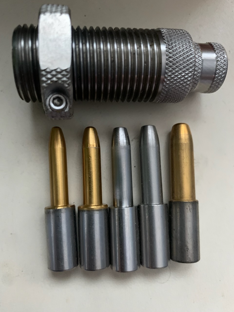

Turning arbors
Sinclair mandrel die and whatever turning mandrel (-.002) I have (stainless, carbide, etc). If I’m playing with lighter neck tension, I’ll use an “expander mandrel” (-.001).

Steel and TiN

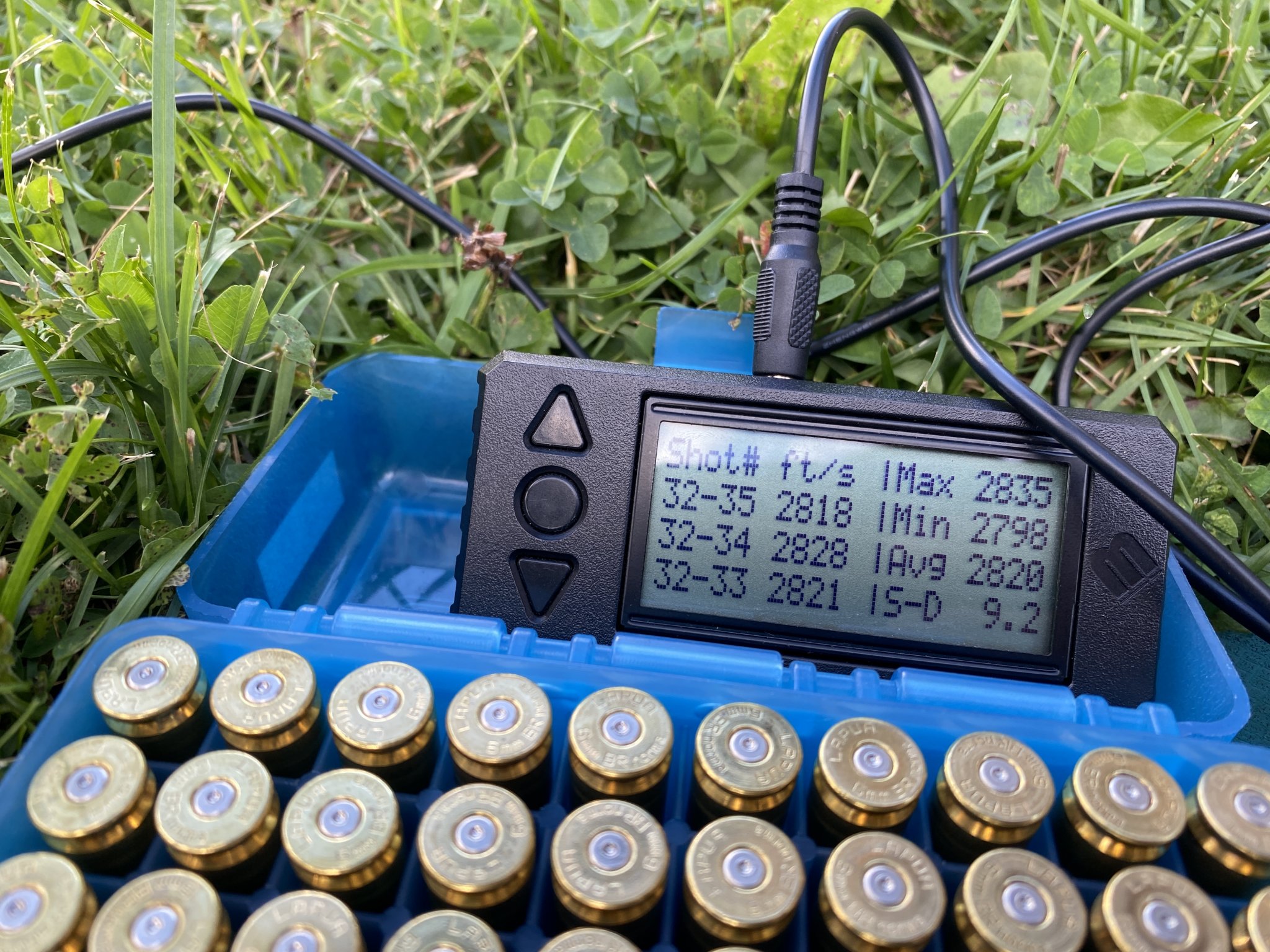

For me it’s less about the physical dimensions I’m left with, and what shows up on target. I use a .265” bushing and press a bullet in.
This includes my first shot on a clean barrel, which I've logged as being up to 80fps slower than average. I could delete that 2798, but it is what it is.
I run my Magnetospeed on an MKM mount on my arca rail, so that it never touches my barrel. I have data on almost every shot that's left my barrel save for the ones in competition, and I quickly came to the realization that the mandrel was a waste of time at the bench for me.

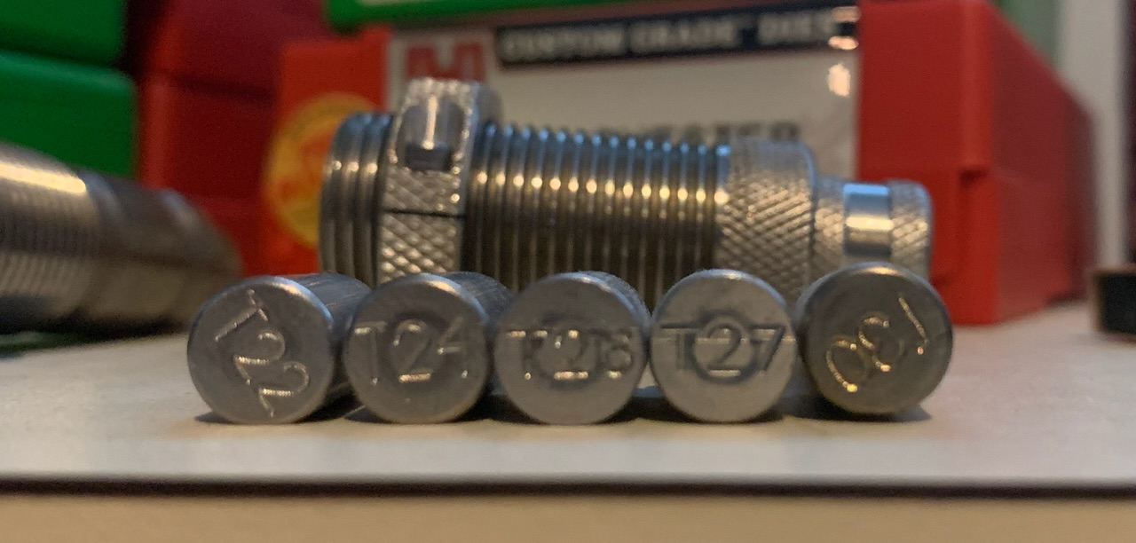

In my case .30 cal i bought pins from 304 - 3075 in .0005 increments and conducted tests, some sizes were easy to eliminate others required additional testing. My best results where .002 under, and as luck would have it I had a carbide neck turning mandrels in the proper size.
Someone mentioned spring back, it is an important consideration, and is consistent across your (same lot) of brass. As a result we can eliminate it as a variable in testing.
The only additional consideration, I use an 8 sec count to expand each piece of brass.

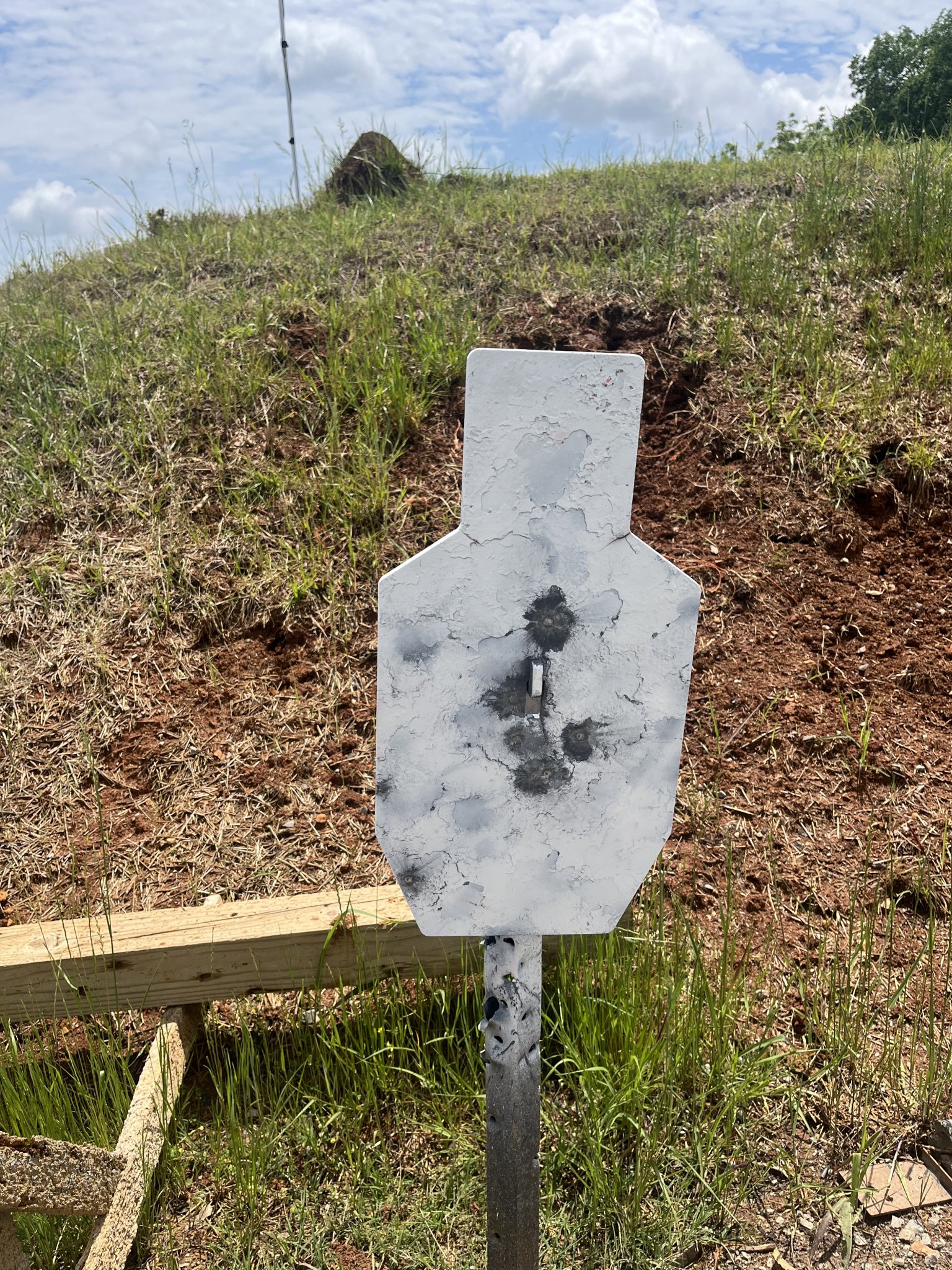

IDK, for me it’s what shows up on target too, except I’ve experienced the opposite thing. Since adding the mandrel I’ve noticed much more consistency/repeatability shot-to-shot than I got previously when I was sizing bushing-only (expander ball removed). My ammo comes out the same level of awesome every time now without having to think about it, so when I suck, it’s me, there’s no blaming the ammo.
I don’t shoot as many shots over the chrono, as most of my practice is off obstacles, but I haven’t seen an SD that wasn’t a single-digit in over 2 years every time I’ve checked.
This is off a cattle gate and Shmedium, 750 yards, 6CM practice barrel way past its prime with a no BS 3000rds on it:
Are you seeing any velocity variance now that you’re @ 3000rds? That’s a pretty high count on a 6CM
Call it 4.5” with that top impact… 0.5-0.6 MOA off a cattle gate is great
I’ve never run it faster than 2900fps and have always jumped ~.100” off, more so than anything else, I think that’s why the barrel has lasted so long.
Also, I didn’t clean the barrel with anything more aggressive than Bore Tech Eliminator, nylon brushes, and cotton patches for its first ~2200rds and thought it was dead…. But I brought it back to life with bronze brushes and Iosso and have been shooting it, still hammers.
I really didn’t know how to properly clean a barrel for the first 2200rds and have been more aggressive every 200-250rds since, now I let the borescope guide me.
I must be pushing it at this point and should retire it, but it’s still shooting… so I’m on the fence as to either pull it after hitting the range tomorrow, or keep going until it dies for real this time, IDK… I still haven’t experienced a speed drop-off yet, so who knows…
