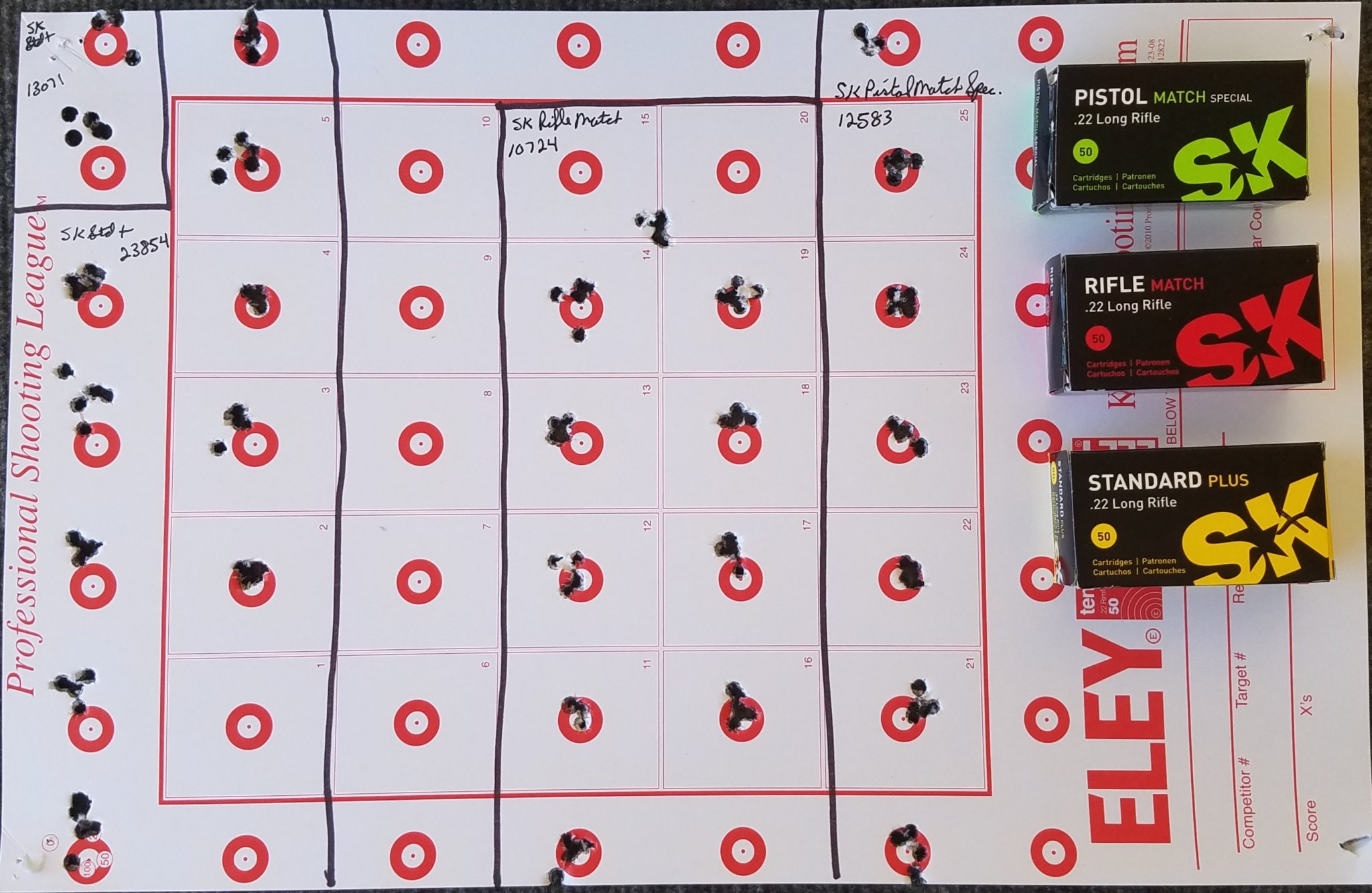

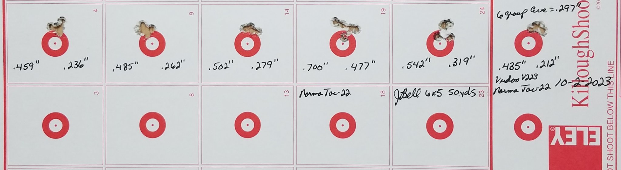

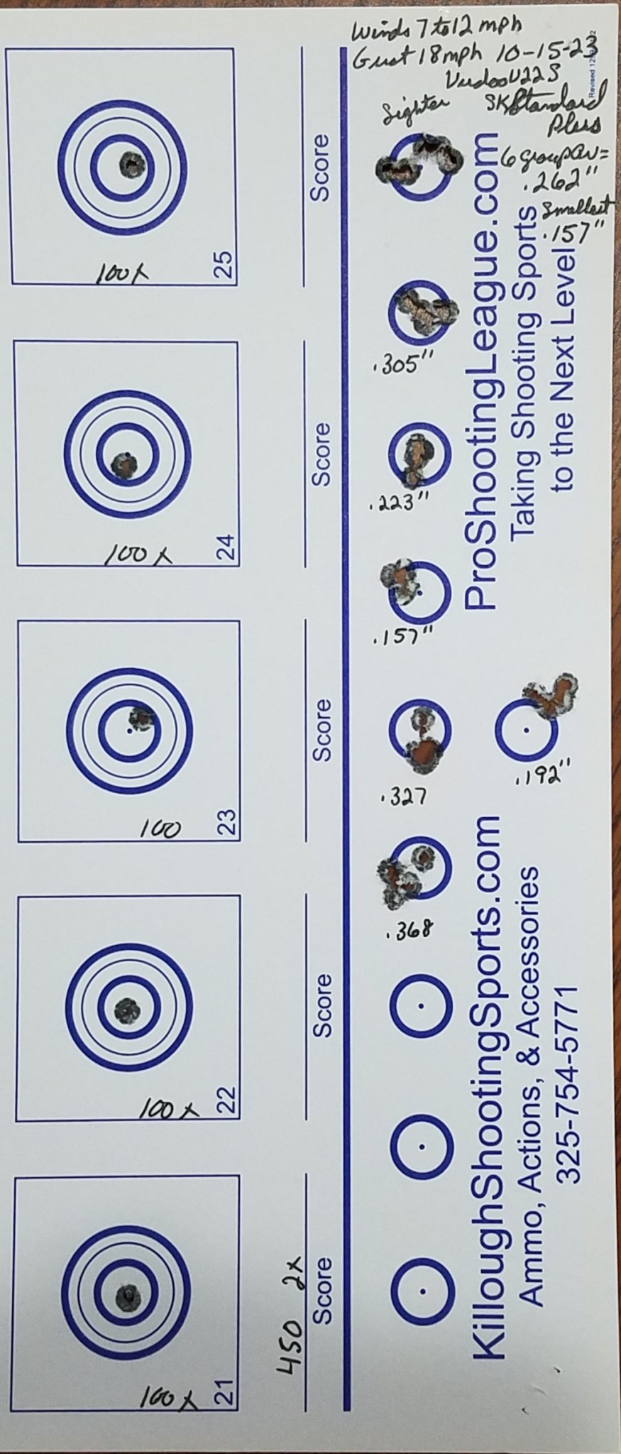

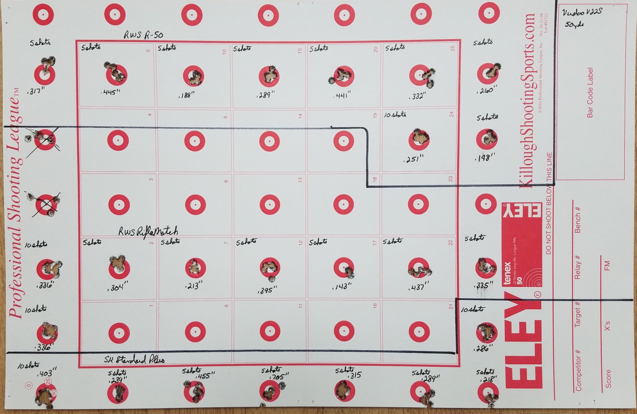

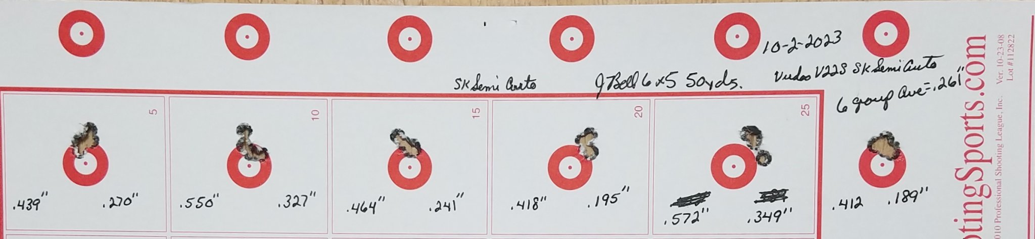

Real world results, outdoors, off a bench for the others
with bipod and rear bag, 32x scope, full box sent each time
This is from a bench with bipod and rear bag at 50 yds. Group measurements are center to center.

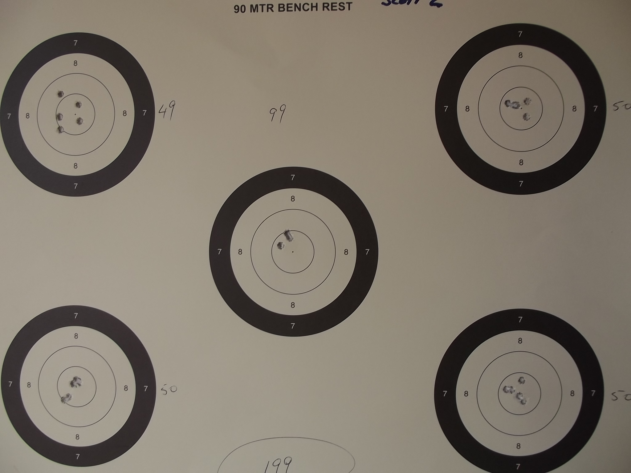

G'day Tazmon, these targets were shot with a DIANA 820S dated 1984 /6 groove barrel / harrell tuner set at 200 / Weaver 36 fch/dot scope. Photos of the rifle are on page 69 posts 3403 and 3408 of the rifle photos thread.Yes 90 metres.Scott Australia.
