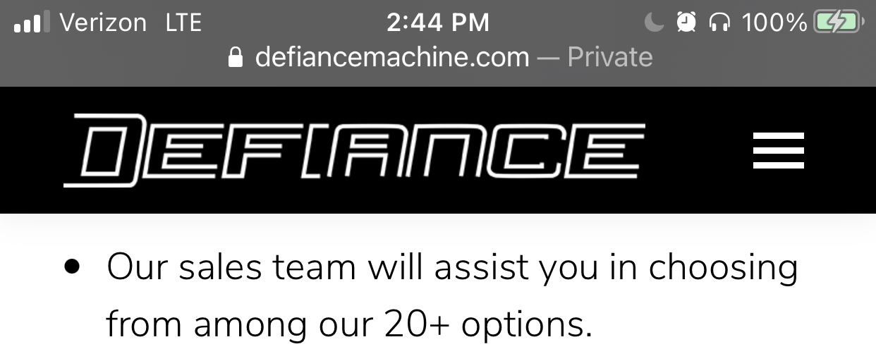

    You would have to order directly from Defiance Machine, but the Deviant could be a customized action. I am not at that level of experience so I usually deferred the the person building my rifles, but you can see the options on their website.

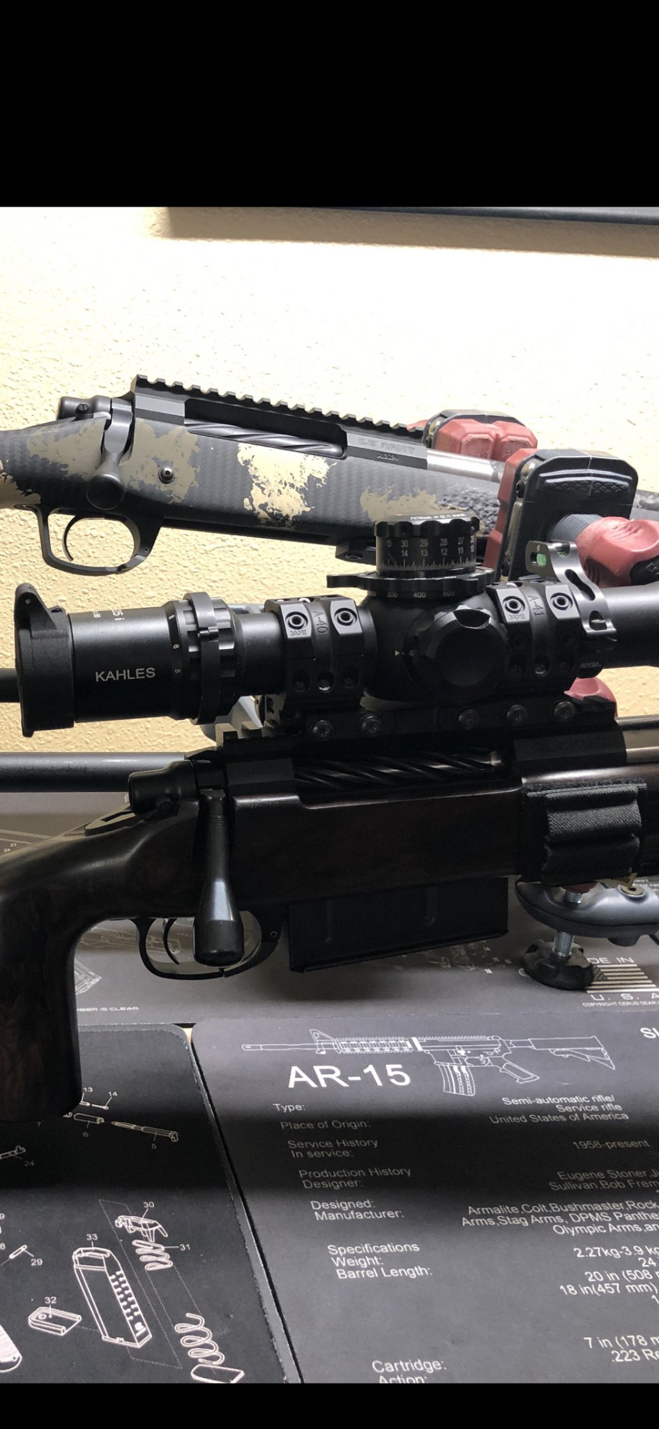

    I have both a Deviant Tactical and Ruckus tactical sitting next to each other. One is a 300PRC and one is a 300wm. Both headspace the exact same with either Proof prefit barrel mounted. The only difference is the headspace gaurantee of the Ruckus and the bolt handle is different as mentioned. The Ruckus bolt handle is round and removable at the top so you can change styles if you want. The Deviant is solid and flatter so the bolt handle opening needs to be larger(either will fit the Foundation opening, manners had to be opened a little from their Ruckus cut). Both have the same throw, the same feel, the same everything. Either bolt worked in either action with the same headspace in these two.
    If you want to spec specific features like controlled feed or different bolt recess call Defiance and you may go with the Deviant. If you just want off the shelf features or if Prefit guarantee is a requirement, go with the Ruckus. Given both are basically the exact same I will go with the Ruckus from now on so I have the headspace guarantee IF i want to throw a prefit on it.
    Deviant handle on top

    I have both a Deviant Tactical and Ruckus tactical sitting next to each other. One is a 300PRC and one is a 300wm. Both headspace the exact same with either Proof prefit barrel mounted. The only difference is the headspace gaurantee of the Ruckus and the bolt handle is different as mentioned. The Ruckus bolt handle is round and removable at the top so you can change styles if you want. The Deviant is solid and flatter so the bolt handle opening needs to be larger. Both have the same throw, the same feel, the same everything. If you want to spec specific features like controlled feed or different bolt recess call Defiance and you may go with the Deviant. If you just want off the shelf features or if Prefit guarantee is a requirement, go with the Ruckus. Given both are basically the exact same I will go with the Ruckus from now on so I have the headspace guarantee IF i want to throw a prefit on it.

    Pic attached above after posting. I can't answer with certainty if it matches the angle of a 700 bolt. The Foundation the Ruckus is in is inlet for a Ruckus specifically. The Deviant fits but a regular 700 does not due to the body of the 700. Does not fit in it to even see if the bolt fits. I'd call Defiance.
    Thanks and yeah, they both look to be slightly swept back and I doubt very seriously if I will have a problem with the bolt handle with the JAE.
