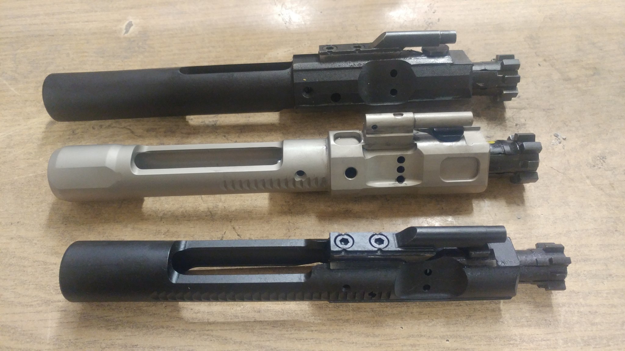

The MSR10 LR is preparatory by design.
There are basics you can change: triggers, barrels, bolt heads, stocks and grips but as far as bcg, I don't think so.
The upper and lower are a cross between a full-size AR10 and the AR15. The bcg is it's own thing.
The one in the middle is the MSR 10 BCG.
The upper and lower are a cross between a full-size AR10 and the AR15. The bcg is it's own thing.View attachment 6891264
That's correct. I started a thread somewhere on here after I started tinkering, to note compatibility. It's kind of a blend of the actual AR10 by Armalite and the DPMS 308. Lower and buffer tube are the Armalite variety. And the bolt/barrel are DPMS pattern. Rest of pretty much compatible with appropriate AR10/15 parts except the handguard which is proprietary, as is the barrel nut (at least to my knowledge).

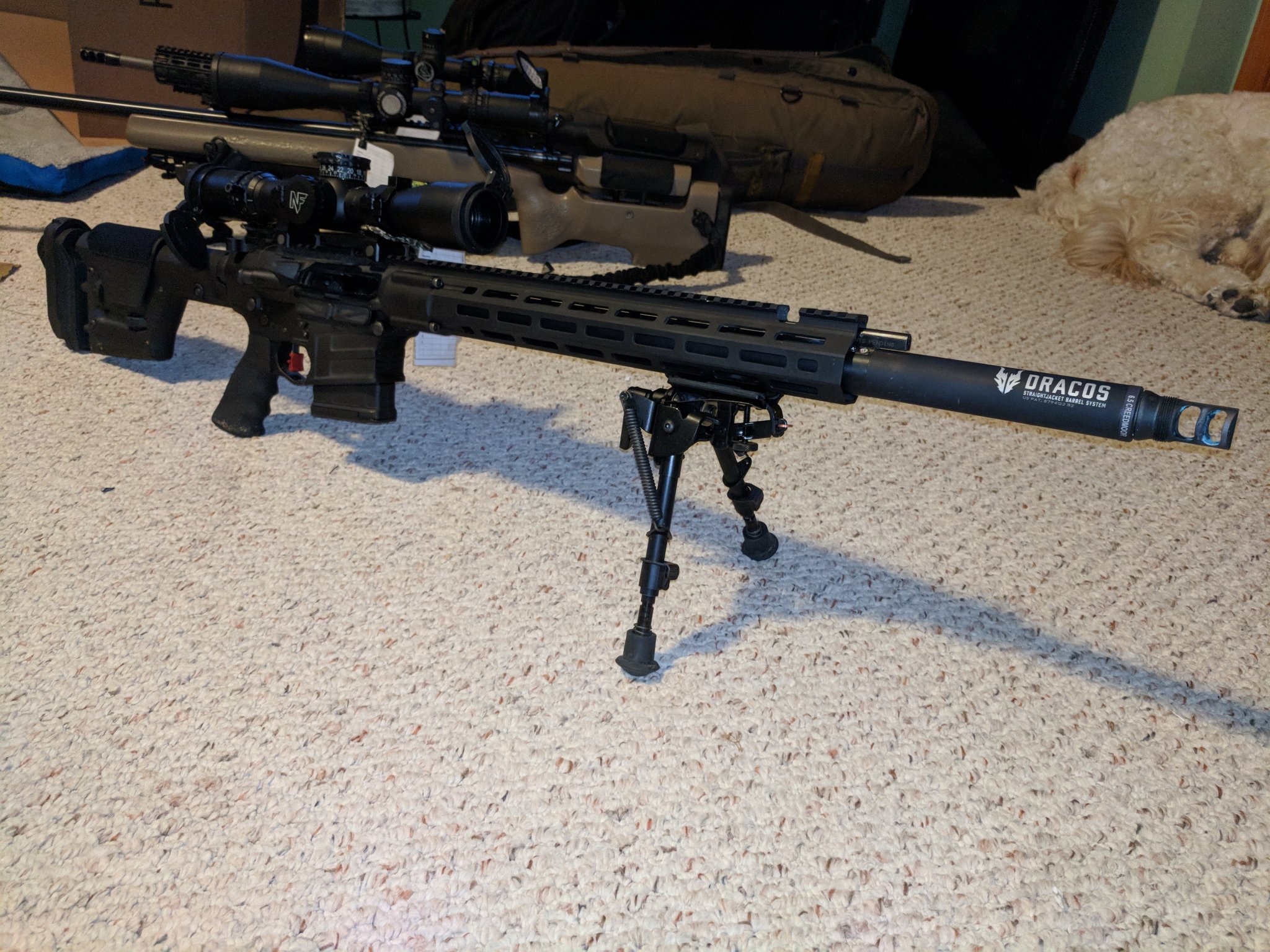

Looks good. Looking for range report.
I have a hard getting to a range but maybe next week?
I'm curious about the Precision variant too. OP, please post results/pics from range. Also, if using factory ammo, I had okay results with factory Hornady 140 (.7-.9") but much better results with factory 120 ELDM, 130 Federal Hybrid GMM and actually American Eagle 140BTHP.
My handloads are 123 SMK, 123 ELDM and 130 Hybrid (average of -+.6") The 140's didn't stay quite as consistent as I'd like with the factory barrel but that was an 18" tube. Happy to share the loads I've found with my 22" Dracos if you want them.
That is a Hogue. Cheap and feels great. Tried the Magpul MOE, Ergogrip and the stock grip and liked this the best. I might like a bit more vertical grip if I could find the right fit but this one works well for combo of prone and walking control.
