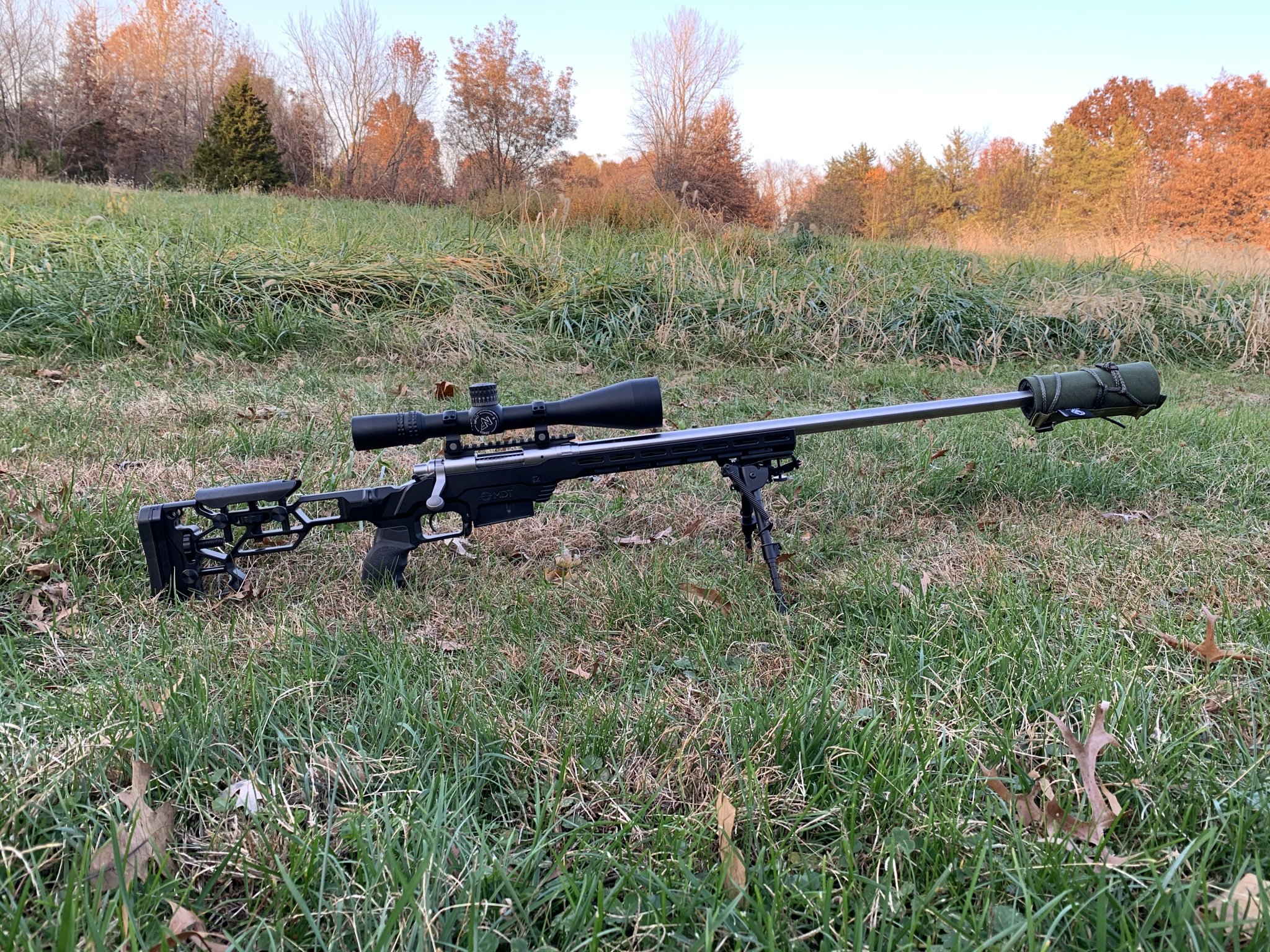

Heck I didn’t even true up my Remington action just slapped it together and it’s shooting sub moa. Just took it to 900 yards last weekend. Also ordered mine through northland shooter supply. Just buy their barrel nut and recoil lug and call it a day.
