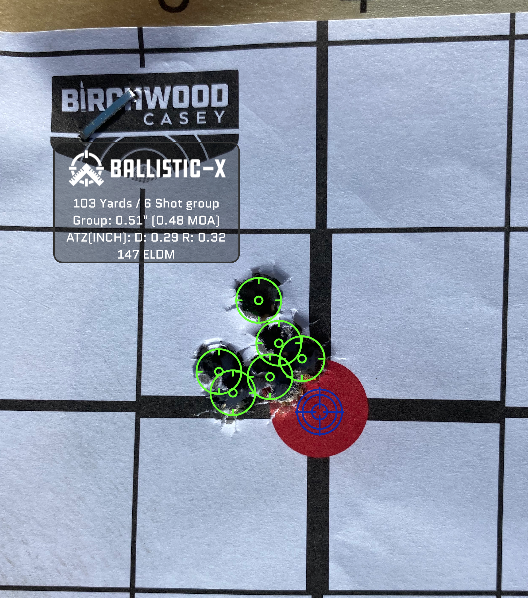

    I had a Gen 2 5R Rem 700 chambered in 6.5cm and it was an awesome rifle. Super smooth action. Very accurate. I put it in an KRG X Ray and loved it. Shot pretty much all “match” ammo sub MOA but really shot factory 147 ELDM well. Attached is what I would call a typical group with factory 147 ELDM.
