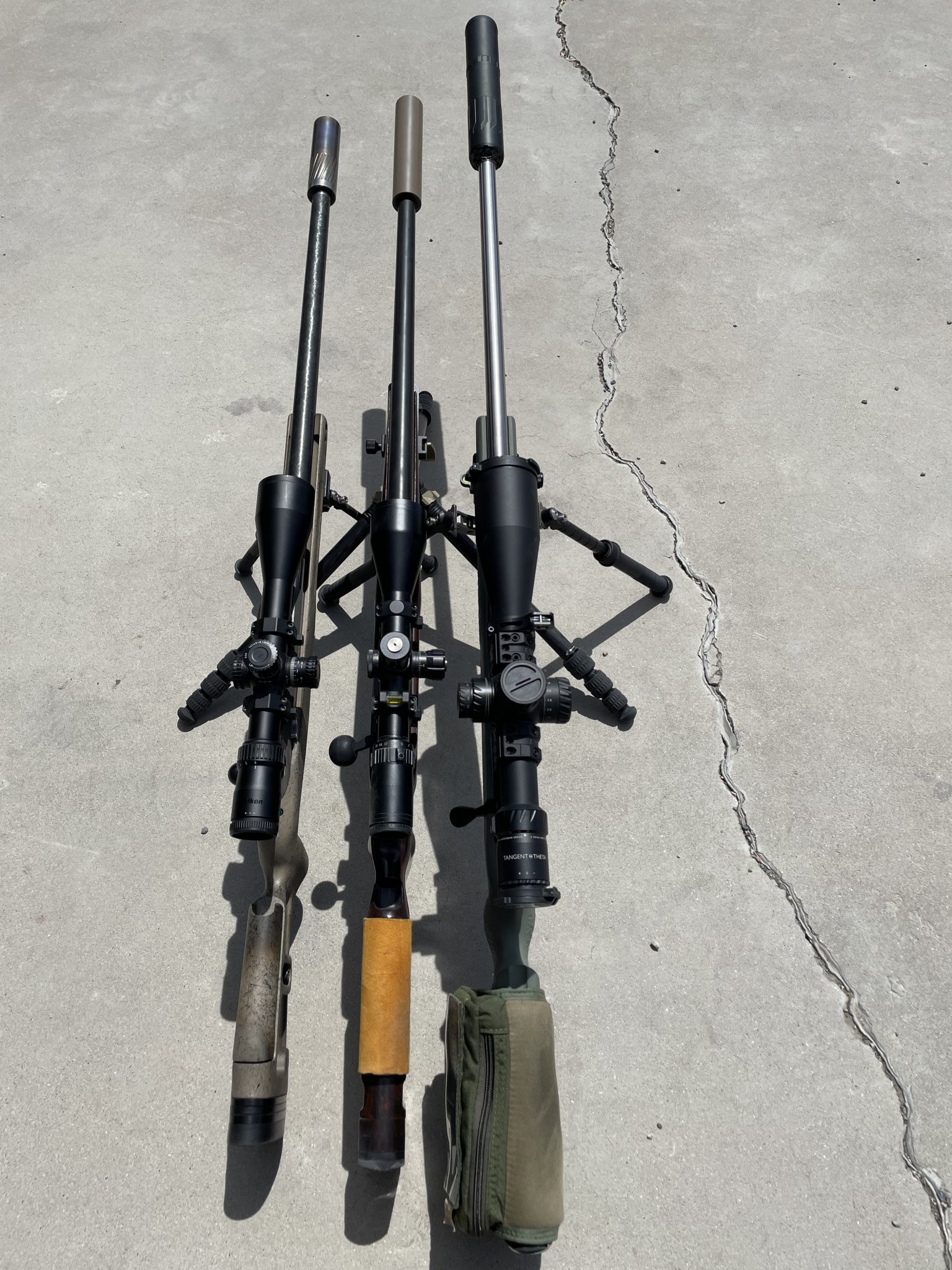

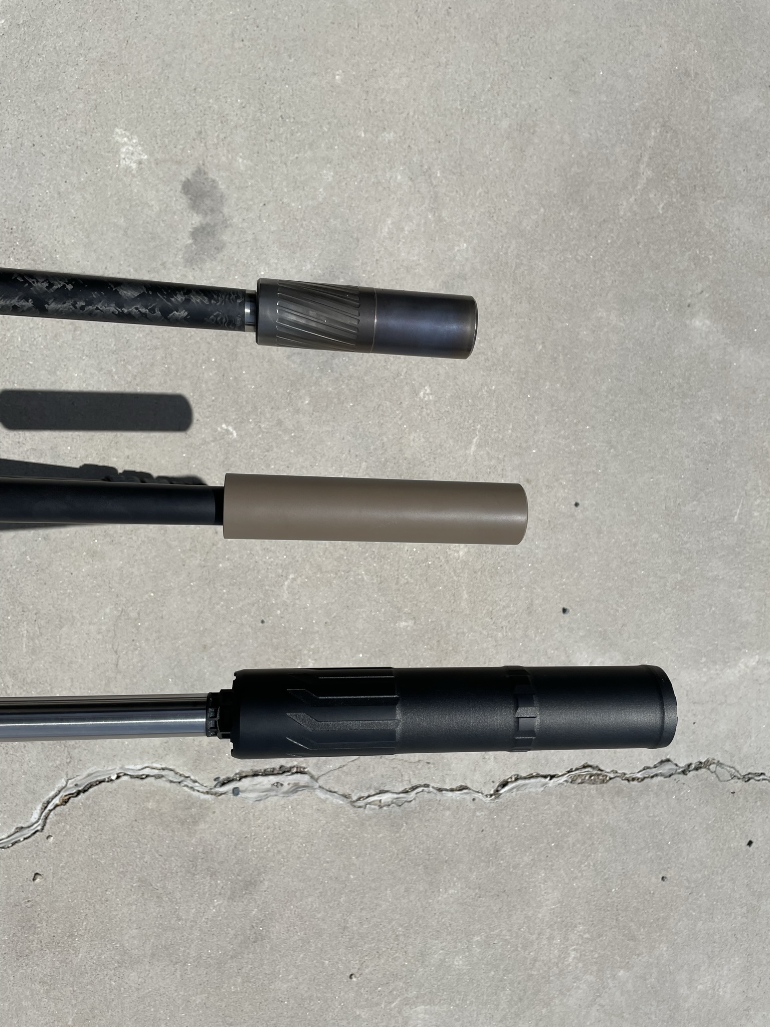

    I have a Hyperion, an older thunderbeast 7, and TB ultra 5. I have also compared it to a TB ultra 9. The Hyperion is an amazing can and definitely is quieter compared to the listed cans. 3D printed cans are the future in can technology. I still love my other cans but my Hyperion is a beast. The Hyperion K is on my short list of things to buy.

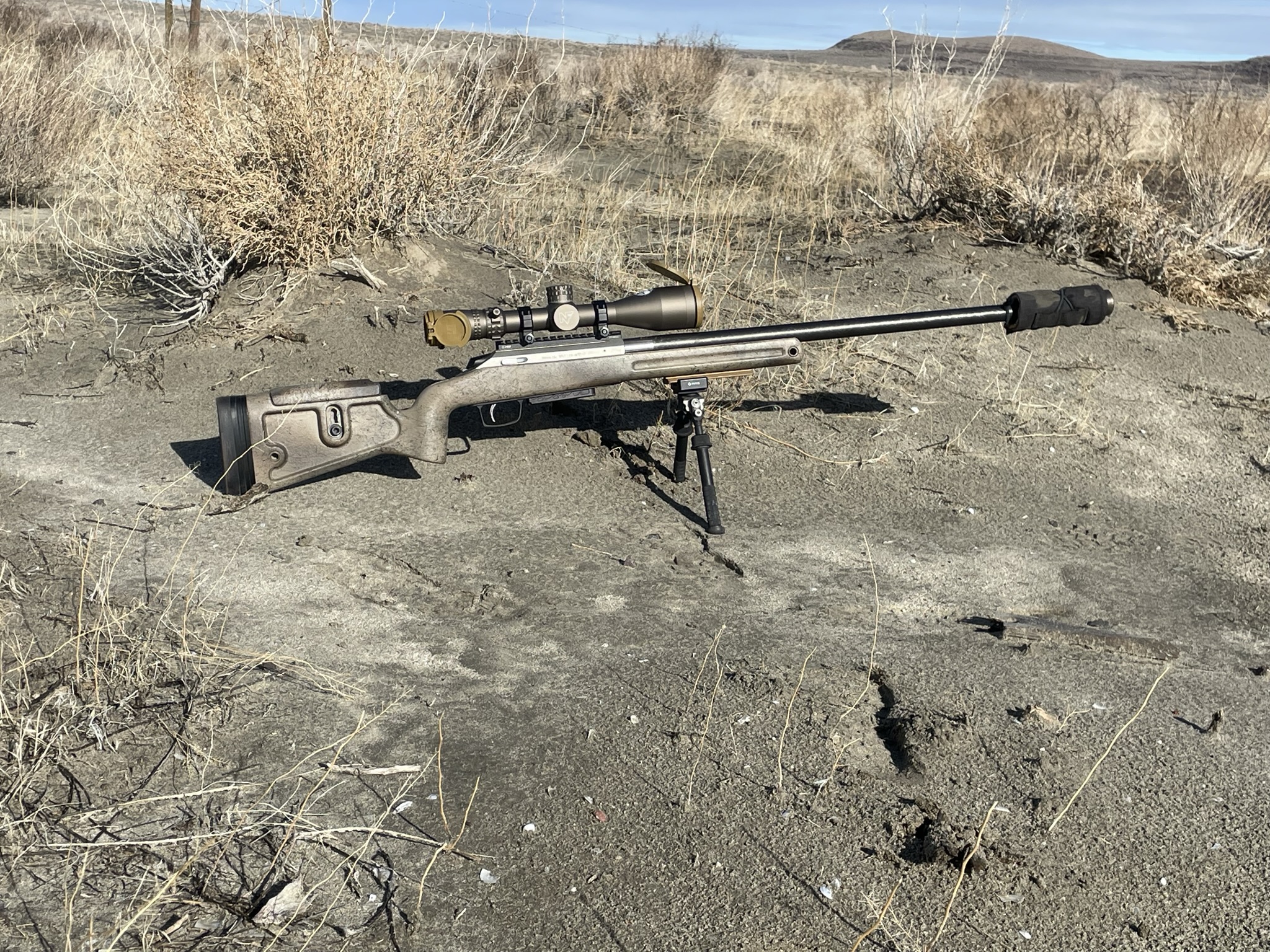

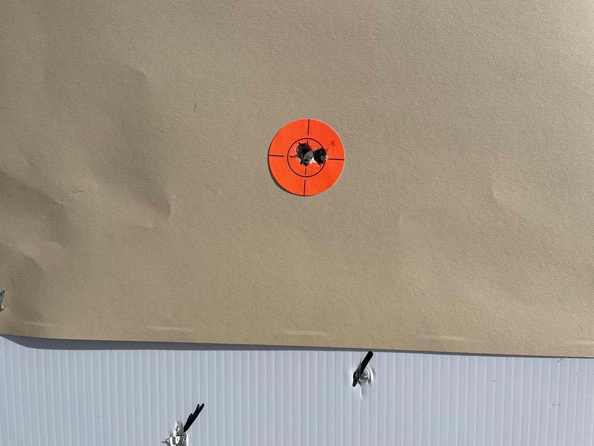

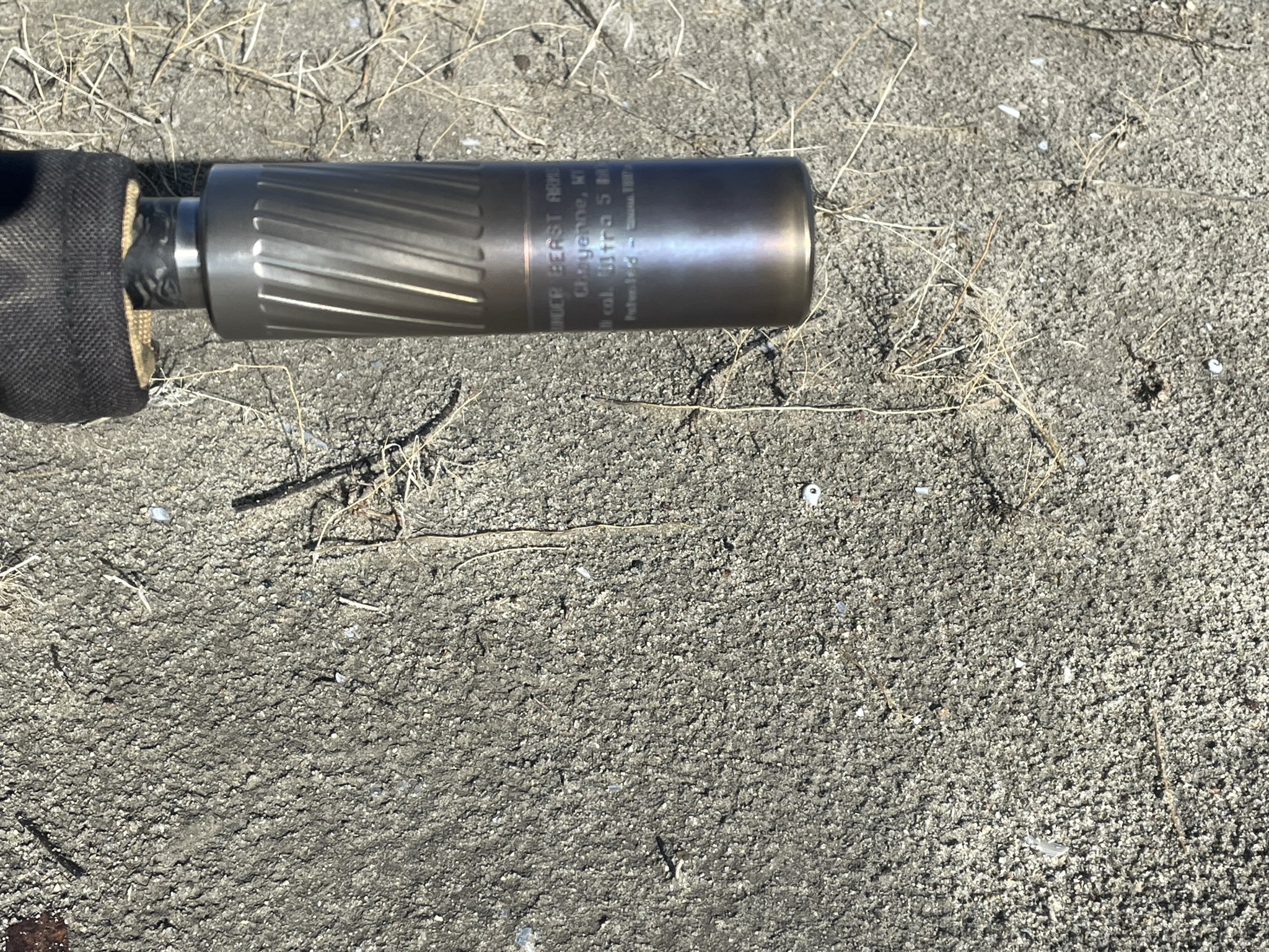

    Probably my 300 WSM hunting rig and 16 in 6 ARC. I put my Hyperion on my 300 WSM and the groups opened up. The rifle shoots lights out with TB ultra 5.
