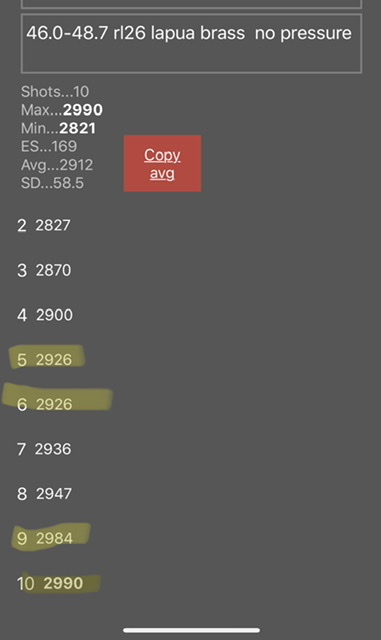

Hey fellas, just wanted to share my results from some testing I will be doing to push the 6.5 creedmoor to its ballistic limits. This is simply a test and I do not advise you try this for yourselves. I have spent a few years trying to find an optimal load for shooting long range with my 6.5cm. I was hindered by the fact my bolt needed to be bushed before it would allow me to push the cartridge to its limits. well this week I received my new bushed bolt and today I performed a few pressure tests to see how fast I can’t get these 153 atips moving.
I was a bit shocked I reached speeds of nearly 3000 fps.
I tested both RL16 and Rl26. I have tested both powders in the past and landed on Rl16 because of how stable and consistent it was. I felt like I was unable to find a proper node with Rl26. I will continue to test and get some groups in with both powders and will update this thread.

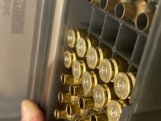

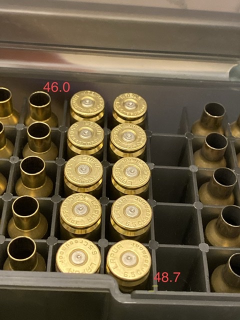

I got all the way up to 2990 FPS with lapua with out much visible signs of pressure, and zero heavy bolt lift, (I noticed only very minimal ejector marks starting to form
On the top end load(. Where as the norma I took it up to 2960 and got heavy bolt lift and visible pressure signs, and decided not to fire the last round at 48.0

RL26 46.0-48.7 (.003 increments) Satterlee 10 rd load test.
groups to follow in a week or so, but looks like I will be loading at the 2926 node and the 2990/2984 node.
Wow those are some awesome numbers similar to PRC territory. I have played with RL26 and 147eld combo that achieved 3000fps without any pressure signs but these are insane numbers for the 153gr projectile. I’m very surprised at how normal your primers look, still nice and rounded. No ejector marks that I can see on the brass. Please keep us updated on how the primer pockets hold up. I’m guessing the smalls will go the distance.
That is insanely unsafe. Regardless of what the brass looks like you have to be well beyond design limits for the gun to get velocity like that. Remember that most of us don’t have any way to monitor actual pressure and those with such equient have found that physical signs like ejector swipes happen well after SAAMI pressure limits are exceeded. I wouldn’t do that if I were you and I wouldn’t post it in a public forum.

I inspected the brass tonight, the lapua primer pockets are still just as tight are good to go.
I will not be using the Norma brass for these top end test, you could really just tell the lapua brass is a better fit for this test. I’ll post some graphs tomorrow.
