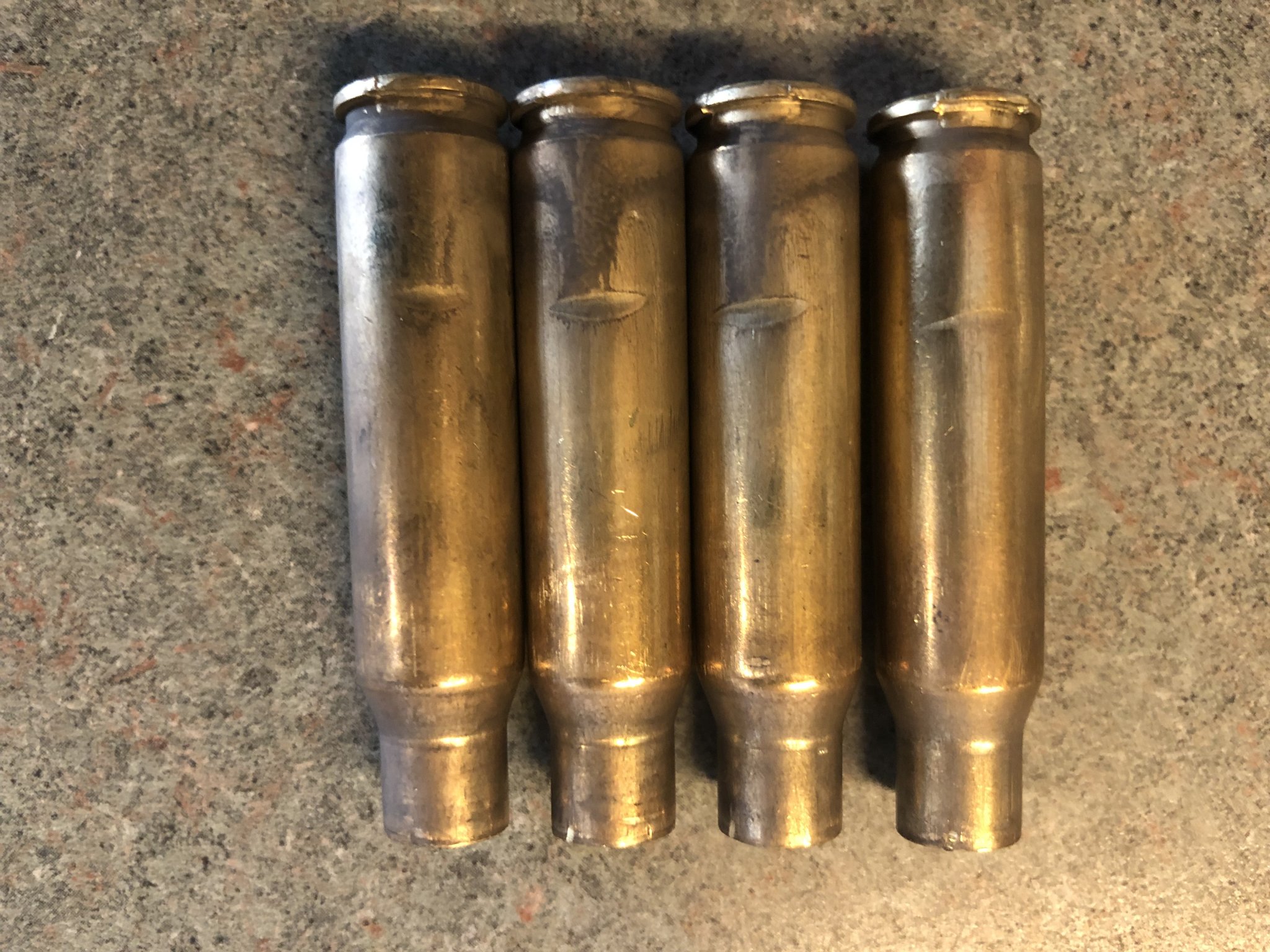

Shot a pieced together a large frame 308 today. Suppressed, 16” BA barrel (🙄) gas port drilled / opened up, PSA bolt, live free armory matched upper and lower. New Pmag 20. Heavy buffer and flat wire spring.
147 fmj ZQ (Turkish) reloadable brass case.
First 2 were fine, then double feed, cleared, fire, same with the next 2, etc.
10rds fired, 3 double feeds,WTF?

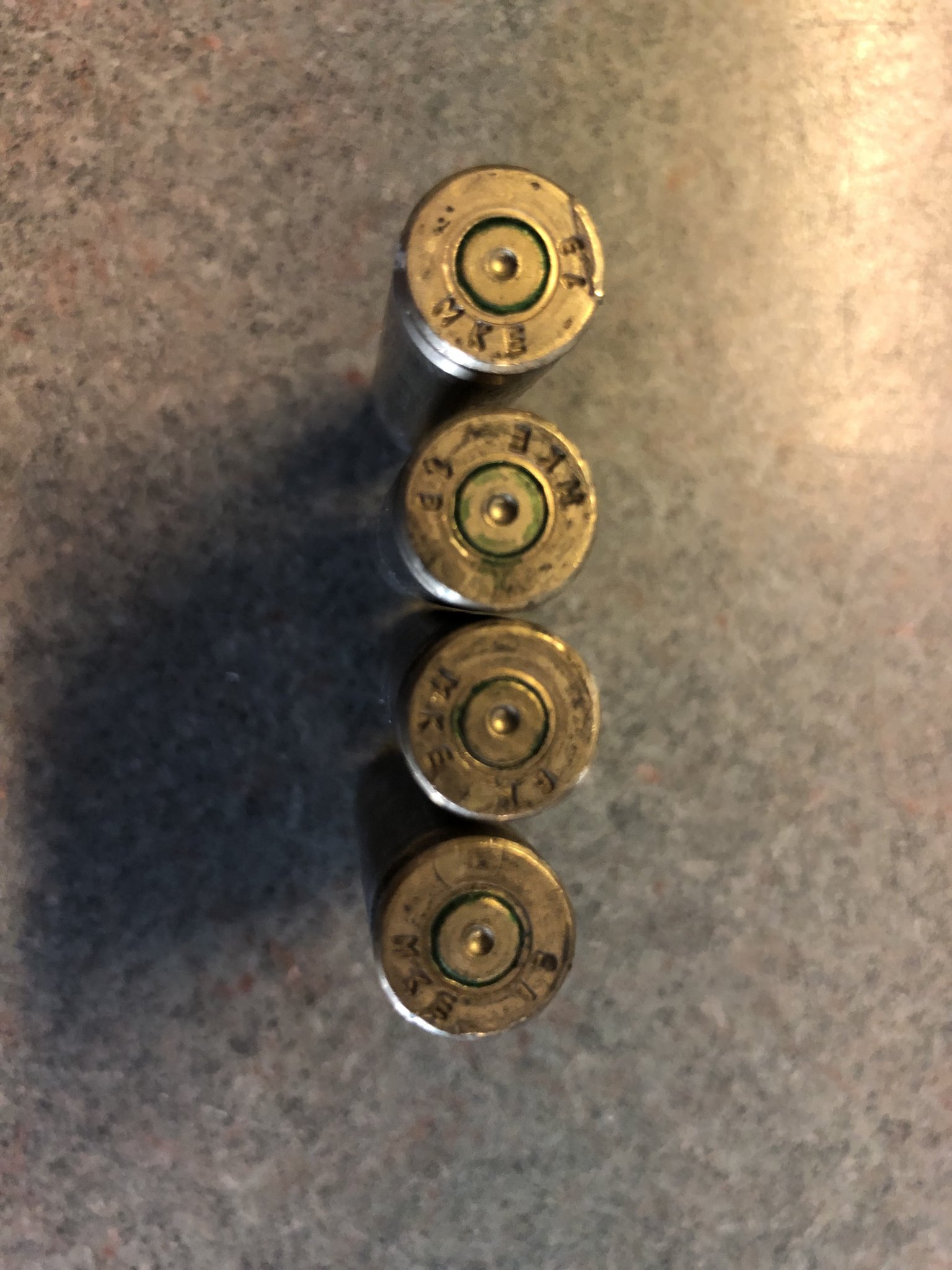

All fired cases have a lower body dent and the rims are a bit chewed up.
Any suggestions??

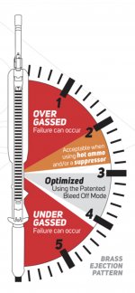

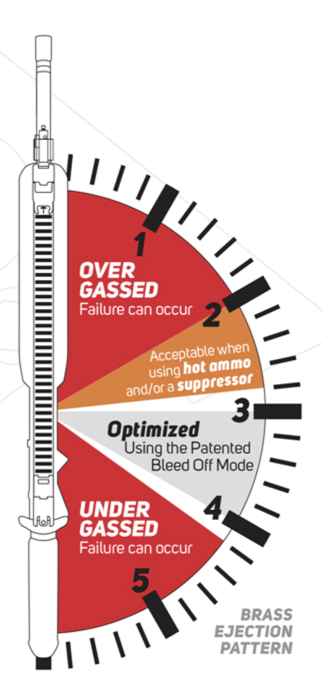

2-3 o'clock indicates "hot ammo and/or a suppressor."
If you are running a non-adjustable gas-block, you won't have a means to reduce the amount of gas pushing the BCG back.

Thanks for the diagram!
Cyclic rate is too fast, and look at the brass flowing into the extractor shelf.
The extractor is trying to rip the rims off the brass due to early carrier momentum from excessive gas into the carrier.
For MLGS 16” barrels, you don’t want to be over .076” generally speaking.
No bueno
