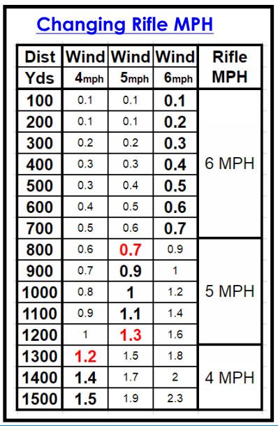

My questions is - Does this idea work? Do you think the system below is close enough to use for doping your rifle at longer ranges?
We are all starting to understand the rifle MPH method of wind doping our rifles. This works out to 600yds, maybe 700, and 800 if you are lucky. But what about the further ranges? I wanted to find an easier way to dope the wind a further ranges without having to memorize ranges and what "jump" I am at. ("my rifle jumps at 1000 again... so that't 2 jumps... my hold is 1.2") So I decided to play with the MPH of my rifle at further distances to see if slowing the wind speeds will make things lineup at further ranges. This worked okay, but not great. I am putting this out there for others to look at and see if they think it will work at further ranges.

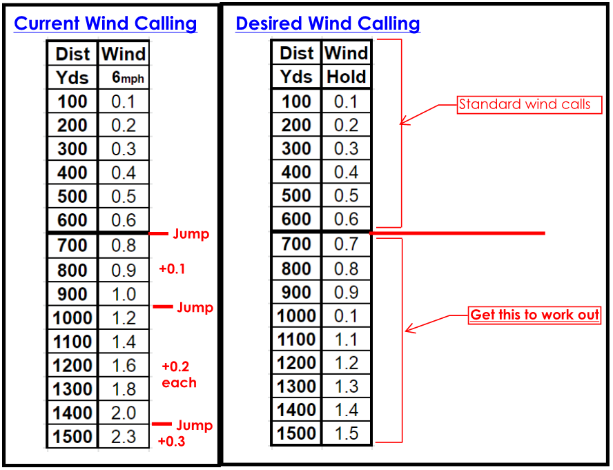

The premise - Rather than remembering where the "jumps" are at in our rifle MPH holds, lets find where our rifle changes mile per hour to keep the yardages equal to the wind calls.
Data is 6.5 Creedmoor, Hornady 140ELD Match ammo, 2650fps
So I played with Hornady 4Dof to see if this might work. I listed the wind holds for each wind MPH to see where a pattern would emerge.
This is what I got.
Now I can memorize where my rifle changes mph and know what my dope is.
My questions:
  1. The numbers shown in red don't quite follow the trend, but are they close enough?
  2. Would this be an easy way to remember your wind dopes at further distance?
  3. Does this work on your rifle? Yardages for MPH changes might be different but does the general Idea work?
Comments are welcome, please chime in, this is just an Idea in progress. Thanks.

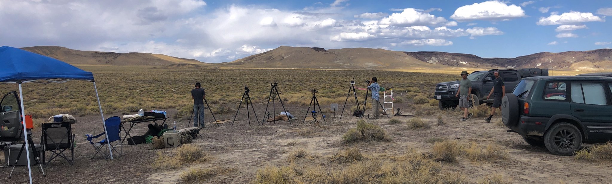

Look is up on practiscore. We also do several ELR shoots. The only image I have on my phone is of our team match— this particular match was sold out almost 10 months in advance.. but look up our others. We have 2 regional qualifiers + 1 pro series, 7 regional series -
Will have 2 dates for ELR (not on practiscore)
All hide guys in the image, but most are on the second range on the right at 90* to the range pictured. (Downloaded the image I posted earlier in the ELR thread)
Jim

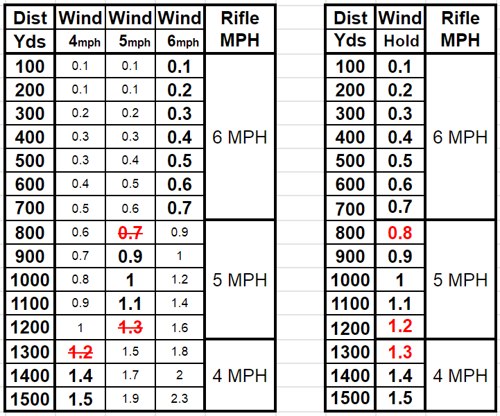

So I'm not hearing any Real negatives to the Idea. Sounds like it could have validity as a rule of thumb. This is all I ever intended it to to be. Longer range wind calling is a dynamic process but its good to have a quick starting point. For shooters that might shoot 1200 or 1300 on occasion it could be a worth while tool. Avid longer range (+1500yds) shooters will find this not effective for wind calling.
I'm going to try this the next time out the range and use it as a rough estimate for the starting point, then check it with a calculator, then check it with shooting. I'll Probably round the red numbers up or down to fit thier yardage and run with it as shown below. Its swag at over 1000 yds with 6.5 creed anyways.
Other Caliber Comparisons
After playing the JMB's wind chart calculator I am seeing this "red number issue" with most calibers. This tells me it can only be a rule of thumb and it will get you close. Most calibers you can find where you'll be a 1/10th high or low and change gun mph when there is 2/10th deviation. I think using @Skookum method of reducing the gun mph by 0.2 for each added 100 yds might be more accurate but also take more head math to get it right. The method I presented is more course (could have more error) but is simple for me to remember.
