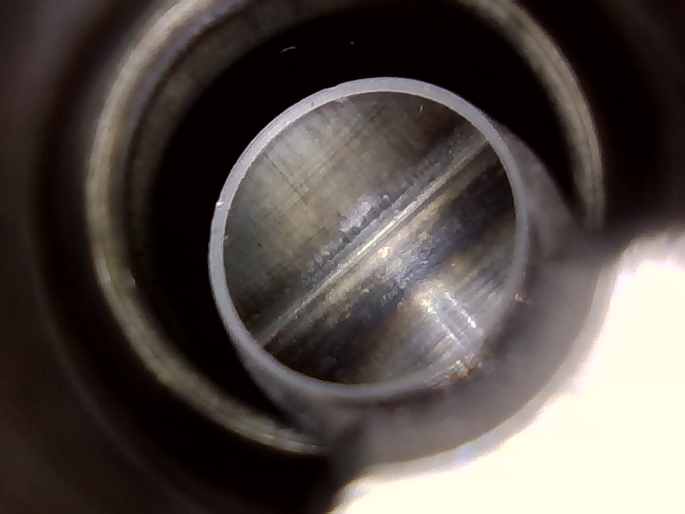

what's your cleaning regimen? It's possible you have developed a carbon ring that is jacking pressures up.

See anything that looks like this with your bore scope?
Reactions: joe.canada

I bought some C4 Carbon Cleaner and will give that a try.
Same lot for all components.
Based on your "all of a sudden" revelation, a carbon ring sounds likely but... in the explore all possibilities line of thinking before shipping it off to a gunsmith...
I've found that C4 Carbon Cleaner is a good general cleaner, but doesn't work all that well on caked on carbon. If you do have some carbon forming, look at Wipe Out foaming cleaner. Night and day. You still have to really work at it, but it pulls carbon off very well.
Thx for the tip. Will do.

UPDATE
I performed a full cleaning of the bore, once using a carbon remover and again using a copper remover, which resulted in no more stiff bolt on extraction. I believe the issue was a nasty carbon ring. I’ll be performing a carbon ring removal (with C4 Carbon remover) after every outing.
Thanks again for the help and advice. Learned something new.

UPDATE
Joe
