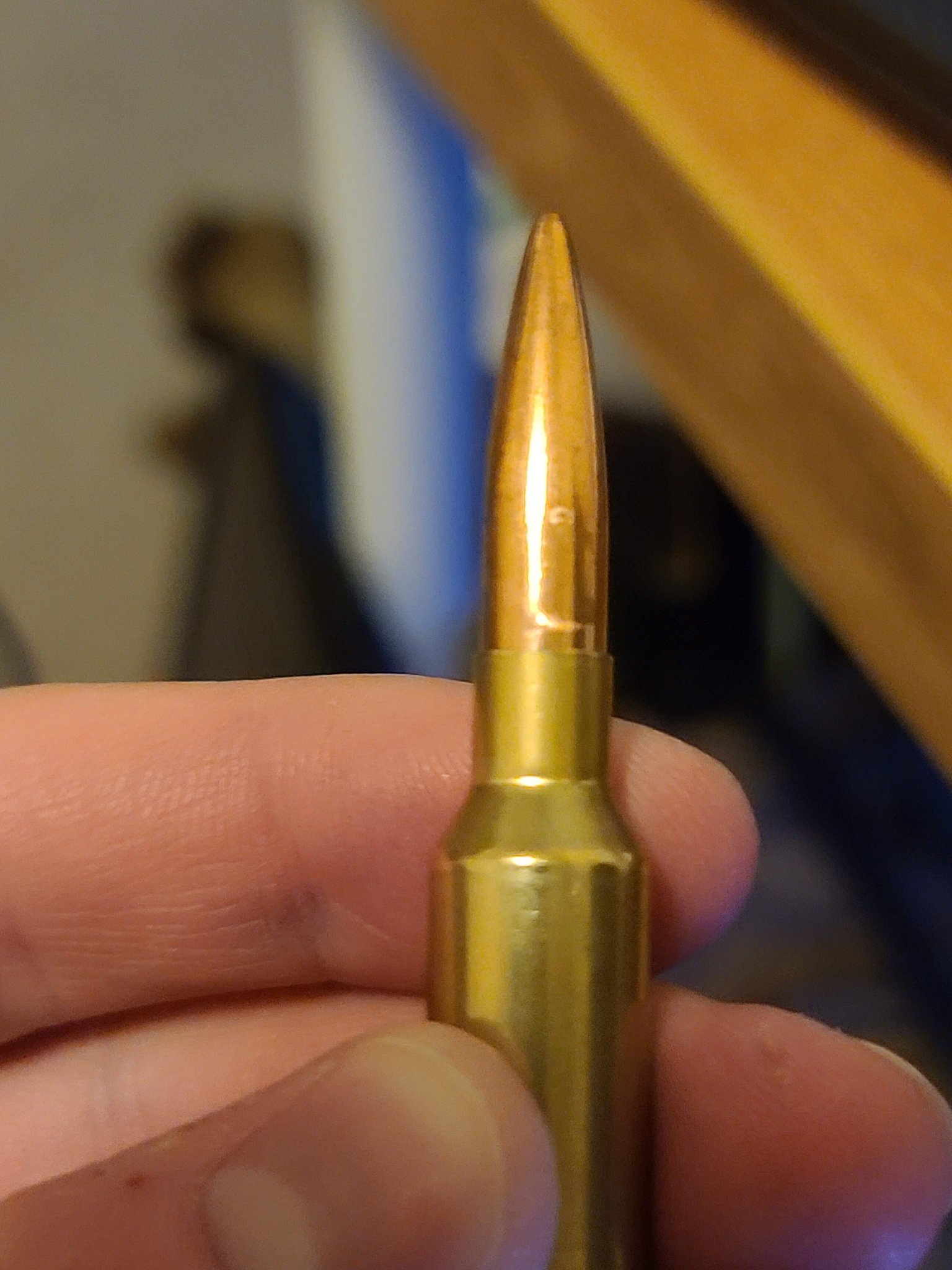

While troubleshooting the above I had an opportunity to have a dummy round chambered and the inspected upon removal. I noticed 4 marks on the projectile that are 90 degrees from each other, I am confident that these are from the rifling and not various chamber burrs as there are plenty of those and I know what those marks look like. Poor quality picture attached lol. Things to note:
  • Lapua case + 140gr Hornady BTHP
  • Jam measured via Erik Cortina's method CBTO of ~2.2250"
  • CBTO for my two loads using these cases: 2.1700"
  • CBTO does not change before and after chambering
  • No pressure signs when load development was completed at the same CBTO
I guess this again is probably not a problem but I am really struggling to understand how the rifling would engrave the round this far back from "jam".

If your chamber is full of burrs, send it back!
