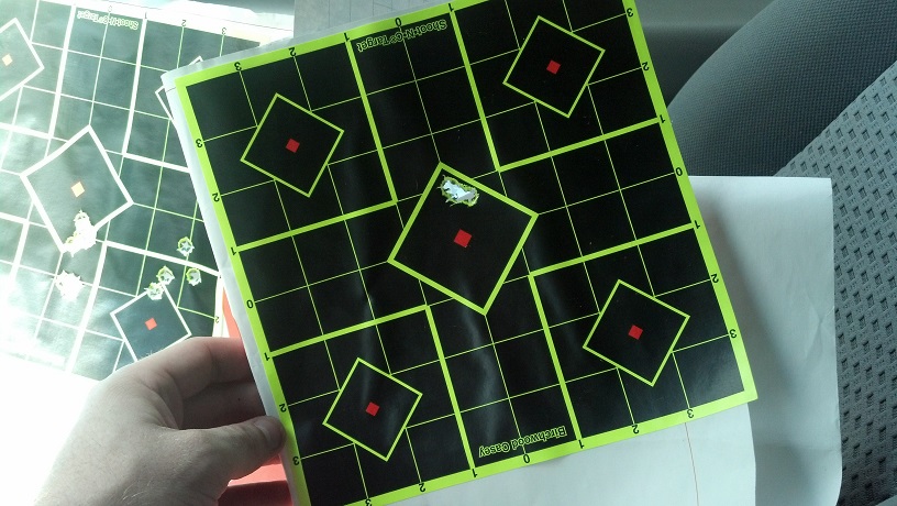

Here is a 3 shot group shot of a harris bipod @100 yds for referencing POI shift
I then Attached my can and shot @100 yds again with nothing on paper. I moved to 50yds and shot 10 rounds with nothing on paper. I just couldnt believe I wasnt hitting paper at 50yds! thus the reason I dumped 10 rounds at it!

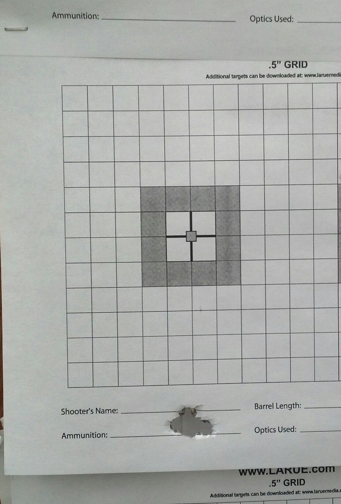

I then moved to the 25 yd range and shot this group below. Its important to mention that I was aiming at the #7 at the bottom of the target.

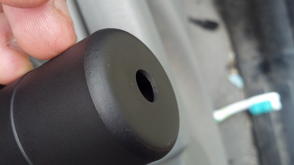

Ilooked down the aac can and saw no visible baffle strikes. Then after close inspection of the tip i found a very very faint copper mark that barely shows up in the picture below.
So what do you think the problem is? im thinking thread concentricty or maybe the muzzle brake is out of spec. Muzzle mount was timed using aac provided shims.

Yeah, that doesn't look like a baffle strike to me at all. You'll see that it's very common to get marks from residue on your cans and if you do ever have a baffle strike (or in your case what might be an end cap strike) it will be clearly noticeable. I'd also check your optic and mount to make sure there wasn't a shift there that would throw anything off. Who mounted the brake? Make sure it isn't loose as well.
That 25 yd group looks like your projectiles are tumbling - which would imply some stabilization issues are occurring. They're not hitting the target very clean. That's definitely a larger POI shift than what is normal in any can I've seen. Something's up for sure...

Well guys I have good news! here is a groups shot out of my 24" .308 rem 700 using an AAC 51t brake. Aiming at the center produced this 4 shot group. So the SDN6 is good to go and the issue now resides in either the muzzle attachment on the AACSD or the factory threading job. I still havent brought it to a Gunsmith yet.
