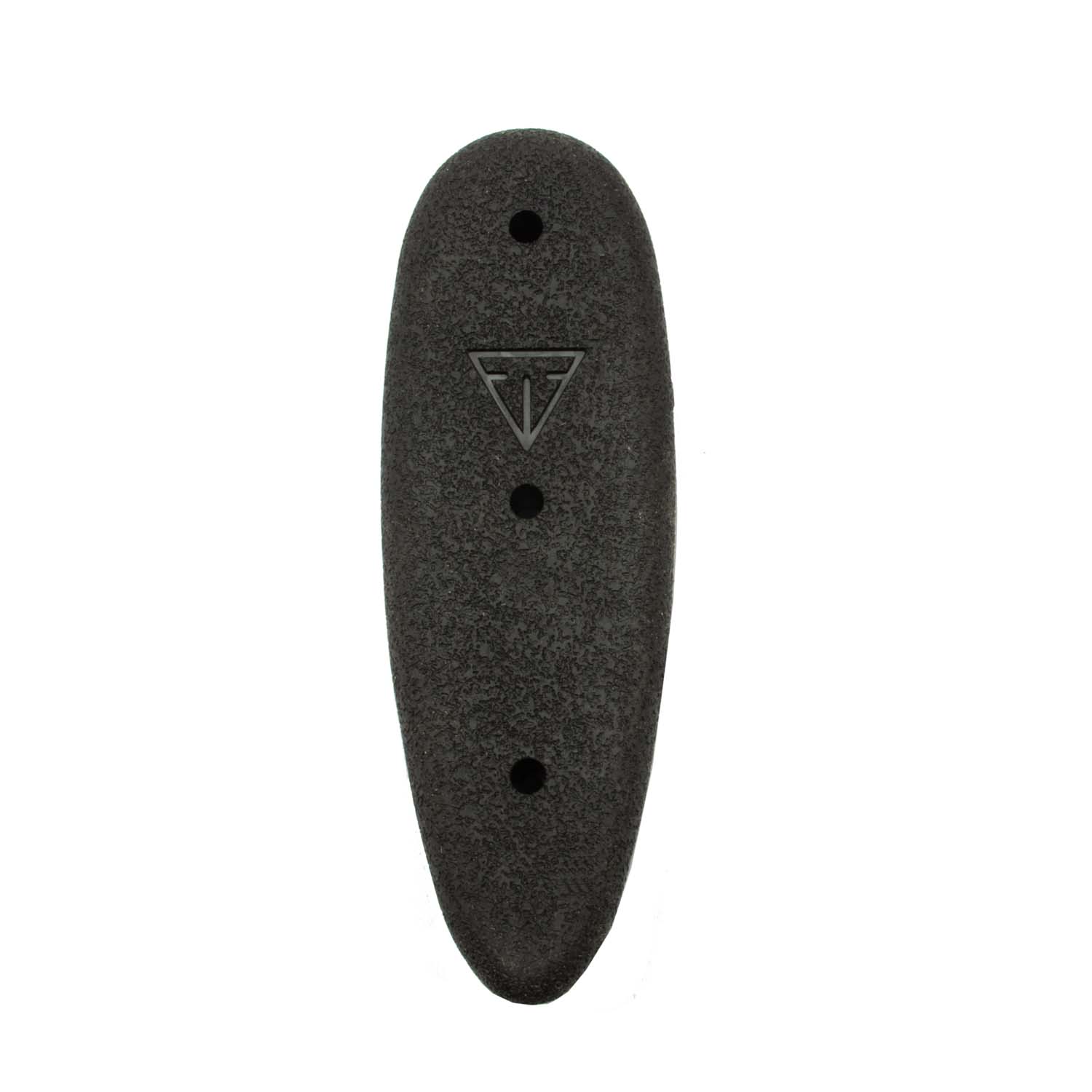

Thinner recoil pad.....assuming you have no LOP spacers installed, right?
Not sure how thick the stock pad is, but here is one at 3/8" which is fairly thin.
I had to do similar on a J Allen chassis....scope as far back on rail as possible, scope back as far as reasonable (did not want rings hard up on the turret), so pulled off the OG JAE 1 1/2" awful pad and had a kick-eez 3/4" pad ground to fit.
Solved my eye relief problem.
