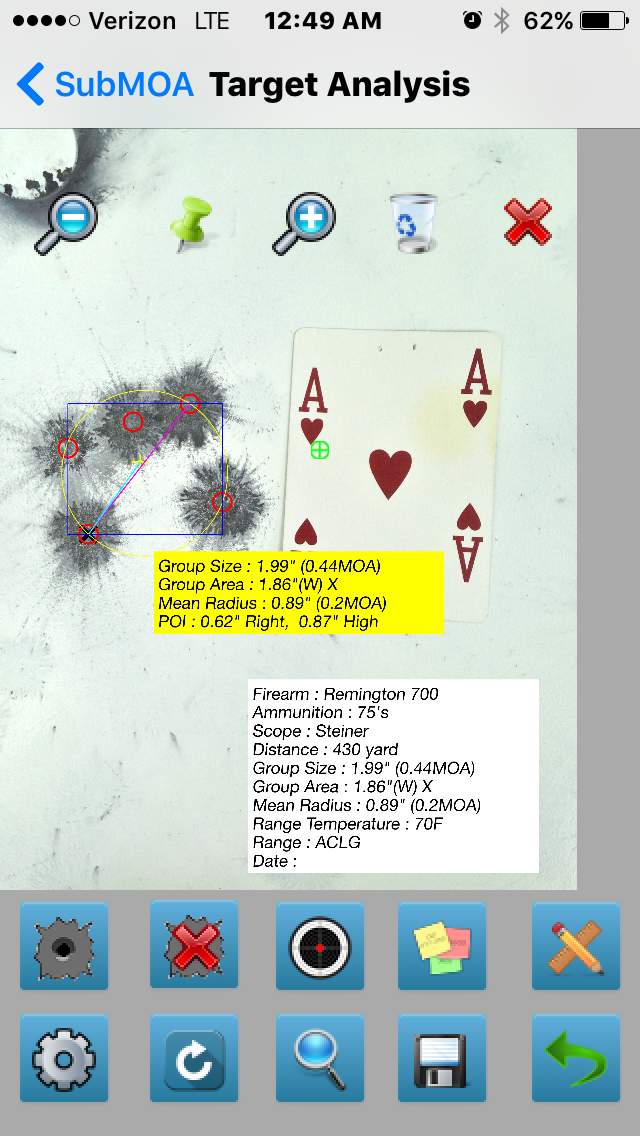

My sps 1-9 twist with 75's @ 430

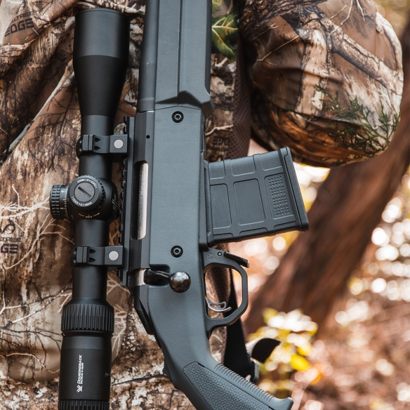

The -now only potential- issue with that is that the ruger magpul stock doesnt play well with the 223 aics mags. AICS and even accurate mags with the extended feed lips release the bullet early before it starts into the chamber.
I think that is part of the reason magpul came out with the dumb new 5.56 "aics" they did which is why I said now only potential to start.
At least they show one with a ruger american, no actual reports yet on if it actually works or not.

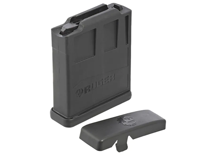

Have you tried the Ruger .223 AICS mags. The feed lips are longer by 1/4" or more.
If you mean the plastic ruger mag then I have not but others did and it didnt work for them
If you mean the metal ruger branded mags that arent offered via ruger anymore but that you can still get from accurate mag... they worked in my 223 american oryx and other chassis for other people except they still didnt work in the magpul hunter for the others.
Its been an ongoing saga for the magpul hunter and 223. https://www.snipershide.com/shooting/threads/ruger-american-223-stock-replacement.6947542/page-2

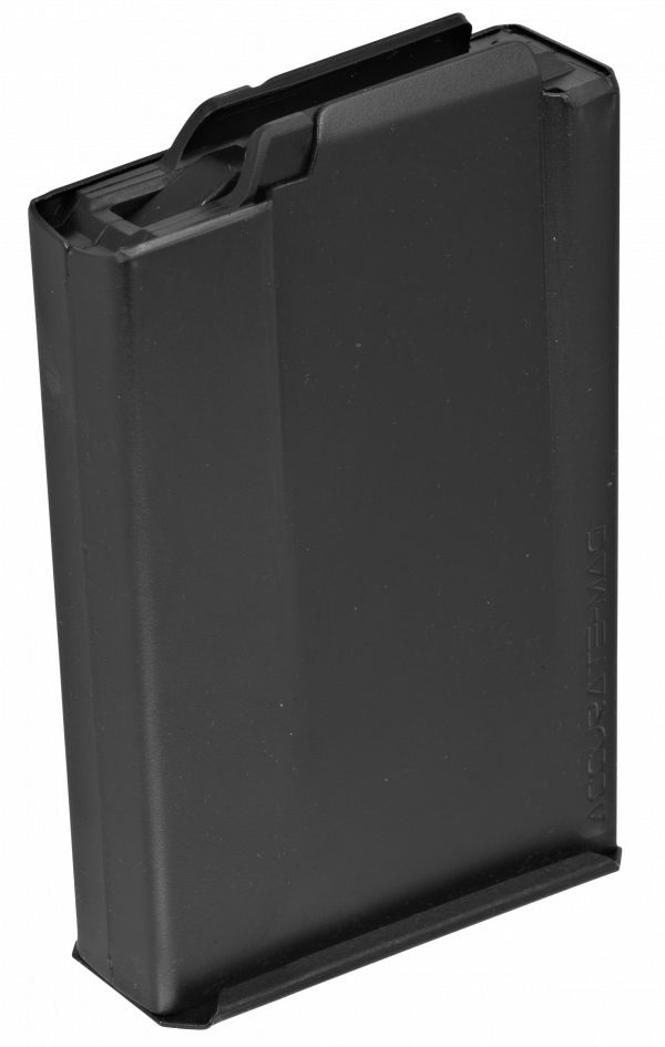

I use the steel Accurate Mag 5round mags for my 223. I pulled them apart and did the modification that the 6.5Guys recommended in their .223 Trainer video. This allows my 80gr rounds that are seated very long to feed great through the magazine.

Accurate Mag - Steel 5 Round mags
I did have to adjust the magazine seating depth with the JAE-700, but once I set it for one type of magazine I found that it fits the magpul .308 AICS and the AI AICS mags perfectly as well.

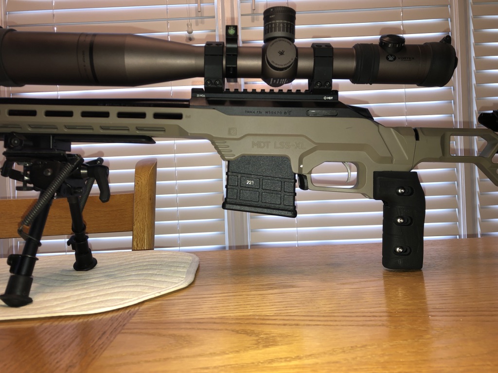

This is a Tikka T3X Varmint (.223) in an MDT LSS-XL Gen-2 chassis with MDT AICS-format polymer mag, vertical grip, M-lok ARCA rail, and skeleton buttstock. Not shown is the Anarchy Outdoors bolt handle. It runs slick as can be asked. New-purchase, non-sale price of rifle and chassis setup (not including optic, bipod) is right at $2k. I've really tried to resist the siren song of a custom .223, which would cost about $2600 to set up the way I want, even with a lower-tier action.
Main point for this thread is that the MDT mags allow for more bullet length than the Tikka throat will swallow.
