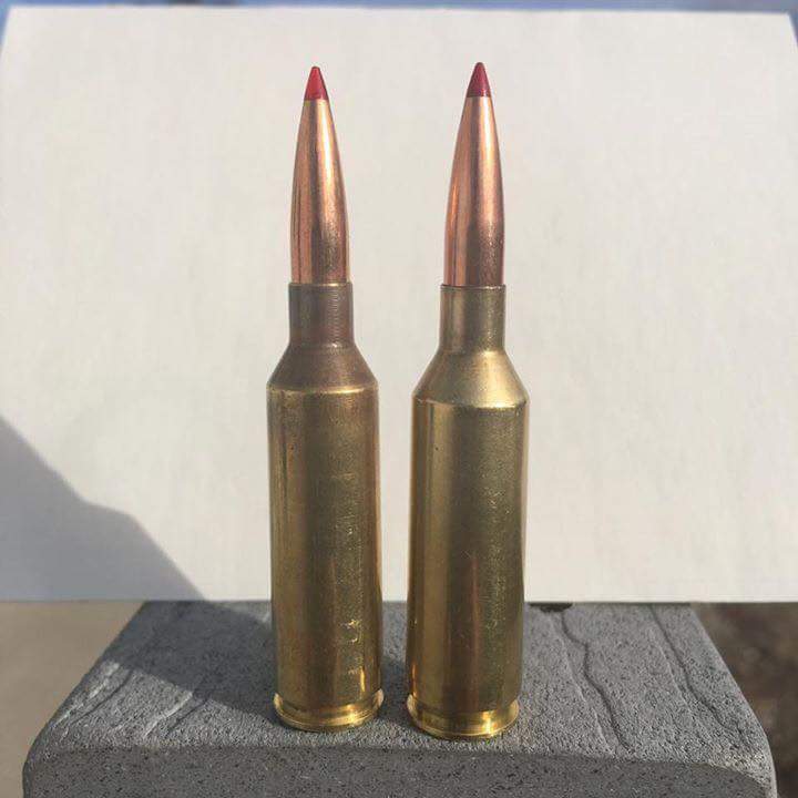

    6.5 SAUM(right) is based on Remington SAUM Case and has a rebated rim
    6.5 PRC(left) is based on the Ruger Compact Mag Case and in a Non Rebated rim.
    SAUM is about 50-60 FPS faster
    I dont own one, i shoot the 6.5 saum. That was a copy paste from George Gardners facebook page.
