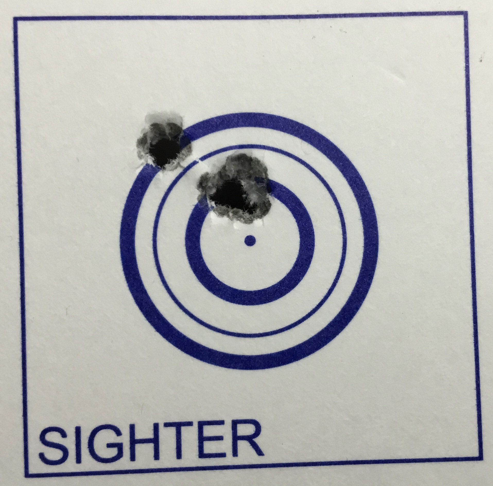

Recent outdoor competition shoot at 50 yds, 7-10 MPH tail winds, 37 F🥶, 1st shot high and left, scope adjust, then 4 more into this beaut. That tuner might be doing something…
YMMV, happy shooting
